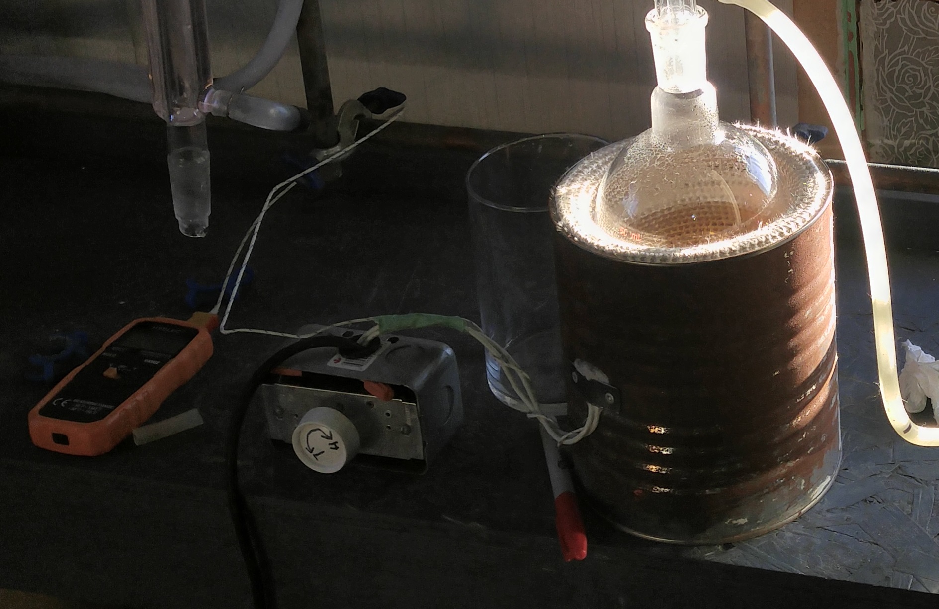

let me rephrase, can you wire a basic electrical circuit, and cut a soup can with out dying?
If so a 1500w light dimmer from local store, and a mantle from daschem for 33 dollars cad and some wire = veritable power heating mantle for about 50 dollars
If you have access to an old oven then you can salvage the high temp wire and the infinite switch from that but will be less precise then a dimmer
Once wired, the soup can was carefully packed with mineral insulating wool to insulate the live wires and to immobilize them inside the can.
If you want to make a separate build thread a great many of us should be able to help you.

Yea I can do that without dying. Do you use nichrome wire for heating?

Ubya - 4-1-2019 at 06:42
no need for nichrome wire, on ebay you can buy the already made heating element woven with glass fiber in a cup shape
Sometimes they only sell the glass sleeve without heating element (and they count on people not seeing this), so make sure to read the listing before buying. Maybe winding a heating element from nichrome would feasible anyway if you have a glass sleeve.
