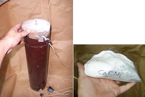

rrroket - 19-8-2010 at 07:38
For better insulation from the air on the lid of the oven pour quartz sand.
I also watched the formation of gray items in 1/4 of the reaction mixture!
I thought that this is due to the fact that I use very long furnace reactor / diameter 45 mm, length 300 mm/
So someone is cause charring organic residues and can not be separated.
It appears this is not the reason.
Also 30 minutes after reaching a temperature of 700-750 degrees leaking gas products are capable of burning with a blue flame.
At the end of the separation of these reaction products are terminated.
/Note-text is machine translation.
Possible inaccuracies/
Reactor furnace and the resulting calcium cyanamide.JPG - 24kB

Okay so I used a 'furnace' to make the Cyanamide. It's just some insulating firebrick with nichrome coils going around the sides. The thing makes somewhat okay Cyanamide, what I'm assuming to be just under 50%.
So since my Cyanamide is so shit, I used 15g of it, and 9g of Hydrazine Sulfate. I kept the pH pretty under control, but the temperature was hard to maintain. During the 80 degree Celcius step, the temperature went up to 95 degrees twice. My yield was about 2 grams, which is honestly shitty. I think I would have somehow messed everything up with the temperature. I know that not getting the temperature high enough is a big problem, but I didn't know about the temperature maximum.
