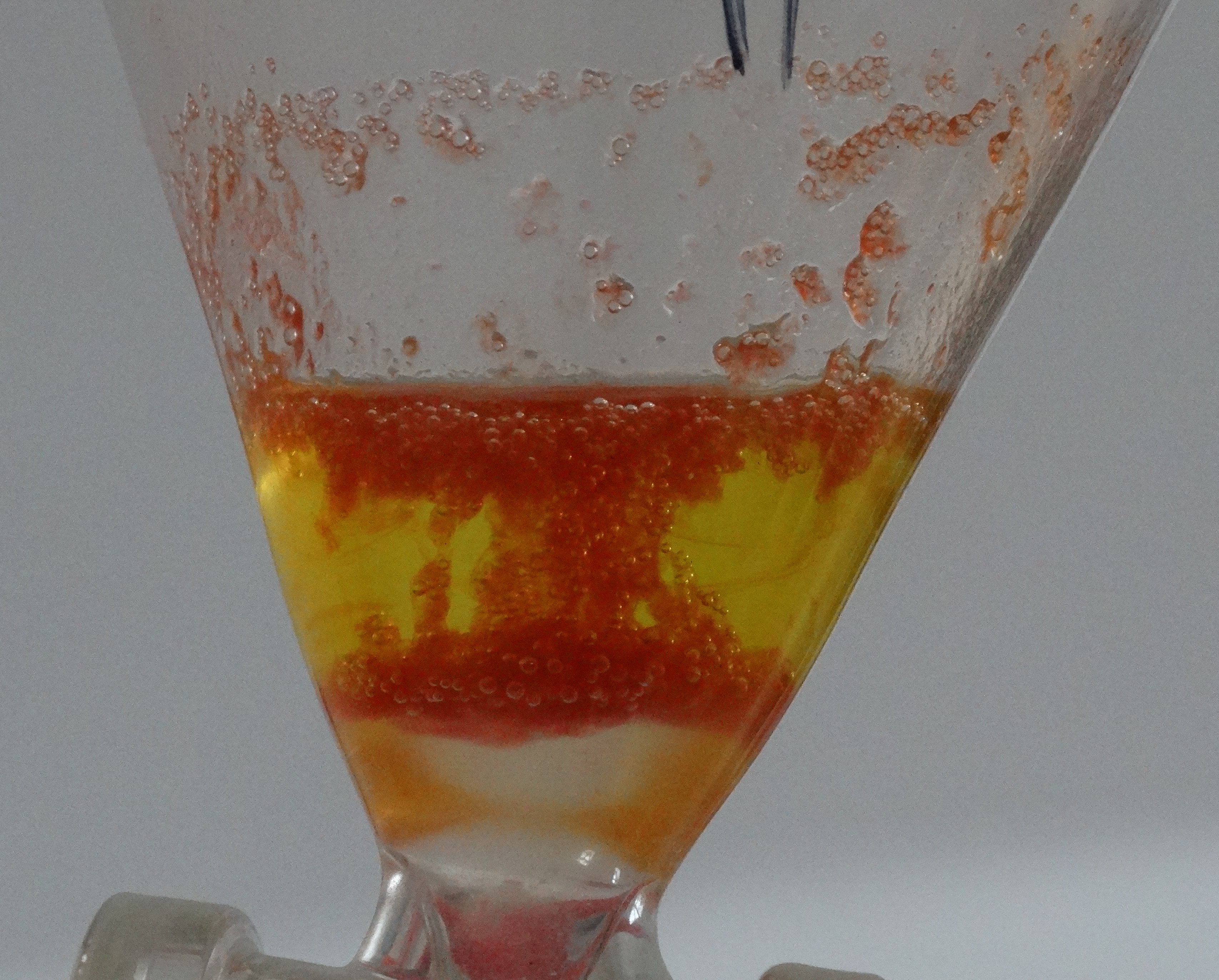

7.5g phenylhydrazine.HCl (52 mmol) are placed in a 250ml seperatory funnel and dissolved in appx 150 ml of dH2O to yield a clear, slightly yellow solution.
5g of KOH are dissolved in 20 ml dH2O and added to the seperatory funnel. The resulting solution turns to a slightly stronger yellow and is basic in ph.
DSC07736 (2).JPG - 2MB
The solution was extracted two times with 30ml of ether, the aliquots combined and the aqueous soln charged with 40g of KCl and shaken to dissolve the salt. On dissolving a organic layer formed and another 30 ml of ether were added on wich a red substance appeared. Most of the queous layer was removed and the seperatory funnel allowed to sit for a few minutes. Tiny bubbles on the red substance pulled some of it to te top of the organic layer. What a mess.
The ether was pipetted off as good as possible to exclude the red substance.

I have no idea why but it seems to me that the sulfate salt of phenylhydrazine is much more air sensitive than the hydrochloride. I scrached the rest of the sulfate wich was still sticking to the sides of the beaker and it had a slight pink colour, not that strong though. Also is the yield really disappointing, I will try to improve!
The sulfate will be recrystallized soon, does anybody have some solubility data?
Any suggestions what the red stuff was or any ideas how to improove are welcome. I hope the way I wrote it is ok.

I think the bottom water layer under the ether layer could contain quite some phenylhydrazine, maybe yields could be improved by adding less (stoichiometric?) sulfuric acid.
Apparently not all phenylhydrazine came over during the extraction, as the amount of sulfuric was about stoichiometric. Maybe using less water in the initial step is an idea. I guess the freebase is quite soluble in water.
DrScrabs - 9-4-2019 at 10:54
Yes it is quite soluble in water, I thought about salting out before the first extraction and using less water as you mentioned. In my test tube experiments i never dissolved the phenylhydrazine.HCl and I had a nice blop of phenyhydrazine floating on top on basifying.
Maybe I do change the extraction solven aswell, ethyl acetate maybe. I will report back again :)
