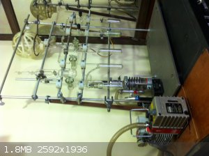

Heavy Walter - 17-4-2019 at 09:01
Hi
I did the synthesis years ago. Completely quantitative.
See the setup involved.
I used vanadium pentoxide, cold traps (ice/salt; acetone/dry ice and liquid N2).
My purpose was to obtain deuterated benzene, so I used heavy water.
Any doubts?
IMG_1236.JPG - 1.8MB

Why would you use cold traps?
Also, what was your yield? Any idea?

Heavy Walter - 19-4-2019 at 15:08
Hi Dr Scabs,
My purpose was to explore the trimerization in order to produce commercially deuterated benzene.
Was nice try but commercially bad, due to very low price of the product in the market.
Hi Keras
I used industrial carbide and the traps were useful to stop heavy water vapors, air traces and some other stuff.
My notebook is not at hand now but I produced 5 mL, extremely pure C6D6.
During the operation there were two accidents: a stopcock flew away due a sudden overpressure and at the end, when pouring the excess of liquid N2 in a large dewar, the small dewar exploded when tilting it.
I employed those commercial small dewars for keeping warm food for kids and tilting it generated stresses on it.
