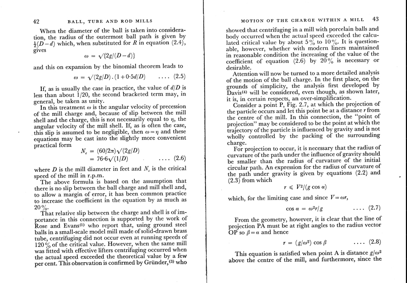

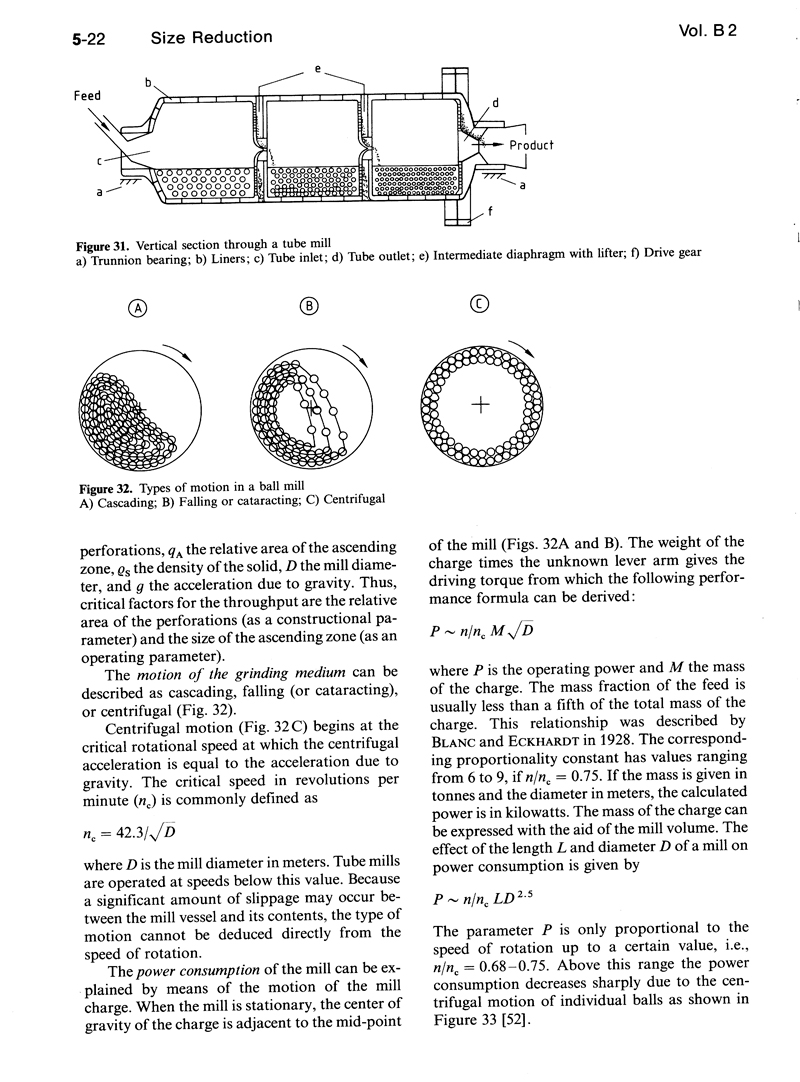

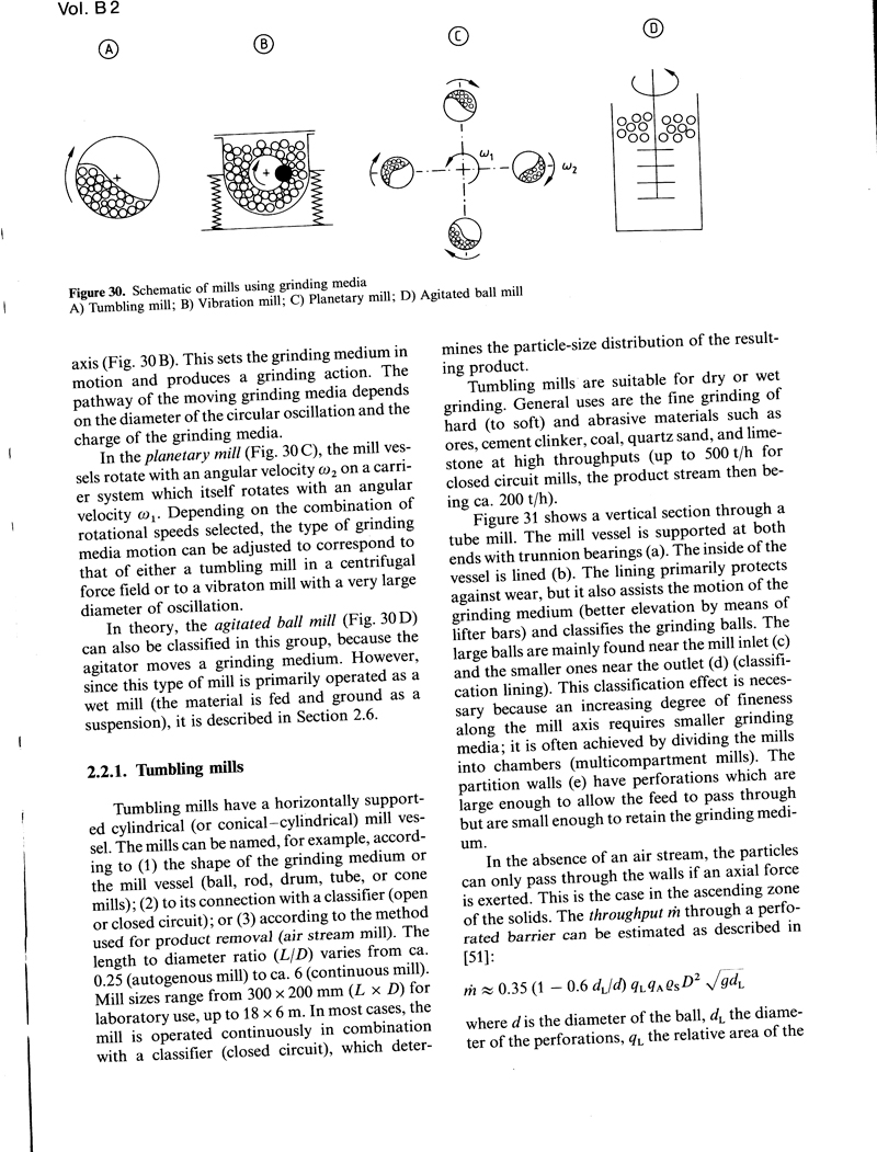

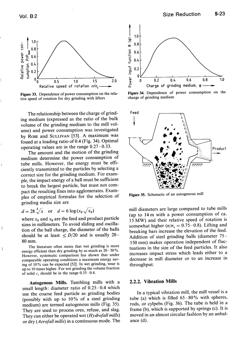

The WiZard is In - 18-11-2010 at 11:23
Quote: Originally posted by mnick12
I have heard of incidents similar to this, some causing quite a bit of damage. A particular incident I recall reading a few years back was an experienced pyrotechnic hobbyist, who wanting some ultra fine magnesium, milled some coarser granules to get the desired particle size. Upon opening the ball mill the magnesium dust instantly ignited causing a massive fireball with alot of heat, miraculously the man escaped with only mild burns.
Ball-mill-1.jpg - 889kB Ball-mill-2.jpg - 847kB Ball-mill-3.jpg - 813kB
This is your basic thermite® type reaction. A standard lab demo

Ball Milling Speed and Load
The WiZard is In - 2-12-2010 at 12:33
Rose and Sullivan
Ullmann's B2 5th ed.
Ball-mill-Ullmann-2.jpg - 335kB Ball-mill-Ullmann-1-800.jpg - 384kB Ball-mill-Rose-800.jpg - 240kB Ball-mill-Ullmann-3.jpg - 358kB

Bert - 28-2-2014 at 17:55
It's the necromancer!
The ball mill chosen was far too narrow. Mill efficiency goes up dramatically with increased jar diameter- That "6lb. ballmill" is actually just two 3lb. (tiny!) mill jars on a double length roller system.
Charge is not determined by WEIGHT. Charge is determined by VOLUME. Mill jar should have been exactly 1/2 full of media, charge to be ground should fill up the interstitial space between the pieces of media, no more. Overfilled jar makes for a much slower grind-
Cheap acetone isn't too pure, acetone is also hygroscopic and needs to be dried before use in several pyrotechnic applications I know of, particularly where it contacts Mg or high Mg alloys. Molecular sieves work for that, so would various anhydrous chemicals that take up water as they hydrate and aren't soluble in acetone.
