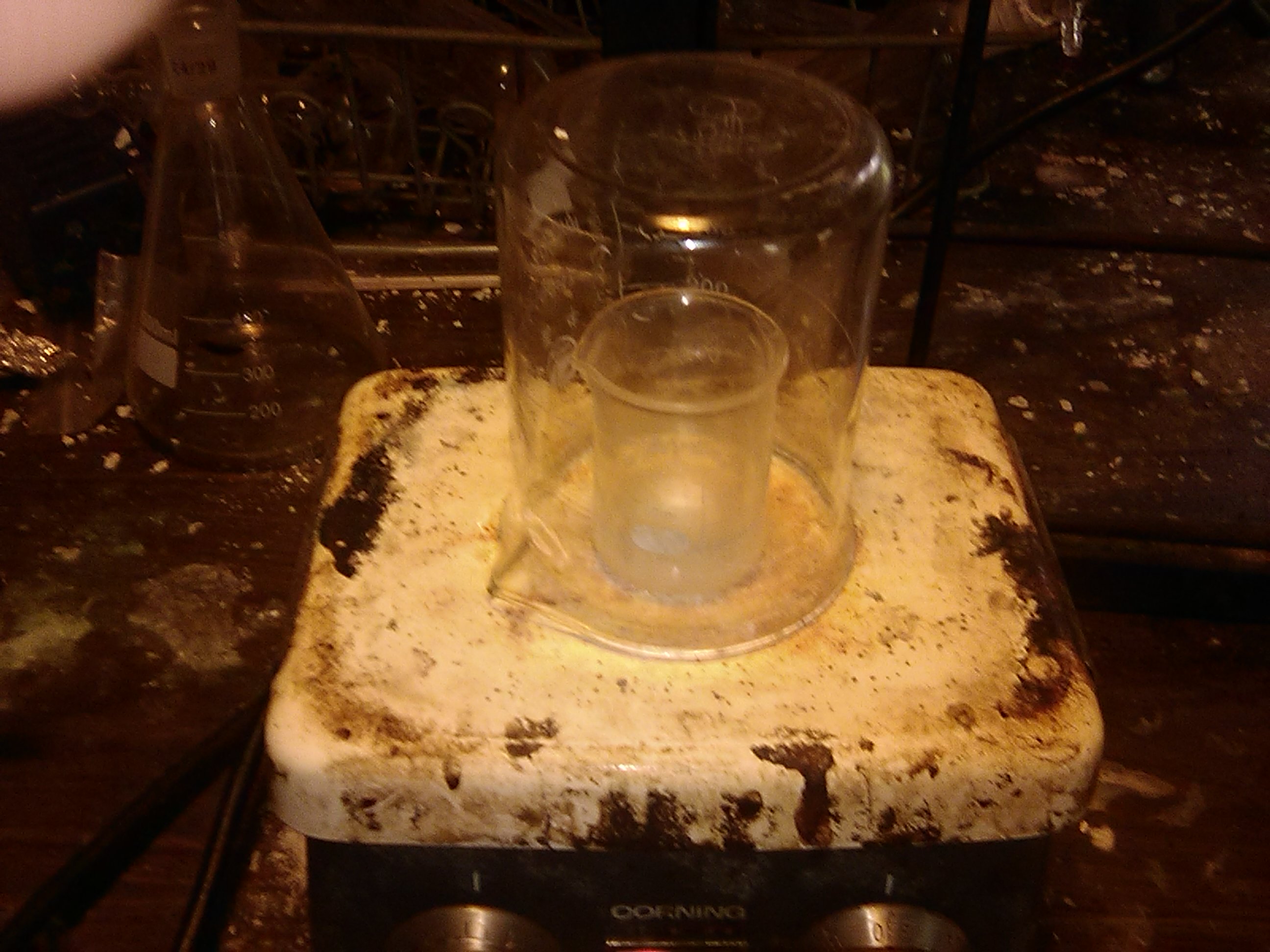

On my mobile. Going to try and set if I can post pictures on a moment. Yesterday morning I put 25ml denatured
EtOH (710 solvent) and one gram of urea in a 50ml beaker and started stirring. This morning I have a non soluble white crust built up. Will check when I get off work today. Still stirring.
IMG_20190429_104451.jpg - 707kBIMG_20190429_104349.jpg - 548kB

Used no catalyst so far, but thinking about a drop or two of H2SO4. I'm practically ancient, so carcinogens don't intimidate me LOL
