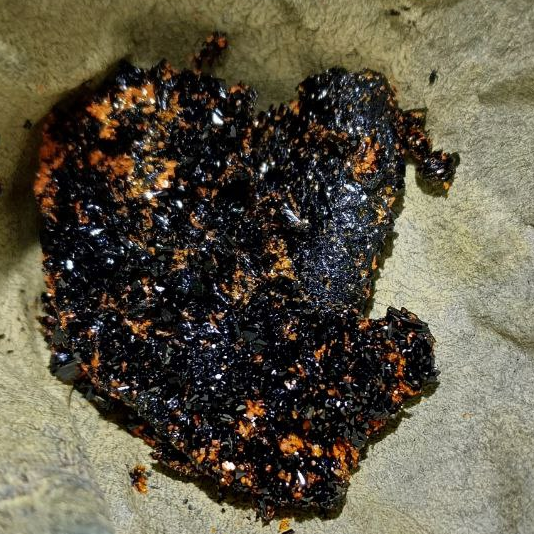

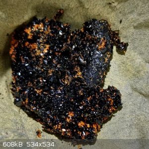

mayko - 13-10-2025 at 20:31
I also followed Brauer and also seem to have leftover dichromate speckling the crystallized product. I wonder if I can rescue the batch by redissolving and adding more oxalic acid?
chromiumoxalatiecontamination.png - 608kB
