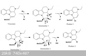

I have also tried the reaction with bromine, as suggested: in a 20 ml flask equal volumes of hydrogen peroxide 3% and sulfuric acid 37,5% were mixed giving about 15 ml solution. To this a small quantity (less than 0.5g) KBr was added, the solution turned almost instantly yellow with a strong bromine odor. 10 ml dichlormethane were added and the mixture was stirred, giving the organic layer an orange color. In a separate flask, rinsed and dried previously with acetone, 0,3 g test substance and 10 ml DCM were added giving a clear yellow solution.
I took the bromine containing DCM with a pipette and added it to the test DCM solution. Decoloration was instant but interestingly it also started slightly fuming (HBr). I would say that if the substance is vinconate (which is highly likely as both M and melting point correspond), there was an addition of bromine to the isolated double C=C bond, followed by an elimination reaction. I have attached a possible mechanism; I would presume that the bromonium intermediate would more likely react with another bromide giving the dibromo derivate which would eliminate HBr giving product 2.

1.png - 29kB
