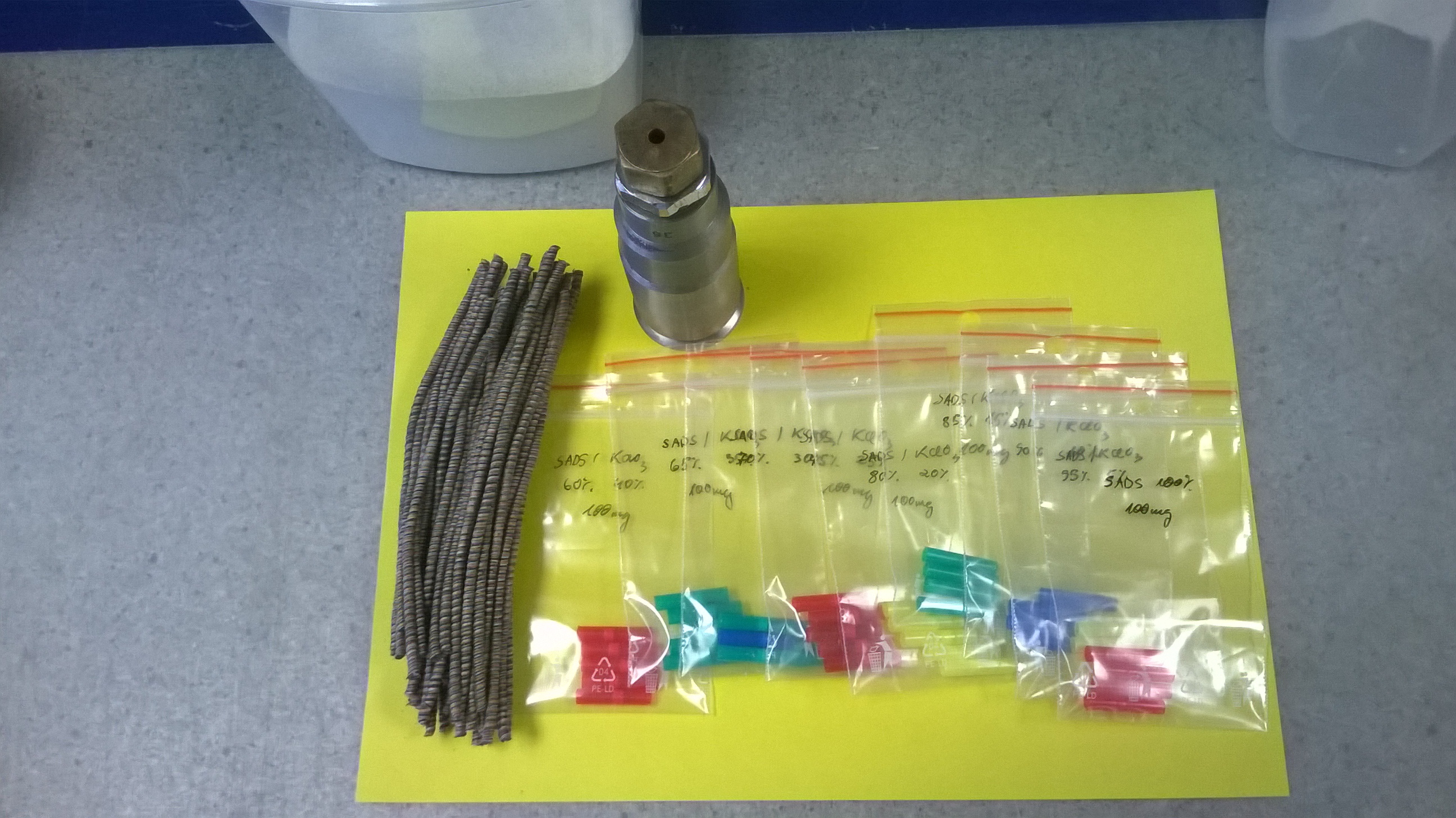

So I prepared a set of samples:
WP_20170201_001[1].jpg - 1.1MB
2* 50mg 100% SADS for baseline
1* 50mg 15% KClO3
1* 50mg 20% KClO3
1* 50mg 30% KCO3
2* 100mg 100% SADS for comparison
The cell was loaded with 40g of evaluation sand 250/100um fraction for all tests and then sieve analysis was performed with RETSCH AS200 apparatus on 100um sieve to get the fraction that passes the 100um limit as the assessment for brisance.

The first results were as follows:
Baseline <100um for 50mg SADS 100% : 3,89g
Baseline <100um for 100mg SADS 100% : 5,82g
15% KClO3 <100mg fo 50mg : 4,42g
20% KClO3 <100mg fo 50mg : 4,09g ?? (probably an error in assessment)
30% KClO3 <100mg fo 50mg : 4,45g
This proves, although inconclusively, my previous assessment of the brisanse of these mixes based on the "match shattering" method. Seems that addition of KClO3 increases the power by quite a considerable amount compared to pure double salt.
As we can see from the baseline measurements ,the double charge of pure SADS caused about 49.6% increase in amount of <100um fraction. Where as the addition of 15% KClO3 caused about 13,6% increase in amount of <100um fraction. Derived from that, one could quite loosely estimate that the 15% KClO3 mix is about 27% more brisant than pure double salt. This applies only to this test under these particular circumstances and postulating that brisance increases linearily in relation to the amount of sand crushed. Which of course is not correct, but let's just assume for the sake of simplicity and just to make an example. All in all I'm very pleased with the performance of the cell and the first results. For further steps I will work with 100mg samples for better resolution and make more repetitions on all datapoints to get a more conclusive result and catch the most potent sweet point for the mix.
Oh yeah...I tried to set off the SADS KClO3 mix with friction and impact...no go, luckily it seems to be not too much more sensitive compared to pure double salt, but extreme caution is a must.
Nice side effect which can be seen in the last picture is that the top of the sample holder is covered in a shiny well adhered layer of metallic silver. It was deposited by the 100mg pure SADS baseline measurements. The 15% mix actually deposited a golden layer which looked even more pretty :)
As far as downsides of this perticular setup are concerned, then the fuse for initiation is best replaced by an electrical triggering system. The pyrotechnical route is messy, leaves ash and stinky byproducts if a BP fuse is used and must be set off outside....but it is simple and reliable.

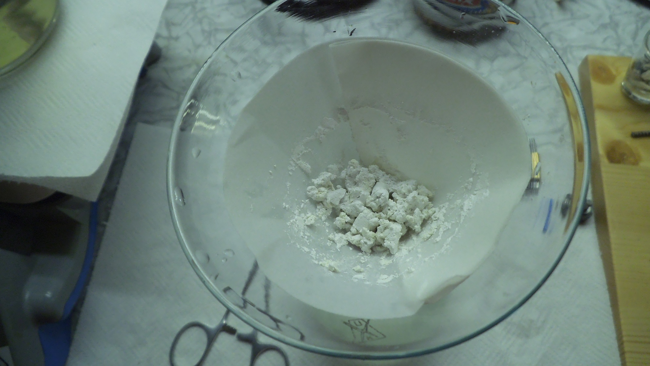

Perhaps an illustrated synthesis run starting from metallic silver is also of value:
DSCF1187.JPG - 761kB
So let's weigh out a sample of Ag
DSCF1188.JPG - 641kB
And prepare the reactor with 20ml of water as the heel and apply PID heating on magnetic stirring
DSCF1190.JPG - 657kB
Warming up to setpoint....
DSCF1191.JPG - 611kB
Let's measure out 20ml of 65% HNO3
DSCF1192.JPG - 666kB
Dissolve the silver and filter the solution into a syringe to remove any persistent colloidal leftovers (with the help of a cigarette filter :D )
DSCF1193.JPG - 694kB
As one can see the solution has a characteristic blue coloration hinting to a copper contaminant in the metallic raw material....but no worries, as it turns out, most of this impurity shall remain in solution after the reaction and can be removed with washing and filltering of final product.
DSCF1194.JPG - 630kB
Let's inject all of the silver nitrate solution into the reactor and let it equilibritate to 65C according to the inner mercury termometer. This requires to overdrive the pid setpoint slightly.
The solution is ever so slightly murky....most likely the water contains some impurities that cause the silver to percipitate in various forms of insoluble salts...a minor inconvenience.
DSCF1195.JPG - 613kB
Let's get some calcium carbide ready to feed into the gas generator.....a horrible low tech garde....dirty as sin in the dark night of Instanbul :D
DSCF1198.JPG - 826kB
Let's fill some into the gas generator that has an ice cold ice/water filling and start the 10 minute bubbling of acetylene into the reactor under vigorous magnetic stirring....omit all filtering of acetylene gas!
DSCF1199.JPG - 573kB
Immediately a beautiful snow white double salt precipitate will begin to form...
DSCF1201.JPG - 602kB
After the ten minutes are up, the administration of gas is stopped and mixing is shut off, the product layer is thick and voluminous, filling practically all of the liquid phase. As can be noticed, the solution above the solid still retains the characteristic blue hint of a copper impurity. Seems that it mostly stays in solution and poses no hazard to contaminating the final product.
DSCF1203.JPG - 692kB
DSCF1205.JPG - 668kB
DSCF1206.JPG - 558kB
DSCF1207.JPG - 554kB
DSCF1208.JPG - 773kB
Spit, stir, filter, wash, squeeze, set a portion to dry.....and commence testing :)
[Edited on 7-2-2017 by markx]

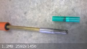

Whilst I am waiting for my limestone sand sample to arrive with the next shipment, I went forth and begun with the creation of a primordial secondary test cell....the "STAMMZELLE" :D
WP_20170207_001.jpg - 1.2MB
Round, face off and clean the main cell chamber.....

Trying to make most of the Friday, I managed to shoot a series of samples in the "nr 36" cell to cover the dilution range of 0-40% KClO3 in terms of limestone sand crushing ability.
The lot of 100mg samples:

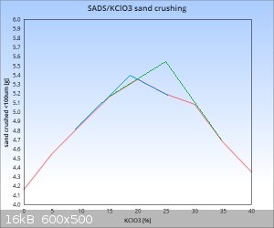

My results of % dilution with KClO3 vs sand crushed below 100um in grams:
WP_20170210_004.jpg - 1.1MB
Due to a rather hectic schedule I only managed to shoot one series instead of four repetitions for every point. I will do that tomorrow to back up the statistical aspect of the data, but since I carefully perpared all of the samples to have the same weight and also made sure the sand was homogenous then even the single point results should reflect a reasonably credible picture of the situation...at least I hope so :)
ChartGo.png - 16kB
It seems that the sandstone from this shipment was a bit harder than the previous batch as the 100mg sample of pure SADS only crushed 4,16g below the 100 micron mark as opposed to 5,82g in my test with previous batch of sand. So already I have reached a situation where data from previous tests is not directly comparable to current one. This makes it quite apparent that when comparable data is to be obtained, then working with materials of the same batch throughout the whole series is absolutely mandatory. Luckily I have just enough of the sand stocked to complete this series with 4 repetition points for all dilution ratios and get a comparable set of data....also the SADS and KClO3 in all of the samples are from the same batch.
As for the relationship of brisance/sand crushing ability vs dilution ratio....seems that the sweet spot for this mix lingers with reasonable probability somewhere between 20-25% KClO3 content. What is quite amazing is the fact that at 40% KClO3 content we are still at about the level of pure double salt brisance or slightly higher (one datapoint is not enought to draw precise conclusions). Quite surprising, as I suspected a sharper drop, but well, the preliminary data suggests otherwise....
PHILOU Zrealone - 10-2-2017 at 11:22
Very nice markx,
You should plot your first results and the new ones in the same graph. Can you do it please?
As expected the geometric factor plays a role...
About the maximum ("sweet spot") actually it can be also between 15 and 20%...since 20% is your maximum graphical point from 5% intervals...the true maximum can be right on it or on its right side or on its left side.
chart SADS-KClO3.jpg - 17kB
Also, once your process is mastered and reproductive...
I strongly invite you to make tinier intervals of 1%...

markx - 10-2-2017 at 15:55
Very nice markx,
Once when working at Procter&Gamble, I was making a study of stiffeners to stop wrinkles of fabrics after laundry wash (post wash wrinkle resistance project)...so we were screening silicons and activated them by ironing the fabrics...then the rigidity of the fabric was analysed by its bending of a given lenght or rectangular calibrated piece of treated fabric.
My manager had chosen the % to analyse (1%, 3% ,5%, 10%)...normally you would expect an increase of rigidity of the fabric when increasing the amount of rigidifier...but the results were erratic no matter the type of rigidifier...so I asked to my manager if I could perform an extensiver study, he said OK but only during my free time...so I decided to perform a study on various product by 0.1% increments (thus instead of 4 point, I prepared, tested and measured 100 solutions per product)...result was very unexpected...the rigidity was following an amorted oscillating patern and in fact the use of 0.3% rigidifier was better than the use of 10%...so it had significant cost reduction impact.
[Edited on 10-2-2017 by PHILOU Zrealone]
Admirable persistence in executing a workload of an order of a magnitude greater than the initial plan and even more so outside of your required duties....I do hope your employer rewarded your efforts with more than a subtle "thank you" :) I myself have ventured on similar paths in service of similar employers in the past. Perhaps not so srikingly enourmous ones in terms of workload, but found to my not so great surprise that besides satisfying personal curiosity for the topic, it gains one little leeway in the upward direction of the rotten steps on the social ladder :D But I am digressing from the topic...
Sure I can and will include also the first results on a combined graph once I have completed the intended set of data. Perhaps displaying the results in % of gain in the amount of sand crushed compared to the initial baseline of pure double salt shall display a clearer picture of the relationships involved, as it offers a simple means to factor out the size of sample fired. The first results were obtained with 50mg energetic samples, but the latter ones with 100mg amounts. Of course the "cell constant" may be different with dissimilar mass of charge, but the overall realtionship displayed against the baseline in % difference between dilution ratios should be reasonably similar and comparable.
The "sweet point" proximity surely deserves a more enhanced resolution by smaller steps on the dilution range scale, but I would not venture on the path of covering the whole scale with say a 1% resolution.....I highly doubt there are any sudden bursts of performance that might get lost between the 5% resolution steps further away from the main peak area.

WP_20170303_001.jpg - 1.2MB WP_20170303_002.jpg - 1.2MB WP_20170303_003.jpg - 1.2MB
Notice the black goop on the inside of the sample tube.....that was caused by the arc burning on the surface.
