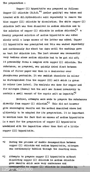

After some reading... this thread may not even belong to organic chemistry at all! :) Apparently, the presence of copper(I) in some instances may lead to dimerization and further reduction of the NO dimer produced, forming a hyponitrite (also see. J. Am. Chem. Soc. 2017, 139, 38, 13276-13279 and Journal of the Chemical Society (1928): 1449-1455.) Ascorbic is a very strong reducing agent, so this would definitely be possible. Supposedly, even boiling nitrate salts with ascorbic acid alone is able to produce nitrites almost quantitatively.
Hyponitrite istelf apparently is a very strong ligand towards copper (I) and forms a chocolate coloured and water-insoluble precipitate with a copper(I) salt, even in the presence of a large excess of chloride ("Some reactions of hyponitrites and the related substances - part II, J.Indian Chem.Soc" see atachment). On decomposition it may form nitrogen gas and copper(II)oxide --> Cu2N2O2 --> 2 CuO + N2 + a lot of energy (a nanothermite of cuprous hyponitrite with aluminium or magnesium powder ought the be interesting! :D) . The latter reference also studied the thermal decomposition of cuprous hyponitrite and strangely though, they never mention strongly energetic properties for their compound, so maybe the precipitate obtained from ascorbic/Cu/nitrite is something entirely different after all...hmmm :)
As metacelsus says, analyzing the copper content of the brown precipitate would probably be more informative, though I don't see an easy way of doing so, except heating it for a long time far under it's explosion temperature (around 210 deg C) and finally higher temperatures, which may leave relatively pure copper(II)oxide...The precipitate also dissolves easily in dilute ammonia, so this may also be an option for some tests.
Curpous hyponitrite.jpg - 125kB
