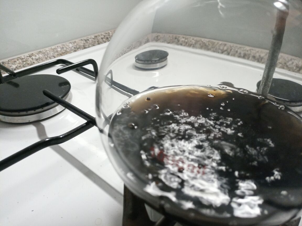

H2SO4 seems not to be much soluble in the ester, perhaps 1 ml instead of 5 ml would be enough as an catalyst
IMG_20200629_093303_2_sm.jpg - 97kB
when almost all H2O trapped and H2SO4 became concentrated again, a carbonization started and a strange phenomenon - small droplets floating at the surface

Hi Tsjerk, you are right, that should help at the small cost that it won't be so well visible what happened at the bottom of the reaction flask. The carbonization occurred when H2SO4 became again concentrated at the end of reaction when last 2 ml of H2O trapped in the Dean-Stark trap adapter during last 20 minutes (first 16 ml was collected fast in 30 minutes). Also better for safety not to heat flammable chemicals using direct flame, I know.
So everyone repeating this experiment should do it as Tsjerk suggested, no need to observe the bottom of the flask, you already know, shown on the pictures.
