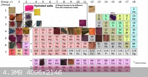

Since there have now been so many metal salts made, i put together a periodic table . There is still a lot of them to be made :)
group 1 is complete!
for group 2 only beryllium is missing.
nedladdning.png - 4MB
[Edited on 27-3-2021 by RustyShackleford]
vano - 27-3-2021 at 08:23
Perfect. I have beryllium i will make it

Bezaleel - 27-3-2021 at 16:15
Nice work! :)
Maybe it's a good idea to write the element symbols into the pictures.
The europium solution is not representative. It was made from EuCl3, which inhibits formation of larger amounts of Eu-violurate. I regained some violuric acid from the failed Pr synth. If you wish, I can make the Eu salt from Eu2(CO3)3, or I can try Ce or Er, whichever you prefer.

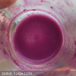

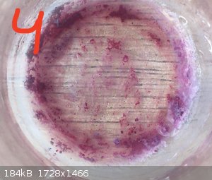

Silver violurate. Solution and anhydrous. I think red particles are hydrates.
PicsArt_03-30-07.49.33.jpg - 324kB received_878483599379459.jpeg - 189kB
How can you be so sure that silver salt is anhydrous? Red colour can be caused by different particle size.
vano - 30-3-2021 at 09:12
The color changed and faded. We have talked about the size and color of the particles before, in this case the red particles were on the walls of the flask, while the dark bottom, i.e. the red, lost less water.

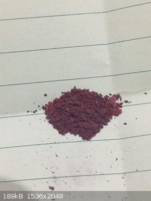

o-toluidinevio.jpg - 1.3MB
