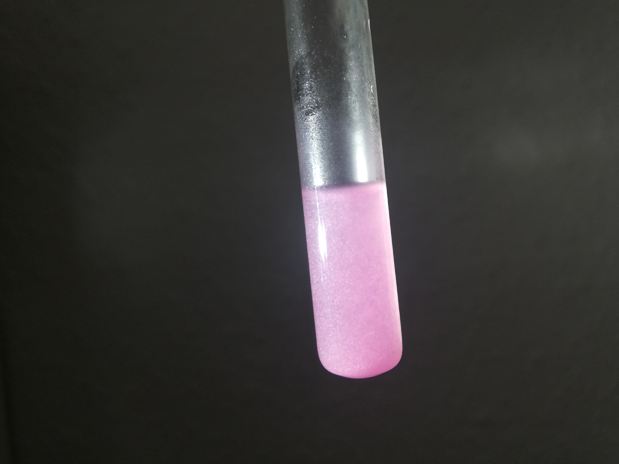

Chemical tests:
The presence of piperidine in the mother liquor, the steam distillate and the final product can be detected using Reinecke's salt NH4[Cr(SCN)4(NH3)2], which can be prepared fairly easily and which is a rewarding inorganic preparation in its own right.
The sample is brought into an excess of ammonia solution (the mother liquor was partially neutralized with NaOH first). To this, a solution of reineckes salt in dilute ammonia is added. Piperidine produces a precipitate which depending on the color of the solution may range from light purple to beige. Pyridine produces no precipitate under these conditions.
This test is positive for mother liquor (pic 1), steam distillate (pic 2) and final product, and negative for the starting material (pic 3).
Pip_5.jpg - 299kB Pip_7.jpg - 283kB Pip_6.jpg - 418kB

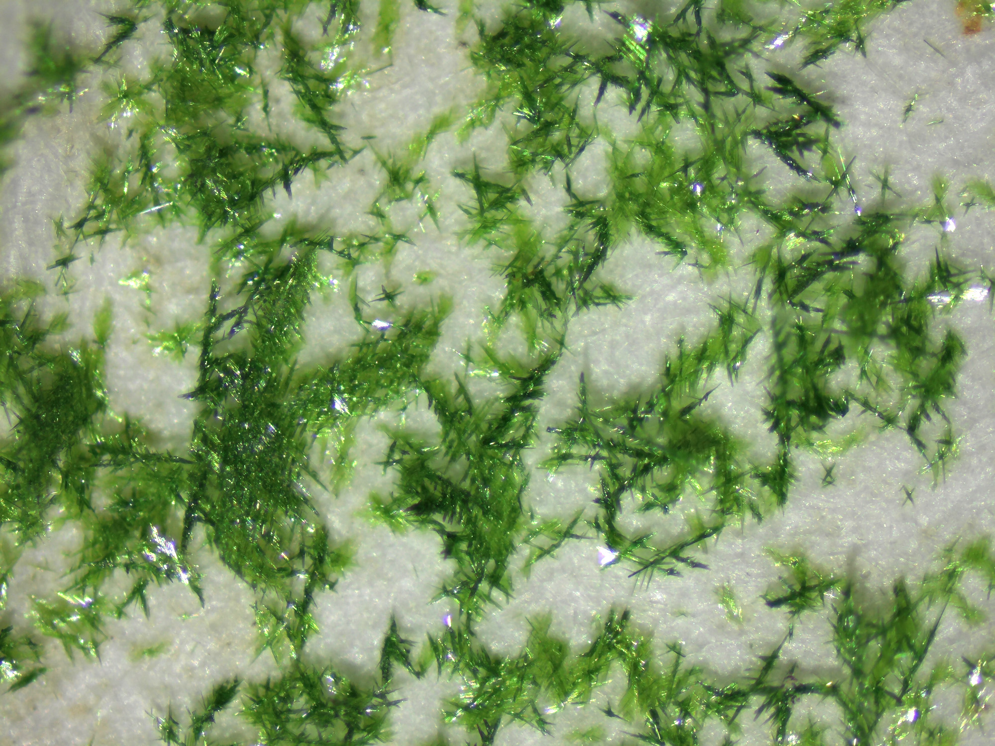

I tried the analytical test for pyridine on my starting material and confirmed that it is a very nice method for detecting pyridine.
Here I used a 10 mM copper solution, 2 eq. of thiocyanate and 2 eq. of pyridine. It's a lovely, rich, dark green, flocculent precipitate. For fun I also recrystallized from hot water after filtration and took some microscope pictures. Enjoy:
CuPy2SCN2_initial_precipitate.jpg - 2.6MB CuPy2SCN2_recryst.jpg - 3.6MB CuPy2SCN2_micro.jpg - 1MB
