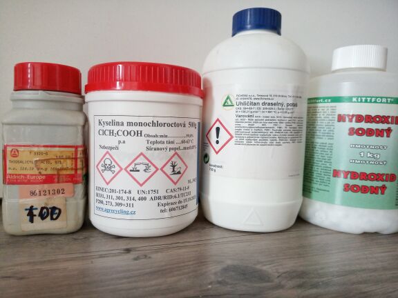

Thiosalicylic acid contains thiol -SH group which is easier to deprotonate than -OH group of phenol. Bases like NaOH, Na2CO3, KOH, K2CO3 etc are used for that. Thiophenolate is then coupled with chloroacetate in which S-C bond is created and chloroacetate loses its Cl. Thiosalicylic acid contains also -COOH group for which extra base is required for creating its salt. A slight 10% excess of monochloroacetic acid was used with a hope to reduce contamination of the product with unreacted thiosalicylic acid which is very poorly soluble in water as the product. The synthesis was done at 0,10 mol scale calculated from thiosalicylic acid.

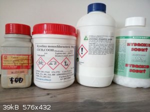

thiosalicylic acid M=154,18 g/mol
NaOH M=40,00 g/mol
chloroacetic acid M=94,49 g/mol
K2CO3 . 1,5 H2O M=165,24 g/mol
Chloroacetic acid 10,4 g 0,11 mol (slight excess), K2CO3 . 1,5 H2O 10,0 g 0,06 mol (slight excess)

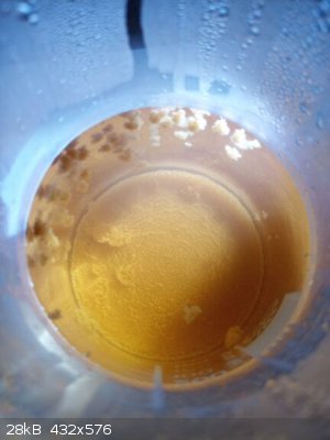

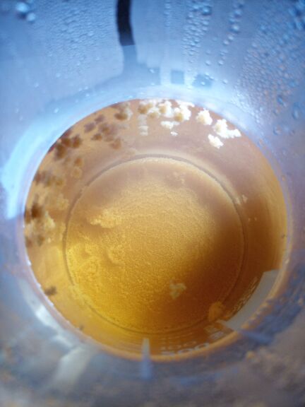

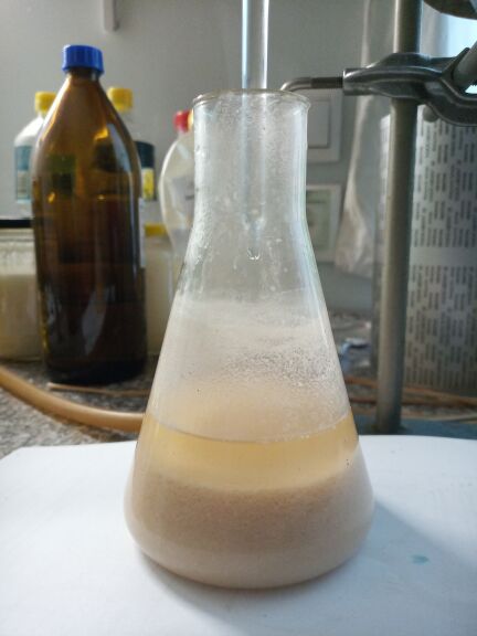

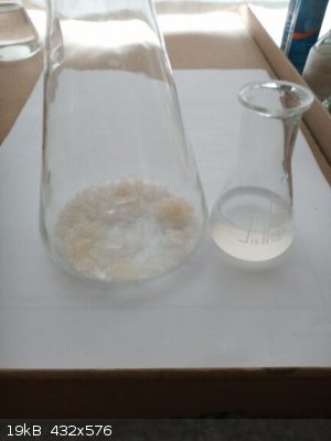

Dissolve 10,0 g K2CO3 . 1,5 H2O (0,060 mol, but it is never pure either completely dry) in 15 ml of water in 25 ml Erlenmeyer flask and add it dropwise to solid 10,4 g monochloroacetic acid (0,11 mol) in 250 ml Erlenmeyer flask while swirling the flask in hand and slightly heating (approx 50 C) until it dissolves and CO2 evolution finishes. Use such big conical flask to reduce loses by droplets of liquid carried out by evolution of CO2 bubbles. Leave few last drops of K2CO3 to be added after neutralization completes and when CO2 evolution finishes to ensure the final solution contains small excess of K2CO3 and that not all the excess is in the form of KHCO3 due to still CO2 evolution / high content of CO2 in the solution. Check the pH with universal indicator paper, it must be slightly alkaline, if not (to much water in K2CO3) add a little more of K2CO3. Second sign that the neutralization is not yet finished is bubbling of CO2 when a drop of K2CO3 solution falls into the reaction mixture, but don't confuse this with natural CO2 evolution from its saturated solution.

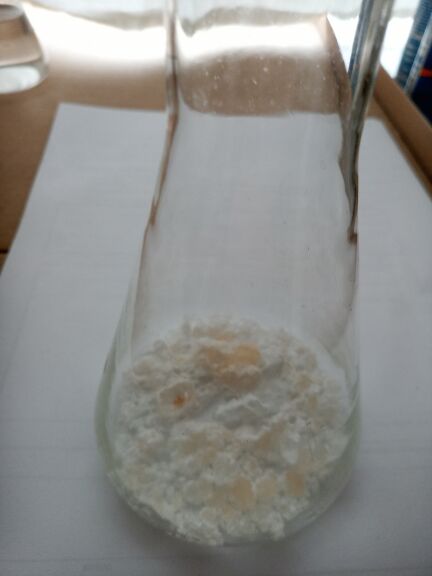

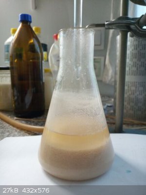

Dissolve 8,0 g (0,20 mol) NaOH in 50 ml of water (exothermic) and add it slowly still hot into suspension of 15,4 g thiosalicylic acid (0,10 mol) in 50 ml of H2O in 250 ml flat bottom flask while swirling the flask in hand. That produces sodium salt from the -COOH acid group and also thiolate salt from the thiol -SH group. The flask could be touched by bare hand as it is only about 30 C warm. Check the pH after the reaction, it must be strongly alkaline. Anyway after that add 1,0 g K2CO3 . 1,5 H2O to ensure slight excess of alkalies (also NaOH is never 100% and always contains some H2O and CO2). Excess of hydroxide was not used as it could dechlorinate chloroacetate, so K2CO3 was used. Also Na2CO3 could be used but I had a lot of K2CO3 at hand.

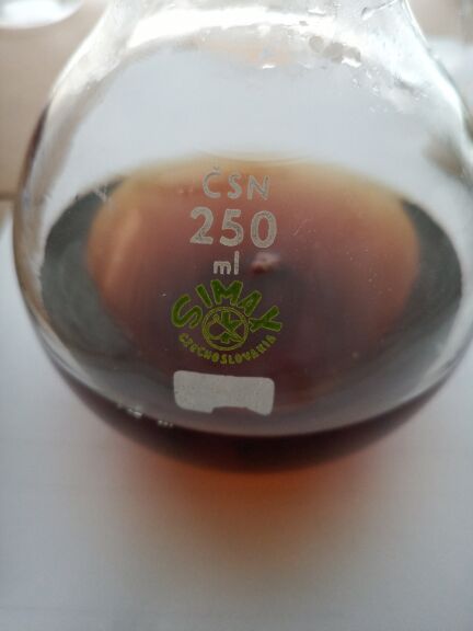

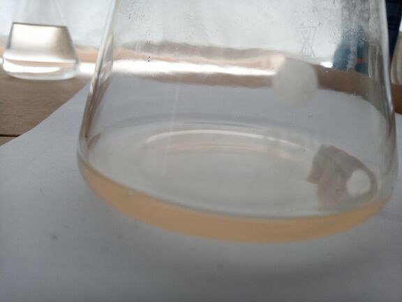

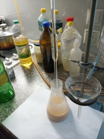

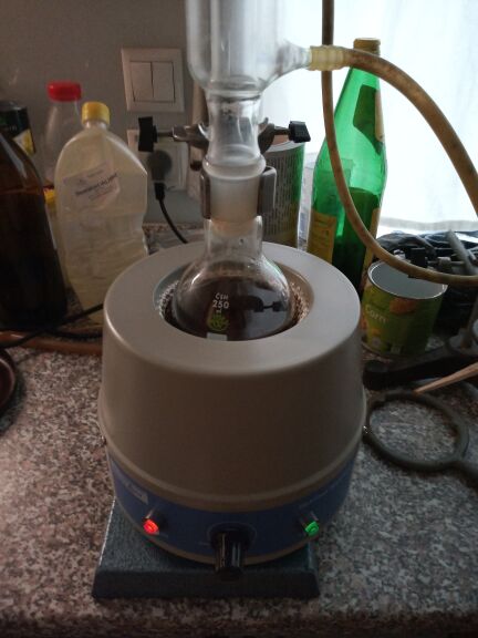

Add slowly the potassium chloroacetate from conical flask into the reaction flat bottom flask with disodium salt of thiosalicylic acid while swirling the flask in hand, add boiling stones (5 glass balls used), attach reflux condenser and reflux for 4 hours. Then add 1,0 g of activated charcoal and reflux for 10 minutes.

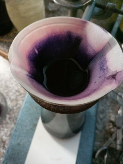

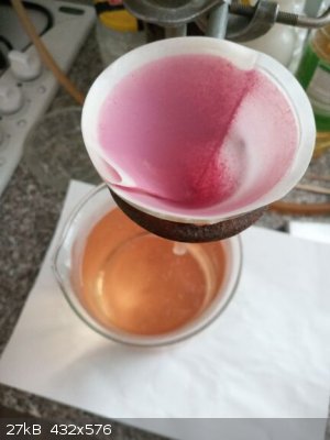

The color changed to violet similar of KMnO4 in water.

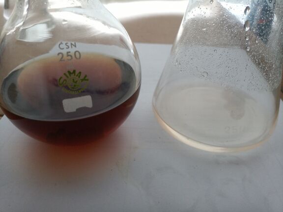

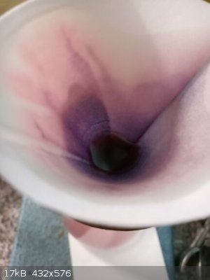

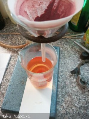

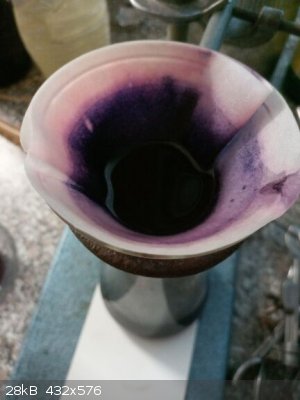

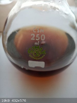

Gravity filter. Solid captured on filter paper had a violet color while filtrate dark red.

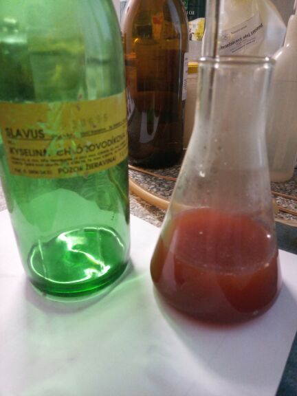

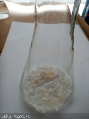

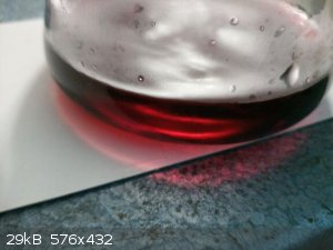

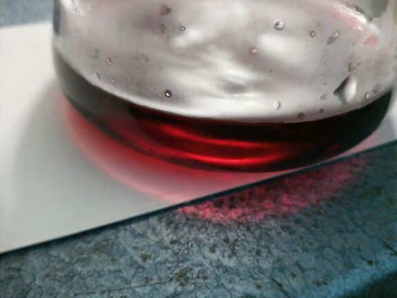

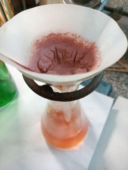

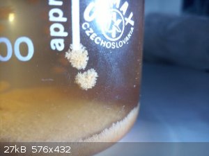

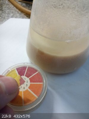

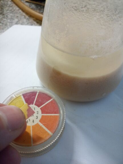

Add dropwise 35 % HCl into the filtrate while stirring, after first 5-6 ml of HCl a precipitate of dark pink solid product observed (??? contamination with S-S dimer of oxidation of thiosalicylic acid similarly as happens in -S-S- bridge in proteins between cysteins ???). Gravity filter out (first crop), wash on filter paper with 2x 10 ml of water, add washings into the filtrate and continue addition of HCl into the filtrate. After 12 ml HCl added totally, the solid product in flask had visibly paler color than the first crop. 22 ml of HCl added totally (0,25 mol, slight excess). Could monosodium salt crystallize first which only later decomposed to dicarboxylic acid??? - because of that risk, boil for few minutes to ensure possible sodium salt decomposition (but the solid did not fully dissolve on boil in circa 200 ml volume).

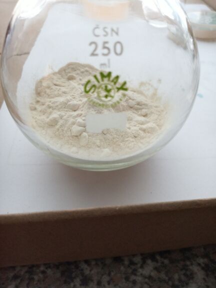

Cool to room temperature in 1 hour and then in fridge for 2 hours at +4 C. Vacuum filter on Buchner funnel, wash with little of cold water on filter paper and suck as dry as possible (second crop).

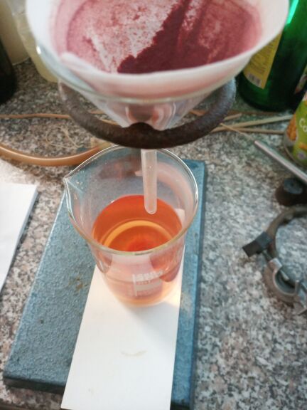

Boil the filtered out dark pink still wet product (first crop) from the addition of first 5-6 ml of HCl with 250 ml of water, quickly gravity filter (it passed filter paper very quickly), acidify with 2 ml of 35% HCl (maybe not necessary??? but that ensures no more monosodium salt present if it was at all) and allow to cool down to room temperature and then in fridge at +4 C. Vacuum filter crystals on Buchner funnel, stop vacuum, wash with little of cold water on filter (+4 C, bottle from fridge), suck with vacuum as dry as possible. Dry in air for 3 days (4,5 g) and then in desiccator over silica gel (4,2 g). Melting point 217-220 C.

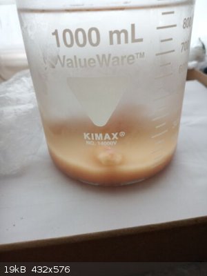

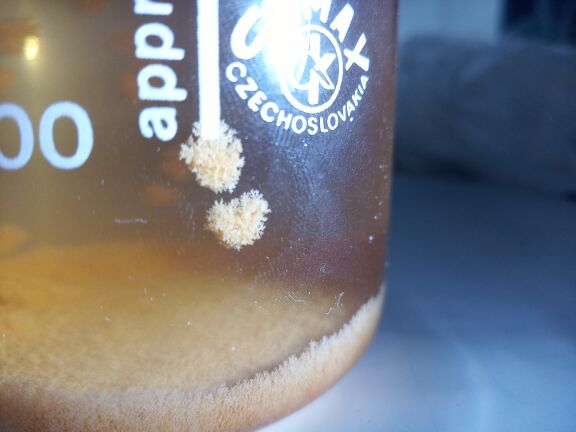

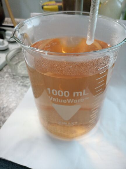

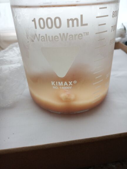

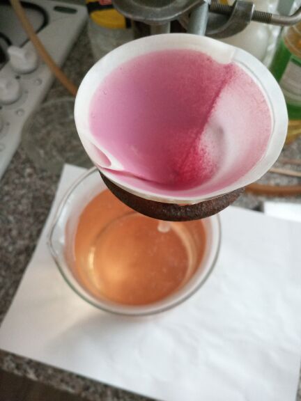

Dry in air the second crop (paler) for 3 days. Weight 13,0 g. Dissolve it in 900 ml of boiling water. Maybe slightly less water could be used 600-750 ml ???, insoluble pink solid confused me so I tried to dissolve it but it didn't.

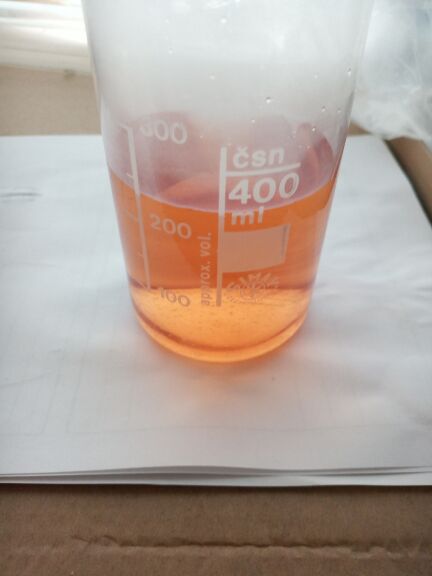

Gravity filter - a little of pink solid side-product stayed on filter paper while filtrate had salmon-orange or peach-orange color (I'm not good in names of colors). Cool slowly to room temperature to crystallize and then in fridge at +4 C. Vacuum filter crystals on Buchner funnel, stop vacuum, wash with little of cold +4 C water on filter, vacuum suck to as dry as possible. Air dry until the weight no more decreases. Weight 11,7 g. Melting point 211-213. Put it finally also into desiccator over silica gel. I will tell you later whether the weight decreased and melting point increased.

reactants

potassium monochloroacetate preparation from monochloroacetic acid and K2CO3
IMG_20220821_173803_5.jpg - 19kB IMG_20220821_173829_3.jpg - 18kB IMG_20220821_175541_5.jpg - 17kB IMG_20220821_175813_8.jpg - 24kB
thiosalicylic acid into solution of disodium salt
IMG_20220821_181248_2.jpg - 22kB IMG_20220821_182240_5.jpg - 19kB IMG_20220821_182811_6.jpg - 27kB
reaction of disodium salt of thiosalicylic acid with potassium monochloroacetate
IMG_20220821_184621_5.jpg - 25kB IMG_20220821_185607_4.jpg - 37kB
filtering the reaction mixture
IMG_20220822_084048_9.jpg - 17kB IMG_20220822_084233_3.jpg - 29kB IMG_20220822_084614_0.jpg - 28kB
partial acidification with first 5-6 ml of HCl - first crop of crude product
IMG_20220822_091836_4.jpg - 29kB IMG_20220822_102416_8.jpg - 27kB
completing the neutralization (22 ml of HCl totally) - much paler product
IMG_20220822_103254_6.jpg - 35kB IMG_20220822_103300_1.jpg - 27kB IMG_20220822_104348_9.jpg - 22kB
crystallization of first crop from water
IMG_20220822_123439_8.jpg - 42kB IMG_20220822_124803_6.jpg - 19kB IMG_20220822_135842_0.jpg - 28kB IMG_20220822_135858_3.jpg - 27kB
crystallization of second crop from water
IMG_20220825_162023_3.jpg - 27kB IMG_20220825_162107_4.jpg - 26kB IMG_20220826_100008_7.jpg - 19kB

I did not reduce the colored byproducts (violet and pink) so I do not know what they were, I just trashed them, the amount was too small so maybe even impossible to get from the fibers of filter paper (I did not even try, maybe they could be dissolved in some solvent or maybe solution of NaOH by washing the filter papers).

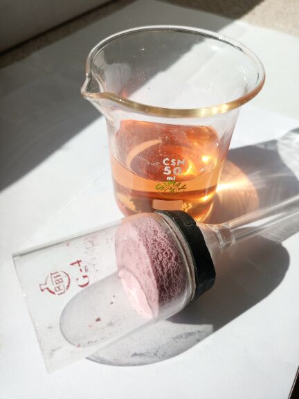

Fery - 23-9-2022 at 01:17

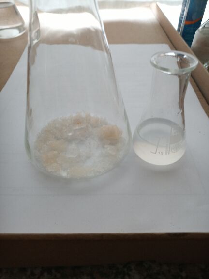

I tried to crystallize the first crop (with that good m.p.) from 85 wt% isopropanol (cca 40-50 ml was enough) by boiling, then cooling to room temperature and finally fridge (+4 C) and I got pinkish product while the mother liquor had the color of the original substance :o
This compound behaves like a chameleon...
IMG_20220923_110432_3.jpg - 28kB
