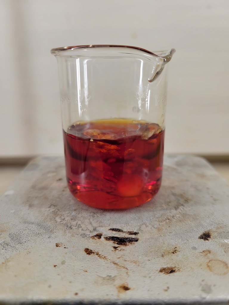

At this point, the reaction mixture was poured into a bowl and let to evaporate down to about 250ml under air flow of the fume hood.
![reaction.jpeg - 121kB](https://www.sciencemadness.org/whisper/files.php?pid=678355&aid=95264)

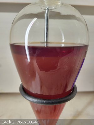

This mixture was then transferred to a 500ml separatory funnel, 150ml of water was added, and then extracted with 5 x 50ml portions of toluene. Some
methanol appeared to carry over.
![sep2.jpeg - 123kB](https://www.sciencemadness.org/whisper/files.php?pid=678355&aid=95268)
![sep4.jpeg - 114kB](https://www.sciencemadness.org/whisper/files.php?pid=678355&aid=95272)
![sep6.jpeg - 163kB](https://www.sciencemadness.org/whisper/files.php?pid=678355&aid=95276)

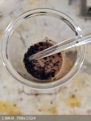

Once the volume of solvent had been considerably reduced, the remaining extract was placed in a 100ml flask, remaining solvent stripped, and then the
4-methoxyphenol was vacuum distilled over. A heat gun was used at times to aid the migration of the phenol along the condenser.
![vac_dis2.jpeg - 2.6MB](https://www.sciencemadness.org/whisper/files.php?pid=678355&aid=95286)
Crude product.

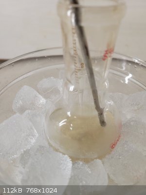

![vac_dis3.jpeg - 159kB](https://www.sciencemadness.org/whisper/files.php?pid=678355&aid=95288)

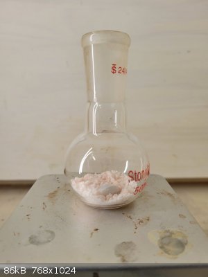

The crude product was recrystallized from heptane and toluene (roughly 1:3). Multiple stints in the freezer with some evaporation of the solvent
mixture was required to get the remaining phenol out after the first crop of crystals.
![final_product.jpeg - 254kB](https://www.sciencemadness.org/whisper/files.php?pid=678355&aid=95290)
Final yield was 32g of 4-methoxyphenol (51.6%). MP was measured to be 48°C-52°C (Lit 52.5°C).

Acetaminophen was added to a 50ml boiling flask and dissolved in 30ml of methanol. Then, sulfuric acid was added and the flask was put in an ice bath
and cooled to ~2°C. Sodium nitrite dissolved in 3.2ml H2O was added using a dropper at such a rate that the temperature never exceeded
4°C (~15m). ~5-10ml methanol were used to rinse the beaker which had the sodium nitrite/water solution. A precipitate of sodium sulfate immediately
formed at the beginning of addition and thickened considerably by the end. The mixture was then allowed to stir for 1h. Color through this time went
from light pink, to light tan, then darker brown, and finally almost green towards the end.

The filtrate was then reduced to 1/3 volume, added to a separatory funnel, diluted with 100ml H2O, and extracted with 3 portions of 15ml
DCM. A black tarry layer formed above the DCM and remained in the aqueous phase. Solvent was then removed by boiling from the pooled extracts, but
only a minuscule amount of a dark red oily substance remained. An attempt was made to further purify it by boiling it in n-heptane and decanting;
nothing but more tar and interesting shades of red happened. The tar from the aqueous layer was also filtered off and some extraction attempts were
made on it, but nothing of note came of this.
