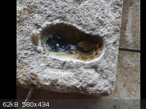

Hi ya Chemist1357 I'm also in Oz (WA) and while I can't supply any Na, I have had fun producing the metal in maybe just less than gram quantities from pretty ordinary materials. Two photos show the initial set up, cheap expanded silica blocks from Bunnings which I drilled two overlapping ~3cm holes and emplaced steel electrodes. Into these I poured NaOH, melted it with a torch (benzomatic type) and started DC current (car battery). Once current started the torch wasn't needed and the electrolysis was quite violent (sodium/ hydrogen explosions). I expect an inert environment would have helped.., and perhaps a clever membrane set up. The second photo shows abundant molten Na globules that could easily be separated via small metal gauze scoop. This could be re-engineered for efficiency. Note I did change the electrode configuration a bit in the second photo, to keep the products of reaction away from each other (less molten sodium explosions).
cheers, Anton
