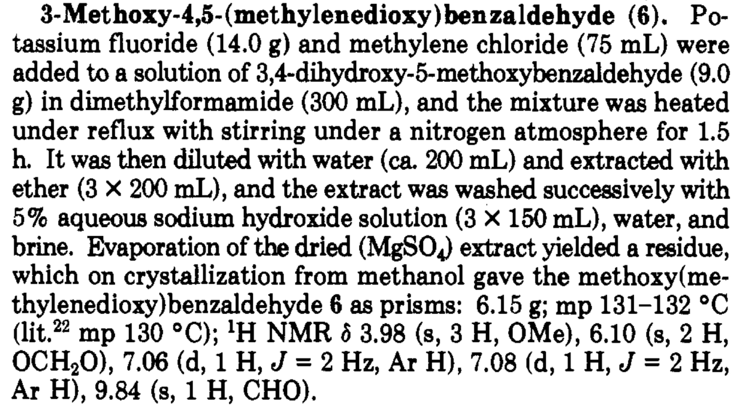

Niklas - 2-10-2024 at 07:25
Thanks Boffis!
I’ve thought about that as well, tho I never came to a conclusion that fully satisfied me. Most of the really good OTC formylation approaches (particularly Duff reaction) are unfortunately ortho-directing, and the alternative of doing a two-step approach via the Blanc-reaction followed by Kornblum-oxidation (something similar should be documented on Erowid iirc), comes with the significant downside of forming highly carcinogenic BCME as a byproduct in the first step..
IMG_7515.jpeg - 123kB
Additionally I‘m really not sure about the accessibility of catechol for the average amateur. I know it is occasionally found in oxygen absorption packs, but I feel like that’s a really expensive way of getting a reagent..
Like sure, I could personally use my catechol bought at Sigma and formylate that with my TCT / DMF purchased from TCI, but that feels like defeating the purpose of publishing it here.

Haven‘t yet had the time to continue with figuring out this synthesis, but while browsing Lamdasyn I came across a mention of a procedure making myristic aldehyde from 5-hydroxyvanillin by the reaction with DCM in DMF with simple KF catalysis in a reasonably impressive 63,4% considering it used neither nucleophilic nor phase-transfer catalysis.
IMG_8859.jpeg - 746kB
So I guess KF may be a lot more suitable than K2CO3 for the Williamson ether synthesis using bad electrophiles like DCM.
