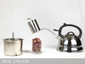

RU_KLO - 29-12-2024 at 05:33
Maybe a stainless steel kettle?
With the "nose" conected to a stainless steel tube, aided with forced ventilation - ex: 12v pc fan, several...) or inside a bigger tube - like homemade condenser.
(it seem that stainless steel in used in professional destilation setups)
also found an commercial example: (check picture)
kettle.jpg - 20kB

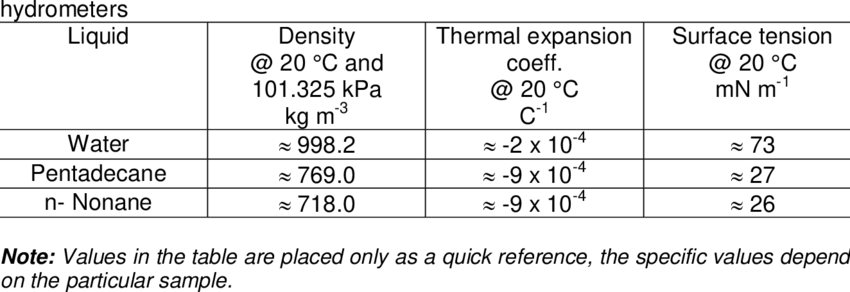

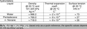

RU_KLO - 30-12-2024 at 11:17
found this, maybe you can get other calibration liquid.
Attachment: 20160215HYDROMEnglish.pdf (1.9MB)
This file has been downloaded 202 times
Liquids-commonly-used-as-density-standard-in-the-calibration-of.png - 37kB
