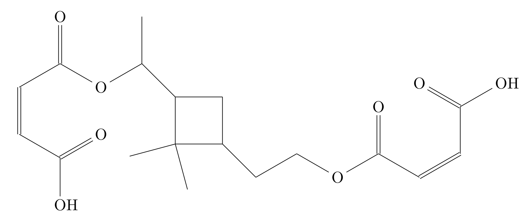

pinodiol.png - 33kB
and the corresponding crosslinker:
pinodioldimal.png - 83kB
This is a little heavier than the dipropylene glycol version, but it is highly branched, so hopefully it is also a liquid.
