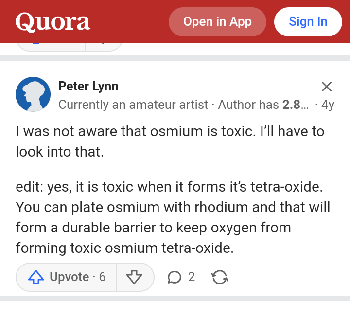

Radiums Lab - 18-4-2025 at 08:43
Here is a clip of one of the post made by a quora user who says it's toxic:
Screenshot_2025-04-18-22-09-23.png - 83kB
There are many posts like this on the internet.

DraconicAcid - 18-4-2025 at 08:54
I still have nightmares about the stench of osmium compounds.

bnull - 18-4-2025 at 10:43
As far as I know, osmium metal only reacts with oxygen at very high temperatures forming osmium tetroxide but I want some clarity and confirmation about it.
Not exactly. It forms tetroxide at room temperature, but the rate at which it happens depends on the surface area: basically, the powder stinks and the bulk solid does not.
Bretherick's lists nothing on metallic osmium except the incompatibility with chlorine, fluorine, and phosphorus. The osmium entry in Sax's Dangerous Properties says that osmium "gives off a pungent, poisonous fume of osmium tetroxide" when heated but the "metal itself is not highly toxic," which for me is the equivalent of "having an Alsatian is safe, unless you piss it off." A review on the toxic properties of osmium tetroxide (https://pmc.ncbi.nlm.nih.gov/articles/PMC1035752/) says that the metal itself is innocuous.
Unless you're sweating halogens or phosphorus (I don't think so), the solid metal is innocuous. Don't heat the metal and don't perform experiments wearing it. I wouldn't keep it in contact with my skin for prolonged periods but that's overcautious me.

Radiums Lab - 18-4-2025 at 12:33
@DraconicAcid I Totally agree that you want to emphasize the toxicity of osmium but comparing a noble metal with a fairly reactive is not a good thing.
I agree that osmium tetroxide is formed when exposed to high temperatures, but still not getting why noble metals (finely divided) like Osmium would react with Oxygen at room temperature it doesn't make sense. People find osmium(while mining) in Crystal state or granular state but they never complained about dealing with chlorine like smell.
I know that osmium's concentration is too low in earths crust but there are places where you can find a lot of osmium crystals, places like meteorite impact zones have been reported to contain a fairly high concentrations Os than ur typical soil.

bnull - 18-4-2025 at 15:46
It makes perfect sense. You just need some basic facts to see why and how it does work (meaning thermodynamic calculations and a little visualization). The process is similar to combustion, there's no new science here.
Radiums Lab - 18-4-2025 at 19:37
@bnull thank you for pointing out that Gibbs free energy value is negative (reaction is feasible at room temperature).
Oh, since is elegant indeed.
Here are some conclusions.
- Osmium does react with air to form OsO4, but it is too slow and happens in minimal quantity to pose any threat at all.
- Finer powder = faster reaction (larger surface area).
- No one is going to wear a ring made out of finely divided Os(try to wear one or make one if possible).
- After some digging, some researchers have told that even the powder take decades or centuries to react in noticable quantity.
- So, it is safe to say we can wear a ring made up of bulk osmium metal.
[Edited on 19-4-2025 by Radiums Lab]
