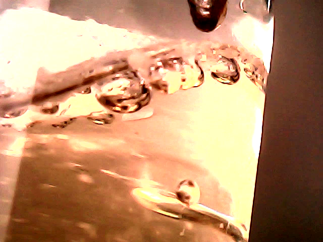

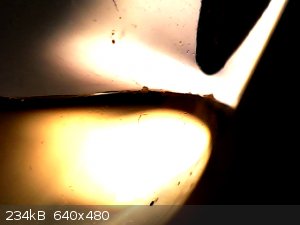

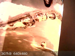

First picture, 102 [°C] at bottom of tube, roughly 75[°C] where graphite electrode is.
vlcsnap-2025-12-12-16h41m40s542.png - 191kB
Second picture, slightly different lighting, same tube with a few milli amps of current flowing through 6 washers. Hydrogen/oxygen bubbles are visible.
vlcsnap-2025-12-12-16h51m50s140.png - 239kB
After scratching off the graphite electrode, it immediately plated again with a thin grey coating.
I'm running AC current for a while to see if I can get more ions into solution while removing hydrogen and oxygen...
The solution is slowly becoming less colloidal and more of a clear brown liquid.
The colloid precipitated onto the washers in the background, and you can see some of it piled up on the side of the graphite electrode.
Parts of the graphite electrode, which were not scratched clean, did not plate after re-inserting into the solution. Mostly on the left side near the tip you can see darker color material.

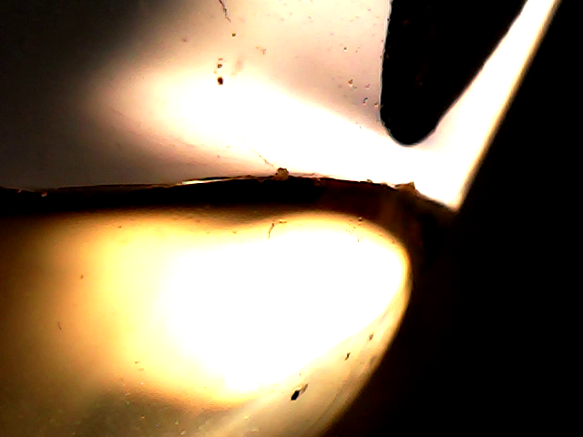

vlcsnap-2025-12-23-11h58m04s361.png - 350kB
Began heating between 70 and 85 [°C]. I turned down heat to stop boiling and paid close attention to any smells. There were no sulfur smells. It just smells slightly like ethyl alcohol.
vlcsnap-2025-12-23-12h08m17s459.png - 397kB
After running for about four hours, grey colored colloids began to circulate in the fluid. Black oxides stuck to test tube wall from the washer (steel anode) stack. Then color began to lighten, with some yellowish looking color forming on steel.
All brief color changes went away, and the solution converted to a very dark olive green after 8 hours. Green colloidal material settles out easily onto electrodes and tends to stick. WIth time it gets finer, and looser (less sticky).
vlcsnap-2025-12-23-19h09m50s494.png - 327kB
I will let this run a few days over Christmas and we'll see what happens.

I added 1/2 cc of ethanol to bring the polar liquid volume back up to about 4cc. Because of variability of liquid volumes after miscing, I am not sure how much ethanol is actually in solution any-more. I'm just attempting to maintain a constant volume and compare conductivity trends.
The color has remained a dark olive green. Over the last two days I have had small amounts of black material build up on the graphite electrode (-). I've cleaned it off. The majority of white and olive-green salt falls to the bottom of the test tube.
Each time I add ethanol, the temperature at which the bottom of the test tube forms boiling bubbles has dropped. Less material stays settled at the bottom of the test tube. I was able to run the test tube at 110 [°C] two days ago without boiling, but today I'm down to 80 [°C]. Pure ethanol according to literature boils at 78.3 [°C].
On the other hand, the conductivity of the solution has slowly risen in spite of the boiling point lowering.
I am running AC current, around 10 [mA] with a D.C. bias of maybe 1 or 2 milli amps.
This should cause fast and reversible chemical reactions to remain in solution, while more permanent or slower reactions will become electrode coatings (and I will clean them off).
Over time, I am hoping this will maximize conductivity of the solution by eliminating more stable oxides and traces of water. ( But I could be wrong. )
vlcsnap-2025-12-29-14h16m20s757.png - 238kB
Note: Rechecked it an hour after adding 1/2 [cm³] denatured ethanol.
Result, the bottom of the test tube is still olive green colored with white+green precipitate. But the top 3 [cm] of the tube is now browner shade.
I assume this is because introducing new moisture comes with introduction of alcohol.
For scale: I lost an eyelash into the test tube while scraping off the graphite electrode (- biased electrode ). The electrode itself is 0.9 [mm] wide. The view is highly magnified, with the glass test-tube oriented at 45 [degrees] to gravity. The top of the picture is level with the ground. Bubbles tend to leave the graphite electrode at a 45 degree angle, this way, and I'm able to tell how much gas comes from each part of the electrode.
In general, this is where hydrogen gas likes to form.
I should be breaking down water and ethanol at both the anode and cathode.
[Edited on 29-12-2025 by semiconductive]

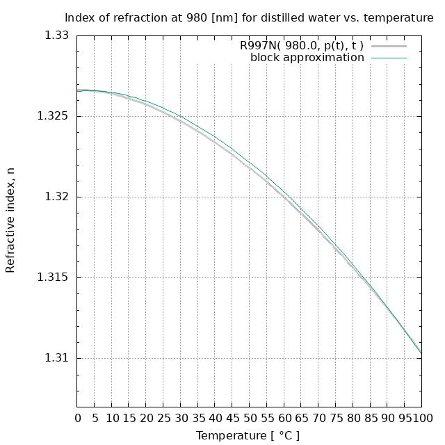

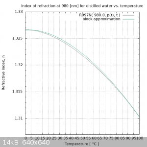

Hmm. I need to be able to re-do this derivation with alcohols, and I need it to be simple.
The NIST models are too complicated for hand computing without an online calculator. I'll work out a restricted standard conditions case, here.
I pretty much just need to know the refraction properties of liquid (water, alcohol) at 1 [bar] pressure for my own experiments.
I also need to verify what the density of water is over the full temperature range, and not just 5 degrees to 40 degrees Celsius.
I can get high quality data for index of refraction in water from multiple sites.
Therefore, I'll test out a theory out about how the index of refraction changes vs. temperature.
Using just the index of refraction data (mostly appendix info) from:
https://www.researchgate.net/publication/252888306_Water_ref...
And from NIST:
https://srd.nist.gov/jpcrdreprint/1.555859.pdf
I hypothesize:
Index of refraction is nearly constant after dividing out optical path length changes that are caused by water density. Eg: the delay in light travel time is directly proportional to the number of molecules that are encountered independently of empty space traveled through. Therefore, I suspect that the primary systematic error in measuring refraction experiments ( AFTER volume phenomena are removed/compensated for) will be inaccuracies in temperature.
That means, if I normalize the index of refraction for a color passing through water , by dividing by the index of refraction of a specific color, eg: 589.32 [nm] light at the same temperature, the implicit volume changes get canceled out because both refractions values have the same volume/density of water.
But: Slight errors in temperature or in-homogeneity of water mixing, will result in linear slope errors. IF this is the case, then dividing the index of refraction of light by another refraction index of light of a different color will leave gently sloped lines that indicate temperature mismatches/errors and other linear energy change errors.
*These errors should be easy to spot in replications of the same experiment by different authors.*
pngsnap.png - 14kB
YES! The plot looks very linear, as expected!
The straight line least squares fits are:
1.04533 -18.8847·10⁻⁶ · (t-25) @ 226.5 [nm]
1.01131 -3.69776·10⁻⁶ · (t-25) @ 361.05 [nm]
1.00771-2.02039·10⁻⁶ · (t-25) @ 404.41 [nm]
1.00751-8.29188·10⁻⁶ · (t-25) @ 404.66 [nm]
1.00039+1.69418·10⁻⁶ · (t-25) @ 589 [nm]
1.0 @ 589.32 [nm]
0.997912-2.23743·10⁻⁶ · (t-25) @ 706.52 [nm]
0.994315+6.72551·10⁻⁶ · (t-25) @ 1013.98 [nm]
0.957622+37.0681·10⁻⁶ · (t-25) @ 2325.42 [nm]
The standard reference for 589.32 [nm] light at 25[°C] and 1[bar] is n=1.3325
Therefore, my linear fits predict at 25[°C], 1 [bar], vs. "simple approximation", vs. NIST's recommended fit.
n= 1.3929 @ 226.5 [nm] vs. 1.3230 vs. 1.3925
n= 1.3476 @ 361.05 [nm] vs. 1.3441 vs. 1.3474
n= 1.3428 @ 404.41 [nm] vs. 1.3415 vs. 1.3426
n= 1.3425 @ 404.66 [nm] vs. 1.3415 vs. 1.3426
n= 1.3330 @ 589 [nm] vs. 1.3322 vs. 1.3328
n= 1.3297 @ 706.52 [nm] vs. 1.3288 vs. 1.3299
n= 1.3249 @ 1013.98 [nm] vs. 1.3242 vs. 1.3248
n= 1.2760 @ 2325.42 [nm] vs. 1.3204 vs. 1.2758
The simple approximation is close everywhere except the two extreme wavelengths.
But: The NIST equation, #7, although accurate for my data set -- doesn't even reproduce the first wavelength between the values listed in the NIST tables for 20 to 30 degrees of wavelength .36105 micron in it's own document. The author has tables that aren't computed by the formula he publishes ?
To represent standard laboratory conditions at 25[°C], (1 bar pressure) I set:
T=298.15; T₀=273.15
ρ=997; ρ₀=1000
λ=361.05; λ₀=589.0
Using Table 4 in the document for full range optimized variables, I compute with equation (7):
n = 1.3474
Using the different coefficients in the Appendix, I still compute,
n = 1.3474
This value is not between n=1.39336 at [20°C] and 1.39208 at [30°C] on page 704 in the 0.1 Mpa pressure column. (1 bar).
I really ought to use experimental data, first... But now comes another problem.... index of refraction values at standard temperature and pressure are contradicted by different published sources:
Kudos, Philiplaven, for pointing this out!
http://www.philiplaven.com/p20.html
Note: My estimated values are at close to IAPWS & Lynch & Livingston's.
Alternately, I thought I could use Wikipedia's tables:
https://en.wikipedia.org/wiki/Optical_properties_of_water_an...
But my values substantially disagree. (Jan 2026)
What a nightmare! This is basic science.
Curve fits are fickle....
pngsnap.png - 28kB

And, it's pretty obvious that the ITS-90 standard/Kell equation is not very good outside of the 5 to 40 degree Celsius range. At 90 [°C], the Kell equation is 0.9620 [ g/cm³ ]. My Gladstone-Dale redacted water density is of about 0.9656 [ g/cm³ ] at 90 [°C].
For the Kell equation to be correct, the experiment's thermometer would be in error by a full 4.2 [°C]. That's extremely unlikely!
eg: AI's telling us that KELL is the most accurate fit, is misleading.
Kell is only the best fit over part of water's liquid temperature range.
IAPWS, for industrial standard -- shows 0.96531 [ g/cm³ ] -- at 90 [°C]. Therefore, even the supposedly less accurate "industrial standard" is closer to scientific experiments than Kell at 90 [°C].
Well, I learned something. ITS-90/Kell water density polynomials are not sufficient for general chemistry. Ouch.

semiconductive - 18-1-2026 at 22:09
The last test tube turned completely black over time.
I'm curious if it's the citric acid that makes a black chelate in alcohol.
There's a few percent water in normal ethanol. I think that's what is making the rust in the first place. So, I'm going to see if I can get it to precipitate out with glucose. Glucose supposedly can sequester and/or chelate iron oxides. Glucose isn't very soluble in ethanol to begin with, so I think maybe saturating the solution with sodium metabisulfite and glucose will precipitate out the orange/black oxides while water is being broken down.
1 CC -- ethanol (Fuel grade).
3 CC -- tri-ethyl-citrate ( An inert diluent. )
1 CC -- kerosene ( To float on top and keep air/moisture out. )
The anode from the last experiment had a little black oxide on it, which I didn't bother to clean off. I added 19 fresh steel washers in a spaced stack to make a lot of surface area.
The bottom of the test tube is held at 80 [°C].
Glucose ~50 [mg]. ( Tiny dusting. )
Sodium Meta-Bisulfite -- enough to where it stops dissolving and leaves 1/3 cc volume of crystals in bottom of test tube.
Glucose initially out-gassed while dissolving in 1CC ethanol. Colloidal glucose crystals can be seen dispersed in the solution, not fully dissolved.
Rust dissolved off the anode and turned solution a faint orange, initially.
The current level is very low, 50 [μA] x 18 plates ≤ 1 [mA].
Hydrogen can be seen bubbling off the cathode, slowly, after 24 hours.
vlcsnap-2026-01-18-22h01m07s544.png - 281kB
The solution has gone from orange to yellow, and is clarifying slowly. Edit: initially, there is precipitation of brown stuff into the sodium meta-bisulfite, but it saturates after about 12 hours. The clarification might never complete. I would have to centerfuge it, to remove colloids, and add more glucose to definitely precipitate all oxides.
I'm hoping that the fact that it isn't turning black (yet), means that the dark color of the last experiment may have been caused by lithium citrate in the presence of moisture.
Glucose has an aldehyde bond on the end, but otherwise is alcohol like. I don't expect it to turn black. Hopefully, glucose will help retain ethanol in the tube at higher temperatures.
Edit: I wiped off the graphite electrode this morning after noticing that it was heavily bubbling hydrogen even though the current level hadn't changed since last night. After putting it back in , no bubbles formed immediately. Then slowly gas began building up and bubbling faster over a period of hours. There's obviously something (probably glucose) building up on the surface of the electrode that reacts to release gas.
Since I see no gas forming at the bottom anode of the 18 washer/plate stack, I decided to raise the temperature of the test tube until I could see one or two tiny bubbles form a minute at the bottom. The test tube bottom is now held at 105 [°C] and the kerosene on top is 30 [°C]. Extra heat at the bottom of the test tube is not significantly changing the gas production rate at the anode.
: Speculation :
This temperature is above the boiling point of ethanol at the bottom of the test tube, but since the top of the test tube is way below the boiling point of ethanol; I expect the washer stack to act like a distillation column and re-condense ethanol before it evaportates.
Edit: 6 Hours of 105 [°C], and I've lost roughly 0.1 [cc] of liquid. The test tube is making bumping sounds. I turned heat down to 101 [°C]. It's still bubbling from the bottom, but it's quiet now.
After adding back 0.1 [cc] of ethanol, the current jumped up to 200 [μA], 200x18 plates ≈ 3.6 [mA] chemical oxidation and reduction activity.
That's a reasonable level of current.
Edit: Had to lower temperature again, 95 [°C]. When I did so, glucose fell out of solution rapidly leaving colorless liquid with small orange floating specs. Allowed liquid to settle in a transfer pipette, and ejected brown/orange sludge into trash. Added fresh glucose and Sodium meta-bisulfite, shook, waited for it to settle and then decanted off the liquid. Now I have clear liquid with white floating glucose specs.
Current level was un-affected by cleaning, and even by sanding the washers lightly.
I added another 0.1 [ml] of ethanol, and current only rose 20 [μA] AKA 5%.
I then decided to experiment with other alcohols.
I added 3 drops of 1,3 propanol. Current level only rose another 20 [μA] over an hour then stopped rising.
I added 3 drops of glycerol, Current level rose only 10 [μA] over another hour and then stopped rising. Glycerol was not entirely dissolving and left a whitish layer on the anode. I mixed it in, and then noticed more bubbling on cathode with a little bit of shiny material depositing (probably glycerine). I waited another hour, no current change.
I added 3 drops of methanol. Current level went from 225 [μA] to 475 [μA], 211% increase. Gas bubbling out over doubled.
See picture:
vlcsnap-2026-01-19-18h33m04s407.png - 277kB
The yellow that you see is a stained Nylon standoff. The actual fluid, is not colored, but has small floating white specs in it. I probably need to get a micro-filter that can do a test tubes worth of liquid. Decanting isn't very effective.
The glucose worked far better than I expected. :)

semiconductive - 20-1-2026 at 12:25
Re-run of experiment without glucose, in AC current mode, to get a better idea of the side reaction happening with 1,2,3-propanol.
There is a DC bias current that I measure, but note the major current is an un-measured symmetrical AC current. This combination of currents is to make reaction speeds more visible on the steel washers since the bottom side of each washer acts as an cathode more often/longer than it acts as an anode.
Note: My plastic droppers drip about 25 drops of water to reach 1 [cc].
It won't be exact for alcohol...
1 [cm³] 1,2,3-propanol 98% Duda-Energy™
3 [cm³] ethyl-citrate reagent grade
~100 [mg] Na-metabisulfite reagant grade
Initial current was a pathetic, 2 [μA]. The PP-ol was all sunk to the bottom, happily dissolving the metabisulfite.
I added 3 drops of methanol to see if I could get it to misc, better. The current went up to 200 [μA] just like the last experiment. But, then current began fading. A lot of gas was being generated.
I could have used ethanol, next, but I wanted something that would misc better with ethyl-citrate than with glycerol and act sort of like a soap.
I chose iso-amyl alcohol. 3 drops.
Current went back up to 175 [μA] but began dropping a bit slower than with methanol. So I added another 6 drops. It held on for a half hour before starting to drop back down.
So, I opted to put three more drops of methanol in, and the current went way up to 550 [μA]. After seeing it was stable, I polished the steel electrodes with sandpaper, mixed the solution well and added another 6 drops of methanol. Current rose to 800 [μA] and started climbing. (!! I went to bed !! )
vlcsnap-2026-01-20-12h10m59s755.png - 316kB
This morning the characteristic ?glycerol? side-reaction deposit showed up only on the final steel electrode. ( Most cathodic voltage )
Black oxide-like deposits built up uniformly on the bottom side of all other washers, with no significant glycerol side product. This suggests that either water or glycerine makes a black iron when being reduced/deposited.
Discussion:
The current level is pretty much back to what it was after adding iso-amyl alcohol.
Since this is an AC experiment, I expect ions ought to be building up in solution with any slower side-reactions remaining on the washers.
But, the current levels suggest that hardly any extra ions exists now.
I think this means that the methanol is being consumed and probably turned into a gas or an inert liquid.
pngsnap.png - 35kB

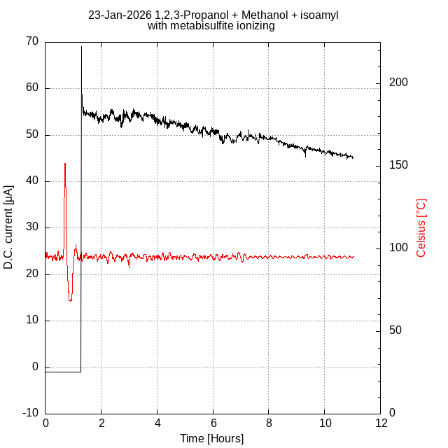

See where the Plot thickens:
pngsnap.png - 29kB
I'll smell it again in the morning.

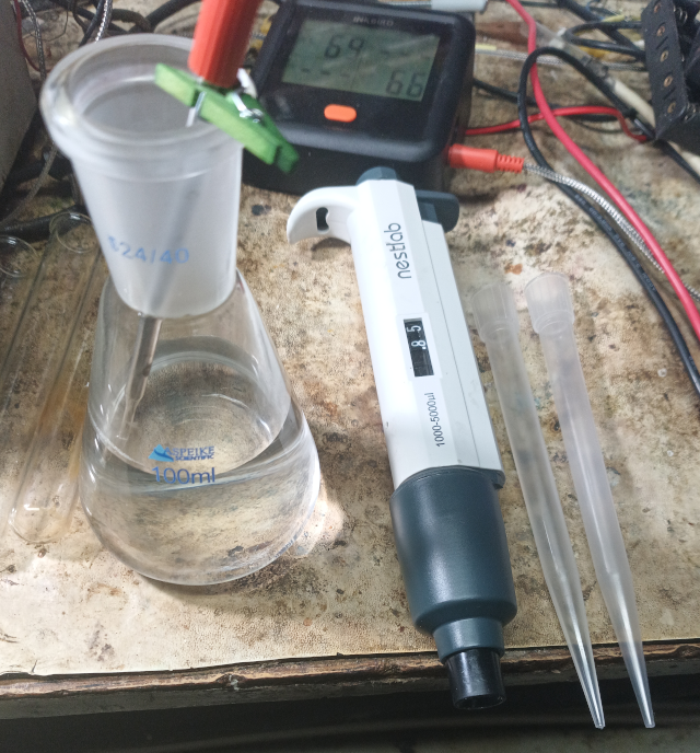

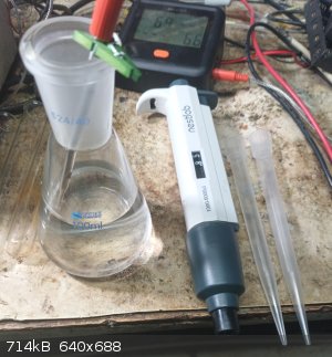

So, Let's see what I can do with density. I have bought a NEST lab pipette that transfers by using suction into a plastic tube. This isn't a highly accurate (or expensive) device, but I'm hoping it will last more than five uses which is all the disposable ones seem to handle before the plastic cracks.
I have a 1.000 to 5.000 [cm³] NEST device, and I bought two of them. If I can accurately measure 1 [cm³] of glycerol, then I might be able to figure out how much water there is from the mass.
Let's test with water first, which is more troublesome (vapor pressure is higher).
I'll set the NEST device to 1.000 [cm³]. Put 100 [mL] of reverse osmosis water in an Erlenmeyer in the microwave, and bring it to boiling.
Now I'll transfer water five times, into a weighed and tared test-tube.
!That didn't go well!
The erlenmeyer cooled down to 40 [°C] before the pipette was ready and assembled to use. I got between four and 5 samples before the water changed by two degrees [°C].
I had to learn not to push the button all the way down, but only to the point where it meets spring resistance. Otherwise it jams.
Note: The temperature recorded is the start temperature of the sampling:
Code:
T= 40.1 [°C] x̅= 1.186 σ= 0.044 [g] μ₀= 1.190 σ₀= 0.045 [g] 3.741% T= 34.9 [°C] x̅= 1.183 σ= 0.016 [g] μ₀= 1.185 σ₀= 0.016 [g] 1.346% T= 30.1 [°C] x̅= 1.176 σ= 0.012 [g] μ₀= 1.178 σ₀= 0.012 [g] 1.032% T= 25.1 [°C] x̅= 1.162 σ= 0.015 [g] μ₀= 1.164 σ₀= 0.015 [g] 1.326%
I got too much water each time and lots of variance. I'm not very consistent/steady at pipetting.
Let's try again!
I'll turn the dial down to 0.800 [cm³].
This time I'm aiming for 10 samples at each temperature.
I'll take the tip off, shake it out, and let fresh air in between every temperature run in order to make sure no water gets up into the suction chamber itself.
Code:
T= 70.0 [°C] x̅= 0.972 σ= 0.094 [g] μ₀= 0.988 σ₀= 0.096 [g] 9.703% T= 60.0 [°C] x̅= 0.985 σ= 0.030 [g] μ₀= 0.988 σ₀= 0.030 [g] 3.005% T= 50.0 [°C] x̅= 0.974 σ= 0.018 [g] μ₀= 0.976 σ₀= 0.018 [g] 1.893% T= 40.0 [°C] x̅= 0.963 σ= 0.019 [g] μ₀= 0.966 σ₀= 0.019 [g] 1.945% T= 40.0 [°C] x̅= 0.970 σ= 0.008 [g] μ₀= 0.971 σ₀= 0.008 [g] 0.781% T= 37.0 [°C] x̅= 0.961 σ= 0.013 [g] μ₀= 0.962 σ₀= 0.013 [g] 1.330% T= 35.0 [°C] x̅= 0.960 σ= 0.004 [g] μ₀= 0.960 σ₀= 0.004 [g] 0.368% T= 30.0 [°C] x̅= 0.965 σ= 0.006 [g] μ₀= 0.966 σ₀= 0.006 [g] 0.576% T= 25.0 [°C] x̅= 0.964 σ= 0.014 [g] μ₀= 0.964 σ₀= 0.014 [g] 1.492%
i took >90 samples, and the pipette is still working. Good enough.
I've computed the experimental statistics twice, first with standard math AKA: a Root of mean-squares algorithm; and second with math designed to estimate the mean of a population from a "Gaussian" sample, better. I take the square of a rooted mean.
I see I'm getting some decent repeatability ( sigma is small ) .... I just need more practice.
Uh... Wait... Water density goes down (less mass/volume) with higher temperature, doesn't it ?
I think this is what I'm supposed to be getting:
https://www.novabiomedical.com/education-training/knowledge-...
?! I get the opposite result !?
[Edited on 24-1-2026 by semiconductive]
semiconductive - 25-1-2026 at 21:36
If my Reverse osmosis water filter is expired, then I get some calcium through it in addition to CO₂ gas forming carbonic acid. But I expect briefly boiling would precipitate any calcium out -- so I think the water's volume vs. NIST specifications ought to be correct because I brought the water to a boil before hand.
If this pipette really is backward, then I suppose I could put pieces of nylon inside the pipette tip until I reduce the volume just enough that air expansion and temperature cancel out.
I can also put nylon washers under the depressor to stop it in the spring area at a repeatable spot. The only annoying weakness of this device is that the volume is set by spinning the depressor. It's not stiff enough to prevent me from accidentally changing it's volume setting when trying to rapidly use it.
Am I overlooking something?
Thoughts?

In order to get the PP-ol to discolor at all, I had to add some calcium chloride (anhydrous). That made the PP-ol turbid and a very slightly yellow. Then I added sodium-metabisulfite, and it floated on the surface (see picture) and caused gas bubbling. But it also made the slight yellow color begin to fade.
vlcsnap-2026-01-30-19h18m00s559.png - 307kB
I'm waiting to see if the bisulfite ever dissolves or not.
But, there's was never any odor.
Very curious.
Edit: The bisulfate began to dissolve, slowly, but as it did the 1,2,3-PPol turned black rapidly (less than 2 hours to totally opaque) and began to have strong odors. Duda™ energy, 1,2,3-PPol is advertised as 99.7+ pure. Mine has been opened for over a year, so I estimate it's still 98%+ still pure.

Redoing the experiment, 600 [mg] PP-ol, 2 [g] kerosene, unfortunately a couple of air bubbles got lodged in the PP-ol. I'll let it run anyway, and see at what temperature the bubbles dislodge.
The air bubbles never dislodged. They absorbed when the bottom of the test tube was at around 175 [°C]. This caused the PP-ol to golden-yellow slightly. I'm watching it to see if it will darken.
This photo is slightly misleading, because the camera is aimed along the refraction line. There isn't actually a dark band of material between the kerosene and the PP-ol. The color, to the eye, is golden yellow but not quite as dark as it shows in the photo.
vlcsnap-2026-01-31-16h58m31s915.png - 234kB

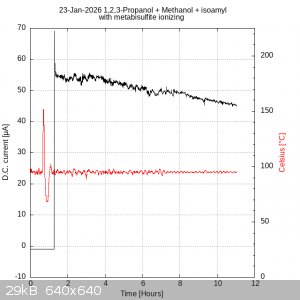

Note: The bottom of the test tube is holding steady at 195 [°C], while the kerosene just above the 1,2,3-PP-ol, is at about 125 [°C].
On this temperature graph, the air bubbles shrank between hours 3 and 5. This is where the yellowing occurred and the index of refraction of the 1,2,3-PPol changed remarkably. The white you see in the picture is a piece of teflon plastic behind the test tube so I could see the color changes of the liquid.
pngsnap.png - 34kB
My 30 watt soldering iron can't get any hotter, so this is pretty much the best I can do for a test tube experiment. I'm not sure if I can get a tiny heating mantle that would fit a test tube bottom.
There are temperature spikes in the graph, which is a bug in the INKBIRD bluetooth thermometer system. I'm working on that in another thread.
But, with a little bit more work I ought to be able to do time-lapse films of test tube reaction with text labeling on the video itself. :)

Refraction data for water over temperature, how I am proceeding -- what I am learning:
I contacted someone in Turkey about an article on water refraction. In my last correspondence, they mentioned that they thought I was something like a 'data' assassin and recommended that I do a high precision refraction measurement myself and 'publish it somewhere' -- rather than try to figure stuff out from other people's data. ( So I won't mention her name here. )
I am attempting to follow her advice.
Building a refractometer:
I have capillary glass tubes, and am able to construct a refractometer based on the original Lorenz design:
https://riviste.fupress.net/index.php/subs/article/download/...
Jamin mirrors for optical surveying are common, and I have some.
I also have found that I can stretch glass fiber by melting it and pulling it, which thins the fiber and jacket. The shape becomes somewhat like a catenary/hyperbolic bend. This leaks more light depending on the refractive index of the fluid that surrounds it. So, I might be able to use a partially melted fiber as a second way to check the Lorenz measurements.
I don't have temperature control totally automated yet with calibrated glass thermocouple probes. ( I really need my 3D printer to work already!!! )
Tentatively,however, my first attempts match with the Turkish fiber optic experiment's plotted data. (which I can only get by picking it off a graph, as she doesn't publish the numbers!).
Which is to say, that my earlier comment to her on the her equation's dis-agreement with NIST has nothing to do with her actual data.
Her raw data isn't bad. BUT -- her published curve fit equation, and her data, do not describe the same curve.
I find the situation fascinating. She thought my pointing out the discrepancy was like an attack / discrediting smear campaign. Rather than as an opportunity to rise above her peers.
Things I have learned:
NIST's and IAPWS "data" isn't raw data.
Their data is actually a curve fit to the Lorenz-Lorentz equation.
The first article that I linked, ( Bashktov and Genina) from Russia, isn't actually using their own data (either) but is in fact curve fitting NIST's curve fit data. ( A curve fit of a curve fit !!! )
https://www.researchgate.net/publication/366494863_A_Simple_...
In all cases of disagreement that I've found, it is actually a curve fit equation that that is in disagreement with another curve fit equation.
It's not the 'raw' data itself. For all raw data I am finding is reasonably consistent (with random errors).
Therefore, I'm of the opinion that If the Turkish fiber optic experiment's raw data is correct, then the Lorenz Lorentz curve-fit equation makes slightly wrong predictions above 60 [°C]. I expect to get better data once I have 3D printing capabilities and a good calibrated thermometer.
But:
The 'upward' curve of the Lorenz-Lorentz equation in my earlier plots is actually evidence that a cube root of water volume will more accurately fit the data than multiplying by a raw volume.
Looking at Lorenz paper, it's fairly obvious that his derivation tries to match the leading terms of the Cauchy semi-empirical dispersion equation.
The same Cauchy semi-empirical equation is being used by both the various articles I linked as the 'simple' equation for their curve fits as well. I suspect something about the Cauchy semi-empirical equation is not quite correct.

Because my vacuum pipettes suck for accuracy ... I also bought glass borosilicate 3.3 TD 1 ml pipettes designed for 20 [°C]. It has 0.01 [cc] gradulations. I was going to buy some temperature regulators for my milligram scale, and see if I can get the precision of my scale to increase. These are the only tools beside reagant grade chemicals that I presently have to make measurements with that could possibly make accurate denisty measurements to figure out anything about dissolved gasses or ions.
I have an optical spectrometer, but I don't have a way to calibrate it yet.
I also have multiple thermometers, but they are only partially functional. ( I'm paying someone to fix it, but they are slow. )

This post is a derivation of an improved model for refraction index of a substance vs. density.
Relative dielectric constant of a substance is a value equal to the index of refraction (of that same substance) squared. It varies with frequency, but is constant at any specific frequency.
ε_r = n²
Which means that a Lorenz-Lorentz model OUGHT (but isn't) to be identical to a model where every molecule is an electronic capacitor having a constant dielectric constant inside and the space between molecules is a capacitor with the dielectric constant of empty space.
Unfortunately Lorenz and Lorentz, both made a simplifying assumption that is not rigorously correct in three dimensional volumes of liquids or gas. They used a polarization model with a single charge cavity and no corrections for series vs parallel dipole moments.
eg: This neglects the different series and parallel effects of molecules spread out in space. Capacitors do not add in only one way.
For an analytical solution that predicts the quality of the error made by Lorenz and Lorentz, I'm going to make a simple linear assumption. I am going to assume that molecules can be modeled linearly as a cubic shaped capacitor with two imaginary conducting plates oriented perpendicular to one arbitrary dimension of the space.
For water, then, the mass and volume of each water molecule 'capacitor' can be found from the maximum water density 3.98 [°C].
Note: At 980 [nm], 3.98 [°C], 1 [ atm ] the refractive index of water is computed as 1.3266 from IAPWS formula. This means the dielectric constant is ε_r = 1.3266² at 980 [nm].
If the total volume of water material is (1 [cm])³, but the total volume we measure the capacitance of is is (B [cm])³ , then the difference in volumes is empty space between and around the water molecules.
Note: It does not matter how many smaller molecular cubes the 1 [cm] cube of water is broken up into, because in electronic circuit theory, capacitors are linear circuit elements. The only things that *really* matter are the relative number of water molecules found longitudinally ( in series ) when passing through any given cube vs. transversely ( in parallel ). For this determines the number of series to parallel elements in a capacitor network.
But, this means I can compute the exact same (bulk) capacitance answer by imagining all water swept into a corner of the volume B³ and the rest left as empty space.
By definition, the density of the entire cube is still 1/B³ even though we've compressed the 1 [cc] of effectively 3.98 [°C] water into a single corner of the cube.
The capacitance of the entire cube can be computed from a network of cuboid shaped capacitors that contain one and only one kind of 'thing' each.
I break the entire cubic volume (B³) up into one cuboid capacitor formed of maximum density water, and three capacitors of different sizes that represent the remaining (empty) cuboid spaces around the water.
The nominal capacitance of a cuboid is defined as:
C = dielectric constant · area_of_face / length_between_faces
I can then describe the entire volume as four cuboid capacitors.
C₀ = ( ε₀ · ε_r ) · 1² [cm²] / 1 [cm] # Capacitor made only of water
C₁ = ε₀ · 1² [cm²] / (B-1) [cm] # Empty space in series with water
C₂ = ε₀ · (1·(B-1)) [cm²] / (B-1 [cm]) # Small space in parallel with water
C₂ = ε₀ · (B-1)·(B) [cm²] / (B [cm] ) # Larger space in parallel with water
I'm neglecting electric field fringing effects, and molecule shape effects, because the error is a fixed percentage based on geometry and this error usually cancels when converting a capacitor value back into a dielectric value. The capacitance values are crude, but the dielectric values ought to be quite accurate.
The total capacitance of the composite cube is:
C = 1/ ( 1/C₀ + 1/C₁ ) + C₂ + C₃
C = ε₀·( 1/( 1/ε_r + B - 1) + 1-1/B + B-1 )
Therefore, for the whole cube, the average dielectric constant is:
n² = ε_a = 1/( B² - B + B/ε_r) + 1 - 1/B²
eg: This is (theoretically) the "average" or "equivalent" dielectric value that light would encounter at a given density when moving through equally dispersed water molecules in a volume.
Here is a graph of IAPWS prediction for 980 [nm] light's index of refraction in freshly distilled water from freezing to boiling at 1 [atm]. I've also included a plot of what my lumped electronic circuit model predicts for the same color of light.
pngsnap.png - 14kB
Code:
#!/bin/env gnuplot # Compute an 'average' index of refraction for a 1 [cm³] volume of ε_k media # distributed in a vaucuum volume of B³, where refractivity is ε₀. # Written by Andrew Robinson of Scappoose, 2026 # Copyright 2026; Released under the GNU pubic license GPL3.0. # https://www.gnu.org/licenses/gpl-3.0.html # # 980 [nm], IAPWS calibration n_k = 1.3266 E_k = n_k**2 # Block model of how permittivity changes with molecule spacing E_B( B ) = 1/( B**2 - B + B/E_k ) + 1 - 1/B**2 n_d( d ) = E_B( (d/1000.)**-0.3333333333 )**0.5 # IAPWS -- characteristic equation # l is wavelength in nanometers # p is density in kg/m³ # T is temperature in kelvin R997(l,p,T)=(_a0+_a1*(p/p0)+_a2*(T/T0)+_a3*(l/l0)**2*(T/T0)+_a4/((l/l0)**2)+_a5/((l/l0)**2-Luv**2)+_a6/((l/l0)**2-Lir**2) + _a7*(p/p0)**2 )*(p/p0) _R997(x)=sqrt( (1+2*x)/(1-x) ) # Caution, this inputs temperature in Celsius and converts it to Kelvin. R997N(l,p,t)=_R997( R997(l,p,t+273.15) ) T=293.15; T0=273.15 l0=589.0 Lir=5.432937; Luv=0.229202 p=997.0 ; p0=1000.0 _a0=0.244257733 _a1=0.00974634476 _a2=-.00373234996 _a3=0.000268678472 _a4=0.00158920570 _a5=0.00245934259 _a6=0.900704920 _a7=-.0166626219 # IAPWS -- density equation for water 0-100C ( <0.02% error ) # https://chem-casts.com/knowledge/density-of-water p(T) = ( 999.83952 \ +16.945176*T \ -7.9870401e-3*T**2 \ -4.6170461e-5*T**3 \ -2.805425e-10*T**5 )/(1 + 1.6879851e-2*T) # set title "Index of refraction at 980 [nm] for freshly distilled water vs. temperature" set dummy t set grid set xlabel "Temperature [ °C ]" set xrange [ 0 : 100.0 ] set xtics 5 set yrange [1.307:1.330] set ytics auto set mytics 5 set ylabel "Refractive index, n" plot R997N( 980.0, p(t), t ) lw 3 lc 'grey', n_d( p(t) ) ti 'block dielectric'
What is important in this graph is not how accurate the IAPWS density vs temperature equation is, but the relative shape difference between the IAPWS curve and my own prediction of index of refraction based on density.
The IAPWS graph represents assumptions based on a Cauchy curve fit of the index of refraction data. My curve has a very similar shape but is slightly higher in value in general but crosses over near boiling.
Now:
Find a graph of experimental data for water at 980 [nm] using fiber optics, vs. a Cauchy curve fit in an article referenced in one of my earlier posts. (Esra K. and and S¸ Yaltkaya are authors, Indian Journal of Physics. ) Esra's actual fiber optic data at 980 [nm] tends to be above her Cauchy curve fit.... (Equation #5 in the article) and crosses over near boiling.
eg: The actual data compared to a Cauchy curve fit agrees (qualitatively) with the electronic correction model I just computed compared against a standard IAWPS curve fit.
[Edited on 20-2-2026 by semiconductive]
