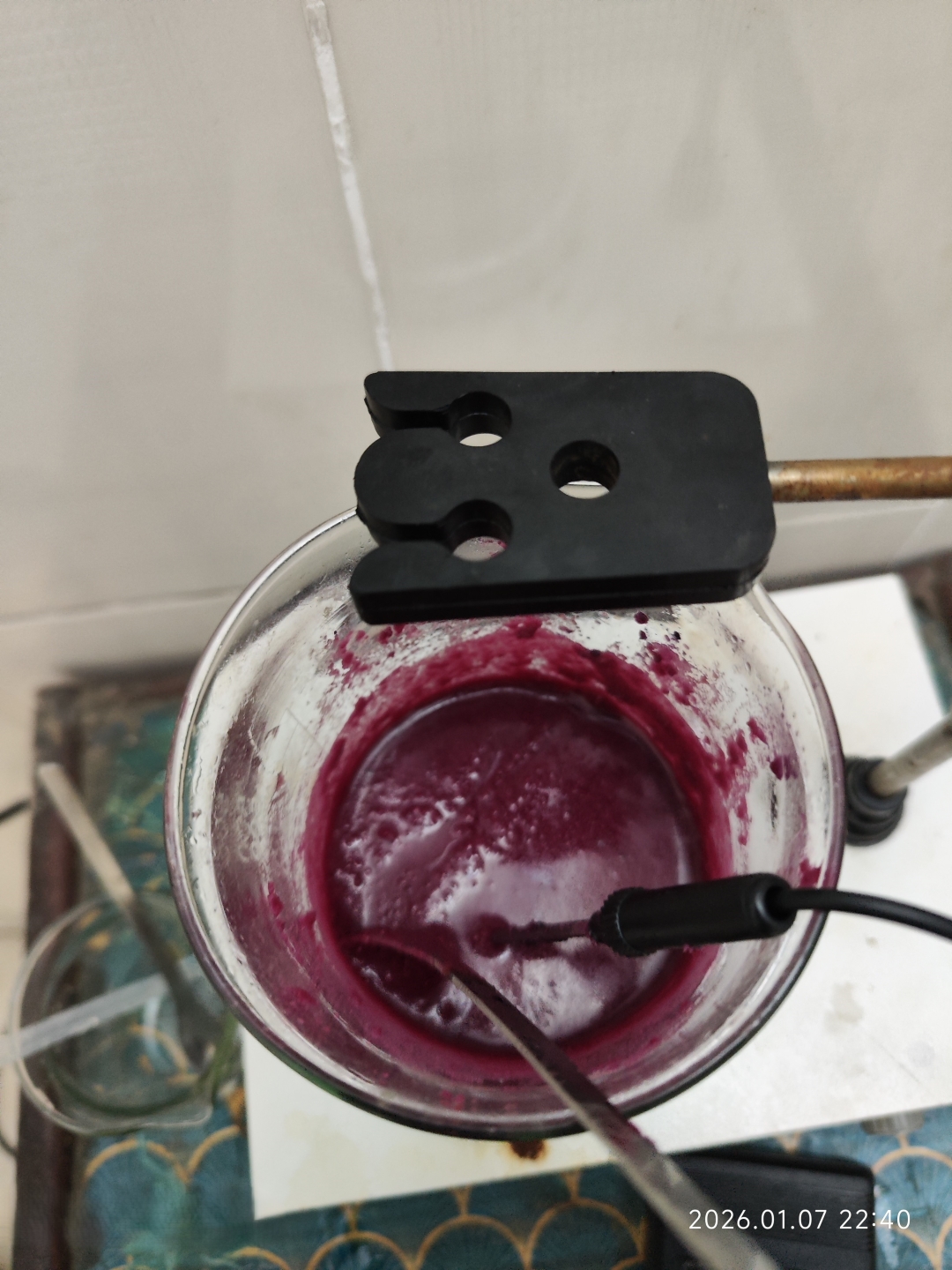

Ran the experiment again with an overhead stirrer. I think the bright colors of the initial run were just char from poor stirring. Chilling the phenoxyethanol helped as well. Crystal shape is the same, but one product is cream instead of red and the other is white instead of orange. Yield is still low, and the ratio of products is still the same. I will change 1 variable at a time until I see improvements.

  1. A chilled beaker of H2SO4 was placed in a water-ice bath with overhead stirring. KNO3 was added in scoops, with temperature kept to 15-20°C.
  2. Then chilled phenoxyethanol was slowly added. When multiple drops were added at once, or when they landed near the edges and were not adequately stirred, streaks of dark purple showed. When added slowly there was no change in color. Overall, the reaction mixture was a bubble gum pink. During and after phenoxyethanol addition, the mixture thickened enough to prevent even stirring, requiring repeated additions of sulfuric acid.
  3. After 34 minutes, addition was complete. There was no further evolution of heat. The mixture thickened somewhat, requiring the addition of 8mL of sulfuric acid (14.68g 93.2%) in total.

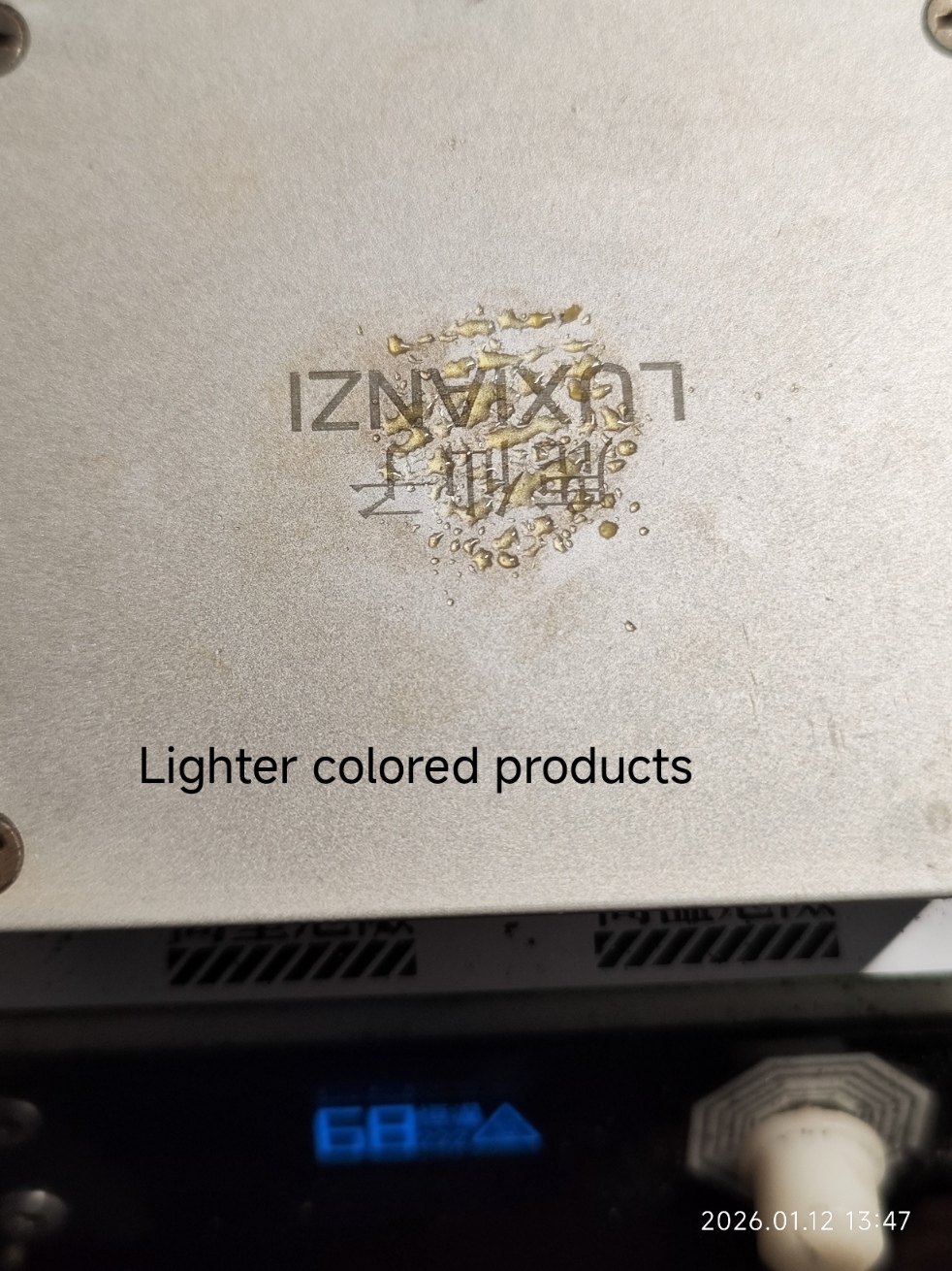

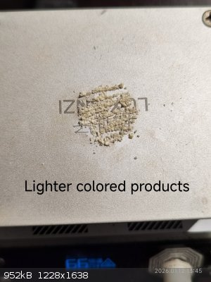

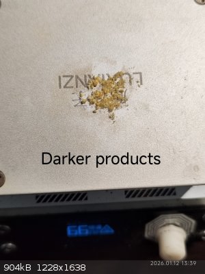

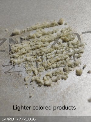

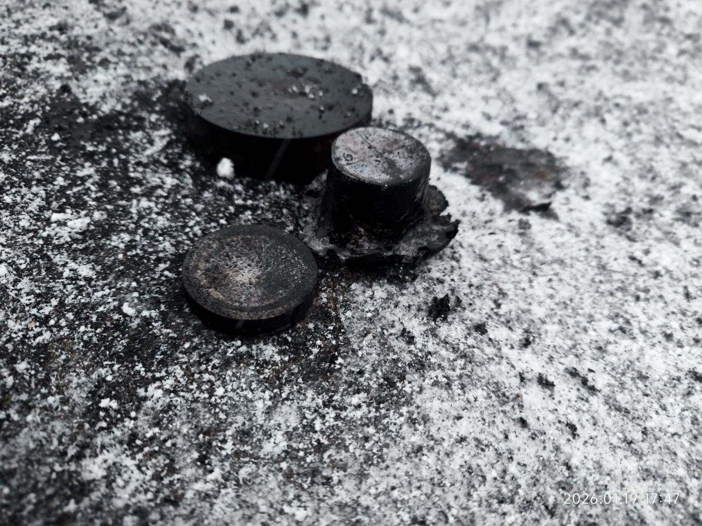

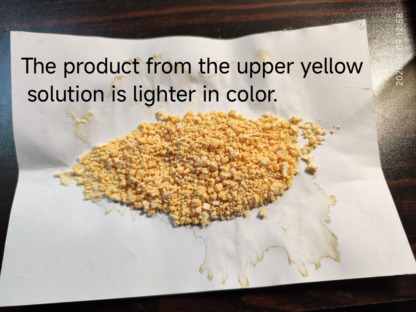

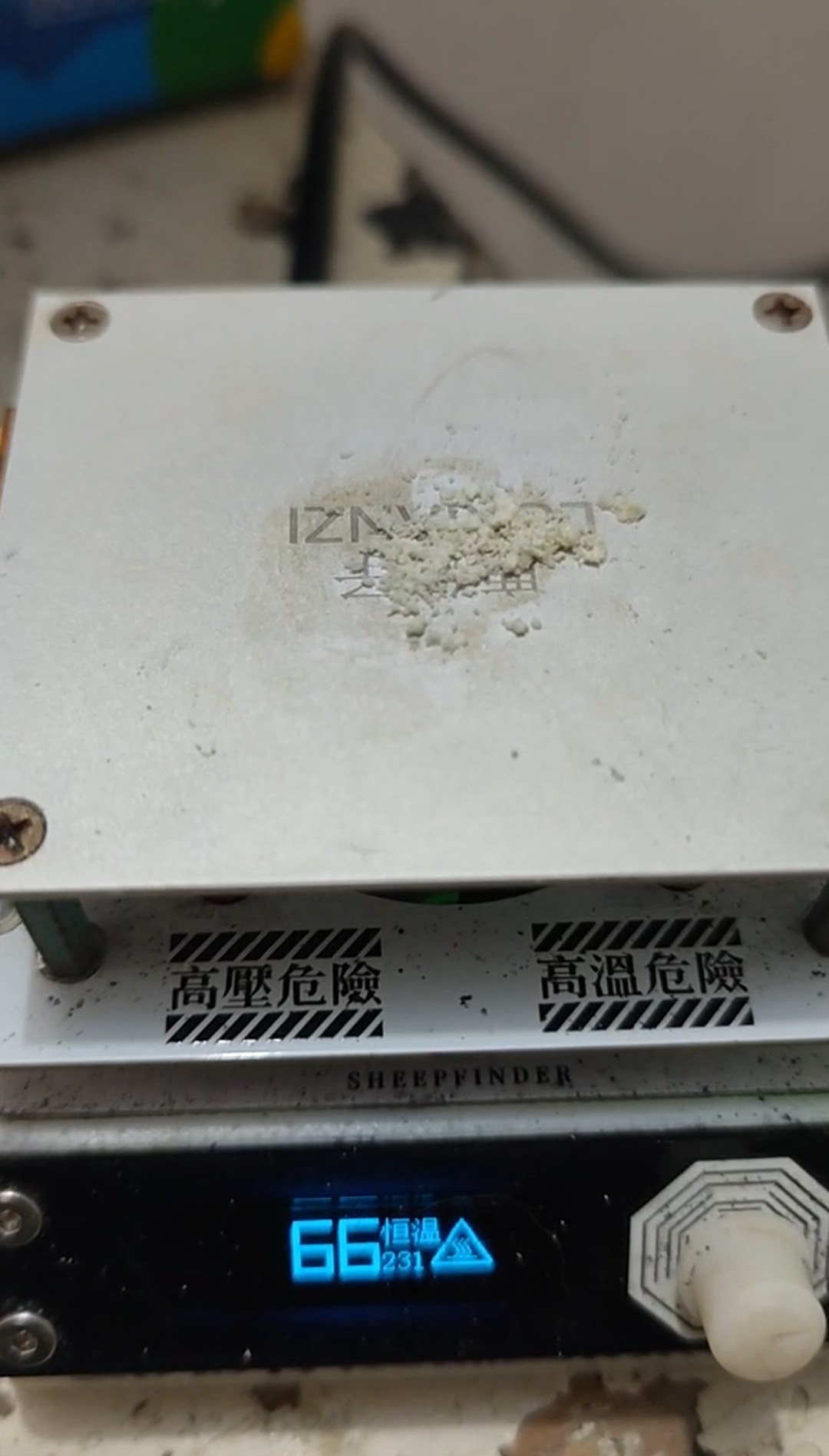

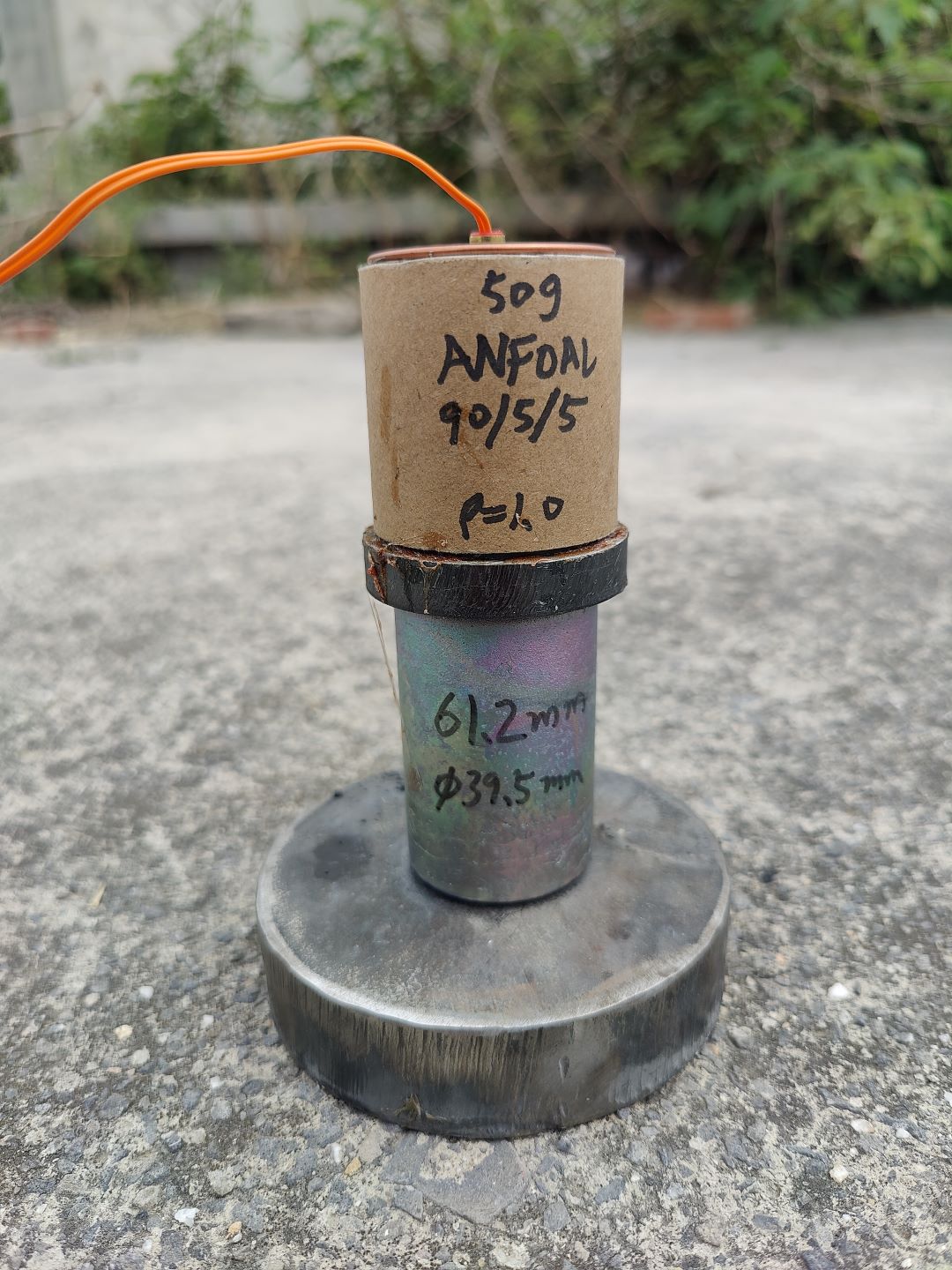

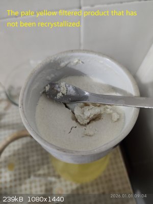

KFeNAT - 10-1-2026 at 08:08

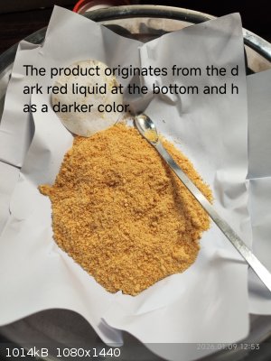

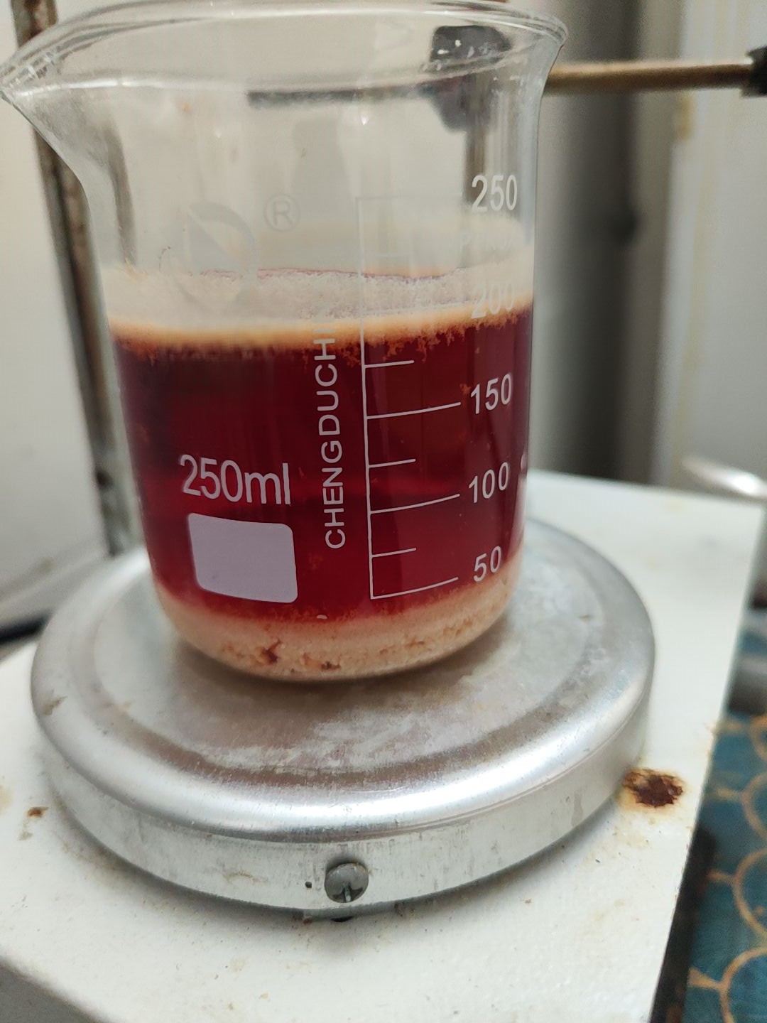

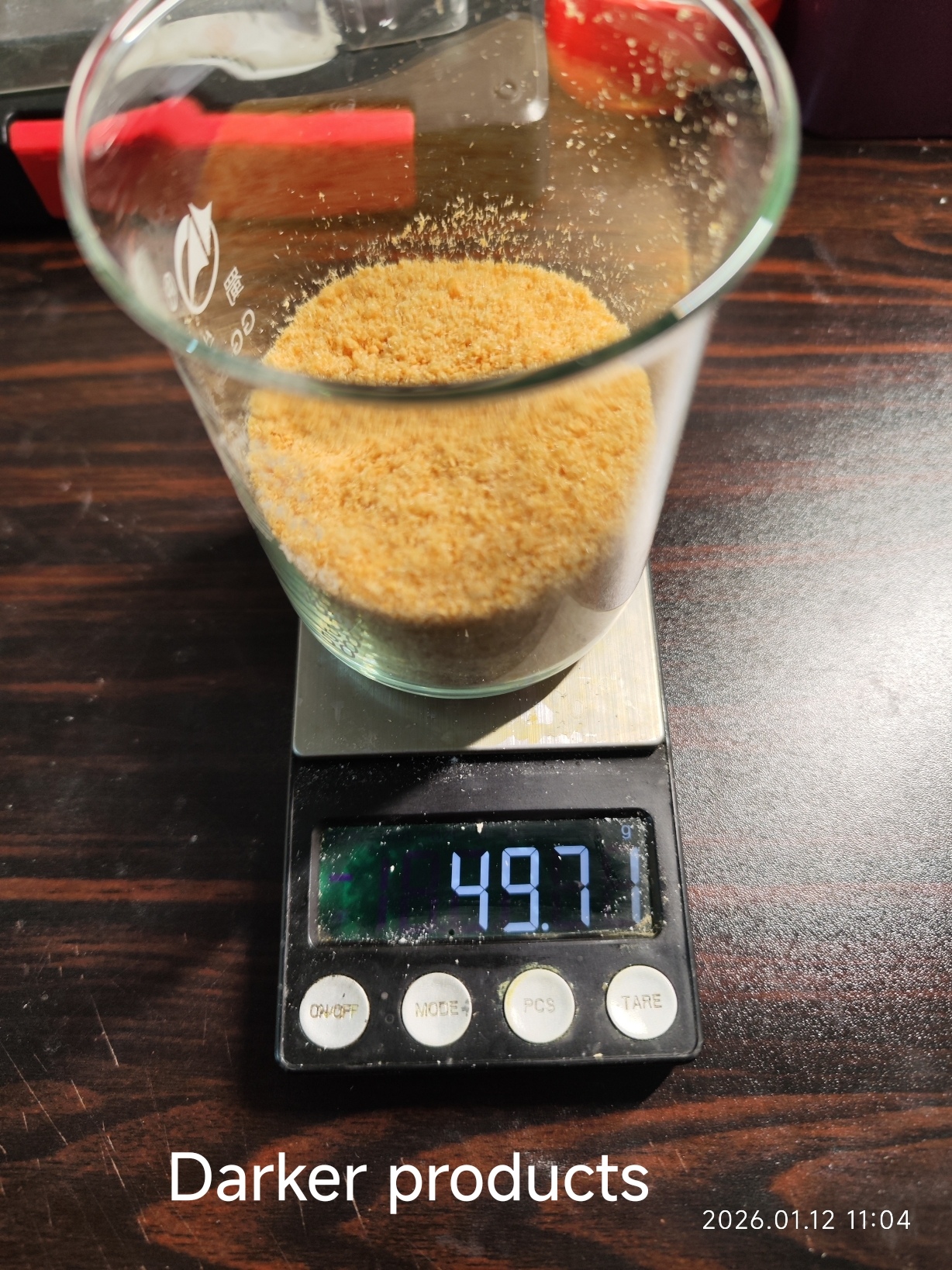

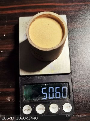

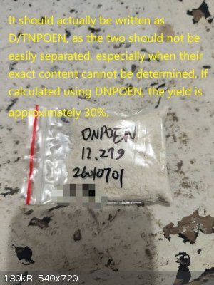

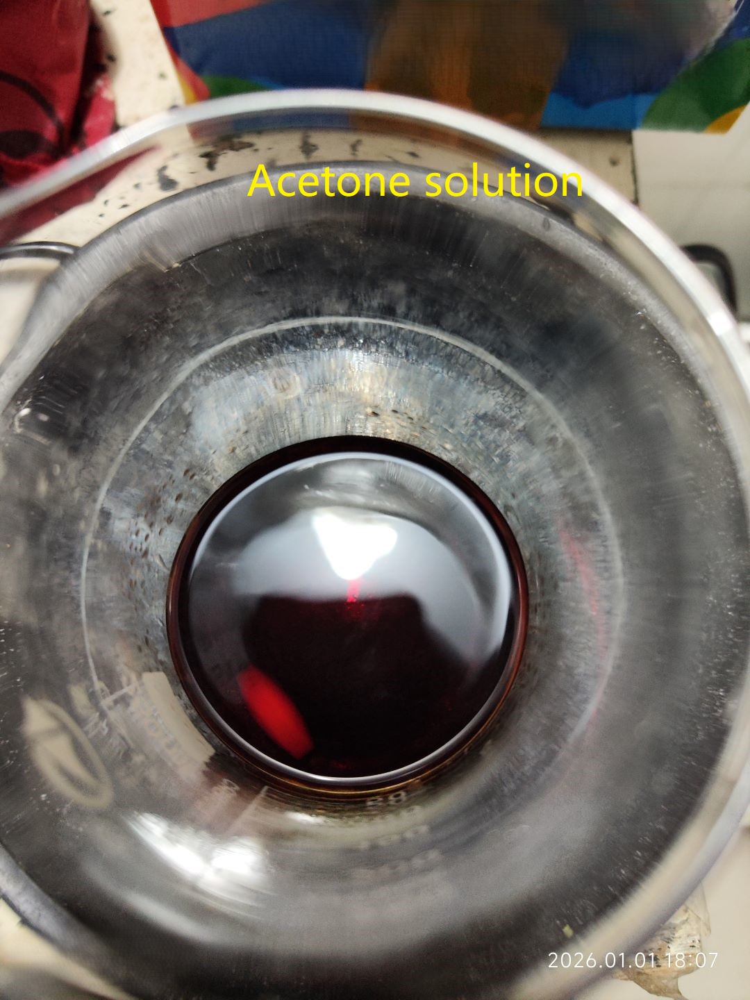

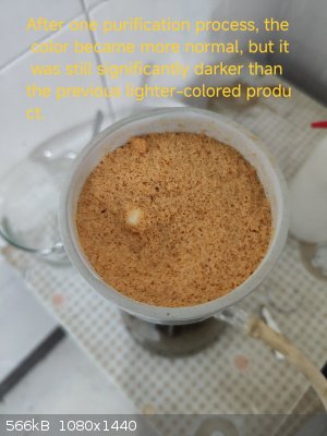

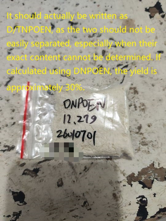

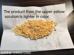

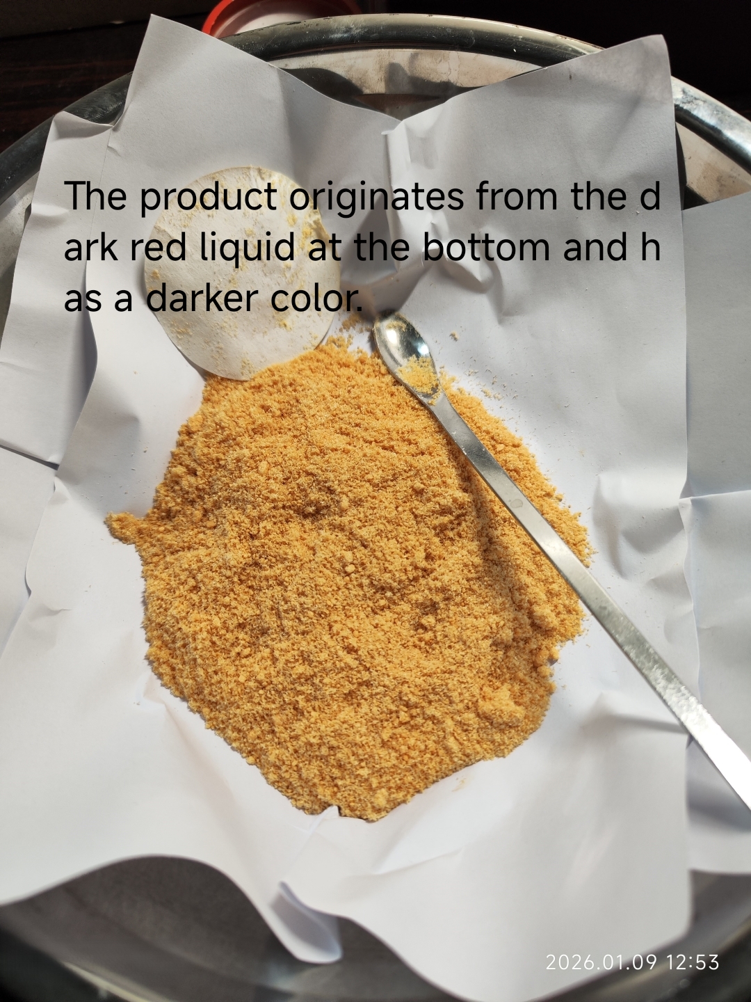

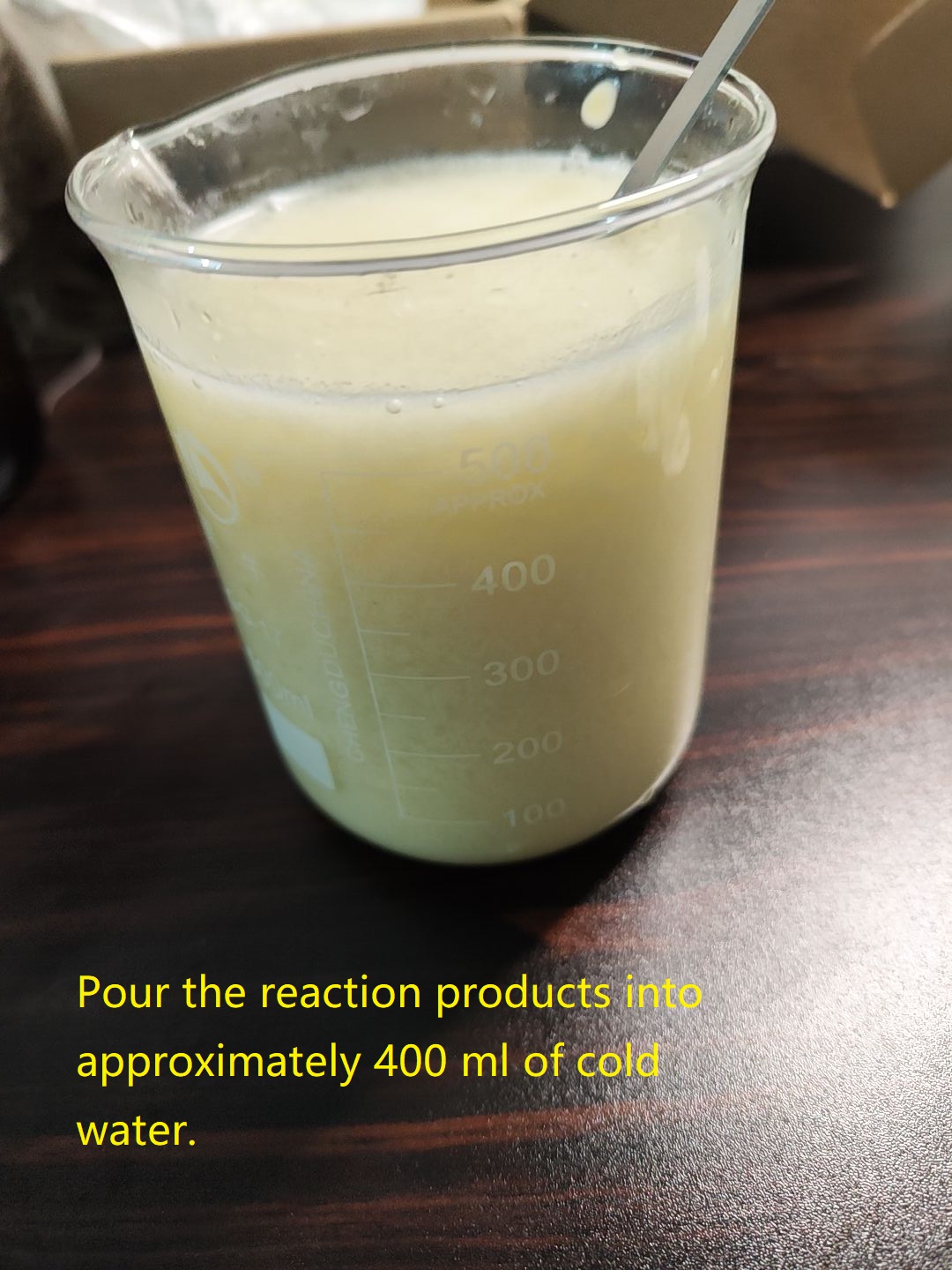

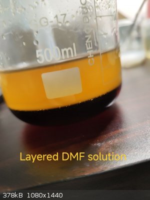

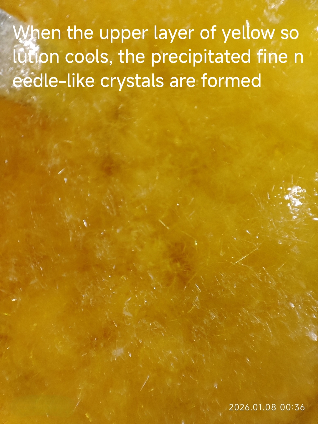

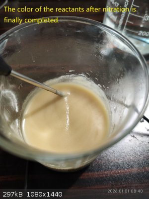

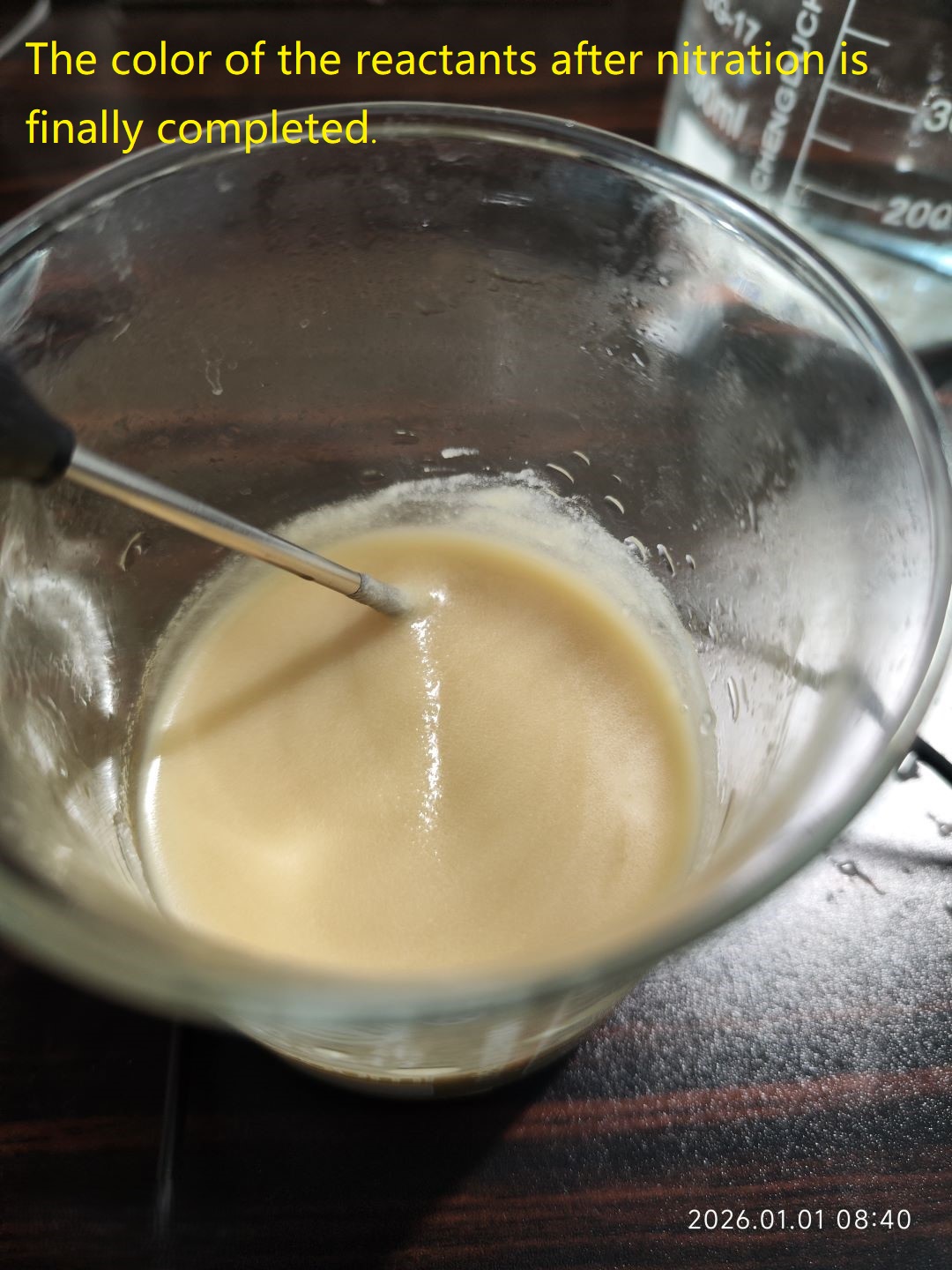

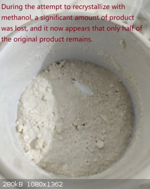

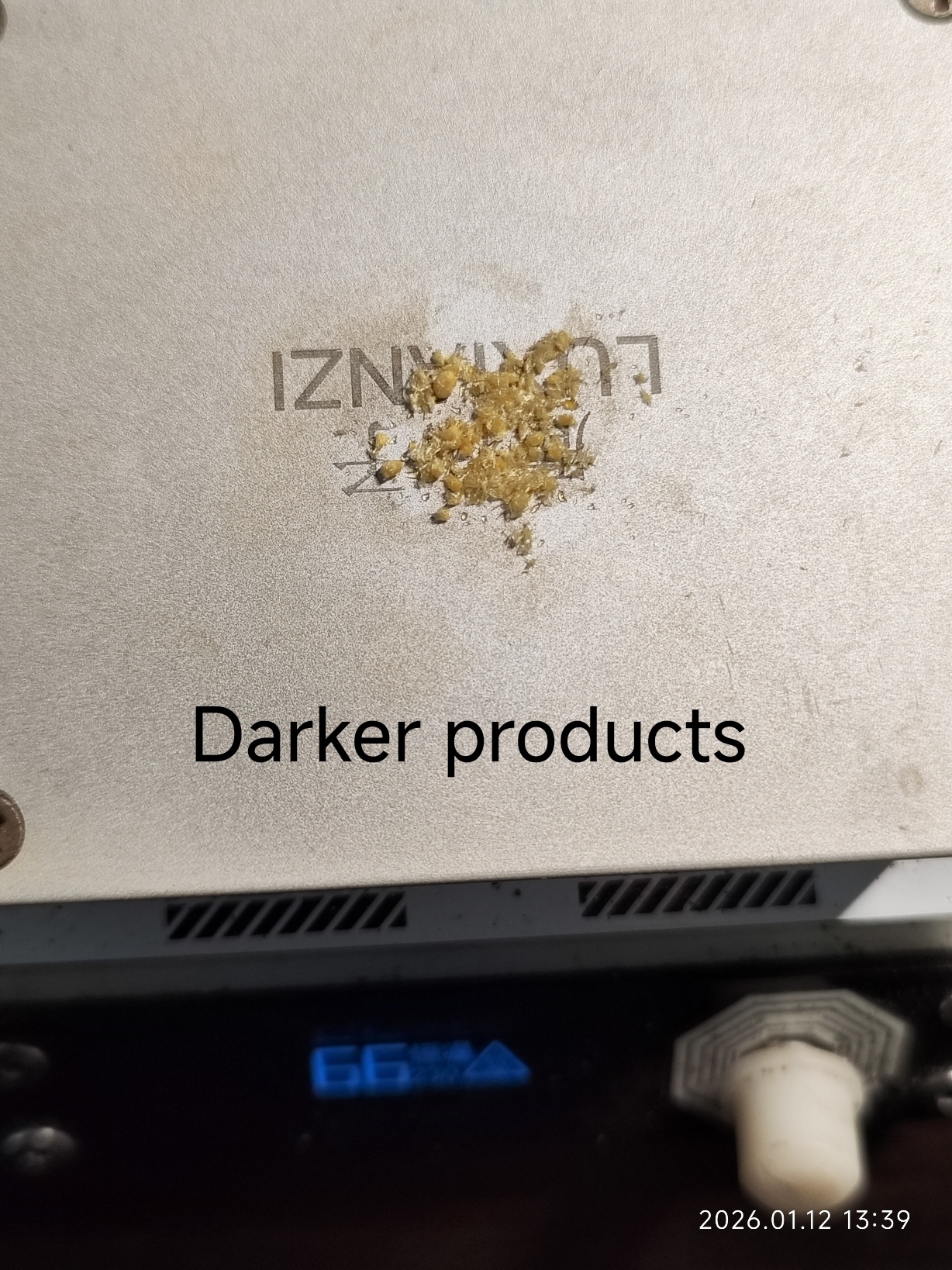

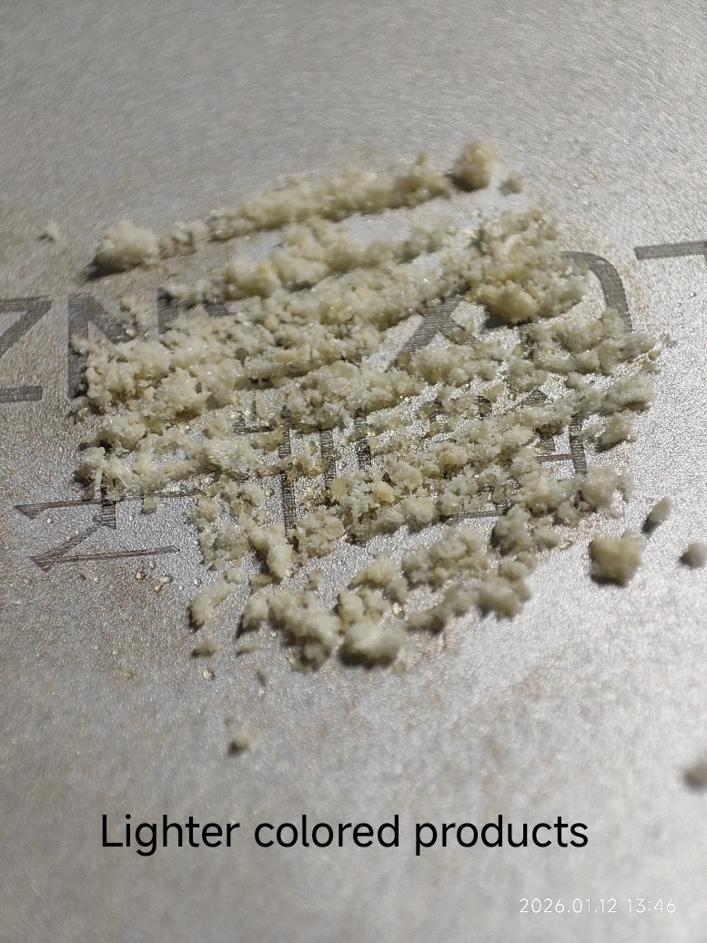

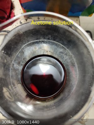

I have currently tried two different nitration methods.
1; First, phenoxyethanol is mixed with sulfuric acid to undergo sulfonation and esterification. Then, the mixed solution is added dropwise to a mixed acid (POE: 96% H₂SO₄ = 1:2, 60% HNO₃: 96% H₂SO₄ = 1:1.7).
POE + 96% H₂SO₄ = 20g + 40g
60% HNO₃ + 96% H₂SO₄ = 50g + 85g
This method does not oxidize the reactants, thus avoiding the formation of a purple substance.
Initially, I tried using inexpensive methanol to dissolve the wet product; however, methanol proved to be an unsuitable solvent.
Firstly, D/TNPOEN's solubility in methanol is insufficient, and secondly, when the product contains water, heating and dissolving it produces a layered solution.
The low-melting-point D/TNPOEN-methanol complex is in the lower layer, and the yellow D/TNPOEN-H₂O-methanol solution is in the upper layer.
Furthermore, when these were poured directly into water, severe emulsification occurred; almost only the lower layer of the D/TNPOEN-methanol complex gradually turned into a yellow solid due to methanol removal and cooling.
The substances contained in the upper solution were difficult to recover due to emulsification.
Therefore, I dissolved and stabilized the remaining lumpy product again using acetone, ultimately obtaining only about a 30% yield.
If I had used highly efficient acetone from the beginning, the yield should have been at least between 50% and 60%.
Finally, the pale yellow product obtained by recrystallization from acetone was tested using a hot plate with a slow heating method, and its melting point was approximately 67°C.

That is a good idea, sulphonation before nitration. I did "stress test" this nitration and it is very prone to oxidation. Adding phenoxyethanol to 68% NA 98% SA mixed acids at anything over 25C results in puffs of smoke, why they were running it with dry ice in the lit.

I adjusted the image size and text description, and now it should be able to be sent successfully.
KFeNAT - 11-1-2026 at 01:09
IMG_20260101_073215.jpg - 365kB IMG_20260101_084025.jpg - 297kB IMG_20260101_084901.jpg - 310kB IMG_20260101_090425.jpg - 239kB IMG_20260101_180720.jpg - 308kB IMG_20260101_183554.jpg - 238kB IMG_20260101_235527.jpg - 197kB IMG_20260101_070953.jpg - 280kB Screenshot_2026-01-11-16-41-02-569_com.miui.media.jpg - 651kB IMG_20260102_004840.jpg - 323kB qq_pic_merged_1768060257058.jpg - 130kB
UndermineBriarEverglade - 11-1-2026 at 14:27
Nice pics. Your sulfonated POE is a much darker color than mine, but that might be due to the larger amount of material. How long did you run the reaction and at what temperature?
I tested the melting point of my "TNPOEN" from runs 2 and 4 and it is 65°C, so the methanol "separation" is a failure and must just be water like you said. With such a low melting point I doubt there is much trinitro in there. For practical purposes it shouldn't matter, but it is unsatisfying not to have a way to separate them.
KFeNAT - 11-1-2026 at 15:17
When adding POE to sulfuric acid, the temperature should be controlled below 20°C. After all the POE has been added, the temperature should be raised to 30°C and held for about 20-30 minutes. Although theoretically POE can withstand higher temperatures in sulfuric acid without structural decomposition, if the temperature is too high, it is generally believed that when it exceeds 50°C, it may cause -CH2OH to dehydrate and condense into -CH2OCH2-, thereby reducing product performance, especially during the process of adding alcohols to sulfuric acid.

POE was slowly added dropwise directly to the mixed acid while cooled (12-17°C). After the final addition was complete, the reactant temperature was raised to 25°C and maintained for 10 minutes.
POE: 35g
60% HNO3: 90g
96% H2SO4: 230g
When using this method, the addition of POE must be slow. Under strong stirring, the previous drop of POE must be completely mixed in the solution before adding the next drop. Adding too quickly will cause the POE to not disperse in time, leading to a sharp increase in local temperature, oxidation of the reactants, and the production of nitrogen oxides and white fumes. Simultaneously, the color of the entire reaction system was the same as in the original poster's case, resembling purple jam. I believe this color indicates that POE has been oxidized, producing phenolic and quinone impurities.
I tried using DMF as the recrystallization solvent this time.
However, for the crude product containing water, a bilayer solution still occurred.
This time, 120 ml of DMF was used, and the solution formed liquid layers at approximately 50 degrees Celsius. This means that the dark red liquid at the bottom is likely still a low-melting-point complex of D/TNPOEN and DMF, while the upper yellow solution is likely a mixture of D/TNPOEN-H₂O-DMF.
Heating to 70 degrees Celsius did not eliminate the layering or dissolve most of the dark red complex in the lower layer.
Therefore, I separated the two solutions while they were still hot, treating the yellow upper layer and the dark red lower layer separately.
For the separated dark red bottom layer: I added 50 ml of acetone to keep the substances dissolved. After it cooled completely, I added 300 ml of 1% NaHCO₃ aqueous solution to redefine the product and remove residual acid.
For the separated yellow upper layer: After cooling, I added water to redefine the product. After filtering the precipitate, I dissolved it again in acetone, then added an appropriate amount of 1% NaHCO₃ solution for stabilization and precipitation.
In the end, I got two products, one darker and one lighter.
IMG_20260107_205145.jpg - 867kB IMG_20260107_224032.jpg - 799kB IMG_20260107_225619.jpg - 893kB IMG_20260112_124830.jpg - 506kB IMG_20260112_123547.jpg - 378kB IMG_20260108_000727.jpg - 864kB IMG_20260112_132253.jpg - 626kB IMG_20260112_125443.jpg - 566kB IMG_20260112_123908.jpg - 921kB IMG_20260112_133013.jpg - 1014kB IMG_20260112_133210.jpg - 640kB

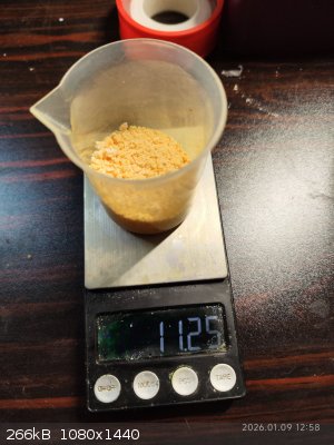

KFeNAT - 11-1-2026 at 23:07
The total weight of the dark and light-colored products was 49.71 + 11.25 = 60.96g. Based on DNPOEN, the yield is approximately 87%.
Using the heating plate again, a rough test of the melting points of both products showed very similar results: both exhibited slow melting at 66°C and rapid melting at 68°C.
IMG_20260112_150059.jpg - 790kB IMG_20260109_125839.jpg - 266kB IMG_20260112_150140.jpg - 904kB IMG_20260112_150203.jpg - 933kB IMG_20260112_150232.jpg - 952kB IMG_20260112_135809.jpg - 644kB IMG_20260112_150327.jpg - 505kB

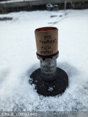

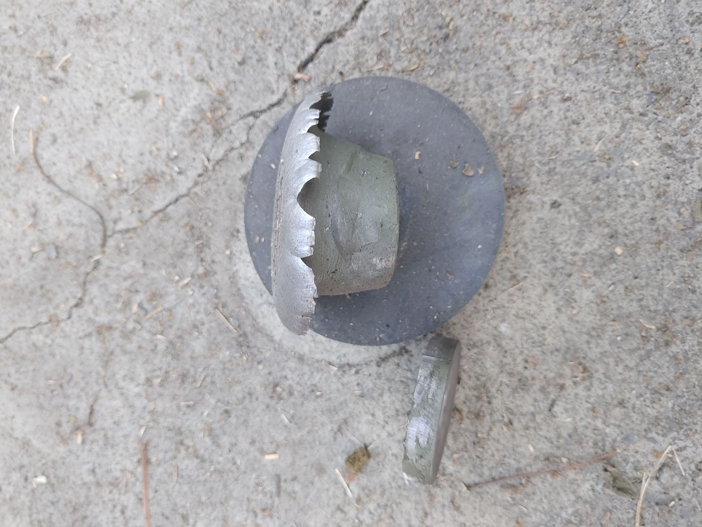

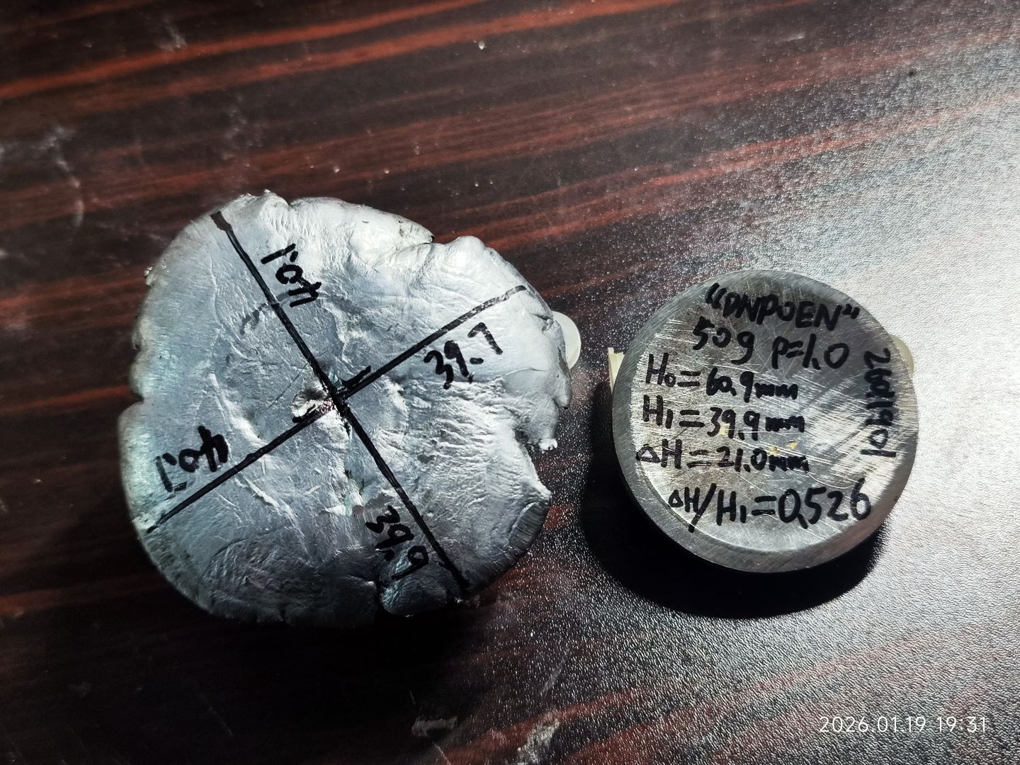

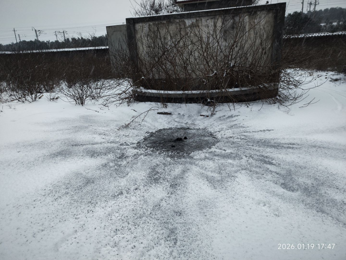

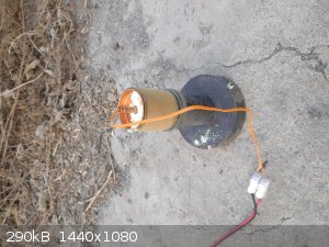

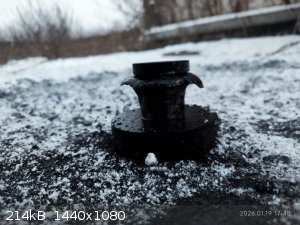

I conducted a lead compression test (Hess)

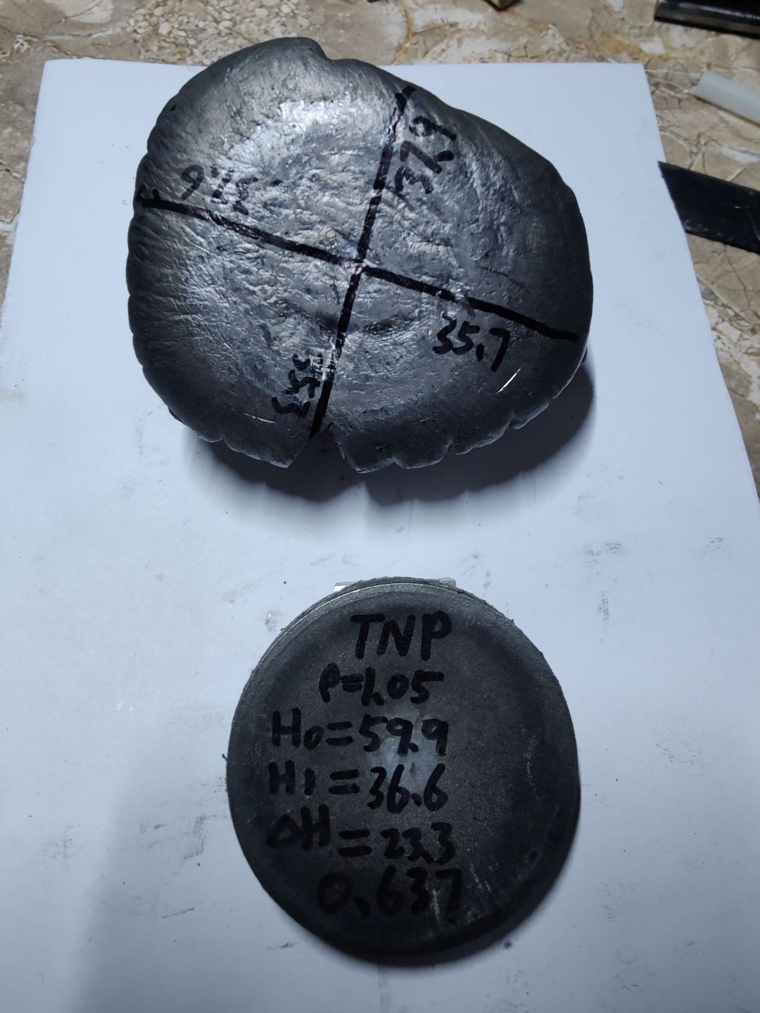

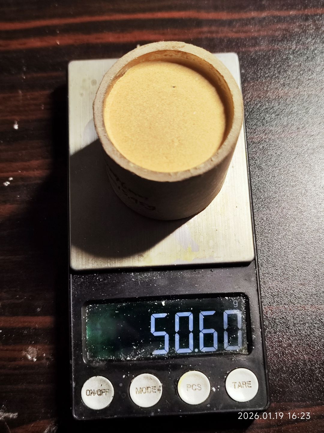

KFeNAT - 20-1-2026 at 01:40
This test used the product obtained by direct nitration (dark product plus a small amount of light product to fill to 50g).
Its relative stamina appears to be slightly weaker than TNP. It also produced very thick black smoke after the explosion.
The steel disc I used in the experiment had a diameter of 50mm, instead of the standard 40mm, thus providing a larger area to receive the explosive shock energy.
Furthermore, the diameter of the lead cylinder ranged from 39.5-39.6mm, slightly thinner than the standard 40.0mm lead cylinder.
Therefore, for the same experiment, my lead cylinder compression was higher than the standard value in the reference materials.
IMG_20260119_162328.jpg - 286kB IMG_20260119_174021.jpg - 139kB IMG_20260119_174728.jpg - 303kB IMG_20260119_174743.jpg - 317kB IMG_20260119_174801.jpg - 214kB IMG_20260119_193111.jpg - 358kB
Attachment: DNPOEN HESS.mp4 (3MB)
This file has been downloaded 29 times
Attachment: DNPOEN HESS 0.125x.mp4 (2.3MB)
This file has been downloaded 27 times
KFeNAT - 20-1-2026 at 01:53
The following are TNP and ANFOAl as references.
[Edited on 20-1-2026 by KFeNAT]
20241226_164907.jpg - 205kBIMG_20250521_190025.jpg - 157kBIMG_20250513_102537.jpg - 256kBIMG_20250513_102721.jpg - 216kBIMG_20250521_173904.jpg - 93kB
Attachment: TNP HESS 0.2x.mp4 (2.8MB)
