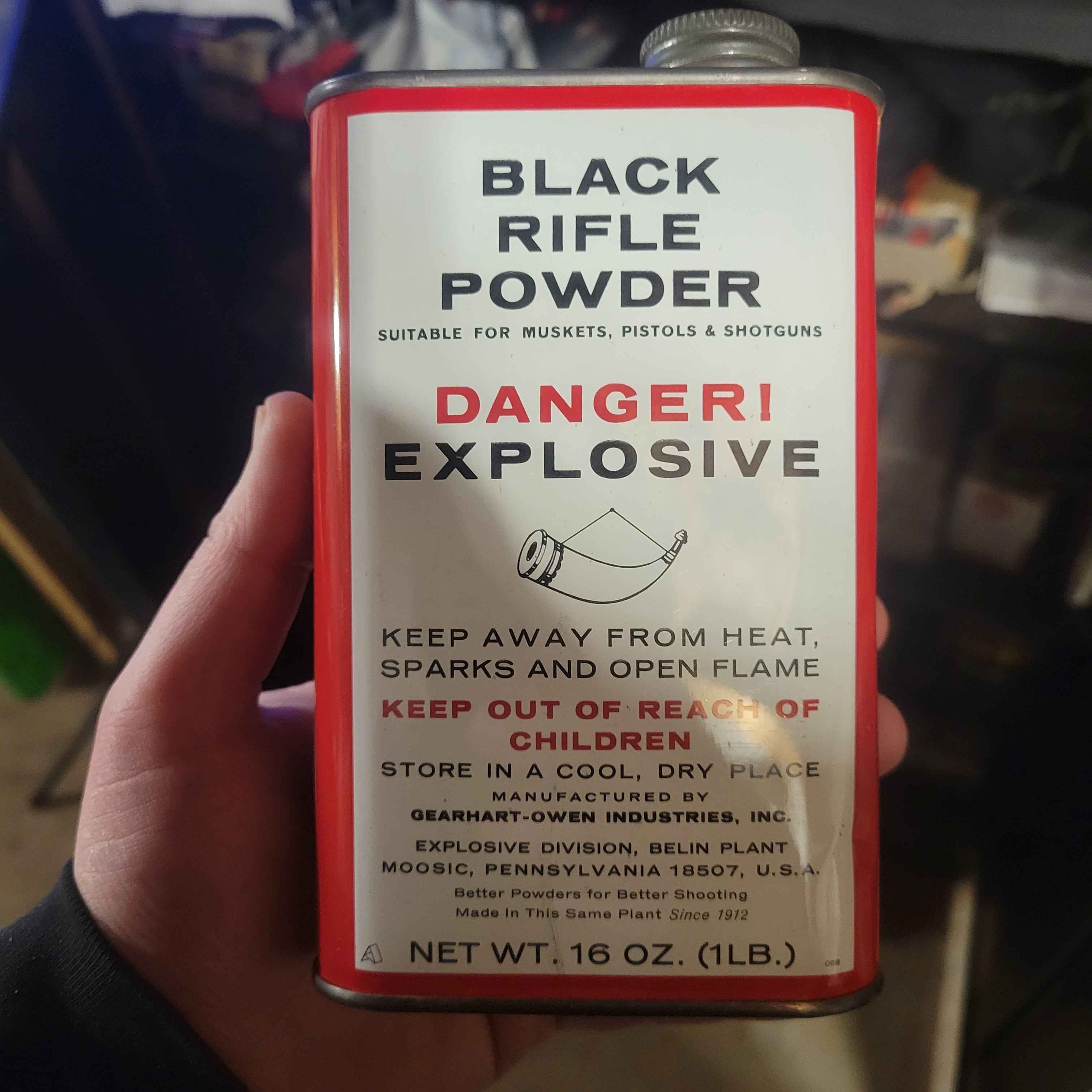

This is the black powder I used. Likely just a granulated mix of the standard 75/15/10 KNO3/Charcoal/Sulfur but it is pretty old and doesn't list the exact composition on the container
