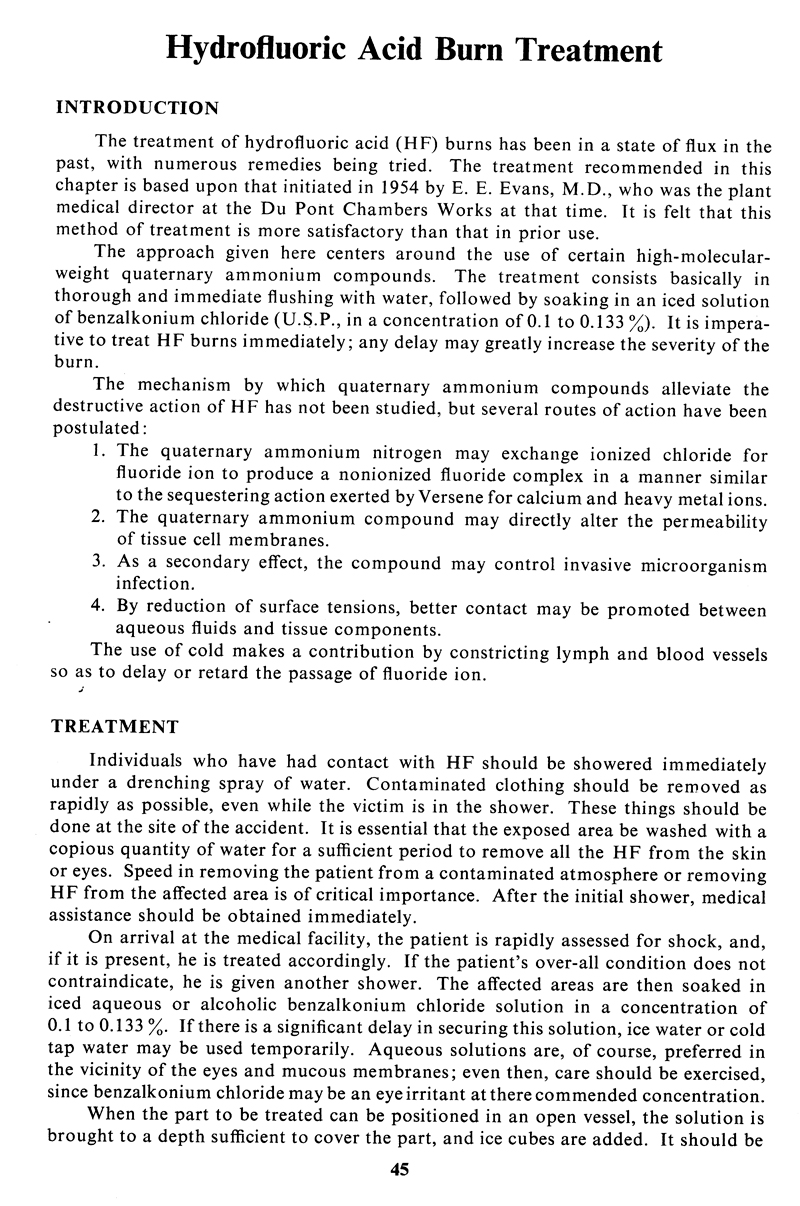

Hydrofluoric Acid Burn Treatement
The WiZard is In - 8-5-2011 at 08:35
CRC Handbook of Laboratory Safety
2nd ed. 1971
NB This was originally published 1966 use it
for clinical judgement at your own risk.
HF-Burn-Treatment-1.jpg - 491kB HF-Burn-Treatment-2.jpg - 500kB HF-Burn-Treatment-3.jpg - 251kB

CONCLUSION: This report highlights a late risk of HF acid dermal exposure.
[The patient later died when his ass-hole snapped shut upon receiving the hospital bill.]
Hydrofluoric acid burns: rational treatment.
Burd A.
J Burn Care Res. 2009 Sep-Oct;30(5):908.
Hydrofluoric acid burns: a 15-year experience.
Stuke LE, Arnoldo BD, Hunt JL, Purdue GF.
J Burn Care Res. 2008 Nov-Dec;29(6):893-6.
Comment in:
• J Burn Care Res. 2009 Sep-Oct;30(5):908. PMID: 19692923.
Department of Surgery, University of Texas Southwestern Medical Center, Parkland Memorial Hospital Burn Center, Dallas, Texas 75390-9158, USA.
Hydrofluoric acid (HF) is a strong inorganic acid commonly used in many domestic and industrial settings. It is one of the most common chemical burns encountered in a burn center and frequently engenders controversy in its management. We report our 15 year experience with management of HF burns. We reviewed our experience from 1990 to 2005 for patients admitted with HF burns. Primary treatment was with calcium gluconate gel. Arterial infusion of calcium and fingernail removal were reserved for unrelenting symptoms. There were 7944 acute burn admissions to our center during this study period, 204 of which were chemical burns. HF burns comprised 17% of these chemical burn admissions (35 patients). All were men, with a mean burn size of 2.1 +/- 1.5% (range, 1-6%) and hospital stay of 1.6 +/- 0.7 days (range, 0-3 days). The most common seasonal time of injury was in the summer. Twelve patients (34%) were admitted to the intensive care unit for a total of 14 intensive care unit days, primarily for arterial infusions. Ventilator support was not required in any patient. No electrolyte abnormalities occurred. All burns were either partial thickness or small full thickness with no operative intervention required and no deaths. The upper extremity was most commonly involved (29 patients, 83%). The most common cause was air conditioner cleaner (8 patients, 23%). HF is a common cause of chemical burns. Although hospital admission is usually required for vigorous treatment and pain control, burn size is usually small and does not cause electrolyte abnormalities, significant morbidity, or death.
Hazardous brick cleaning.
Ferng M, Gupta R, Bryant SM.
J Emerg Med. 2009 Oct;37(3):305-7. Epub 2008 Jun 20.
Department of Emergency Medicine, Rush University Medical Center, Chicago, Illinois, USA
Hypocalcemia, hypomagnesemia, and hypokalemia following hydrofluoric acid chemical injury.
Dalamaga M, Karmaniolas K, Nikolaidou A, Papadavid E.
J Burn Care Res. 2008 May-Jun;29(3):541-3.
Department of Internal Medicine, NIMTS General Hospital, Athens, Greece.
Dermal exposure to hydrofluoric acid could potentially result in severe serum calcium and magnesium depletion induced by binding with fluoride anion. This report describes the case of a 48-year-old man who developed hypocalcemia and hypomagnesemia accompanied by hypokalemia-an interesting finding-following a chemical injury with exposure to 70% hydrofluoric acid. Successful treatment included administration of calcium gluconate and magnesium both intravenously and topically.
Hydrofluoric acid burn to penis.
Schmidt MJ, Bryant SM.
Clin Toxicol (Phila). 2007 Sep;45(6):732.
Department of Emergency Medicine, Northwestern University Feinberg School of Medicine, Chicago, Illinois, USA.
Opical treatment of experimental hydrofluoric acid skin burns by 2.5% calcium gluconate.
Roblin I, Urban M, Flicoteau D, Martin C, Pradeau D.
J Burn Care Res. 2006 Nov-Dec;27(6):889-94.
Laboratoire de Développement Analytique, Agence Générale des Equipements et Produits de Santé, (AP-HP), Faculté des Sciences Pharmaceutiques et Biologiques, Université Paris V, Paris, France.
Topical therapy with 2.5% calcium gluconate gel is considered as the "first-aid" treatment of accidental hydrofluoric acid skin burns. The efficacy of three different gel formulations varying in the amount and/or nature of their gelling and moisturizing agents was experimentally evaluated. Thirty male Wistar-Han rats (250 g) were exposed to 60 mul of 40% hydrofluoric acid for 2 minutes on two spots (4 cm) of skin under pentobarbital anesthesia. One lesion was massaged with 1 g of gel (10 rats/type of gel) at 3 minutes; 30 minutes; 1 hour; 1 hour, 30 minutes; 2 hours; 3 hours; and 4 hours after injury. During the next 3 days, rats received a single daily application of gel. The other lesion for each rat remained untreated (control). From day 1 after injury to the end of the study (day 17), gel therapy reduced the number of extensive (-66%), severe (-44%), and moderate (-34%) lesions (P < .0001). It reduced (P < .001) the median Area Under the Curve day 0-17 of burn injury from 34.0 (25th to 75th percentile: 18.2-44.5; untreated lesions) to 17.7 (7.0-26.7); overall, there was three cases of treatment failure. At day 17, full wound recovery was obtained in 14 cases by gel therapy compared with 6 in the absence of treatment. The efficacy of the three gel formulations was comparable for all evaluated parameters. Repeated applications of a 2.5% calcium gluconate gel is an efficient treatment of experimental 40% hydrofluoric acid skin burn; few differences were observed between evaluated gel formulations.
7 cases of hydrofluoric acid burn in which calcium gluconate was effective for relief of severe pain.
Ohata U, Hara H, Suzuki H.
Contact Dermatitis. 2005 Mar;52(3):133-7.
Department of Dermatology, Nihon University School of Medicine, 30-1 Oyaguchi-kamimachi, Itabashi-ku, Tokyo 173-0032, Japan. utaken@nifty.com
We report 7 cases of chemical burns due to hydrofluoric acid (HF). The patients suffered from severe pain. However, the pain was relieved after treatment with calcium gluconate. 6 out of the 7 cases were men. At the accidental exposures, all the patients had been engaged in washing or cleaning work and received burns on their hands and/or fingers. In one case, the forearm was also involved. During such work, all the patients had used rubber gloves, but the gloves had pinholes. For the treatments, 4% calcium gluconate jelly was applied in 5 cases and 4 of 7 were subcutaneously injected with 8.5% calcium gluconate. The involved nails were removed in 5 cases. It is concluded that physicians should provide calcium gluconate jelly and subcutaneous injections to treat an HF burn and should not hesitate to remove the involved nails. To prevent chemical burn due to HF, education and reeducation of workers regarding the hazard of this chemical are necessary.
Lethal inhalation exposure during maintenance operation of a hydrogen fluoride liquefying tank.
Dote T, Kono K, Usuda K, Shimizu H, Kawasaki T, Dote E.
Toxicol Ind Health. 2003 Jul;19(2-6):51-4.
Department of Hygiene and Public Health, Osaka Medical College, Takatsuki City, Osaka, Japan. rhart99@comcast.net
Calcium sulfate adheres to the inside of liquefying pipes during the production of liquefied hydrogen fluoride. It is regularly washed away with water jets every six months. Two days before the operation, the pipes were experimentally washed down with water and the safety of the operation was confirmed with acidic washing fluid (pH 5). A 65-year-old man was severely sprayed on his face just after the start of the operation. He died half an hour later from acute respiratory failure. High serum concentrations of ionized fluoride indicated massive exposure to hydrofluoric acid (HFA). Pathological findings revealed severe bilateral pulmonary congestion and edema. It was hypothesized that calcium sulfate hardened with the water during the experimental washing and caused some blockages in the pipes. Consequently, choking of the pipes caused the HFA to collect and the washing fluid ran back. Weak HFA is not pungent to skin and mucous membranes. Therefore, it was suggested that a low concentration of HFA was inhaled directly into the peripheral respiratory tracts. No risk management against HFA exposure was in place during the operation. It is especially important to take thorough safety measures against inhalation of HFA. It is also essential that there are no stoppages of the pipes before the operation.
Treatment of hydrofluoric acid burn to the face by carotid artery infusion of calcium gluconate.
Nguyen LT, Mohr WJ 3rd, Ahrenholz DH, Solem LD.
J Burn Care Rehabil. 2004 Sep-Oct;25(5):421-4.
Comment in:
• J Burn Care Rehabil. 2005 May-Jun;26(3):291. PMID: 15879755.
Regions Hospital, St. Paul, Minnesota 55101, USA.
Hydrofluoric acid (HF) is highly corrosive substance often used in industrial processes. HF burns to the skin cause local tissue injury. Systemic hypocalcemia may ensue, with the potential to produce life-threatening arrhythmias. Medical treatment consists of local application of topical calcium gels, subcutaneous injection of calcium gluconate, and intravenous or intra-arterial infusion of calcium gluconate. Calcium gluconate infusions have been used for HF burns on distal extremities and digits. We report a case of HF burn to the face that was treated by the use of calcium gluconate infusion via the external carotid artery.
[Hydrofluoric acid burns. A rare chemical emergency situation].
Richter H, Hollenberg S, Sachs HJ, Oeltjenbruns J, Weimann J.
Anaesthesist. 2005 Feb;54(2):123-6.
[Article in German]
Klinik für Anaesthesiologie und operative Intensivmedizin, Charité-Universitätsmedizin Berlin, Campus Benjamin Franklin, Berlin. hrichter@zedat.fu-berlin.de
Burns caused by hydrofluoric acid can be life-threatening. Of special significance is the often underestimated local and sometimes delayed deep action of the highly diffusible free fluoride ions and the accompanying systemic toxicity. The specific antidote calcium gluconate can be topically applied, injected into tissue or infused intra-arterially. Because of the extreme danger of systemic toxicity even after seemingly trivial injuries, monitoring in the intensive care station, especially by measuring the calcium concentration in blood and electrocardiography, and therapy is recommended.
. Hydrofluoric acid-induced burns and life-threatening systemic poisoning--favorable outcome after hemodialysis.
Björnhagen V, Höjer J, Karlson-Stiber C, Seldén AI, Sundbom M.
J Toxicol Clin Toxicol. 2003;41(6):855-60.
Department of Reconstructive Plastic Surgery, Karolinska Hospital, Stockholm, Sweden
BACKGROUND: Skin contact with hydrofluoric acid (HF) may cause serious burns and life-threatening systemic poisoning. The use of hemodialysis in fluoride intoxication after severe dermal exposure to HF has been recommended but not reported.
CASE REPORT: A 46-year-old previously healthy man had 7% of his body surface exposed to 71% HE Despite prompt management, with subsequent normalization of the serum electrolytes, recurrent ventricular fibrillation occurred. On clinical suspicion of fluoride-induced cardiotoxicity, acute hemodialysis was performed. The circulatory status stabilized and the patient fully recovered. High fluoride levels in the urine and serum were confirmed by the laboratory.
DISCUSSION: There is no ultimate proof that the favorable outcome in this case was significantly attributable to the dialysis. However, most reported exposures of this magnitude have resulted in fatal poisoning. As our patient had normal serum electrolytes and no hypoxia or acidosis at the time of his arrhythmias, it was decided that all efforts should be focused on removing fluoride from his blood. The rationale for performing hemodialysis for this purpose is clear, even though such intervention is more obviously indicated in patients with renal failure.
CONCLUSION: Hemodialysis may be an effective and potentially lifesaving additional treatment for severe exposure to HF when standard management has proven insufficient.
Treatment of hydrofluoric acid burns.
Schiettecatte D, Mullie G, Depoorter M.
Acta Chir Belg. 2003 Aug;103(4):375-8.
Department of Plastic Surgery, AZ Sint-Jan Brugge, Belgium.
Hydrofluoric acid injuries have a potential for both systemic as well as severe local tissue destruction. In this article the different treatment modalities will be presented. Hydrofluoric acid is frequently found in the semiconductor industry, in rust removers and façade cleansers. The negligence or carelessness of workers and ignorance of the risks of hydrofluoric acid promote the incidence of these severe burns. To prevent these burns, adequate information for the workers is necessary. Splash goggles and neoprene gloves as well as laboratory coats should be worn at all times to prevent eye and skin contact. In cases of exposure, therapy should be accurate and immediate.
