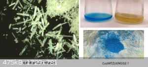

Axt - 18-5-2025 at 23:41
I neutralised formic acid with a slight excess of hydrazine then heated the hydrazine formate to 180-190C for 5hrs in an oil bath. After cooling the solid was recrystalised from ethanol/ether gave what I'm assuming to be 4-aminotriazole as a white crystalline precipitate, the melting point of about 80C seems correct.
I mixed the stoichiometric quantities of basic copper carbonate, perchloric acid and 4-aminotriazole to give {[Cu(C2H4N4)3](ClO4)2}n. A light blue precipitate forms immediately, it was stirred for an hour and filtered.
CuCO₃·Cu(OH)₂ 0.553 g
70% HClO₄ 1.435 g
4-Aminotriazole 1.262 g
Now actually reading the literature (main discussion on pg. 28) they use a considerable excess of copper perchlorate to give the tris-ligand instead of the tetrakis-ligand. I presumably have Cu(C2H4N4)4(ClO4)2. It flares off like blackpowder on ignition but only as a powder, if the caked lumps are ignited it flashes in a blue jet of flame, scoots away and deflagration does not propagate.
Does anyone have experience with Cu(C2H4N4)3(ClO4)2 or Cu(C2H4N4)4(ClO4)2? What are their "vehemic" properties?

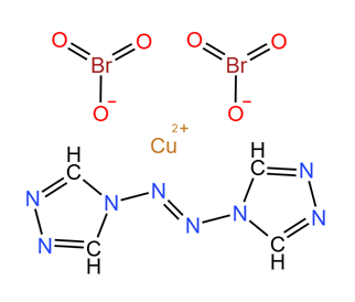

Attaching the hypochlorite oxidation of 4-aminotriazole to 4,4′-azo-1,2,4-triazole. The complexes of zinc perchlorate and copper nitrate given probably have no practical interest being hydrates but other experimentation may be interesting, being that 4,4′-azobis(1,2,4-triazole) is itself an explosive.
The other which may be more convenient is with sodium dichloroisocyanurate.
Qi, C., Li, S.-H., Li, Y.-C., Wang, Y., Chen, X.-K., & Pang, S.-P. (2011). A novel stable high-nitrogen energetic material: 4,4′-azobis(1,2,4-triazole). Journal of Materials Chemistry, 21(9), 3221. doi:10.1039/c0jm02970j gives explosive props of 4,4′-azo-1,2,4-triazole. (file size too large to attach)
Density = 1.62 g/cm3
VOD = 7520 m/s
Det. pres. = 23.5 GPa
Impact sens. = 14J (about half sensitivity of RDX)
Friction sens. = Slightly more sensitive than RDX
Low static sensitivity.

Axt - 13-6-2025 at 03:51
Cu (4,4′-azo-1,2,4-triazole) Bromate (BLG-1)
Cu(C4H4N8)(BrO3)2
https://pubs.rsc.org/en/content/articlelanding/2023/mh/d3mh0...
It's a 2023 paper. The claim is 3mg to initiate RDX and 1mg for CL-20 that is the most efficient I've seen. They are also claiming lower sensitivity than lead azide but we know how these Chinese claims go.
Prep for 4,4′-azo-1,2,4-triazole is linked on previous page, precursor is 4-aminotriazole, a derivative of hydrazine and formic acid followed by hypochlorite oxidation to the azo bridged compound.
[Edited on 13-6-2025 by Axt]

Microtek - 14-6-2025 at 08:23
Yet another great find Axt. I looked through the supplementary material, and I think it looks promising. The photos of the lead plate tests with 30-70 mg neat BLG-1 are quite convincing assuming they are not a complete fabrication.
I will have to prepare some bromate, but in the meantime I've tried with perchlorate as the oxidizing counterion:
1 mmol 4,4'-azo-1,2,4-triazole was dissolved in about 7 ml hot distilled water along with a little HClO4. 1 mmol Cu(ClO4)2 was prepared by dissolving 0.5 mmol Cu2CO3(OH)2 in slightly more than 2 mmol diluted HClO4.
Once all the 4,4'-azo-1,2,4-triazole was in solution, the Cu(ClO4)2 soln was added dropwise. This caused immediate precipitation of a blue solid. At time of writing, I'm allowing the mix to come to room temp with stirring.

I also prepared som KBrO3, so I'm almost ready to see if the bromate complex is as impressive as the paper claims. Regardless, I think that the performance of Cu(atrz)n(ClO4)2 calls for making some more 4,4'-atrz. I will try the hypochlorite method to see if it is more convenient than the one using SDIC.

Cyanuric acid seems to be significantly soluble in hot water (from chemister.ru)
water: 0.27 (25.5°C) [Ref.]
water: 0.7 (50°C) [Ref.]
water: 2.6 (90°C) [Ref.]
Вирпша З., Бжезиньский Я. Аминопласты. - М.: Химия, 1973 pp. 28 [Russian]
I can't see why a hot basic solution (bicarb?) couldn't be used. I cannot find data for sodium cyanurate, only that it's "soluble". This assumes ATRZ hasn't an amphoteric nature, it's "weakly basic" although not basic enough to form isolatable acid salts. This is the reason its iodate "salts" in the table above are cocrystals not true salts.
Edit: Looking up the pKa, it looks like you'd only get a monosodium cyanurate with bicarb. You might be able to get a disodium cyanurate with carbonate and trisodium with hydroxide. The solubility of the mono is still low at "0.8%" https://www.msdsdigital.com/system/files/MONOSODIUM_CYANURAT... . No data on disodium, trisodium is high at 1000g/L https://www.echemi.com/sds/cyanuricacidtrisodiumsalt-pid_Sev... .
[Edited on 18-6-2025 by Axt]
Microtek - 17-6-2025 at 23:43
Yes, the problem is that 4,4'-aztr follows about the same solubility curve; very low solubility at lower temps, and then increasing significantly as you get above ~60 C. I'm planning on charting the solubility of 4,4'-aztr in order to find a workable strategy, but I only have about 0.1 g left. I will see if it reacts with NaOH.
Edit:
I did a quick melting point measurement on the mystery substance and it melts with decomposition at about 200 C, so it seems to probably be a chlorinated derivative of 4,4'-aztr. When exposed to flame, it puffs off semi-energetically. The question is if it is possible to do anything interesting with it, like maybe replacing some of the chlorine atoms with azide groups.
I also followed the "chlorinated azotriazole" paper's method for 4,4'-aztr using SDIC. When I added the aminotriazole soln in one portion (to avoid having a molar excess of SDIC) the temp shot up to 50 C with a little effervescence. It is stirring and slowly cooling now, and we will then see about the isolation of the product.
[Edited on 18-6-2025 by Microtek]

The idea of neutralizing the cyanuric acid seems to work well. I did a SDIC based coupling reaction, filtered to isolate the solid products and then added three molar equivalents of ca. 1M NaOH assuming full recovery of cyanuric acid. After stirring about 10 seconds, the mix was vacuum filtered and washed with a small amount of water. The filter cake was recrystallized from the minimum amount of boiling water, with slow cooling resulting in well defined pale yellow needle shaped crystals in decent yield. I still need to make sure that the crystals are in fact 4,4'-AZTR, but I am fairly sure that they are, based on the way they behave on flame contact as well as solubility.
Edit:
I did a "melting" point test with a small amount of the predried (110 C, 30 min) crystals. No change was observed up to 300 C, but shortly thereafter the sample exploded with a sharp report that left my ears ringing. Curiously, the capillary tube I was doing the test in didn't shatter.
[Edited on 24-6-2025 by Microtek]

Microtek - 25-6-2025 at 13:38
I prepared what I believe to be BLG-1. 1 mmol aztr and 2 mmol KBrO3 was dissolved in 10 ml water at 70 C. Then a soln of 1 mmol CuSO4*5H2O was added dropwise with stirring. There was no immediate precipitate, but after 1 hour of continued stirring while the temperature slowly dropped a dense blue solid had formed. This was filtered off and washed with a small amount of water, and the product was dried 30 minutes at 110 C. Yield was 48%.
The product pops if ignited from above in very small amounts, and detonates if flame heated from below. In fact it behaves a lot like NAP, though it leaves more soot.
I did initiation tests in which 200 mg RDX was pressed into a brass tube (7.0 mm ID, 0.5 mm wall thickness) at about 25 MPa. On top of this, 10 mg BLG-1 was lightly pressed. A 3d printed flash cap with a little gun cotton was inserted, and the assembly was fired against a witness plate (steel, 2 mm thickness). Full detonation was achieved with a deep dent and spalling of the back side.
The test was repeated with 4-5 mg of BLG-1 (my scale only has a resolution of 1 mg, so these small masses begin to be a little uncertain), and again the base charge detonated. It was noted that the RDX seemed a little under initiated with a less pronounced dent and no spalling. It is quite possible that the RDX could be initiated with just 3 mg as claimed in the paper, but that really wouldn't be desirable. Already 4-5 mg is not enough to cover a 7 mm disc in a continuous layer, so I doubt I would ever want to use less than maybe 10 mg.
At any rate I now need to look into the sensitivity of the substance, and I will also revisit the perchlorate analogue with my new batch of AZTR which seems to be much more pure than the one I used earlier.

Axt - 6-7-2025 at 05:33
Hmmm. I recrystalised the azotriazole and yes, small matted felt-like needles that peel off the filter paper (attached), fast deflagration with no residue. Attempted BLG-1 but used ATRZ, copper nitrate and sodium bromate, 1:1:2 the process matched your experience blue crystals precipitating not immediately but on standing for an hour, but it is quite timid when ignited. Significantly slower than even the copper aminotriazole perchlorate although faster than nickel aminoguanidine nitrate. It makes me think the nitrate has precipitated preferentially. I don't have much left to test, but it would be good to run it again sans bromate and see if the nitrate product matches this product. It is still quite impact sensitive, but produces a weak snap not an ear splitting crack that you'd expect.

Combining these two solutions while hot, leaving in fridge overnight seemingly gave the correct compound. Didn't measure yield but the filtrate was clear. It's a distinct cyan colour rather than the light blue.
Approx molar ratio C₄H₄N₈ : NaBrO₃ : CH₃COOH : Cu₂(OH)₂CO₃ = 3 : 28 : 8 : 1
0.3 g ATRZ
2.5 g NaBrO3
25 mL Water
0.13 g basic copper carbonate
0.32 g 90% acetic acid
25 mL Water
Microtek - 7-7-2025 at 23:29
I see you use a large excess of bromate. Did that improve yields relative to what I got? I used the stoichiometric ratio for all reactants and noted a slight blue tint to the filtrate, indicating that not all the copper ions were pricipitated.
Axt - 8-7-2025 at 00:41
I can't say anymore than the filtrate was clear.
I measured the filter paper vs a non-used paper and it come out a yield of about 180% :/ no amount of meddling with the reactive species will give this. I didn't try scaping it all off to get a proper measurement. With such a small quantity (100% would be 0.57 g) the overshoot could easily be explained by different paper weights and the excess bromate soaking into and drying in the paper (I just used kitchen absorbent paper to filter).
This did take more than the hour to precipitate, it was quite slow in this ratio and concentration.
