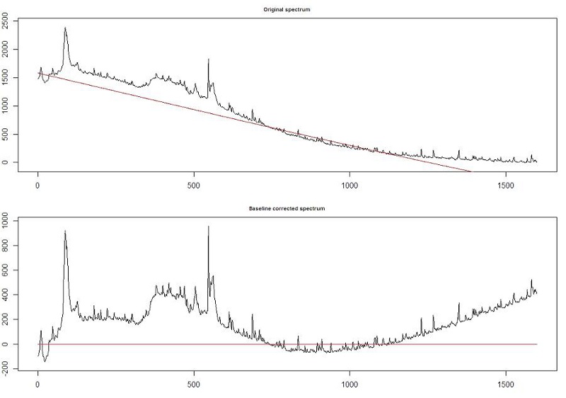

Quote: Originally posted by radagast  | | Assuming that fluorescence doesn't increase equally across the wavelength range while cranking up the laser's power (and I don't see why it would),
this might account for the background hump. | Fluorescence is the absorption and re-emission of photons, so
its emission spectrum is generally independent of the pumping energy. Emission lines are doppler-broadened for each transition, so with (a) a
room-temperature sample and (b) a spectrometer that doesn't discriminate with really fine resolution and (c) a laser with a broad emission spectrum
and (d) and an organic sample with lots of transitions, you'll end up with a big hump like you're seeing. (a), (b), and (c) each contribute their own
convolution width, and (d) means you're summing more than one Gaussian together.
What to do about it is another thing entirely. In the time-resolution paper I posted up-thread, they're using extraordinary sharp pulses and using a
photomultiplier tube in single-photon mode to count. They're not doing simultaneous measurements at different frequencies; they're scanning. So that's
not the easiest way to improve fluorescence rejection.
