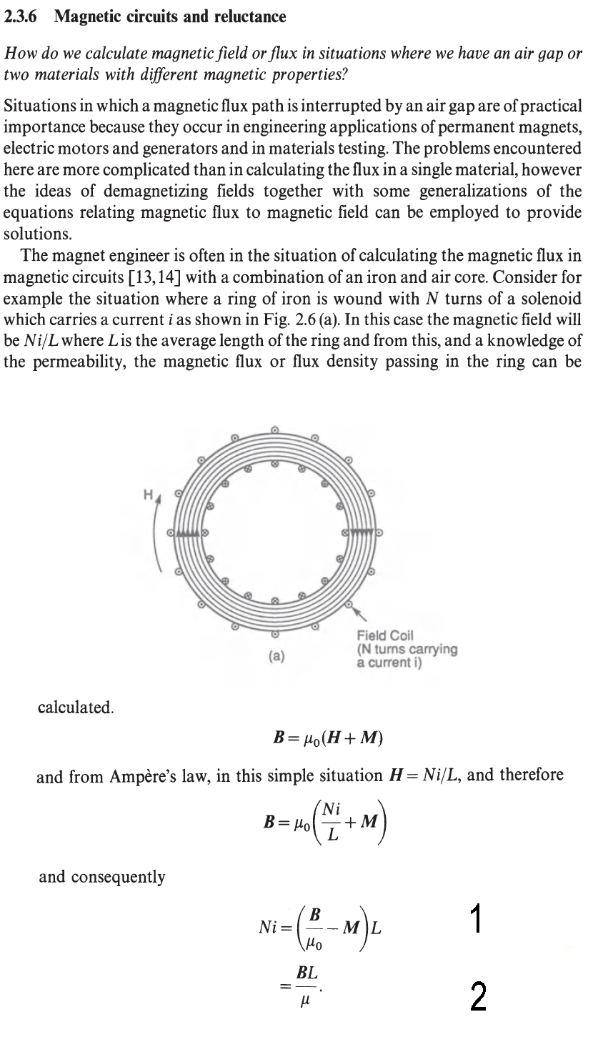

yobbo II - 21-9-2023 at 11:35
Maths leg up required (get out the spoons)
Can anyone tell me how to get from line 1 to line 2 in the pictures attached.
Thanks,
Yob
mag.gif - 104kBmag_2.gif - 117kB
yobbo II - 3-10-2023 at 16:52
This case is now closed :cool:
B = UoH + UoM
UoM = B - UoH
Divide both sides by H
Uo X = (B/H) - Uo [ X = M/H = susceptance = Ur -1 BTW]
Uo(Ur - 1) = (B/H) - Uo
UoUr - Uo = (B/H) - Uo
B = UoUrH
B = U H
and the second one
B = Uo(H + M)
B = Uo(Ni/L + M) H = Ni/L
B = UoUr(HI/L) FROM RESULT ABOVE
B = U Ni/L
Ni = BL/U
Cheers,
Yob
