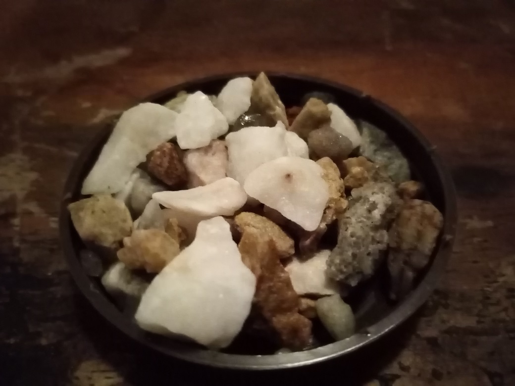

Amos - 11-10-2014 at 20:25
I chiefly use pieces of quartz salvaged from geodes; they're free and easy to obtain and they get the job done really well.

I have recently been doing a lot of EtOH distillations and for boiling stones I have been using these
stones.jpg - 136kB
STONES, from the garden - they work really well giving a stable rolling boil.
Borosilicate glass is harder than Marble and so far no signs of scratching
pneumatician - 3-9-2020 at 07:12
I distil a lot of wine & EtOH and NEVER put anything in the flask, no bumping. You put too much heat power???? Use allways the lower heat necessary, you will save yourself a lot of trouble.
Sulaiman - 3-9-2020 at 14:57
I guess that you are doing simple distillations only, with no fractionating column?
(or possibly a poor fractionating column such as a Vigreux)
