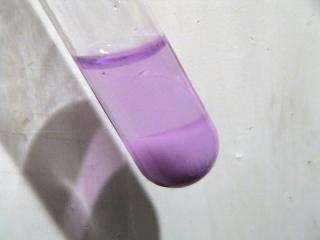

I did some experiments with nickel(II) ions and ethylene diamine. This combination affords remarkable colorful chemistry and as a bonus one can make a nice energetic compound as well.
http://woelen.homescience.net/science/chem/exps/Ni_en_comple...
I hope to do more experiments, one of my goals is to isolate the perchlorate salt of the deep blue bis(en) complex. I can imagine that this is even more energetic than the perchlorate salt of the tris(en) complex, because of better oxygen balance. The effect may be neutered, however, by the presence of two water ligands in the bis(en) complex, but if I can isolate this complex, then I certainly will try this and compare it with the tris(en) complex of which I still have almost 1 gram around and which can be stored safely.

woelen - 15-9-2013 at 08:58
Failed attempt to isolate the blue bis(ethylene diamine) bi aqua nickel(II) complex
In this experiment, an excess amount of nickel(II) carbonate was added to an approximately 15% by weight solution of perchloric acid. After the initial fizzling, the solution was heated for quite some time to assure that all perchloric acid is consumed. The result is a turbid liquid, which has a high concentration of nickel perchlorate, with finely suspended solid nickel carbonate in it.
The solution was poured in a thin test tube which was put aside for two days, with a rubber stopper on it to assure no dust could enter the test tube. After two days there was a perfectly clear bright green solution on top of a thin layer of pale green precipitate (unreacted remains of the nickel carbonate). Using a pasteur pipette with a long needle-like tip, the clear liquid is sucked away from the precipitate and transferred to a separate test tube.
Drops of a 25% solution of ethylene diamine are added to the bright green liquid, until the liquid has a deep blue color. After each drop the liquid is shaked to assure good mixing. Addition of drops does not lead to formation of precipitates. First the liquid becomes cyan, then light blue like dilute copper sulfate and then the liquid darkens after addition of each drop. As soon as a single drop did not cause any visible deepening of the blue color, addition of ethylene diamine was stopped. The end result was a beautiful deep blue liquid, much like the liquid, shown in one of the pictures above.
The deep blue solution was transferred to a petri dish and put in a warm dry place, free of dust. After one day, the volume of liquid was less than when it was made and the color of the liquid still was deep blue. After two days, all liquid had evaporated, but no nice dry crystalline mass was produced. A dirty-looking, very sticky, green/brown paste was sticking to the glass of the petri dish. After yet another half a day, the sticky tar-like material still was tar-like (like a nearly dry syrup, which does not dry further). It could be scraped off, but it remained sticking to the spatula.
The dark green/brown paste was not kept around, some water was added to it to see whether it can be reverted to the nice deep blue solution. This is not the case. The paste does dissolve fairly easily, but it gives a turbid pale blue liquid. Probably the pale liquid contains some of the bis-ethylene diamine complex, but also a lot of nickel hydroxide.
The isolation of the complex did not succeed. A small excess amount of ethylene diamine was added to the turbid pale blue liquid and this immediately caused formation of a very fine purple precipitate and formation of the violet liquid. This liquid was heated and even gentle heating was sufficient to make it completely clear and deep violet. On cooling down, many nice glittering violet crystals were produced of tris(ethylene diamine) nickel(II) perchlorate. The liquid above these crystals was decanted and these crystals were dried in the same way as described above.
So, it can be concluded that the tris-complex can be isolated perfectly well, but the bis-complex cannot easily be isolated. Most likely this is due to the more labile properties of the complex and partial loss of ethylene diamine from the liquid when it is allowed to evaporate to dryness.

woelen - 18-9-2013 at 03:58
I added (en) to the turbid liquid and when this is done, it immediately becomes clear and purple, due to formation of the tris(en) complex. I added too much (en) for formation of intermediate complexes.

I tried the experiment with copper. This is not as easy as the preparation of the nickel complex. I have the impression that I do not get any crystals from the solution, while it is quite concentrated.
I used CuO and 30% HClO4. I dissolved a slight excess amount of CuO in 30% HClO4. This requires quite some heating to get the last amount of HClO4 reacted. The final product is a turbid dark blue solution. When one or two drops of HClO4 are added to the turbid solution, then it becomes clear and deep blue, but then it also contains excess HClO4, which is not what I want.
To this turbid blue solution, I added some pure ethylene diamine. This reaction is more exothermic than I expected. The result is a deep blue liquid, which after standing for a while becomes turbid and on heating, it does not become clear again, but light blue solid material deposits on the bottom. This most likely is Cu(OH)2 or some basic copper perchlorate. So, I added quite a lot more ethylene diamine. When this is done, then the solution turns more purple/blue instead of deep royal blue. This purple solution remains clear, also on heating to boiling.
I now have the blue/purple solution standing and hope to see formation of crystals from this solution. This solution is a little viscous and it sticks to the glass.
One day later: A large amount of crystalline solid has settled at the bottom, I am really amazed to see how much solid separates from the liquid. The liquid apparently can be hugely oversaturated.
I put the liquid in a freezer for some time, such that its temperature drops to well below 0 C, but not so cold that the dark blue liquid freezes. When this is done, then even more crystalline solid separates.
I decanted the ice cold purple/blue liquid from the crystal mass and put the material on a filter paper, which in turn is put on a pile of paper tissue. I firmly pressed the material in the filter paper between the paper tissue. By repeating this two times with fresh paper tissue, I obtained a fairly dry crystal mass (crystal size in the order of magnitude of 1 mm). The damp crystals were put in a warm dry place and after a few hours they were perfectly dry.
Properties of the material:
- dark blue/purple crystals
- dissolves in water with some difficulty (e.g. like KClO3)
- the solution is clear and has a very deep purple/blue color
- non-hygroscopic
On heating in a flame, the crystals pop and crackle with a beautiful blue flash. If the material is put on a small spatula, and the spatula is heated from below, then when the temperature reaches a sufficiently high value, the material explodes, giving only a weak blue flash, but an impressively loud and full report.
Compared to the nickel-complex I have the impression that this material is more explosive. It ignites more easily and the audible effect is stronger.
Pictures and video will follow soon.
[Edited on 14-10-13 by woelen]

An attempt at tris(ethylene diamine) nickel(II) hydroxide
Bezaleel - 6-11-2013 at 08:17
Yesterday, I made an ethylene diamine nickel complex in the following manner. Half a spatula full of wet nickel(II)hydroxide was put in a test tube and about 2cm of demi water were added. To this approximately 0.7ml of ethylene diamine were added.
The hydroxide attached to the glass of the tube immediately received a pink-purplish layer on the outside. On the inside it remained green, and in between was a dark blue region. The hydroxide in the water turned a bit whitish. After shaking and standing for a minute, everything had become pink-purple, just as the tris(ethylene diamine) complexes produced by Woelen at the beginning of this thread. It surprised me that the liquid on top of the pink-purple precipitate was also pink-purple. Apparently the newly formed substance is somewhat soluble in water.
IMG_9185_adjFM.jpg - 7kB
The picture was taken under incandescent light, and white balance corrected to represent the colour correctly. Under the light of mercury vapour lamps, the colour of the pictures became far too blue.
Note that the nickel(II)hydroxide was not entirely pure. It was created by adding an NaOH solution to a solution of black nickel oxide in hydrochloric acid solution. The hydroxide was used without further purification.
DraconicAcid - 6-11-2013 at 09:10
Nice nickel.
I've seen a sample of [Ni(en)3]Cl2, which was made by accident. The students were supposed to be making NEt4NiCl4 by dissolving nickel(II) chloride in ethanol, adding triethylformate, and then adding tetraethylammonium chloride. One student accidentally added ethylenediamine instead of triethylformate (they both said "ethyl" in the name somewhere, you can't blame her for not reading the entire label....honest!), and got an instant precipitate of a very similar purple material.
I'm not surprised that it's water soluble- many hydroxides of complex ions are perfectly water-soluble, in stark contrast to the simple hydroxides.
woelen - 6-11-2013 at 23:27
Interesting to see that you can get a hydroxide complex as well. This can be a good starting point for many other complexes. It would be interesting to see how it behaves if dilute sulphuric acid is added very carefully, such that the hydroxide is just neutralized. Does the hydroxide react first, or is the (en) protonated, resulting in destruction of the complex?
I have done a similar small experiment, by adding some CuO to a solution of (en) in water. If this is done, then the CuO partially dissolves, giving a blue/purple solution.
