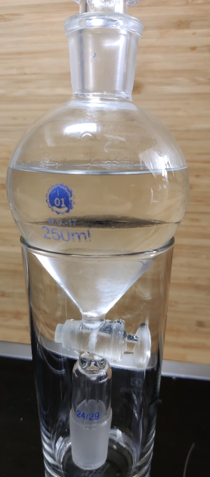

Sciocrat - 5-7-2010 at 12:29
This experiment has been based on the patent (US2796443) mentioned in this post. Since I need to acquire some sodium ethoxide, I decided to give this method a chance, because I would very much like to avoid ordering pure Na, which is quite expensive where I live.
Following the ROH + MOH <-> ROM + HOH equation, and having in mind that the patent states that a surplus of 0.1 to 0.4 (in my case ~0.12) moles of NaOH should be added, in addition to the stoichiometric amount, I added about 250 ml of 96% ethanol (4.11 moles) to 200 grams of NaOH (5.00 moles).
When the ethanol was added to the sodium hydroxide, a quite amount of heat was evolved relatively fast. A moment later, the cylindrical beaker was placed in a hot water bath in order to achieve and mantain the temperature around 70°C. When the solution reached the mentioned temperature, I left the reaction to carry on for half an hour.
(click for a larger pic)
The result can be seen on the image above. As stated in the patent, there is indeed a dense fraction that can be seen reaching a bit above the layer of NaOH (picture to the right). This should be composed mainly of water and sodium hydroxide. The solution above the mantioned fraction should contain mostly ethanol and sodium ethoxide.
I didn't expect these two fractions to be that clearly separated, but it certainly did help in the separation of the two, which was done by slowly extracting the alkoxide layer with a pipette, soon after the picture was taken.
The obtained solution has just a slight yellowish color, although you can see that the upper layer of the NaOH is clearly yellow colored, while at the bottom, the NaOH has a clean white color which is also conforming to the patent which claims that the alkoxide rises upwards during the process.
I'm not sure what would be the best way to extract the ethoxide from the solution. I was thinking about distilling the solution until the ethoxide starts to crystallize and then cool the solution to the lowest temperature that I can achieve over a longer period of time (~ -26°C ), in order to lower its solubility. Then the ethoxide would be separated by simple filtration?
[Edited on 5-7-2010 by Sciocrat]

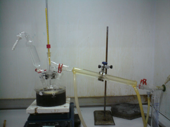

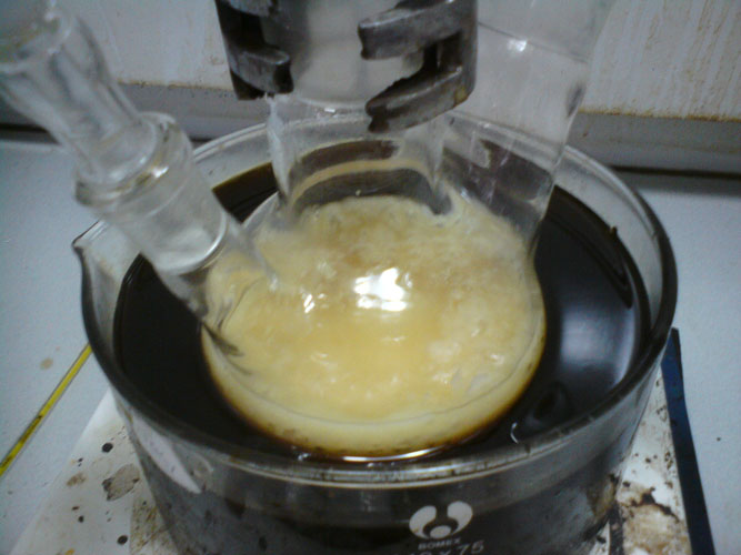

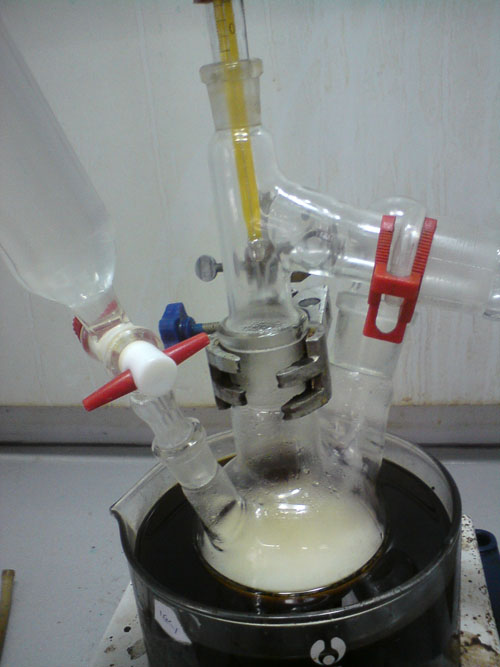

Waffles SS - 13-1-2014 at 08:39
I tried to make sodium ethoxide by reaction of anhydrous ethanol with Sodium hydroxide.
I distilled mixture for bring out the Ethanol that make azetrope with water and added more anhydrous ethanol for pushing this reaction to right side.
NaOH + EtOH <==>NaOEt + H2O
I used 40gr(1 mole) NaOH and 92gr EtOH(2mole) also added 400 cc excess Ethanol for making azetrope with water but it seems no Ethoxide formed.
I checked density of distilled ethanol and that was 0.793(near dry ethanol)and also i added calcium oxide to it but temp didnt increase.
somebody has experience on this reaction?

blogfast25 - 13-1-2014 at 13:19
Waffles:
Have you tried the procedure that uses acetone as an anti-solvent to precipitate the NaOEt? See top of this page for patent and links. That appears to work well for short chain alkoxides.
Nicodem - 14-1-2014 at 10:18
The difference of bp between the azeotrope and pure ethanol is less than half Kelvin. There is no way you could quantitatively remove water with a distillation employing such an insignificant difference, not even if you used a distillation column. You would need to add toluene to make a ternary azeotrope with some significant bp difference and still you would need to apply a distillation column.
Waffles SS - 14-1-2014 at 22:07
How much toluene is needed?can you send picture of your suggested system?just i add distillation column?
Waffles:
I tried it before.
I reflux 1mole KOH with 2 mole EtOH for 3 hours and then i added anhydrous acetone but i got no precipitate
Metacelsus - 15-1-2014 at 08:25
You don't need to reflux; just make sure all the KOH dissolves. I would suggest making a saturated solution.

But, to the topic. I couldn't wait for my lab and did some rudimentary tests with my own boka-fractionated, polished and diluted 40ABV vodka and NaOH.
I first added a small amount of vodka, and added NaOH pellets and stirred, until separate layers were formed.
funnel1.jpg - 86kB
Then I added more, between 200-250mL, and added more NaOH and stirred, and the liquid heated up a lot, but not too much to handle the funnel. I kept adding NaOH little by little, until layers were separated. They formed bubbles and the boundary closed in just as in any biphasic extraction. The activated carbon residue used to polish the distillate can be clearly seen at the boundary.
funnel2.jpg - 91kB
The extracted upper layer was at first attempted to drain into a tube for ABV meter, but it had a pinhole, which caused a little leak. Actual measuring cylinder was dug through the rubble, and the ABV measurement and volumetric measurement were conducted. The ABV reported pretty much exactly 0ABV, but I hardly believe the alcohol layer would have been the bottom layer, as the upper layer had a very burning alcoholic odor, but the ABV meter is very sensitive and the most likely explanation is dissolved NaOH, ethoxide and other stuff. The total collected volume was 86.5mL as seen, which checks in the ballpark with the input alcohol, at 40ABV by rough calculation and dilution.
The amount of NaOH required is a lot, but not hefty, and obviously as this was 40ABV, the required amount would be inherently larger than when separating azeotropic product.
It should be distilled and remeasured to see if the resulting product is closer to anhydrous ethanol, but at least the very clear layer separation caught my curiosity if ethanol can be salted out from water with NaOH to make actual close-anhydrous ethanol.
Btw, the OP's funnel concept works for the part that it does form a layer close to the edge of the NaOH pellet mass - but the NaOH will completely clog the funnel and form a cone-shaped conglomerate that is very hard to break down and will prevent draining any liquid, even when poked with piano wire from the drainhead. Instead, just adding ethanol to funnel and adding NaOH pellets and shaking until layer separation occurs could be a more viable option. I have currently a batch of azeo EtOH stirring over MgSO4/CaSO4, and I'll probably strip a sample to see if any desiccation has been occured, and if not, I will do a full-scale treat on the batch and see what the resulting product will be. It is likely I'll do it anyway, because I'm running out of ethanol and simply treating the wiper fluid directly with mass of NaOH will both destroy MEK, detergents and additives and keep the residual water, so pretty decent ethanol should be able to be stripped directly off it.
For the record, I have stripped several batches of ethanol from this wiper fluid product. It consists of azeotropic ethanol, denaturants, detergents and additives to enhance the welfare of automobiles, aka crap that NaOH eats for breakfast. I double distilled this stuff, first directly and then with NaOH, although I only used 4% per weight mostly to kill MEK, I remember getting readings over 100ABV with the warm condensate, so apparently most of the water was also left behind. Using more, up to 10% per weight could be even more efficient, but in the long run it would be nice to find the spot at when the returns do not increase anymore and the rest is wasted as ethoxide.
