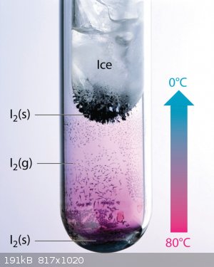

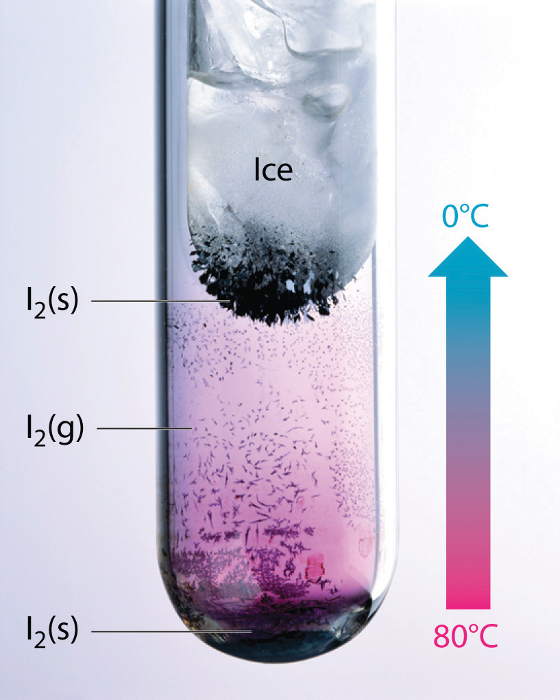

Heating iodine

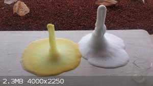

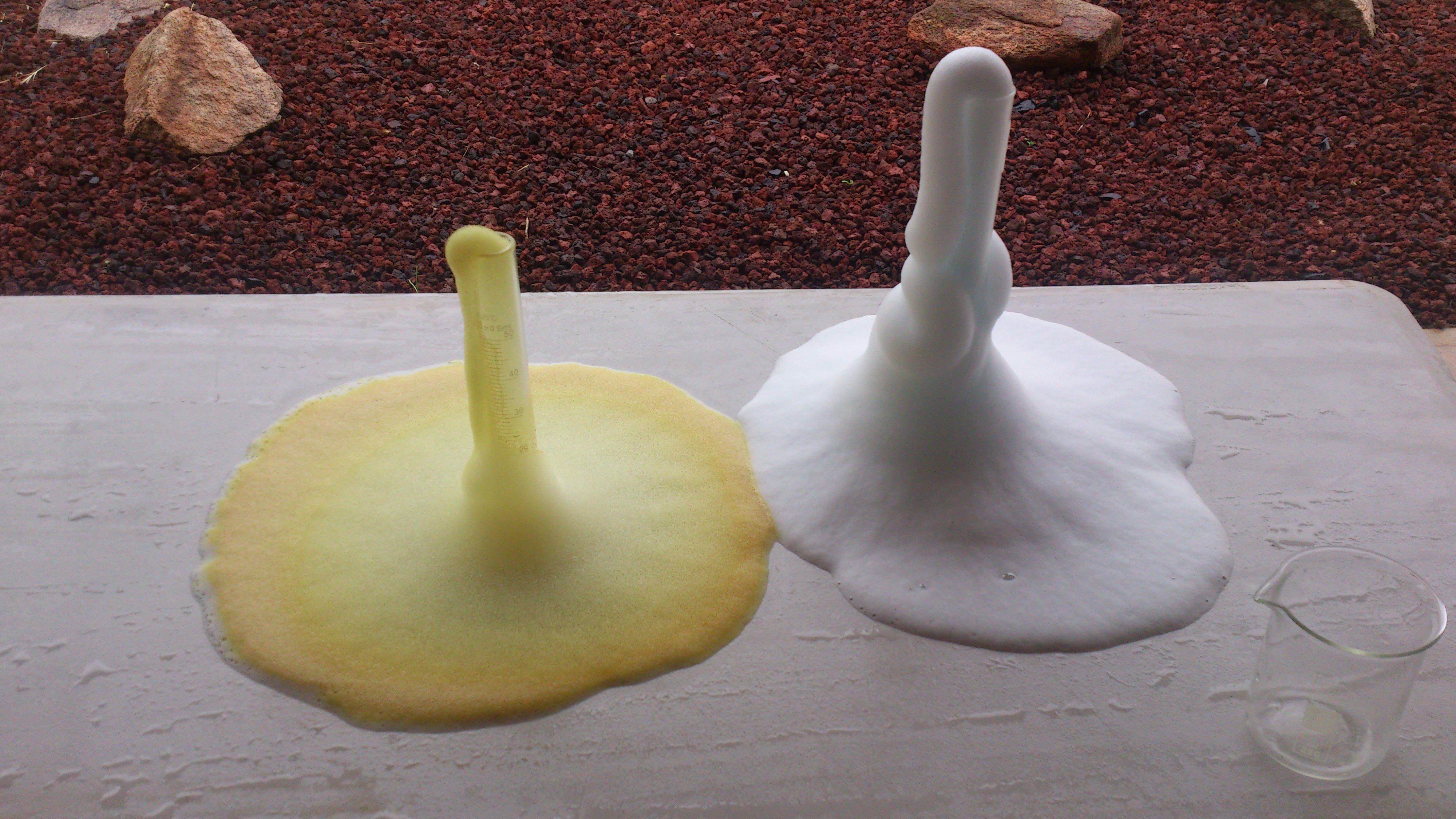

I tried to perform the elephant toothpaste reaction many times today without very impressive results,
I first tried 50ml of 50% H2O2, 5g potassium iodide solution, 25ml kitchen detergent (poor result) followed by the same amounts but replacing the kitchen detergent with sugar soap ( a little better this time)
Then I tried the same amounts of H2O2 and potassium iodide with a much smaller, unmeasured amount of sugar soap but still didn't achieve the impressive expansion of foam expected with this novelty reaction.
I thought it could be an issue with the 2 different bottles of H2O2 I tried and have had in storage for a long time so I bought a fresh bottle at the local hydroponic store but still had the same results.
Any ideas what might be going wrong?
DSC_2411.jpg - 2.3MB
MrHomeScientist - 24-3-2016 at 09:22
Three things:
- How concentrated is your "potassium iodide solution"?
- You're using a ton of soap, which I'm sure is diluting and slowing the reaction.
- You can easily check the concentration of your peroxide to make sure it hasn't degraded by measuring the density, and using this calculator.
Our version of elephant toothpaste uses 125mL of 35% H<sub>2</sub>O<sub>2</sub> with maybe < 10mL liquid dish soap, just enough to lightly color the solution and produce bubbles. To this we quickly add a solution of 12g KI in 10mL water (so, a saturated KI solution). This is done in a 1000mL plastic graduated cylinder, and shoots a column of foam out the top several feet in the air.
One time the manufacturer accidentally filled one of our 35% bottles with 50% peroxide, and using the same conditions as above blasted the foam out instantaneously, spraying hot foam onto the presenters. Scary situation. Now we test each new bottle of peroxide before use. Be careful with that strength of peroxide.

NedsHead - 24-3-2016 at 18:31
MrHomeScientist
My Kl is a saturated solution, I add just enough water to disolv the 5g of Kl,
I also thought the amount of soap could be diluting the reaction but when I used considerably less the reaction improved only slightly,
I did do a quick test of the peroxide by dropping a piece of MnO2 into a sample of each, the two old bottles of peroxide reacted mildly, the fresh bottle reacted strongly and produces a thick amount of O2 vapour from the test tube, I'll test the exact concentration of the peroxide like you suggested.
I'll try your measurements and report back

Elephant toothpaste we did, we used 12% peroxide with MnO2 (i think), and just a tiny amount of decent washing up liquid. It was done in a large measuring cylinder and shot all over the place :D.
