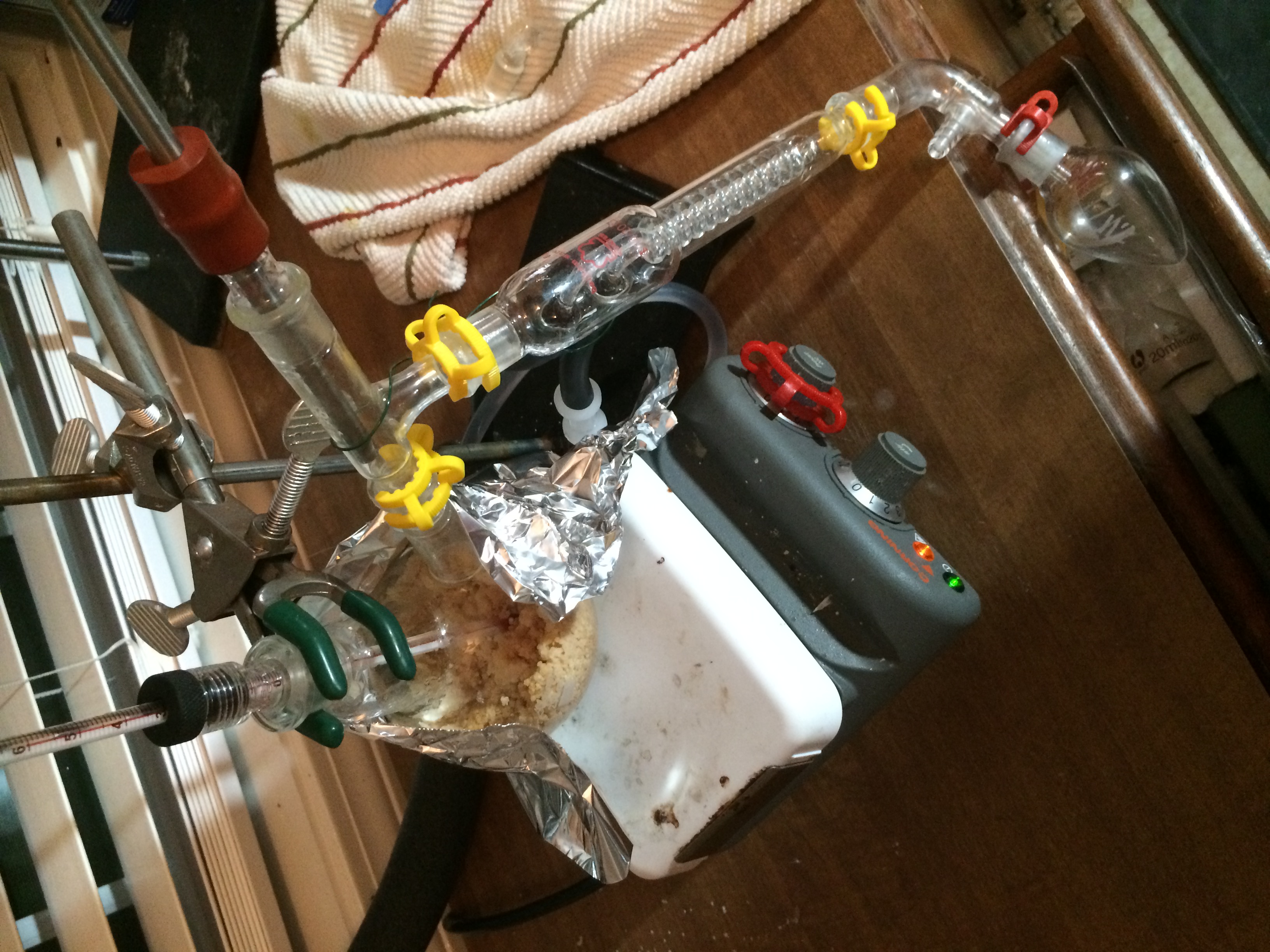

Recently I ran into something really annoying....All over eBay was cheap glacial acetic acid, which was teasing me since no one on eBay will ship acetic acid to Hawaii. At first I wondered " conspiracy " . So I tried several home methods, I ended up using my original Ethyl Acetate + NaOH = Sodium Acetate + 80% H2SO4 = Acetic Acid, it always works, and it is predictable as heck. I wanted to see how much sodium acetate I could make this way in one batch, while managing the exothermic reaction as to not boil of my ethyl acetate, or need exotic cooling. 6 moles is the max at once with SS kitchen stuff and ice. I buy the 99% Ethyl Acetate at the hardware store, in 1 gal cans, where it is now sold as MEK Substitute, thus in the effort to make things more healthy, ethyl acetate went OTC.

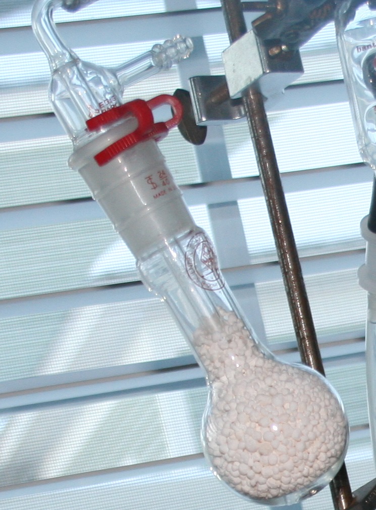

Simply mix the ethyl acetate with lewis lye in a 1 mole NaOH + 1.1 mole Ethyl Acetate ratio, 1.1 since some is lost to evap. I just zero a kitchen scale to the Wally Mart SS beaker, mix x grams of lye, and x grams of ethyl acetate, and the easy part is done. Now you can take a small break, But do not do what I did, and leave even a "Tiny" 1-2 mole jar in the kitchen with your in laws and forget about it, when I remembered, they had already withdrawn from this kitchen and in the jar my sodium acetate ( mostly) was bone dry, so they must have been treated to my new super strength ethyl acetate / alcohol air freshener!
When you mix it, it just sits there....and does nothing for say about 10 min, then ever so slowly the temp rises and warm spots form, heat of course accelerates the reaction. Then the reaction speeds up big time, and requires cooling. I just use a big stainless steel beaker, with an ice filled bowl on top to act as a reflux condensor. With this plopped into an ice bath and me stirring like mad I can control about 6 moles with confidence. It is funny how the small lye prills morph into larger identical shaped sodium acetate prills, for some reason the starting lye physical state is carried forward and perfectly preserved in the first reaction, they are 3-5 times bigger though.
When the reaction subsides, I seal the Sodium Acetate prills in a jar with a jigger of ethyl acetate, for 24 hr, just to make sure there is no lye left.

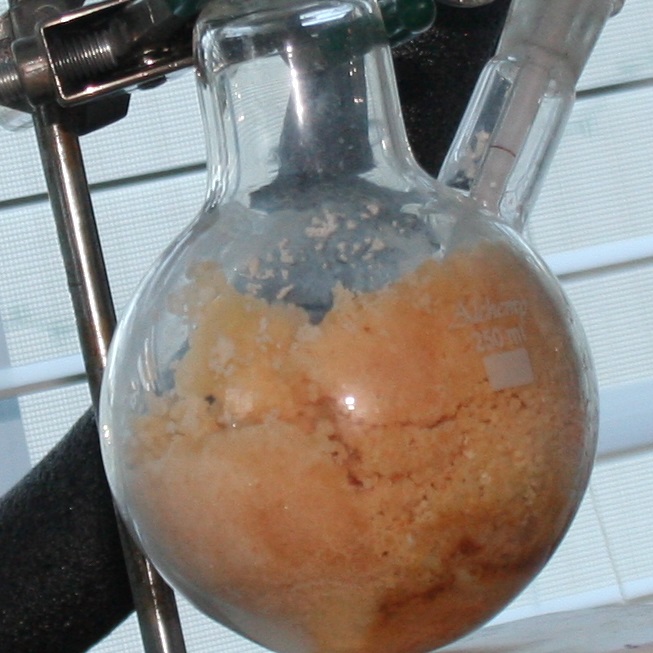

For Distilation:
Since we can't get any non added surficant's, chromates, or other added crap added phosphoric acid here, I use 75-80% sulfuric acid, I am always sure to add the acid to the ice water to make 80%. The reason is at 98% sulfuric chars the Sodium Acetate, and gets way to hot. At 80% it still self distills in the beginning, and reacts fast.
Just for reference one 6 mole batch makes about 350 ml glacial acetic acid. I do not know why acetic acid is so hard to find here, all the organic farmers want it so they can spray weeds with 15-20% acetic acid solution, while keeping your organic farm certification. For me the best part is that you can replant / plant seed the next day : )
Last there is a small bonus in this acetic acid workup, the reaction by product is pure 200 proof ethanol, and its surprisingly easy to get it ethyl acetate free, just distil. I know there are so many ways of making acetic acid, for me this synth. is simply the easiest one for me, with no boiling down 20 liters down to one liter crap.
Enjoy : )

In a nice, heavy, two necked, 250 mL round bottom flask was placed just under 40 g (one mol) sodium hydroxide in fine prills. This flask having one major, central neck and the other splayed off to the side, was fixed just above a stirring hot plate, but initially in an ice bath. A thermometer was placed in the off vertical neck, with the bulb extending below the midpoint of the flask but above the activity area of a stir bar which was then also added. An efficient reflux condenser was fitted in the central, main neck and the circulation of ice water was begun. All tapered glass where joints were greased with high temperature vacuum grease.
After a short time, roughly 99 mL (1 mol ) of hardware store ethyl acetate (Klean Strip MEK Substitute) was added in two separate approximately equal additions. After a couple of minutes of heavy stirring, the 40 g of NaOH was suspended as a slurry in the one half mol of ethyl acetate. The suspension remained at a temperature of 11°C with little or no exothermic action so the other portion of ethyl acetate was added, and a thermometer adapter reinserted.
The ice bath was removed and the flask was heated gently on air bath. Shortly after reaching about 70°C, obvious refluxing began. This was allowed to continue for approximately 2 hours after which time the liquid phase became limited and the solid volume increased markedly. Heating was increased moderately in an attempt to melt the growing mass of crystals. Magnetic stirring was insufficient to move this mass significantly. Very little liquid remained but this did continue to reflux.
The heating was stopped and a calcium chloride guard tube was added to the top of the reflux condenser to prevent the entry of moisture.

One of the goals of this experiment was to produce ethanol and sodium acetate in an anhydrous form. Instead, some of the white solid material was charred and darkened possibly due to oxidation. Very little liquid seems to exist separately from the wet solid.
I am at a loss as to what has happened. I could find no reference to any attempt at performing this saponification with no water added to the initial liquid phase. My guess is that the reaction is halted somewhere short of completion. The still pot smells strongly, as one might expect, somewhere between the ester and the alcohol. The crystals do appear damp and there is some liquid remaining. It was calculated that 58 mL of ethanol would result from 100% conversion.
I attempted to put some litmus paper to a sample drawn out shortly after stopping. I'm not sure what it means the stuff is wet but not with water and doesn't seem too weep into the paper. It may have represented significantly alkaline conditions.
I have some photos. Something I've noticed since halting a couple of days ago. It seems as though the charred coloring has pervaded an ever enlarging mass of crystals. Meaning, initially a dark spot was on the bottom, now the whole large mass of crystals has taken on the discoloration almost evenly. A photo was taken shortly after shutting down using a cell phone. Then, I took some photos today with a somewhat better camera and a lower aspect. Lighting, resolution, angle, camera and time are all changed, so surely my perception is subjective. But clearly the volume of white material is larger now than when we halted a couple of days ago.
I also include a shot of my calcium chloride drying arrangement – I wanted to get something on there quick, before cooling down drew in appreciable air. I wasn't able to pack my tube, plus, it's "college rule" (19/22). That adapter is a nice fritted bubbler (I had lying around), that fits perfectly into that oddly shaped Erlenmeyer flask (stem almost touching the bottom). The barbed end of the fitted tube is unfortunately off screen, but leads through a short piece of rubber tubing to a little 14/20 gas fitting in the top of the condenser.
And speaking of condensers, that little bantumware 14/20 reflux condenser is a really nice rig. It doesn't sweat but you can drive a lot vapor into it and you won't even smell solvent in the room.

I tried this process a couple of times to obtain water-free EtOH over the past 2/3 days at a 2 mol scale.
In practical terms, the NaOH prills do swell up, presumably trapping any EtOH formed, as it becomes a solid lump.
Strong heating in a disty rig didn't even get close to any distillate after 10 minutes, and i suspect (not looked it up) expansion co-efficients would end up with more cracked glass than product, so i stopped. (value the glass more than the booze).
When the solid mass was broken up there was still the distinctive smell of ethyl acetate.
The easiest way to get the lump out of your glassware is to add water, which kind of makes it useless for anhydrous EtOH production for an amateur.
Strong heating was noticed when the water was added, so presumably a lot of unreacted NaOH as well.
At a 0.25 mol scale or less, this reaction will probably work (for getting anhydrous ethanol) if stirred strongly for 24 hrs and with pure reagents.
For producing sodium acetate, it does work, although at bigger scales the yield of sodium acetate will be limited by how well you can thoroughly mix slightly damp solids whilst controlling the temperature.
