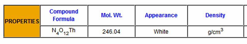

Also, it's Th(NO3)4(H20)4, right? That's what wikipedia says, I don't have my bottle with me right now. I get 552 for the molecular weight.
Yes, it's nominally the tetrahydrate.I feel [slightly] less silly about this error. I referenced the American Elements website to get an anhydrous MW of 246.04 (image attached), and ignoring common sense, I added 4 mol H20 (72.08) to get 318.12.
Notice that on average, there is less than one atom of 212 Po for every mole of 232 Th.
Yes, even in my flawed calculations I got that result. That was rather fascinating.
Well, I should adjust my numbers to see if they jive with yours.
Anhyd. Thorium Nitrate.gif - 12kB

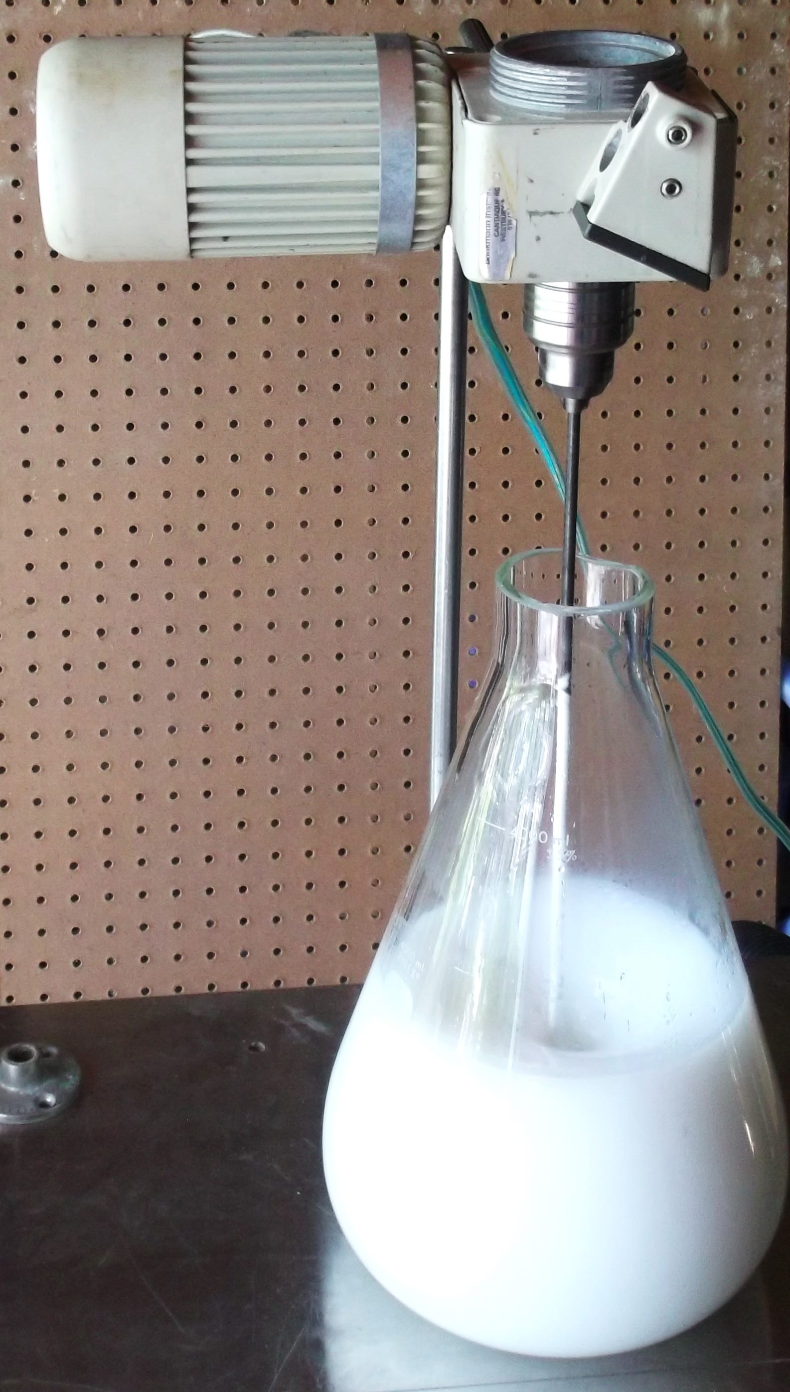

powerful stirrer for the Th(OH)4 : check (It's a re-purposed Buchi stirring motor)
stirrer.jpg - 74kB

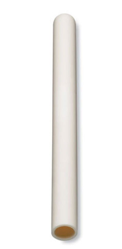

I've been giving the prolonged high temperature calcination step the most thought of all. I see it as clearly the most hazardous by a large margin. This is the step most likely to cause aerosol formation (this and the hydrolytic work up with decomposing Ca causing bubbling), which is really the only thing I fear in this prep. My thinking has radically changed as this project has progressed. I'm much less worried about gamma emanations than the feeble ("I can even go through a sheet of paper") alpha particles. This is the exact same reason that plutonium is so toxic.
I had considered two large silica melting crucibles shaped like bowls. Put them together like a clamshell and heat. But in what? My furnace? I'd rather not contaminate that. So......?
Then this mullite process tube appeared on eBay for only $20. It is 2 inches in OD and a foot long. Wrapping it with Super Kanthal A-1 wire will allow the 900 C that I need, easily. The cool, open end of the process tube can be fitted with an exhaust tube which will carry all effluents to a mineral oil trap.
Mullite tube.jpg - 15kB

Another detail to address is the final filtration. In keeping with the idea of using disposables whenever possible, I need a set-up which will have a provision for blanketing the final, potentially pyrophoric thorium powder with argon, following filtration, until it can be transferred into a vessel connected to vacuum. The blanketing gas should also be supplied in such a way that it can't fail because of positional variations. It also shouldn't blow in such a way as to potentially kick up any of the finest particles.
I previously mentioned, but didn't explain, my method of funnel construction. I used the material pictured as flat sheets (below) to construct the desired apparatus. It's sintered polyethylene and it's porous. I cut slightly tapered disks of the thicker material (for unsupported applications) to be tightly press-fitted into various cut down HDPE bottles (picture 1) which are fitted with a vacuum-tight hose barb (picture 2). By making one unit a loose fit for another, I can provide an argon blanket which is consistent with the given requirements (picture 3).
One other detail worth mentioning from a safety standpoint is the method of grinding the dioxide so as to avoid exposure. It's cheap and quite effective. I transfer everything into a large Zip-Lock freezer bag and simply work through the bag. It's quite easy if you have a small amount of a well-behaved powder like this one. This, plus a respirator and goggles, along with multiple layers of new lab-grade nitrile gloves and working outdoors, makes me feel that exposure is absolutely held to a minimum. I have disposable, full-body plastic/paper suits, which is certainly overkill, for final operations like pressing the powder into compacts for eventual vacuum arc melting.
1.jpg - 449kB 2.jpg - 438kB 3.jpg - 280kB
