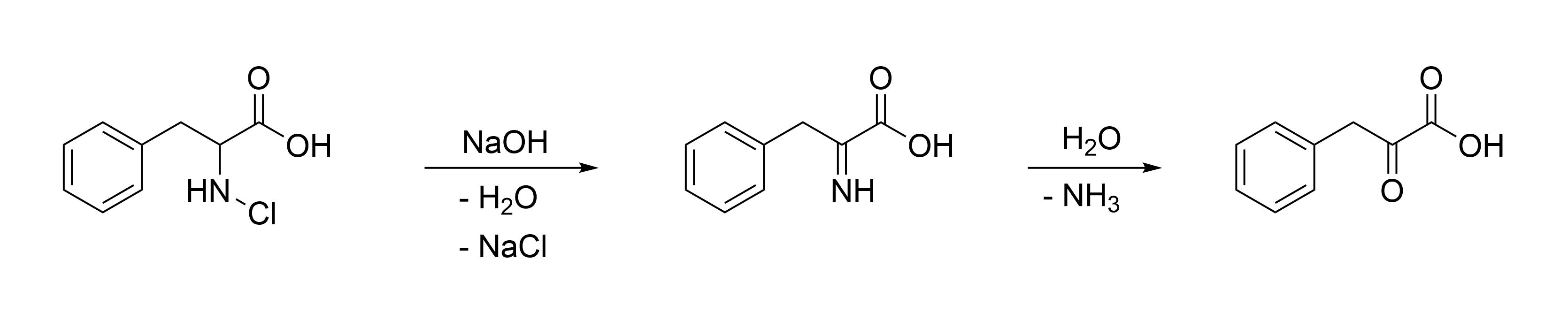

Dr.Bob - 19-3-2015 at 06:05
I would guess that you made some benzyl chloride as a by-product. It is a potent lachrymator, and some people can be sensitized to it and similar compounds (Bz chloroformate is particularly bad) which make them even more potent. When you have certain benzyl groups and a chloride source, there is a chance to make some benzyl chloride. I would guess than the cyanide can act as a good enough leaving group to be displaced by chloride, which is also present.
DJF90 - 19-3-2015 at 06:50
I've worked with phenylacetonitrile before, and remember it has a very penetrating odour sort of in-between that of benzaldehyde and phenylacetic acid. I tried to minimise contact with it due to the fact it is an R26 (T+) compound, and whilst I don't recall any lachrymatory effects, it was handled appropriately in a fumehood. However, the Aldrich MSDS suggests a "burning sensation" as a symptom of exposure.
CuReUS - 20-3-2015 at 02:14
its funny that TCCA would oxidise phenylalanine to phenacetonitrile while bleach will oxidise it to the aldehyde,I thought TCCA was much more powerful that bleach:o

Loptr - 27-4-2015 at 14:05
I thought this might be helpful if added to this content.
The Oxidation of Amino-Acids to Cyanides
H. D. Dakin. Biochem. J. 10, 319 (1916)
This paper establishes the cyanides are produced by the decomposition of previously formed dichloroamino-acids, and are as follows.
R-CH(NH2)-COOH --> R-CH(NCl2)-COOH --> R-CN + 2HCl + CO2
So it seems that an excess of hypochlorite is is required to form the dichloroamino acids, otherwise it seems aldehydes are the products.
Attachment: The Oxidation of Amino-Acids to Cyanides_Dakin.pdf (462kB)
This file has been downloaded 2124 times
[Edited on 28-4-2015 by Loptr]

Yep, next year. The author refers to previous work on the subject, which would have to be even older.
Langheld [Langheld, 1909] only went as far as the monochloroamino acids, which yielded the corresponding aldehydes after hydrolysis. So if using stoichiometric amounts of HOCL yield aldehydes by way of the monochoroamino acid, then two equivalents should result in the nitrile.
I am not sure of its reliability, but I have read in Advances in Taste-and-Odor Treatment and Control that the highest level of phenylacetaldehyde was produced in water treatment plants when the chlorine-to-amino acid ratio was 1.5, under neutral conditions, and a reaction time of 2 hours.
Page 85, taken from Hrudey et al. (1989)
https://books.google.com/books?id=mBnKIRVt4JIC&lpg=PA81&...

Darkstar - 16-2-2017 at 03:22
@Cryolite: As JJay pointed out, there are numerous examples in the literature of hypochlorite being used to convert amino acids into aldehydes, so it would seem that it is indeed possible. For example, the authors of one of the references in the thread JJay linked to claimed to have obtained phenylacetaldehyde from phenylalanine in 60% yield using one equivalent of sodium hypochlorite in aqueous solution. It should be noted, however, that both of their amino acid and sodium hypochlorite solutions were extremely diluted, and a phosphate buffer was used to maintain a pH of around 7. It's also worth mentioning that the hypochlorite solution was added very slowly over the course of ten minutes with constant stirring.
I think the reason Amos failed to produce any phenylacetaldehyde was because he used a large excess of concentrated bleach. I believe the key to getting the aldehyde is keeping the concentration of the hypochlorite as low as possible, while also keeping the pH as close to neutral as possible. The idea here is to chlorinate the nitrogen once and then quickly eliminate the chloro group via decarboxylation. We want to avoid forming an imine through normal E2 elimination prior to the decarboxylation step. By keeping the hypochlorite concentration low, we avoid over-chlorinating the nitrogen; by keeping the pH neutral, we avoid eliminating the chloro group via deprotonation of the adjacent carbon. Also, by keeping the pH closer to neutral, most of the hypochlorite will be in the form of hypochlorous acid, which is most likely the real oxidizing species in these reactions anyway. In Amos's case, the large stoichiometric excess of hypochlorite most likely led to over-chlorination and too high of a pH, favoring the nitrile over the aldehyde.
The reaction we want is this:
decarb1.png - 80kB
The reaction we don't want is this:
decarb2.png - 86kB
The problem with forming the imine before the decarboxylation step is that even if the imine hydrolyzes immediately afterwards, the carboxyl group can't just suddenly leave as CO2 now that it's an alpha-keto acid. Just like in Strecker degradations, something must first act as an electron sink before the carboxyl group can leave, otherwise you inevitably end up with an extremely unfavorable acyl anion intermediate, which are highly unstable and rarely ever observed in practice (if at all).
While I suppose it's possible that an alpha-keto acid intermediate may actually help to facilitate the decarboxylation of unreacted amino acid molecules by condensing with them and acting as an electron sink, the problem is that the reaction mixture is not only aqueous, but extremely dilute as well. So how beneficial this would turn out to be, I don't know. My guess is that something like this would have to happen in order for decarboxylation to occur:
decarb3.png - 505kB
