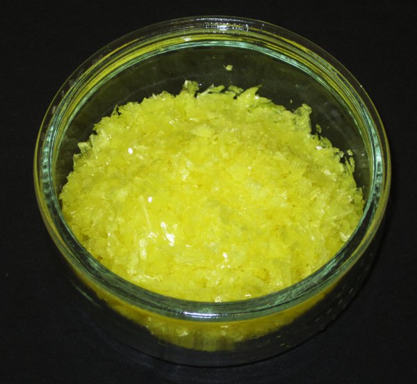

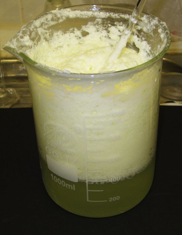

Anyway, heres conventional r-salt through NaNO2/HCl/hexamine. Three solutions were made, one containing 60g 35% HCl in 100ml water, one containing 40g NaNO2 in 80ml water and one containing 20g hexamine and 60g HCl in 100ml water. The NaNO2/HCl solutions are combined, producing blue solution of nitrous acid. This is then added to the hexamine/HCl <0°C. The foam filtered off, dried. Yield was just over 50% right on the documented yield. Melting point on rapid heating was 110°C, close enough to documented temp of 106-7°C. The other possible product (dinitrosopentamethylenetetramine) melts at 207°C so easy to tell apart.
By not mixing the up the nitrous acid first, theres a lot more foaming and heating and often I end up with nothing at all.
R-salt burns easily with soft orange flame leaving residue, with noise but not as vigourously as RDX. Ive never tried to detonate it.

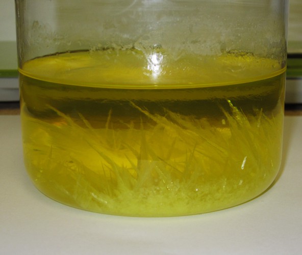

Sorry for the double post but here's the results. Finally a success!
First I added 30 ml of 31.45% HCl to 50 ml water and this was mixed with 18 grams KNO2 in 30 ml water. I then added 7 grams hex to 50 ml water.
http://img.photobucket.com/albums/v78/wolfhound/ct1.jpg
At < 0C I added the nitrous acid to the hexamine solution. At first I thought nothing was happening but then it foamed up quite a bit, almost to the top of the reaction vessel. Then the foam went down as the gas escaped.
http://img.photobucket.com/albums/v78/wolfhound/ct2.jpg
http://img.photobucket.com/albums/v78/wolfhound/ct3.jpg
This was then filtered and now it's drying. I don't know how great the yield is since it's a big air filled blob of wet product still, but I'll measure when it's dry. Either way I'm just happy that it worked.
http://img.photobucket.com/albums/v78/wolfhound/ct4.jpg
I think the first time I tried it I actually did get something but it was an uncontrolled foaming with lots of NO2(?) coming off. So now all that's left is drying and weighing. Just one more question, is there any reason to wash the product to neutralize it? Thank you for the help and I appreciate any input.
