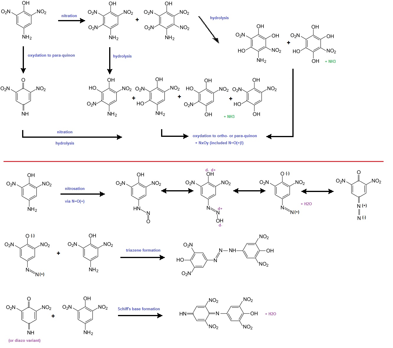

You have initially H2N-C6H2(NO2)2-OH probably as a sulfate.
Adding KNO3 results into liberation of some HNO3.
-->Part of the HNO3 may oxydise the para-amino-phenol into a para-quinon (mono-imine)...
-->Another part may nitrate further the dinitro compound into a trinitro one...or doubtfully to a tetranitro one
I don't think so, but, if it does, then you will have two NO2 on neightbourgs C (ortho vs each other and ortho vs the NH2 for one and vs the OH for the other)...and in such conformation; one of the two neightbourgs NO2 may be expandable/lost by hydrolysis afterwards and lead to even more oxydable molecules (dihydroxyaminobenzene and by further hydrolysis to trihydroxybenzenes (or trihydroxyaminobenzene to tetrahydroxybenzene).
Oxydation of the substrate by HNO3 is concomittant with reduction of HNO3 into NxOy fumes in what nitrosonium is present as NO(+)...a powerful nitrosating agent.
I have seen into a book about diazocompounds a process to make diazoniums starting from an aniline and plain HNO3 only; thus without any nitrite...about half of the HNO3 serves to make the oxydation and NO(+); the other half is used to make the salt diazonium nitrate.
Usually para- and ortho-aminophenol when diazotized makes an unsoluble internal diazonium-oxyde (diazo-phenate); but here maybe the H2SO4 keeps it solubilized? And then it reacts further with unoxydized p-amino-phenol molecule to make a triazene...or a quinone based Schiff's base.
The reaction scheme here-below is simplified since all ortho- and para-quinon (and imines) derived from transcient trinitro and tetranitro derivatives by hydrolysis/oxydation may also react
--> with the NO(+) to make diazoniums
--> or with the free p-amino-phenol molecule to make triazenes or quinon based Schiff's bases.
isopicramic reactions.jpg - 176kB
[Edited on 18-12-2016 by PHILOU Zrealone]
nitro-genes - 2-1-2017 at 14:43
Best wishes for 2017 everyone! Thanks for that scheme Philou, there is probably a lot happening as indeed is usually the case. :)
So here are my further incoherent ramblings regarding the subject :D:
When the product after KN/SA nitration was extracted with ethylacetate, redissolved in a minimum of 80 deg C water, pH adjusted to 6 and KNO3 added, a light yellow-orange coloured compound precipitated, contaminated by a brownish-orange compound, which is most likely pDDNP. The light yellow-orange coloured material is incredibly explosive though, the tiniest specks detonate with considerable strength, much resembling a heavy metal azide. It concurs with desricptions of the potassium salt of DDNR, although a potassium salt of a 1,2 quinone diazide is also possible. Total yield was only about 100 mg or so, so for curiosity purpose only. Most of the ethylacetate extracted stuff is lost when redissolved, so I guess that the 1,2 and 1,4 quinones and accompanying diazo derivatives therefrom are likely far more water soluble than pDDNP and DDNR. The compound could also be a potassium salt of the triazene as indicated in your scheme, though I don't think this is likely under these extremely acidic conditions. Likely, the nitramine is formed first after which several things could happen. Also don't think direct NOx mediated oxidation to the quinone imine is likely under these acidic conditions. When I dissolved purified isopicramic acid in boiling (!) 30% sulfuric acid once, and added potassium nitrite in small portions, almost exclusively pure, crystalline pDDNP was produced as large coarse crystals. The reaction was much slower in this case, likely due to the fact that the anilinium ion is unreactive towards NOx, only the small amount of dissociated and free acid reacting. Then again, these temperatures would also lead to fast decomposition of the HNO2 and N2O3 produced, which would be the main diazotizing species in this case.
Still puzzled why heating 2,3,6-trinitro 4-aminophenol with 65% nitric produces DDNR selectively and in such good yields. Maybe this is a tradeoff which allows hydrolysis of the 3 nitro, enough water to allow diazotization by the NOx produced (or nitramine formation) while relatively disfavouring further nitration of the ring? It is strange though, both DDNR and 2,3,6-trinitro 4-aminophenol are reported to be reasonably stable in cold concentrated sulfuric acid (no hydrolysis there), so yields must be bad for other reasons, maybe using sulfuric acid changes the way the nitramine rearranges or reacts, though I would have guessed ring nitration (if possible) would be favored this way. I was unable to find how a diazonium salt or diazophenol behaves in concentrated sulfuric acid but maybe some side reactions occur here as well. Also curious whether using 100% SA or even oleum as opposed to 97% SA would have made any difference, or 2 mole equivalents of 100% HNO3 in an inert solvent or something. Or similar nitration using 1 mole eqvt of nitrate salt.

About other thoughts: (see picture below)
1°) It would be interesting to test diazotation for the following compounds and investigating new powerful diazo-oxide primaries
-EWG trinitromethyl in para position
--> 2-nitro-4-trinitromethylanilin
--> 2,6-dinitro-4-trinitromethylanilin
--> 2-nitro-4,6-bis-trinitromethylanilin
-EWG nitro in para position
--> 2,4-dinitro-6-trinitromethylanilin
2°) Inspired by the bis-diazo-oxide-anthraquinon case, the design of a bis-diazo-oxide compound seems very interesting because it would mean higher density and more power... what can be interesting and desirable for initiation purpose as a primary or simply as a HE explosive:
-for benzen nucleus (with two nitro groups or one or two trinitromethyl groups)
-for naphtalen nucleus (the diazo-oxide can involve positions on the same ring side of the molecule thus a 5-membered cyclus or may involve the two rings (like positions 1,8 and 4,5) via a 6-membered cyclus)
-for biphenyl nucleus (with two nitro groups or one or two trinitromethyl (nitroformyl) groups on each phenyl ring.
-In the case of benzen because of the unpossibility to get a bis-diazo-oxide involving a discrete meta-quinonic structure, one would have to hypothesize that an ortho-quinonic or para-quinonic structure may hold the line.
As such one would have to investigate pyro-catechol (o-benzendiol) and hydroquinon (p-benzendiol) derivatives like:
  1. 1,2-dihydroxy-3,6-diaminobenzen (with explosophoric groups into position 4 and 4,5)
  2. 1,4-dihydroxy-2,5-diaminobenzen (with explosophoric groups into position 3 and 3,6)
  3. 1,4-dihydroxy-2,3-diaminobenzen (with explosophoric groups into position 5 and 5,6)
In this last case one may get also a competitive reaction vs the diazo-oxide formation because two NH2 are vicinals and usually this may lead to benzo-triazole ring...what may also be interesting.
DDNP and other diazo-oxide.jpg - 957kB

nitro-genes - 14-1-2017 at 05:58
Thanks Philou, interesting reading material! Would have liked to try the TNA diazonium + base reaction, though I don't have anything HE related anymore. Lots of interesting possibilities for further study, although some of the precursors to the diazophenols you describe in your last schemes may be very difficult to obtain. ;) I also wonder how stable any of the bis-diazophenols would be. Adding the trinitromethyl moiety is an interesting thought, just like diazonium salts and diazophenols from coupled molecules, biphenyls, stilbenes, maybe even some more OTC options like xanthones etc., like nitration off 2,7 diaminoxanthone or bis(4-aminodiphenylether) For the most part, obtaining the required nitro and amino derivatives selectively from nitration and nitro reduction will the challenging here. Maybe some other aromatic carbon rings or even heterocycles might also be able to form stable diazonium phenols so lots of possibilities for sure! :)
After trying the nitration of some left over pDDNP again (Cautiously adding few mg's at a time to large amount of-20 SA), the light yellow compound is probably the triazene from your scheme. After boiling in potassium acetate until colour change to the colour of pDDNP, the supernatant was treated with CaCl, no precipitation, so no SO4 present. Adding extra KNO3, results in no precipiation of K-picrate. When the brown salt is reaciidified, the light yellow colour returns. The monopotassium salt of the triazene is probably somewhat soluble, while the di-potassium salt upon basifying further is very soluble or leads to destruction. It is interesting that nitroamidoresorcinol can actually be nitrated at low temp using KNO3/SA, still wonder what happens here and in what order, in either case that extra hydroxyl is probably vital.
I wonder if the schffbases from your scheme may form from oxidation by SA itself, stupid... never occured to me that hot SA may be able to oxidize the isopicramic to the quinone imine, could swear smelling some SO2, although impurities in the isopic could also be the cause here. It is very difficult to get completely pure. Takes several crystallizations to get those beautiful golden hair-like crystals, and not all was purified to this extend.
Anyway, most puzzles solved...

nitro-genes - 2-2-2017 at 16:40
Don't know how to read NMR data. The oxide-hydroxide placement maybe matters, so DDNR may not be a good term indeed. Was assuming it would form sort of one resonance structure, with the metal ion (of the salts obtained) sort of locked in between, I doubt this would really represent 2 different isolable isoforms, but perhaps not. Only a diazo in 2 would be so probably.
[Edited on 3-2-2017 by nitro-genes]

nitro-genes - 3-2-2017 at 07:03
Something like a charge-transfer complex maybe, like chinhydron?

nitro-genes - 3-2-2017 at 11:22
They menion dinitroso rescorcinol being converted to styphnic with great ease from even the slightest trace of NA, quite likely a resorcinol is much more activated than a phenol indeed. In 30% SA, it is most likely that diazotization occurs first iand any nitric formed from the excess nitrite+water will effect further nitration. The same doesn't apply for isopicramic, which is diazotized and won't nitrate further under condtions that keep it intact, because the 3 and 5 positions are not activated.

nitro-genes - 3-2-2017 at 13:25
Ah yes, I'm positive the stuff obtained from heating isopicramic with 65% nitric and bicarb neutralization detonated upon heating over flame. The problem could be that if no pDDNP was left in this case, the ignition temperature could have been much higher and thus more prone to detonate anway. It is possibe that some DDNR was formed, but also a sodium salt of a triazene, 2,6 dinitro 1,4 benzoquinone and maybe some sodium picrate, depending on what exactly the light yellow compound is. The puzzling thing is that the triazene seems as energetic upon ignition as pDDNP, whereas I would think a triazene would behave noticably less energetic. Whatever the light yellow compound is, it is very stable in hot conc NA, SA and nowhere near as sensitive to light as pDDNP. If it is the triazene, it might be interesting to try and make some nitrate/perchlorate doublesalts. Would a triazene of dinitro resorcinol also exist? hmm....

PHILOU Zrealone - 3-2-2017 at 13:46
Diazo group is meta director just like NO2...now when both are conflicting (in ortho or para) I don't know wich will win...
But regarding hydrolysis (in mild acid, neutral or basic media) the NO2 in ortho is more sensitive because the diazo remains and form a diazo-oxide.
A nitrate or perchlorate of triazene will be hard owing to the very acidic nature of the triazene linked to polynitroaromatic rings...
It is a bit like speaking of nitrotetrazole nitrate or perchlorate...not possible into water...maybe with anhydrous HClO4 and solid nitrotetrazole...but to my feeling very risky because of the unstability of both reactants.

nitro-genes - 3-2-2017 at 14:05
That would be quite novel would it, any ideas what this intermediate would look like, some NOx species involved? So if I would have to make a guess, you are wondering if nitration of isopicramic using 100% NA would provide a different result than either 65% NA or SA and small quantity of NA? :)

nitro-genes - 10-2-2017 at 14:06
It would seem counter intuitive to be able to add a 3-nitro to isopicramic acid by nitration under conditions that would immediately hydrolyse it as well since the 2,3 nitro presence is not favorable seen the observed ring strain and ease of hydrolysis, in this respect the patents going from nitroamidorescorsinol at 30% SA and boiling temperatures are noticeably different of course. There are many explanations why isopicramic can seemingly only form the 4-diazo 2,3,6 trinitrophenol from SA and 2 eqvt of KNO3 . Maybe indeed only some intermediate can be nitrated (nitramine f.e.) further, although I would think this would be strange considering DNAc can't be nitrated further. It is also possible that oxidation like Philou has shown is simply competing for the nitric, and 2 mole eqvt's happens to be sort of a coincidental sweetspot for obtaining some of the 4-diazo 2,3,6 trinitrophenol. I must say, I thought usually, 50-65% nitric-water was considered most oxidative and isopicramic is pretty stable up to temperatures of 60+ C. at these nitric concentrations. Then again, oxidation in 65% nitric may not be comparable in this case, since the water content would lead to diazotization of part of the product, which would resist any further reaction. Maybe overnitration and sponaneous hydrolysis of a putative tetranitro are more plausible side reactions competing for nitric (these products would also be oxidized further probably), or further reactions/stability of any of the products or intermediates in the nitration mix. Maybe the KHSO4 present acts as a solubility modifier allowing nitration as the free acid, maybe something more like a radical nitration adds the 3 nitro, or catalysis from nitrosylsulfuric present. How soluble is NO2/N2O4 in sulfuric, does it form some anhydride in there? Seems like a lot of possibilities, and each one and combinations of these would require a different adjustment of reaction conditions, so I wish anyone good luck trying. :D
Maybe lower temperatures, thoroughly dissolving the isopicramic before adding any nitrate and studying the effect of performing the reaction in a range of 100%-92% sulfuric may help get some more product.

what is equal to
2-diazo-5-hydroxy-4,6-dinitrophenoxide
what is is equal to
6-diazo-(1-oxide)-3-hydroxy-2,4-dinitrobenzene
or
6-diazo-3-hydroxy-2,4-dinitrophenoxide
Yes you start to feel dizzy and suffer from vertigo...your brain is overheating and fuming :D:cool::);):P and this gives you a better view of the problem...
(*) So what you wrote implicitely is exactly what I wrote explicitely...
I deliberately noted the oxide place and number to make things clearer...because this is the main source of confusion...
I really think that everybody here should always do so...to be sure what we speak about.
(**) If there is little ambiguity (***) when dealing with DDNP beause the diazo can only form a single diazo-oxide with the only OH present; when dealing with dihydroxyphenol (resorcinol)...confusion arises and speaking about DDNR becomes a problem.
In common usage for the future we should refer DDNP to be Diazo-Di-Nitro-Phenoxide and not Diazo-Di-Nitro-Phenol because the -OH is inexistant into the molecule...for analogy it is like saying that CH3-O-CH3 is methyl-methanol...while it is an ether (dimethyl-ether).
(***)The tiny ambiguity may come from the various true isomers and from the effective numerotation/nomenclature used...
so a little molecular drawing is never too much.
[Edited on 22-2-2017 by PHILOU Zrealone]
Rosco Bodine - 22-2-2017 at 03:59
It is frustrating and confusing what is the nomenclature derived issue and trying to do the mental algebra to translate what is being described at one time in history using an "original language" kind of nomenclature and associated ring position numbering, with the changed naming language of a different time in history where the same compound is subjected to a different naming convention. Often the naming chosen to be used follows a pattern that is an association with the trivial name for the precursor compound used in synthesis of a product compound that is then regarded as a derivative "offspring" child of the "parent compound". The trivial name for the derivative or some acronym adopted is then not formally correct, as Louis pointed out regarding DDNP which is not actually any longer a phenol but a phenol anhydride resulting from the diazo-oxide bridge that has displaced the hydroxyl hydrogen of the parent phenol. Even so, DDNP will forever be called DDNP simply because every chemist knows the historical name even though it is not precisely technically correct.
In common usage what is the compound DDNP is understood to be "the diazo compound of Griess who discovered and published the origin of diazo chemistry",
so the acronym is not formally correct but is a historical trivial name for what is a compound every chemist knows as a "basic compound" no matter what long name it may be given.
In my opinion it is likewise the case for the compound DDNR, which analogously is "the compound of Benedikt and Hubl" and is another historical trivial name and acronym that has a historical basis that should be understood by every chemist what structure is DDNR, no matter what long name it may be given.
The subject of this nomenclature issue was discussed earlier
nitro-genes - 24-2-2017 at 08:25
It is hard to believe there really exists a N=N-O bond for diazophenols:
1. The ring strain produced for pDDNP would be really immense for an aromatic and perhaps more importantly, much higher compared to oDDNP. Yet, the difference in energy release and initiating properties between the two seems very similar. (Although the latter still needs proper verification, I would say pDDNP is somewhat more energetic, but perhaps also seems so due to mono-nitro present)
2. One would expect that Tdec would be lower for pDDNP due to increased ring strain, while the opposite is true
3. In all likelyhood, both DDNP's dissolve in strong acids to form a diazonium salt
4. Even moderately strong nucleophiles can easily react with the diazogroup leading to substitution, even under (almost) waterfree conditions
5. No other compounds containing a R-N=N-O-R group have been found (fafaiaao), while diazotates are charged (behaving more like a OH- salt IIRC)
I think depending on conditions, DDNP's represent something between a zwitterionic and quinoid structure. In very strong concentrated acids it can behave as the former, but the electrons are not completely sure where they should reside the most. :D
So where does the extra energy for pDDNP come from in Klapotkes calculations? From assuming the NNO bridge?
[Edited on 24-2-2017 by nitro-genes]
Rosco Bodine - 24-2-2017 at 11:30
In the case of the p-DDNP the diazo-oxide bridge has only one path to form which is straight across the ring, since there is no other hydroxyl available. And I think the nitros on each side of that para hydroxyl amplify the attraction and steer that diazo-oxide linkage formation there sort of like magnets steering an electron beam. And I think the combined effect of those "steering groups" is stronger than the attraction of an adjacent hydroxyl as a prospective target, particularly if that hydroxyl hasn't formed yet because it is a nitro at 3 and must decompose to a hydroxyl subsequent to the formation of the para diazo-oxide linkage across the ring. I could be wrong, but that is my guess what is occurring. If the second hydroxyl was already present before the diazo-oxide linkage formed, then it might preferentially form the linkage with the adjacent hydroxyl similarly as is the case for o-DDNP. There is an uncertainty about these reactions and sequence that could make possible different isomers. To sort out what is the whole true story would require performing different paths of synthesis and comparing the products to see which are the same and which may be different.
I think the extra energy for the p-DDNP comes from the para diazo-oxide bond and added stability comes from the symmetry.
Thanks to Boffis for the file for the Klapotke article that is published. We have been discussing what was information in an early preview draft that had not yet published so there may be unknown changes or corrections. Attached is the file for the article as published.
Attachment: 4-Diazo-2,6-dinitrophenol and 6-Diazo-3-hydroxy-2,4-dinitrophenol.pdf (432kB)
This file has been downloaded 864 times
I already see what I believe is a problem in the NMR data table figure description.
The first two compounds based on identification of structure diagrams appear to be transposed. The legend shows compound [7] as the middle compound, but the structural diagram is for iso-DDNP which is compound [4]
Likewise for the first structural diagram shows compound [7] but the legend for the table says it should be compound [4].
So the table legend for Figure 3 is wrong for the first two compounds. I am pretty sure the top graph is for [7} and the middle graph is for [4].
Klapotke article as published.bmp - 714kB
[Edited on 2/24/2017 by Rosco Bodine]
Rosco Bodine - 24-2-2017 at 18:24
Okay I think I have sorted out what has been puzzling about this Klapotke article and why his reported compound [8] may differ from Meldola's p-DDNR structurally with regards to the diazo-oxide appearing as an ortho linkage to the adjacent hydroxyl to the diazo, instead of appearing as a para linkage diazo-oxide to the hydroxyl across the ring directly opposite the diazo.
If what Klapotke is reporting is accurate, (and I now believe it is), then it is possible to produce either isomer depending upon the method of diazotization applied to the compound [7] which is 4-amino-2,3,6-trinitrophenol. Following the method of diazotization of Klapotke depends upon the decomposition of the nitro at 3 to diazotize the amino, so that sequence makes available the ortho hydroxyl adjacent to the diazo as soon as it forms. In that case, if that is what does occur then indeed HODDNP could be the result.
In an earlier post linked here Meldola used a different means of diazotization applied to the same 4-amino-2,3,6-trinitrophenol, and used small portions of solid nitrite added to a solution of the 4-amino-2,3,6-trinitrophenol in cold H2SO4, under conditions where the 3 nitro remained intact as the diazotization was
performed. In that circumstance there was only one hydroxyl available for the formation of the diazo-oxide bridge and that would be the para, just the same scenario as occurs for p-DDNP.
Meldola actually isolated the 4-diazo-2,3,6-trinitrophenol(1-anhydride) as a dense yellow microcrystalline powder precipitated from dilution of the soluble diazonium sulfate. Boiling that material with a strong solution of sodium acetate decomposed the 3 nitro and produced the sodium salt of p-DDNR, even though it is clear Meldola was not certain himself of the structure, and did not positively identify one isomer. Given the reaction sequence as the most logical influence, it would be likely that Meldola was describing the para isomer variant different from the ortho diazo-oxide DDNR of Bendikt and Hubl. The DDNR of Benedict and Hubl has the ortho hydroxyl already present, as would other diazotization schemes applied to styphnamic acid. So evidently the ortho bridge for the diazo-oxide would be the usual, "normal" structure for DDNR and is the exact same compound as Klapotke's HODDNP.
Klapotke's HODDNP = Benedikt and Hubl's DDNR
Meldola describes what would be an iso-DDNR or p-DDNR variant that has the same para diazo-oxide bridge as p-DDNP.
So the normal, more usual diazo-oxide bridge is the same ortho structure for DDNP and DDNR. The classical DDNP of Griess is o-DDNP and the classical DDNR of Bendikt and Hubl is o-DDNR.
The para variant of DDNR would then be the para "iso" structure for the p-DDNP and for the p-DDNR. The enhanced energy and stability that appears for p-DDNP would reasonably apply also for the p-DDNR.
So at this point, the logical hypothesis for me to make is that depending upon the method of diazotization applied to Klapotke's compound [7] 4-amino-2,3,6-trinitrophenol it is possible to obtain either isomer desired. Following the method of Klapotke the product will be HODDNP, o-DDNR, but in the alternative, following the diazotization method of Meldola and hydrolyzing the product will be p-DDNR, or iso-DDNR, obtained as the sodium or potassium salt, with the free acid p-DDNR obtained by acidification with HCl or other acid.
So I think ...the mystery is solved!!!! See how easy that was :D:D;):P
Hey it was so much fun ...let's do it again :D
To summarize what has been distilled from the study of the available references, the nexus which I had identified for the compounds described by Benedikt and Hubl, Von Herz GB207563,
Hagel and Redecker US4246052, and Klapotke compound [8]
appear to be all DDNR ....and about that nexus I was correct.
However, all of those examples of DDNR (referenced to ring positions for resorcinol) are the ortho structure for the diazo-oxide from what would be position 4 of the diazo to the adjacent 3 position hydroxyl, made into a 3 anhydride.
The DDNR reported by those several authors is
4-diazo-2,6-dinitroresorcinol-(3-anhydride) o-DDNR = HODDNP
I was incorrect in my early impression that the "normal" DDNR diazo-oxide structure would be the para structure that would be from the diazo at 4 to the hydroxyl at 1, forming a 1 anhydride.
That is the exceptional structure obtained by an alternate scheme for diazotization used by Meldola.
The p-DDNR of Meldola would be.
4-diazo-2,6-dinitroresorcinol-(1-anhydride) p-DDNR or iso-DDNR
The name is somewhat misleading for p-DDNR since the compound is not strictly a resorcinol "derivative" but is structurally similar.
That para diazo-oxide iso-DDNR or p-DDNR is the "special case" isomer obtained by a modified diazotization scheme of Meldola, applied to a precursor that is Klapotke's compound [7].
Paracetamol is the starting material for p-DDNP and p-DDNR and each are expected to have enhanced properties over their more commonly known analogous ortho isomers.
[Edited on 2/26/2017 by Rosco Bodine]

nitro-genes - 4-3-2018 at 16:24
I call it a day, lump-and-dump-easy-OTC-picramic...whoohoooo :D
Suggestions welcome
[Edit, new file uploaded, some mistakes corrected]
[Edited on 5-3-2018 by nitro-genes]
Attachment: Reduction of picric to picramic using copper sulfate and ascorbic acid - Copy.pdf (885kB)
This file has been downloaded 1116 times
Boffis - 4-3-2018 at 23:29
Woow nitro-genes! This method certainly beats the pants of the sulphide methods, can't wait to give it a whirl!
nitro-genes - 5-3-2018 at 02:54
Some mistakes were present in the first version, uploaded a new version in the previous post.
@Boffis
Reprtedly, the sulfide methods do give higher yields, though this is an easy reaction indeed using OTC chemicals. :) Higher yields may be possible somehow, though optimizing such undescribed reactions is very labour and material intensive, especially as an amateur. Would be interesting to hear if you have some additional ideas how to possibly increase yield further. Maybe a buffer solution at a pH of 3 like rosco suggested and gradual additions of ascorbic would be an improvement. Any suggestions?
