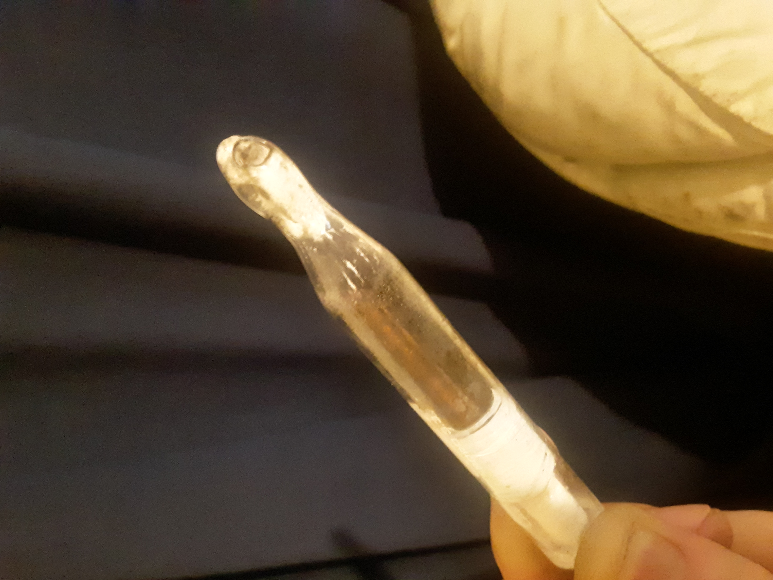

has anyone ever used this kind of quartz tubing (from oven heating elements) as a normal transparent quartz tubing?
like to hold catalysts or as a combustion tube
20181129_123948.jpg - 515kB

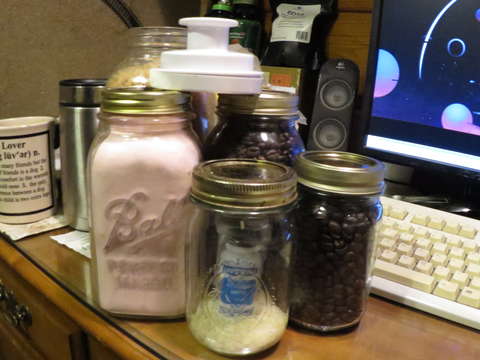

FoodSaver Jar Sealer to extend shelf life of things (vacuum storage in mason jars at ~20-30mbar)
andy1988 - 11-12-2018 at 03:30
Using water aspirator:
files.php.jpg - 49kB
With mason jars and ~$9 FoodSaver Jar Sealer (perhaps other products exist, but nothing else on shelves in U.S.). Also 5mm OD vinyl tubing, I use next size up & beeswax to fit to aspirator, don't buy the FoodSaver's overpriced tubing as generic tubing fits perfectly... They market it with their $60+ machines as the vacuum source... but I'm guessing aspirator has better vacuum (vapor pressure of cold water).
IMG_4130_.jpg - 38kB IMG_4128_.jpg - 42kB
Will reduce oxidation problems like with FeSO4, and reduce moisture problems with things like potassium iodide (LOUDWOLF brand bottle pictured in mason jar with rice as desiccant) and alginate (pink powder in picture). Extends shelf life of such things!
I buy big 5lb bag of roasted coffee beans and vacuum seal in many jars, keeps the oil from oxidizing (keeps it fresh!). Also I seal many of my "nootropic" powders this way, like trimethylglycine [1][2]. Searching literature/google for "XYZ stability" would help me find if this procedure is useful for the substance in question.
Note: Gasket on mason jar lid seem to have shelf life differing between brands, I have a bunch laying around, hard and soft, the hard ones won't hold vacuum (i.e. if the gasket hardens in a number of years you'll loose vacuum, lid will pop up indicating as such).
Procedure: Put lid in device and device on jar. Blue rubber holds lid up so that air can be sucked out. Blue rubber must touch glass "flange" below threads to seal (may have to push if flange large, or remove bottom plastic ring). If jar has no flange below threads or flange too large, I think you could use wax to temporarily seal threads. Let vacuum for a minute, pull vinyl tubing from device (not device from jar), it'll "pop" as rush of incoming air pushes lid down, pull device off and verify sealed.
EDIT: I suppose you could also do a dry nitrogen purge first (or other appropriate gas if you have) to try to replace all oxygen & moisture before pulling the vacuum.

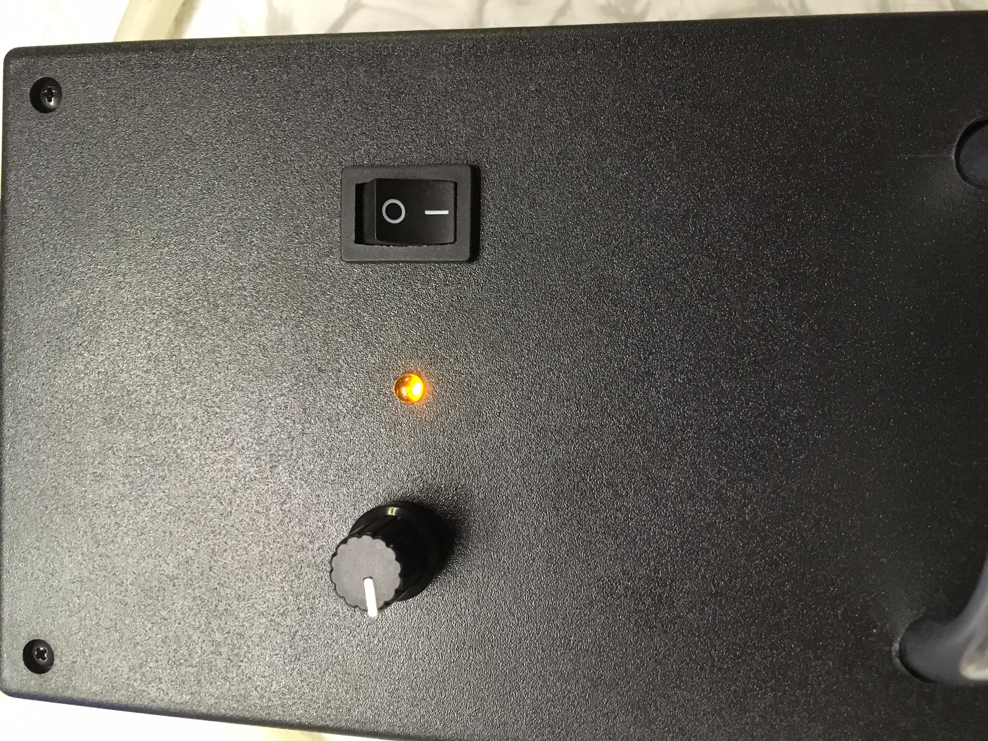

Housing for Power Controller
hacker - 2-1-2019 at 03:01
regulator.jpg - 510kB

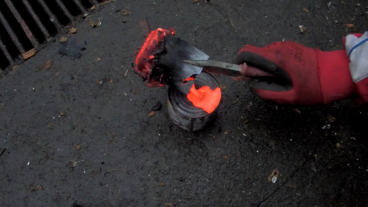

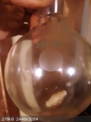

SO I had some old 400w sodium or metal halide bulbs and I cut them open with a diamond wheel on the dremel. They cut very nicely on the far end (where it screws in) and is just under 2" diameter making it perfect for a 2" bung/plug.
These might be great boiling flasks/distillation flasks where there may be remains in the bottom that are difficult to impossible to break up. These are borosillicate glass and they are thicker than both beakers and round bottom flasks that I have checked (broken) by about 20-40%. The setup is self explanitory and I'm going to test it down the road and see what the results are. I plan to use glass tubing coming out of the bung leading to a condenser. IDK if there is anything I need to think of before this, but it seems a plausible idea.
The 400w bulbs (Phillips brand & most brands are same size) are 1,4L to 1.5L which is a very nice size and smaller 250w, 175w, 120w, 100w, etc are all freely available from electricians and gives sizes from 220ml up to the 1.5L.
I used a simple hose clamp around the neck with some tape to give it something to hold onto.
How would you know they are borosilicate?
I have cut open one today and intend to fire polish the cut end.
There is a nice alumina? tube to be had inside as well.
Other halide bulbs (longer and have clear glass) have nice thin alumina tubes that are very useful for shielding thermocouples at their ends
Others contain quite a nice looking blob of sodium (I hope to remove some today). The tube inside these bulbs is u in shape, about 10 inches long and could be used for something or other.

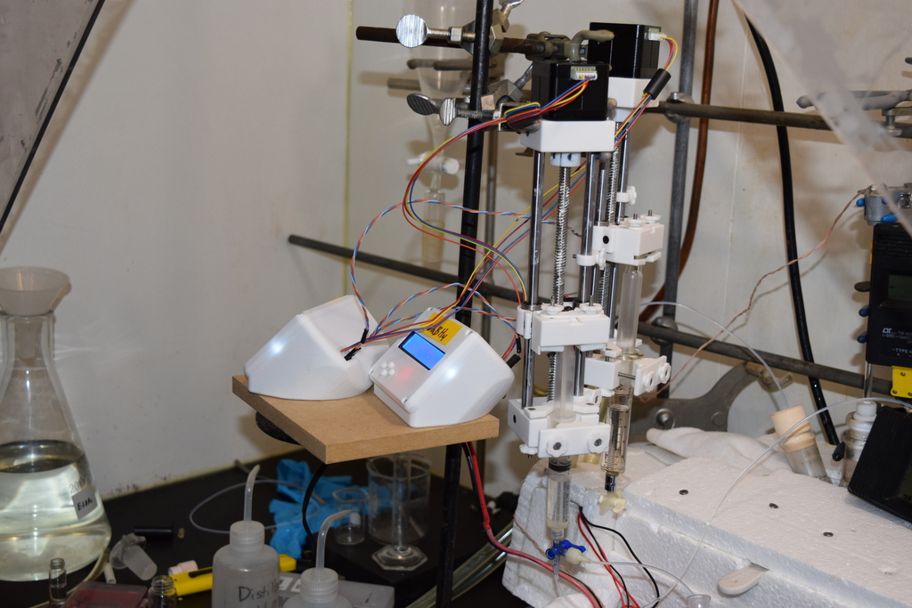

mayko - 18-1-2019 at 18:09

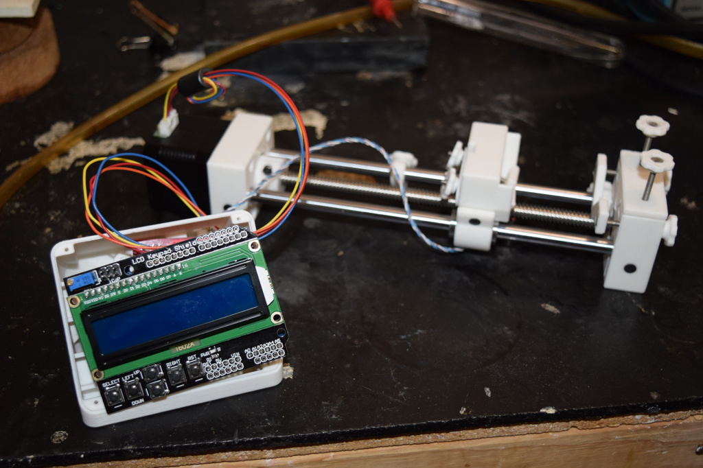

the poseidon syringe pump system:
While open sourcing has become de rigueur in genomics dry labs, wet labs remain beholden to commercial instrument providers that rarely open source hardware or software, and impose draconian restrictions on instrument use and modification. With a view towards joining others who are working to change this state of affairs, we’ve posted a new preprint in which we describe an open source syringe pump and microscope system called poseidon [....] Together, these components can be used to build a Drop-seq rig for under $400, or they can be used piecemeal for a wide variety of tasks.
overview from one of the authors:
https://liorpachter.wordpress.com/2019/01/18/open-sourcing-b...
preprint:
https://www.biorxiv.org/content/early/2019/01/17/521096

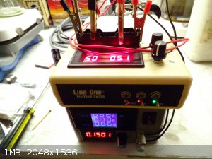

markx - 29-1-2019 at 10:51
Made a small power supply with varied output voltage (0,7-40V, 4A), current control function and some measurement panels for voltage, power and current:
DSCF1878.JPG - 1MB DSCF1880.JPG - 961kB
The power supply is made from a standard 12V SMPS coupled with a SEPIC converter. A versatile match that renders a very capable little lab unit for basically a few dollars.
The blue panel meter is truly a disaster regarding the concept of accuracy....was dirt cheap though :D :D
But on the contrary the red "high precision ampmeter" below that is truly great for the money. Perhaps I got lucky, but testing against a verified ampmeter it shows exceptional accuracy.
Coupled with a homebrew H-bridge pulsed plating unit:
DSCF1881.JPG - 1MB DSCF1883.JPG - 996kB
Makes for great fun in the field of small scale electrochemistry related experimentation.

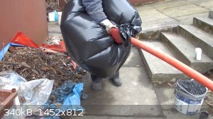

C6(NO2)5CH2CH(CH3)N(NO2)2 - 29-1-2019 at 15:35
This appears to be a mild form of vacuum filtration, done using a vacuum cleaner: https://youtu.be/M8lXPlD4M3Y?t=99
I've had problems using paper filters, where the last few ml of liquid will not even drop out, presumably because the weight of the liquid is too little to overcome surface tension. Since I don't have a "real" vacuum pump, I will totally have to try this.
arkoma - 29-1-2019 at 15:37
I've used a vacuum cleaner to filter before............:cool:
Ubya - 29-1-2019 at 17:07
if you are really desperate you could build this https://youtu.be/vaho7JSVS1I

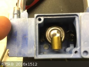

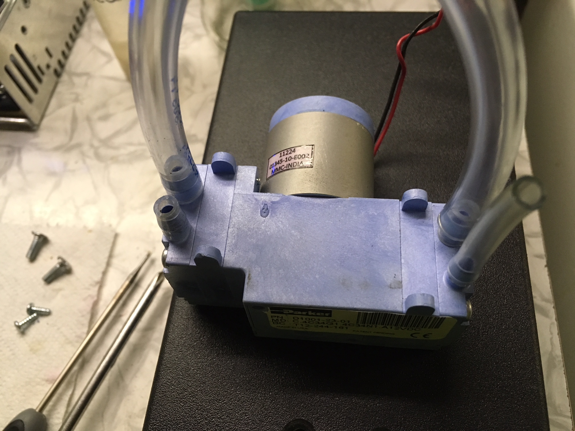

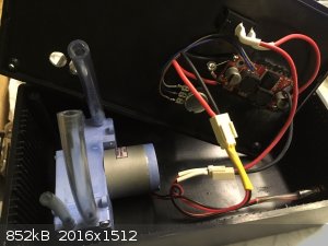

markx - 10-7-2019 at 14:25
On the note of vaccuum filtration aids....I found this double membrane unit on ebay:
https://www.ebay.com/itm/Parker-DC12V-D1001-23-01-Brushless-Vacuum-Pump-Diaphragm-Pump-Dual-Head-Air-Pump/263818752821?ssPageName=STRK%3AMEBIDX%3AIT&a mp;_trksid=p2057872.m2749.l2649
This is a really good quality and capable gadget for the money. It actually runs on bearings and even has a counterweight attached to the crankshaft assembly. I'm very pleasantly surprised!
IMG_3935.JPG - 885kB IMG_3937.JPG - 779kB IMG_3938.JPG - 675kB
Time to build this into a proper casing and add a speed control circuit:
IMG_3940.JPG - 775kB IMG_3942.JPG - 933kB IMG_3944.JPG - 759kB IMG_3945.JPG - 852kB
All done and the two stages connected in series for vaccuum operation:
IMG_3948.JPG - 1.7MB IMG_3949.JPG - 1.1MB IMG_3934.JPG - 683kB
Due to the sepic converter I added it can now be operated from basically any source of DC voltage in the range of 3-35V. Rpm can be fluently regulated with the pot knob. It runs very smooth and quiet and pulls more than enough vaccuum for filtration operations even at minimum speed.

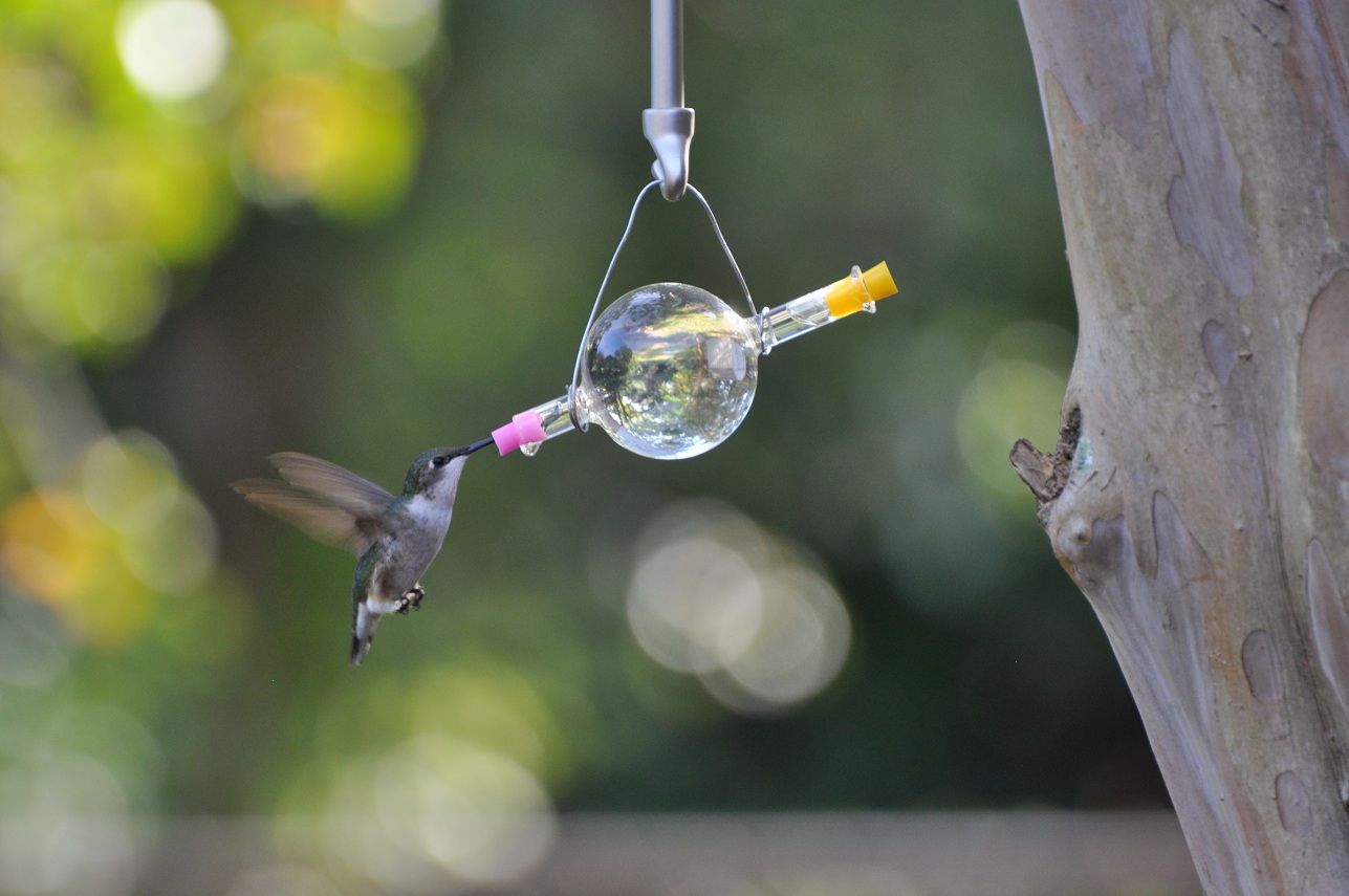

I got some borosilicate drinking straws as a gift and figure they could be repurposed for something. And the little cleaning brushes reminiscent of test tube brushes ...
[Edited on 5-1-2018 by Morgan]
These straws
https://www.sciencemadness.org/whisper/files.php?pid=502689&...
and these fused quartz tubes
https://www.sciencemadness.org/whisper/files.php?pid=513305&...
Experimenting today with glass straws, sugar water, and some red toy rocket launcher base piece of plastic, (something laying around in the garage anyway), I was able to attract some hummingbirds. Also with one of those longer, narrow plastic drinking straws that comes with an umbrella mounted to it worked as well. I sort of cut some of the top of the umbrella straw off and put a tiny piece of pink silicone tubing on the tip and a very tiny silicone stopper in the tail end after filling the straw. But the plastic straw had some 4mm X 2mm fused quartz tubing sleeved inside it and that's what was holding the "nectar".
Anyway the blur in the umbrella photo shows a bird where you can sort of make out his beak against the pink umbrella. He fed out of it but I didn't get a shot of him with his beak in the straw. The photos were taken from inside the house because for some reason these hummingbirds are very skittish. I don't know much about them.

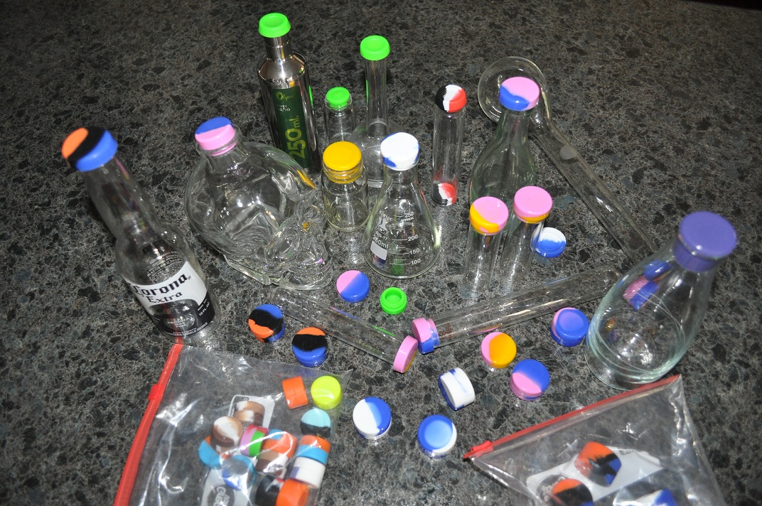

Morgan - 10-9-2019 at 11:48
These are "silicone jars" that are sold on eBay, some 3 ml and the larger 5 ml. What's interesting about them is that you can use the inside diameter of the two halves for different size stoppers and the outside can be pushed into a bottle neck as well. One half has a sizable flange so that makes yet another size that it could fit into. If you think about it there are five sizes to play around with with one silicone jar.
And while I would have preferred other color schemes, a few are of a pleasing, unique design overall, not your average stoppers. And there's always the potential for imagining unique uses for the silicone containers. I really like them - just something good to have around in the parts department. The last photo a longish test tube with a narrowed neck whatever that's called or used for and one of those stoppers with a puncture in it is for this hummingbird feeder. One jar top with the flange sleeves really nicely in a kjeldahl flask and all the items pictured are a good fit, silicone having a fair amount of stretch and give and take.

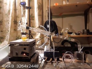

earpain - 11-9-2019 at 03:35
Hi first post. Lurking for years. You all are always the final say on all chemistry questions I ever research.
So here's my vacuum distillation set up. I read this entire thread, so just about all of my DIY hacks have been done by others(confirming I was right!) But a little detail anyway:
Stand on the left holds my multimeter set to temperature sensing via a thermocouple, I tightly wound the two types of wire at the probe, pulled off a thin 'nipple' of glass via lampworking, filled it with glycerine, and sealed the thermocouple in the glass. The base of the stand is from a fancy architect's type of lamp, with a microphone stand bolted in. One of those metal garage lamp clamps holds the multimeter.
Not thrilled about using copper tubing for my condenser, so that will be replaced soon. I made the outer jacket from vinyl reinforced super-wide plumbing hose, and two stoppers clamped on the ends.
The cooling bath is a large stainless steal pot, that i bolted a marine 24V water pump to. I use a 4 setting power supply to pump the coolant, usually at 5 volts.
In lieu of a Lab jack, I stack old CD-ROM drives. Despite how it may look, that receiving flask is super sturdy where it sits.
So I did break my Graham condenser long ago, and had no choice but to cut out the glass coil using a diamond wheel, then work it over a torch to stretch out the distance, and pull off the ends. That along with the small RBF up above is a vacuum trap.
The lab stand is again, a microphone stand, clamped into a very heavy bench vise.
And last but not least it all ends at a vacuum pump made from a window air conditioner. It reads as though I'm distilling isopropanol at 27C, but IR Thermometer contests that it's closer to ~40C, since the thermocouple ends up within the reduced pressure environment.
The other pic is a testament to my going on 3 years tobacco free, and my glass cold working skills=D Anybody that vapes knows how annoying it is to break the boro glass tank part, as every tank has slightly different dimensions. The female ground glass joint from said graham condenser happened to fit snugly, after some careful shaping and grommet fabricating. When i'm out and vaping, I'm still waiting for someone to notice the markings and figure out the backstory.
Love this thread, and this site! Thanks everyone.
Distillation.jpg - 210kB 20190911_070211.jpg - 515kB

Here's a fused quartz sphere repurposed into a feeder. It's nice in that after you tap it to get the solution all the way down it stops dripping yet continues to feed unlike most feeders that drip off and on. I have a pinhole in the top of a coke bottle and inverted it will drip constantly every few seconds. Somehow air skirts in around the tiny hole. It's curious how some shapes won't work and others with 10 times as big a hole do. The nature of surface tension, air bubbles, gravity, and partial vacuums makes for some challenging riddles on how liquids flow.
You can make reverse images with it or start a fire too, another use as a lens.

So I broke all of my 24/40 flasks , all but exactly two. I did feel a foreshadowing of some greater wisdom as I saved as many female ground glass joints as I could.
After buying a whole mountain of Pyrex brand Erlenmeyer's for $10 from some woman in my city, what I have been trying to achieve with glass blowing, silicone casting, copper-to-glass, etc. etc. I finally achieved.
20200608_002651.jpg - 351kB
This is an airtight distillation (azeotropic, caustic, ethanol), with an old Pyrex brand 500ml Erlenmeyer, with just a standard erlenmeyer neck.
20200608_002706.jpg - 176kB
20200608_171129.jpg - 133kB
So here's what I did:
Upon breaking a vessel, I use to try to salvage as much ADDITIONAL glass beyond the female ground glass joint. In this case, I used my faithfull diamond wheel to cut right along the seem where the female joint's cone is at its shortest, right before the actual flask begins.
Even before the teflon tape, I dropped it into the neck of several of my erlenmeyers, and it almost made a perfect seal as is. It's moments like these that remind me that I don't just love teflon tape, I am IN LOVE with teflon tape.
One more pic, showing a failure, the same success, and a future work in progress
20200608_171103.jpg - 467kB

So I have a bunch of stir bars but all of them are the bar shape, made for flat surfaces. Not ONE, has ever, stirred, at least for more then 2 seconds, in ANY of my round flasks. I have owned one tiny pear shaped one for 25ml - 50ml flasks, that's why I even knew it was possible.
I kept telling myself: "Order some special stir bars, don't forget!"
and I kept forgetting.
So I held the example pear shaped tiny one in one hand, and tightly wrapped PTFE tape, over and over, around a big stir bar, until the shape matched. Dropped it in. Observed my first whirlpool in an RBF. Beautiful. Vacuum distillation - like night and say.
20200724_115133.jpg - 328kB
20200724_114912.jpg - 278kB

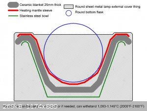

I have decided to make a more complete heating mantle from the heating mantle sleeves i have bought.
They can be used as they are but i would like to build an enclosure so they look a bit more like a real heating mantle.
My plan is to use a stainless steel kitchen bowl, put a thick ceramic insulator blanket (25mm thick) in the bowl and then put my heating mantle sleeve inside this.
Vermiculite can be used as extra insulation if needed, i have a lot of it.
I have found a round sheet metal lamp enclosure that looks very much like a heating mantle outer cover and i will try use this one as the outer cover for the heating mantle.
Something like the picture i have drawn.
Then i could place the DIY heating mantle on top of my hotplate stirrer for the stirring function.
At least until i have figured out how to build the stirring function and the electrical driver.
A modified computer fan could be the start of a stirring function together with som high-temp magnet.
The driver could be a diy triac circuit or a cheap dimmer module from ebay.
It would be nice with a temperature regulating function, maybe a PID regulator with a SSR.
I think i will make a external driver/temp regulator unit so i can use it with different sizes of diy heating mantles.
First i must put together the heating mantle assembly then i can start figure out stirring, driver and temp functions.
Have any of you made something similar?
DIY heating mantle assembly.JPG - 269kB
earpain - 22-8-2020 at 23:57
Nice blueprints!
Remember, the only way to UTFSE for sciencemadness is to use google with special parameter at the end 'site:sciencemadness.org'
without the '
DIY mantles, hotplates and stirrers might be the MOST discussed topic in scimad library that stretches beyond eternity.
Also, lol I have!
I think you're on a good start. The issue of adding stirring whenever you'd like, I actually have a circa 1950's, lab stand clampable, swivel attached,(Edit: The picture in my very next post uses the swivel lab clamp device to hold the digital temperature readout and manage safe wiring suspension in respect to the temp and/or 3-way distillation piece) magnetic stirrer. It (was) driven by an A/C motor with well hidden speed control circuitry, which in turn could be controlled via an in line potentiometer, which was made of incredibly heat-reinforced material. Thomas brand. Anyway, ALL of it's components are currently vital pieces of other monstrosities I have built. I just wanted to re-encourage you that going back as far as the 1950's, even industrially made chem equipment was considerate of having a seperate stirring device to clamp in vicinity to a heating device
I can attest to this as my current set up allows for certain flasks/stirbars to stir very well clamped 6 ot more inches above the surface of the hotplate.stirrer.
So the PID thing: There are some certain users on here that I expect(hope) will chime in here. I agree with the final meta-conclusion made by the explorer Sulaiman:
At the end of the day, precise temperature control inside the vessel is rarely needed. Since:
During any distillation/reflux/evaporation etc. it's the BP of the solvent that determines the temperature, not your PID controller.
Sometimes, like for -serious- fractional distillation, packed column, etc. maintaining a specific temp is really nice.
Then of course there are certain reactions that proceed bellow the boiling point of the solvent. (Most of them, I wouldnt take my eyes off of regardless)
I did read up on the ingenious , outside-the-box theory and history of the PID approach. I love that I stands for Integral and D stands for Derivative, and my favorite part is the analogy of the helmsman.
All that being said, seems like most people here end up just preferring to control the voltage/current/pulse of the heating element instead. Which takes no heed of recorded past data , calculates their integrals, nor does it calculate instantaneous rate of change lol. But some people like the devices that do this via a thermocouple in the hotplate.
Love me or hate me, but I have a few hotplates that i just have an an/off switch for, if that. And I just go by feel. Like a helms man.

earpain - 23-8-2020 at 00:20
OK so the situation is as follows:
Often enough, I have some reaction or extraction where there's but a small amount of an organic, non-polar, water immiscible substrate or target compound.
Often there's also an aq layer during a reaction, or an extraction, or a purification etc.
Now that DCM is gone, I've been plagued by the tediousness AND the mechanical yield loss off having aq. layers 10 or more times the volume of my compound. And all the organic non-polar solvents still sold to the public either boil at WAY TOO HOT degrees celsius, or just suck in general because they hide water or they dont really dissolve stuff(naphtha).
OR I have to make them from scratch! diethyl ether, chloroform, this isn't over!
And then, the Monstrosity
So here's how it works:
take your standard stillation set up. Replace the first 3-way adapter with an ultra micro-scale Short Path distillation head, that happens to have a Vacuum Insulated Vigreux column. (there are two sets of condensation needle (theoretical) plates.
There was once a 10/X taper nice thermometer that fit right where it should in the SPD device, but that broke.
Eventually I built my own thermocouple device, and courtesy of my glass blower friend who stops by occasionally to be wowed by my chemistry, and then (hiding from his wife. etc.) does some projects for several hours with a torch in the corner. So, he brought me the perfect boro tubing to make thermocouple sheaths that end up having identical dimensions to a standard lab thermometer..
The digital display and tyke K processor was $8 courtesy of Ebay.
IT IS SO ACCURATE
Now the black 'bungs' are not rubber stoppers! no no. Go to an autoparts store, they sell 'vacuum plugs'. THey are like caps that you have to stretch on to the end of a tube, and designed for systems in vacuum in a car. Cars get waaay hot. So whatever the material is, I SWEAR H2SO4 had no effect on it. You might find a special set tjat fits many sizes. That's how I interface the thermometer into the SPD head.
You'll notice two nipples are left bare. They are intended for water coolant. I deemed this not needed in this set up. The next nipple is the SPD head's vacuum. Since the setup has two such nipples, I decided to seal that one off. THEN, there is, i'm sorry, a rubber stopper. I WILL SOON PURCHASE A 14/X to 20/40 adapter for that section.
So what's happening in the picture is I am boiling off solvent at ATMOSPHERIC pressure. Taking note of the temp. Once that is finished, i simply slide a 500ml RBF on that bottom receiver elbow piece, connect my vacuum source to the special straight vacuum adapter which is slowly rendering vacuum angled take-off's obsolete.
Then i proceed with a Vacuum Fractional Distillation
In such a way where it is most ideal to use <100ML flasks as the stillpot, but crucial to use serious BIG BOY glassware to condense and collect.
SPD_Modify.jpg - 496kB

Fyndium - 12-11-2020 at 01:52
I could not find a shorter stem length thermowell, so I shortened one myself. It was just a shy too long to fit in the short path, but now it fits perfectly.
This short path is perfect for many distillations, especially vacuum with higher bp. I could not effectively monitor the temp prior to this.
shorty.jpg - 110kB
Piroz - 19-1-2021 at 12:44
Need is the mother of invention so I have some ideas, especially I haven't much money and no job right now. This is one of these. Mini furnance from tin cans, metal pipe, a piece of garden hose and garbage bag. It works like bellow- by compression of air in garbage bag (using force)- air is moved trough garden hose and metal pipe into mini furnance and increase temperature of charcoal. By this way I melted aluminium and table salt (801 degrees C). Now I'm working with bigger version of this- for melting calcium chloride needed for electrolysis of molten salt.
Here is the video- how it works (translation to english isn't completed, some missing translation on the end):
https://youtu.be/gkhVcoaFBPs
Garbage_bag_hose_pipe.jpg - 230kBMelting_aluminium.jpg - 293kBMelting_aluminium2.jpg - 349kBMoltenNaCl.jpg - 208kBFurnance.jpg - 317kB

draculic acid69 - 26-1-2021 at 05:40
These things are just like a$4 Variac.
They've proven reliable, trustworthy,temp stable,accurate for my 1L mantles and I suspect would be fine for up to
5L mantles.Theyve proven more reliable than the original circuits in both of my mantles.they cost a few bucks and are worth every dollar 1000 times over.
Google this and look for this picture, eBay has thousands of people selling them.pick one
2000W 220V AC SCR Electric Voltage Regulator Motor Speed Control Controller eBay.
s-l400.jpg - 27kB

flaminglasrswrd - 26-1-2021 at 15:57
I recently assembled a pair of syringe pumps. They are based on the Open Source Syringe Pump Project. They cost about $85 each to build, but that was higher because I paid to have the 3D parts printed. Now I have a 3D printer of my own so any more pumps will cost about $50 to build.
Overall I think they are quite useful. I chose some slightly underpowered stepper motors (300mA max) so they sometimes slip when everything isn't perfectly aligned. That's probably a good thing.
The menu system takes some getting used to. I would like to make them computer-controlled at some point. The buttons are a little clunky.
Here they are, hard at work pumping fluids at 0.02 ml/min and 0.4 ml/min.
syringe-pumps-working-here.JPG - 484kB
And a better view during construction.
syringe-pump-poseidon-replication-build.JPG - 265kB

Here is my homemade rig. It's a distillation column, which I built to distill some bromine for my element collection. After several failed attempts, I yielded about 5g, which is good enough for me. Any comments on the column part? I was pretty much winging it based on pictures I've seen. I'm not sure how effective it actually would be at fractionating. I could see the bromine condensing near the top and running down the column wall. Then it would evaporate away near the bottom, when it contacted the H2O steam. This seems like the right sort of thing it should be doing, but I don't really know.
20201226_163248.jpg - 2.3MB

Piroz - 2-3-2021 at 15:09
Today I tried my new improved furnance that use charcoal as fuel, powered with garbage bag. :D
It melted around 250 g of table salt in less than 10 minutes. However tin cans as inner part of furnance were completely destroyed due to high temperature after a half hour of heating. So I'll try some new tricks and make new furnance.
MiniFurnance.gif - 2.6MB Minifurnance.jpg - 697kB Minifurnance2.jpg - 696kB Me_with_garbage_bag.jpg - 340kB MoltenSalt.jpg - 512kB Destroyed_cans.jpg - 573kB

I made a very effective gas-into--liquid diffuser.
Materials:
-thin borosilicate test tube, or similar
-Woven fiberglass insulation tubes used commonly in high-powered lighting. I'm sure 'glass wool' and many others would work as well. But I went through about 4 types of so-called 'fiber-glass' that burned, charred, disintegrated etc. when attempting the procedure
-a simple plumber's propane torch
1. rotate the end of the test tube over the flame, and use a glass rod or some pliers to 'pull off' the end of the test tub, creating a conical tapered end, instead of the hemi-spherical one that was there previously.
2. At a convenient spot on the stretched out 'cone', use a 3-sided file, or glass cutting tool, to cleanly break off the tip. There should be an opening somewhat smaller than the diameter of the rest of the test tube, with a glass wall that's a bit thinner
3. pull some of the threads of the fiberglass apart, and mush it together like if it were a cotton ball. Stuff this inside of the new tip. Use a stem or screwdriver to stuff it in such that, you can still blow through the tube, but you can feel constricting.
4. This is fun. Rotate the end of the tube over the torch. Start slow. What will happen is first the outer glass will become red hot and soften, and soon the fiberglass will slightly melt(hard to see the melting). Periodically stop and try blowing through the tube. Eventually allow it to cool, the device is almost complete, if the fiberglass is clearly fused permanently, yet constricted air flow is possible
5. Anneal! Somehow! I just stuck it into a pot of vermiculite. One could also use an oven, the same torch, etc. The variation on this that used shards of broken glass, requires the annealing step more-so. But still a must.
6. Test. Air or whichever gas you want to be bubbling into a solution should be constricted, and come out as hundreds of tiny foamy bubbles.
20210407_053852.jpg - 2MB
