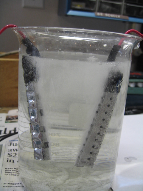

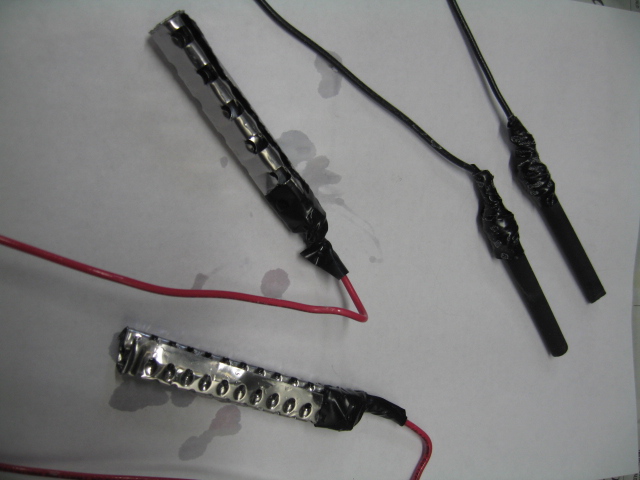

I have been experimenting with the electrolysis of water using a 12vdc source. My goal is to produce and capture pure H2 at a reasonable and sustained rate.
My first try was with some carbon cathodes from a dead 6v dry cell. I used large glass test tubes to capture the gases. Since production was very low at first I thought more surface area for the electrodes was needed. So I made new ones from perforated, rolled sheet ss (from a vegetable scraper). This gave no improvement. After watching some YouTubes where people were making HHO I noticed that they were producing gas like gangbusters. So I took off the test tubes and then I too was producing gas like gangbusters. I learned form this experimentation that a clear path for ion movement must be provided.
Shown below are the electrodes and gas production in a saturated solution of NaHCO3. The amp draw is a little over 3 amps. At 3.5amps I calculated that the production rate of H2 is 1.5L/hr.
electrolysis electrodes.jpg - 112kB electrolysis of water.jpg - 140kB electrolysis amp draw.jpg - 132kB

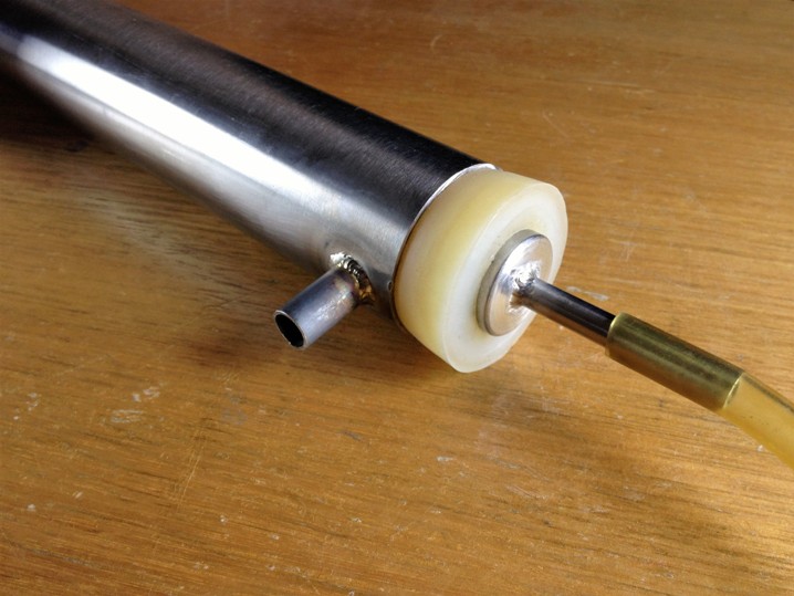

I'll put up some pics later on today, but I have had the same needs for H2 production. Which I mentioned in this thread earlier:
https://www.sciencemadness.org/whisper/viewthread.php?tid=68...
The problem was making a cell that would split the two gasses and supply H2 at line pressure for blending with another fuel gas. I didn't want to go down the path of using pumps and storage tanks and regulators and drying, cleaning ....you get the picture.
I first tried the U tube type arrangement with 0.5M approx H3PO4 as electrolyte, stainless steel anode and cathode. At 30VDC I was only managing about 0.15A. Gas production was infinitesimal. So the same electrodes were placed inside each other one was about 30mm Dia and the other 18mm Dia. and about 300 mm long. With the same electrolyte
12VDC draws 30A. The power supply can't handle that sort of current for very long before overheating. But it solved the geometry problem, and the rate is good, too good.
I've been converting a computer ATX supply rated to give 5VDC 20A just recently, which I expect to do the job nicely, and now I'm doing the plumbing for the cell.
The cell has a membrane of vidaflex [ http://www.cablecraft.co.uk/heat-resistant-glass-braided-sle... ] over the internal electrode which is sealed at the top by glass thread wound over the vidaflex, a cable tie gives it a bit more grip to be sure. which allows the internal electrode to become the anode and collect the oxygen through perforations around the top.
A silicon rubber bung plugs the outer tube and fits the inner tube with a little bit of an adapter- this pics will explain it.
The outer electrode was sealed at the bottom making the whole cell able to be pressurised. This meant that the cell can run completely filled with electrolyte and any gas rises out of the outlets to the reservoir tanks above the cell. The electrolyte drains to another external tank which is pressurised above the liquid to line pressure, where fresh water can be added. The pressurised system means no dead volume above the membrane, minimising the risk of H2 and O2 mixing, and the ability to draw off H2 without changing the pressure in the O2 reservoir.
Will have pics and more details soon.

It is interesting that you talk about electrode spacing requirement. This seemed to have no effect in my cell: a 1L beaker.
My system will not require hydrogen pressure other than that needed to fill a collapsed Mylar party balloon. This balloon acts as a reservoir from which I will fill a regular heavy duty latex balloon using an aquarium pump. This scheme has been tested and works nicely.
The key problem is collecting the hydrogen while still allowing efficient travel of the ions. That's my conclusion anyway. The solution to this appears to be use of a semipermeable membrane.

The following pics give you an idea of the construction and arrangement.
H2Cell1sml.jpg - 93kB Here is the internal electrode with the vidaflex
H2Cell2 closeupSml.jpg - 149kB Up close with the detail of the vidaflex held with glass fibre and cable tie
H2Cell3 EndSml.jpg - 89kB
H2Cell4 RunningSml.jpg - 94kB The current is 1.25A at about 5VDC
H2Cell6 BubblesSml.jpg - 176kB A gush of bubbles.
It seems to work ok except for a bit of bubble lock, the inlets to the tanks are a bit too small where the rising bubbles block the tubing and stop the tanks filling, I'm going to have to redesign the inlets to be bigger.
[Edited on 29-10-2016 by Chemetix]

Ok it looks a bit Dr Frankensteinish, but it works. The bubble lock was due to the liquid needing somewhere to go as the gas rises in the inlet tubes. This was solved by having a separate return path.
Cell Fittings Sml.jpg - 166kB
CellRunningSml.JPG - 257kB In this shot you can see that the left tank has hydrogen collecting in a big flow of bubbles while the oxygen just fizzes over more constantly.

Chemetix - 12-11-2016 at 13:39
Yes, lamp stand being used. That was a piece of obtanium, a la roadside. The whole arrangement has since been put in a wooden stand like an Orsat-Muenke apparatus.
On a further note I am now running 12V and the electrolyte has been diluted by at least half, and the overall performance goes something like:
12 V
4.2 A
1.2 L. hr -1. H2.
H3PO4 @ 0.25 M
