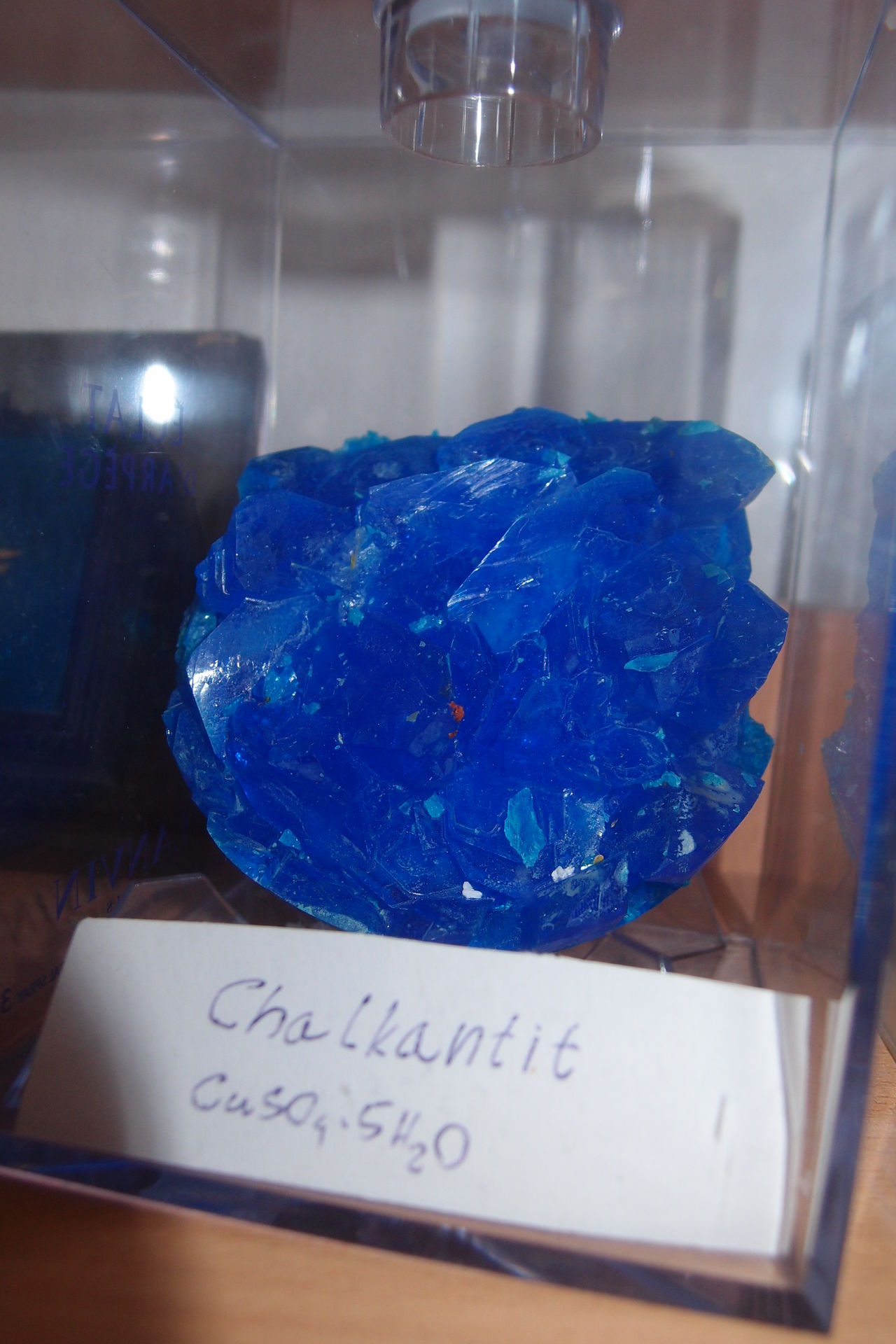

2) Copper(II) sulfate pentahydrate (CuSO4.(5H2O))
Cu_SO4_5_H2_O.jpg - 215kB

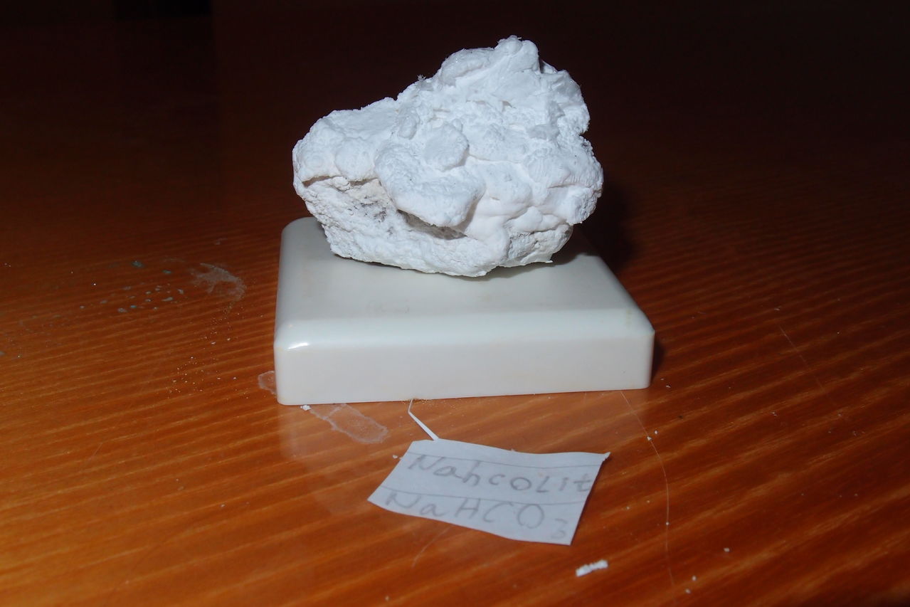

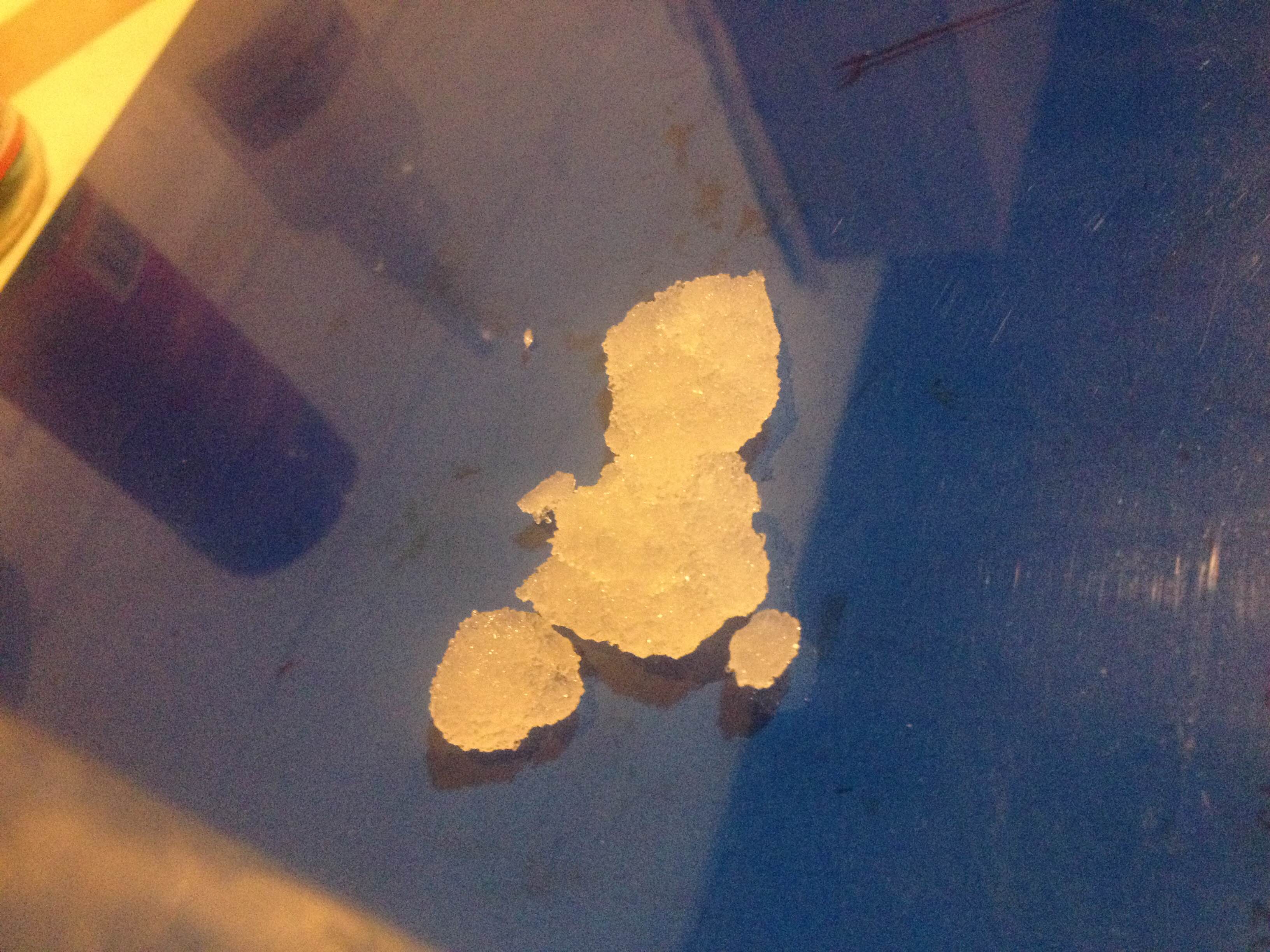

4) Sodium bicarbonate (NaHCO3)
Na_HCO3.jpg - 86kB

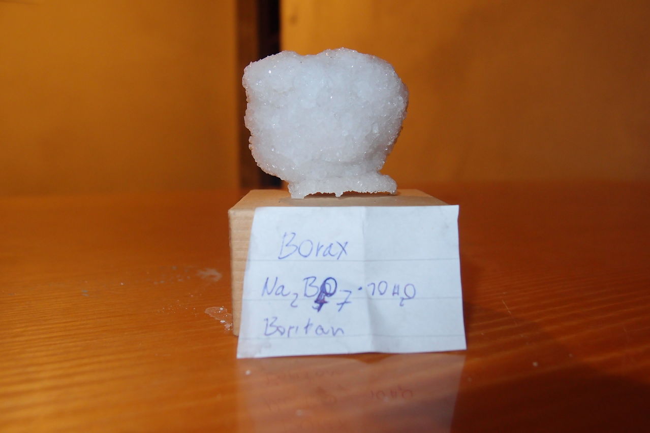

9) Sodium tetraborate decahydrate or simply Borax (Na2B4O7·10H2O)
Borax.jpg - 61kB

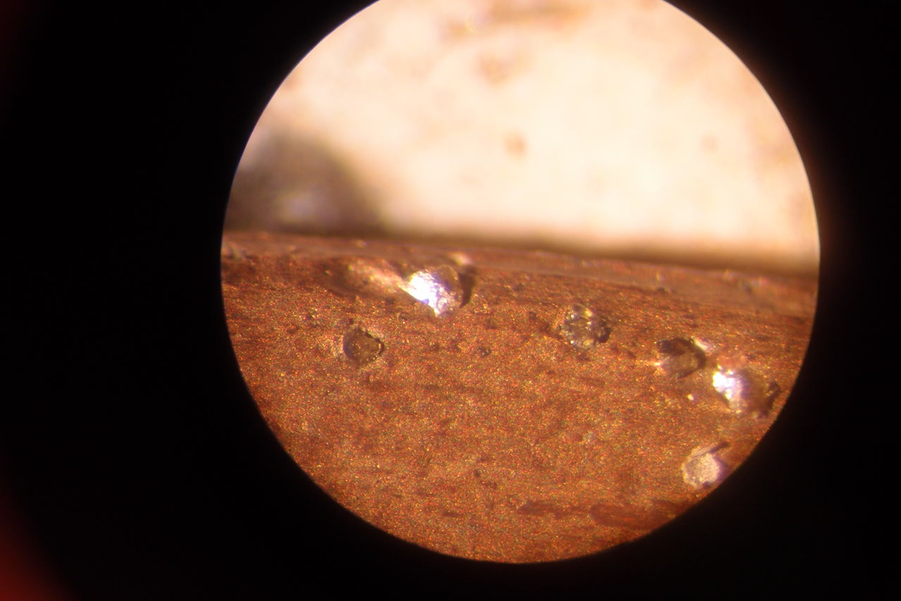

10) :cool: Diamond :cool: (I´m not joking it´s real diamond from grinding wheel under microscope :D:D:D)
Diamant.jpg - 101kB

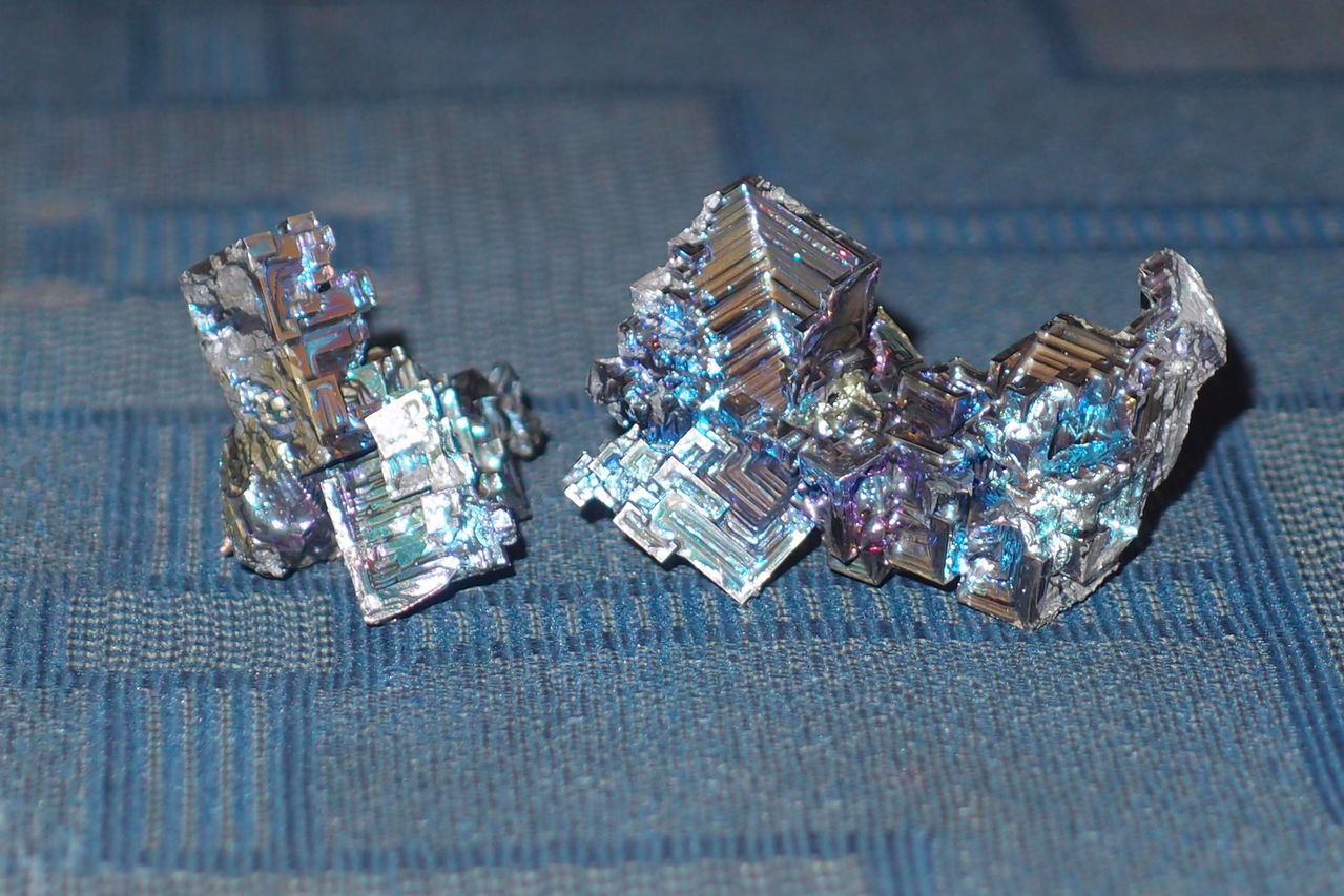

11) Bismuth (Bi)
-my favourite
PC241986.jpg - 211kB
PC241991.jpg - 79kB

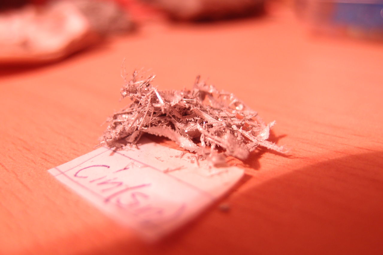

12) Tin (Sn)
image.jpg - 82kB

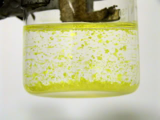

Im going to grow sulfur crystals from toluene solution.
What do you think is the best technique?
Cooling the heated solution or slow vaporisation of the toluene ??
diddi - 7-1-2016 at 02:27
use xylenes instead.... very slow cooling works well. you get long crystals. if you seed it you can get the diamond shaped crystals
j_sum1 - 7-1-2016 at 02:36
Definitely cooling.
I suppose you could pull the toluene off with a vacuum. But the solubility is so temperature dependent that mere cooling makes them grow easily.

diddi - 7-1-2016 at 11:26
did you do anything special to grow the crystals?
xylenes allow about double the amount of sulphur to be dissolved per litre.

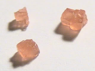

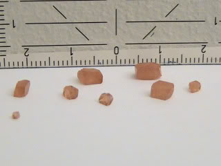

Hello, These where not produced for the sake of growing crystals but non the less the process yielded some lovely pure crystals of the sugar alcohol Erythritol.
Process here: http://www.sciencemadness.org/talk/viewthread.php?tid=26679

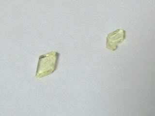

Now these crystals came from the tailings of this process that I had saved to use in my cooking, The mother liquor was poured back into the container and placed in the fridge (Its composition would be weak stevia extract and Erythritol mix, being the erythritol having a higher concentration)
When I went to add the wash water to the liquor I found these beautiful diamond shaped crystals in it!
Feed stock was Truvia, Erythritol/Stevia extract Sugar substitute.
pure Erythritol.jpg - 117kB Purifide Erythritol crystals-Size 01.jpg - 154kB Purifide Erythritol crystals-Size 02.jpg - 123kB

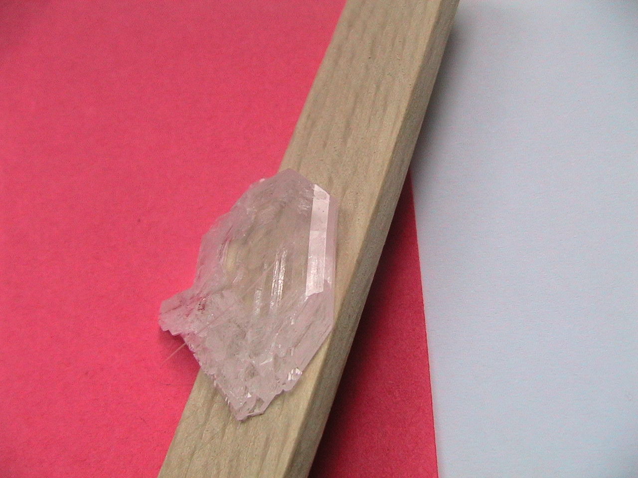

crystal grower - 17-1-2016 at 04:54

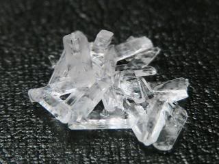

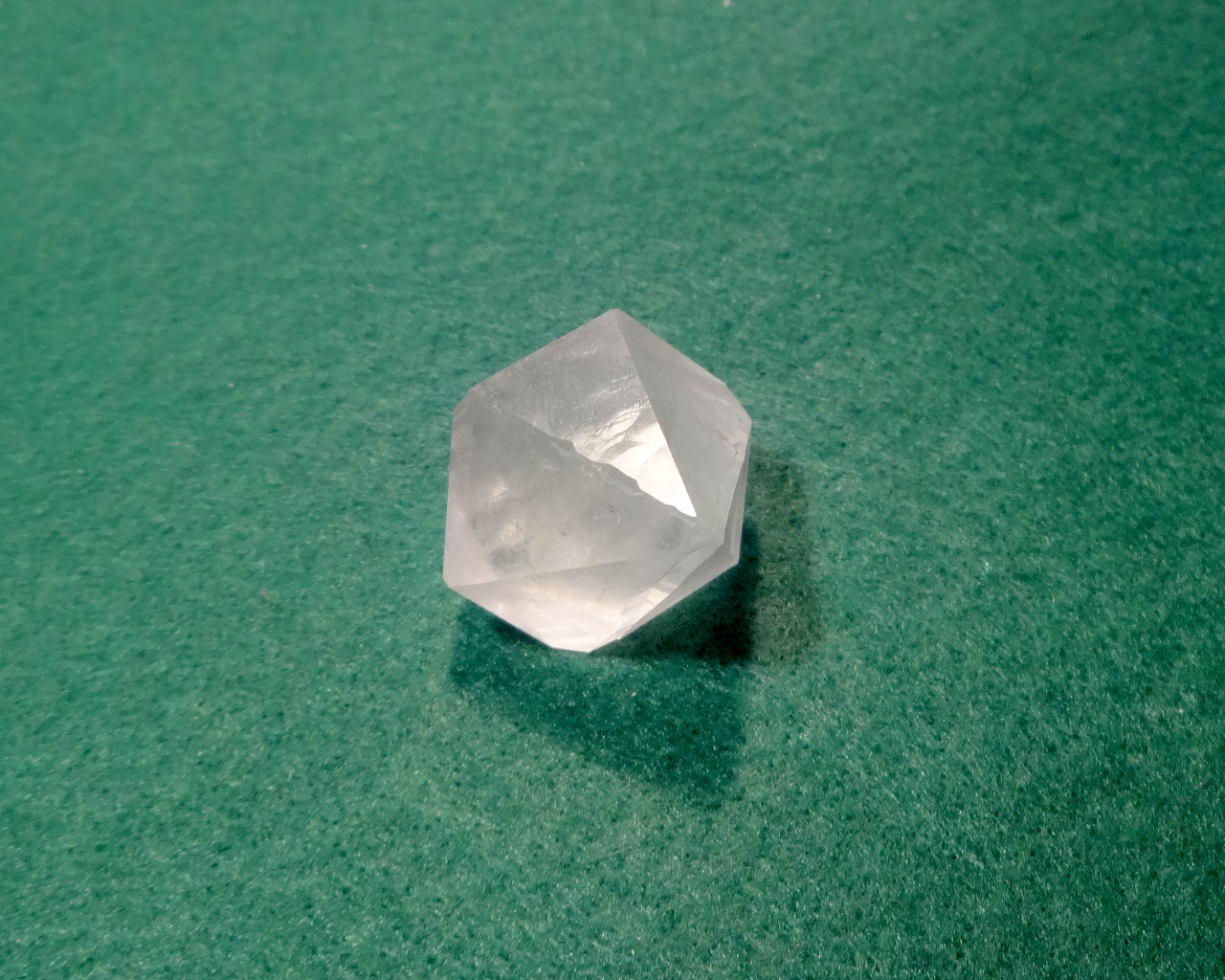

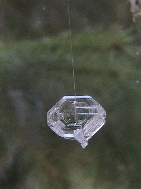

Kalso4.11h2o
-it isnt perfect crystal because it has grown only in 1week.

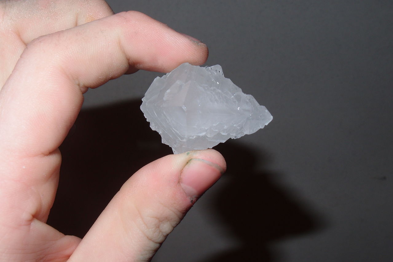

P1122202.jpg - 71kB
P1122208.jpg - 89kB
image sharing

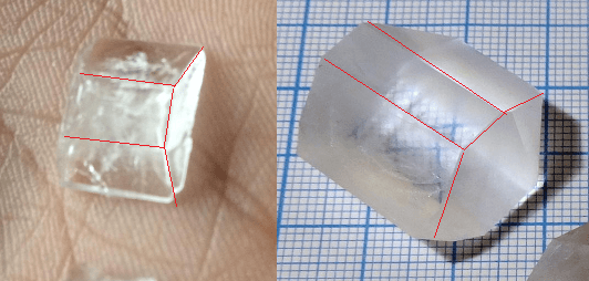

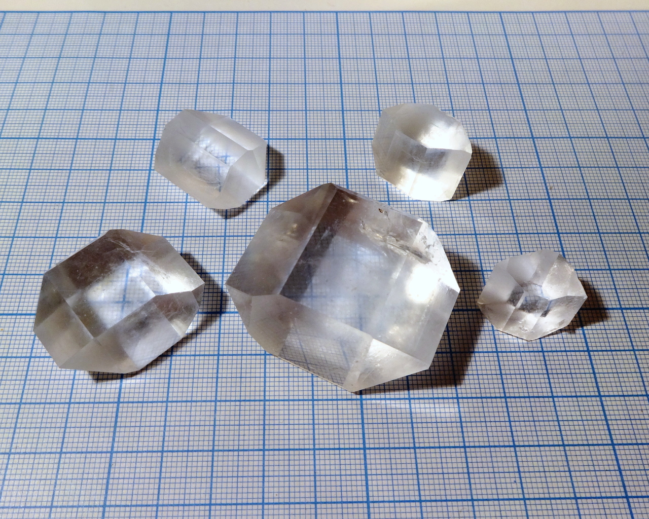

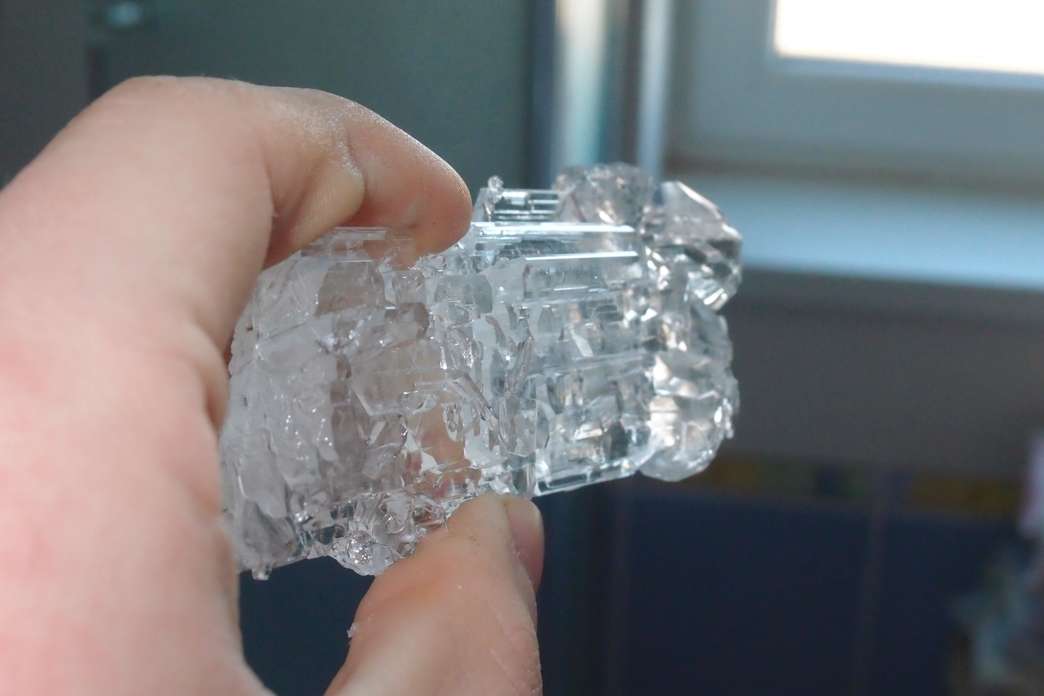

Crystal grower, how did you manage to grow NaHCO3 crystals?

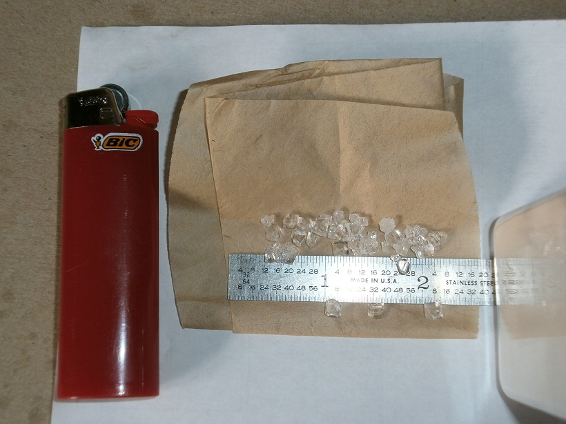

aga - 19-1-2016 at 06:34

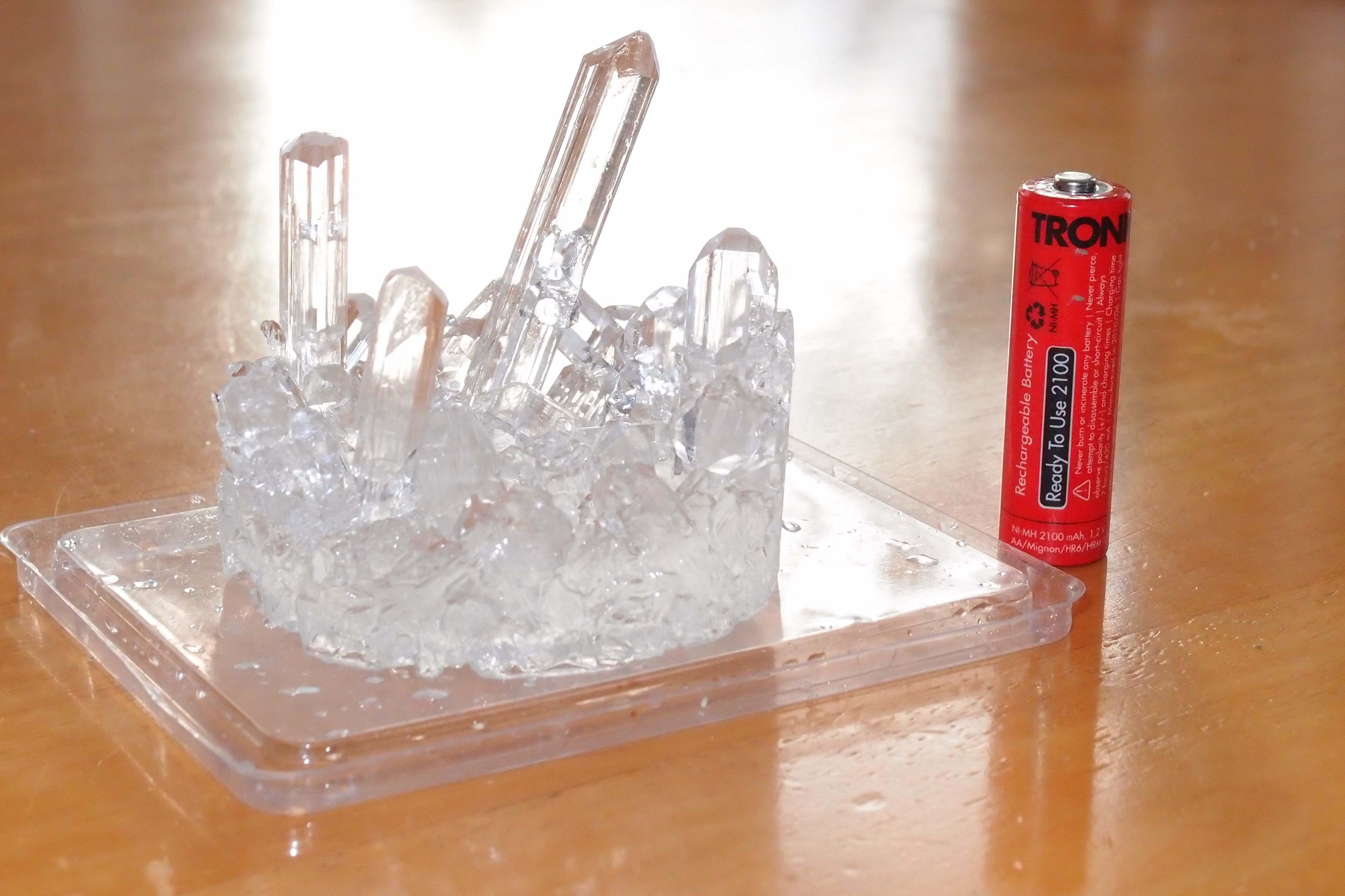

Potassium nitrate is easy and gives nice looking crystals.
crystals.JPG - 147kB
crystal grower - 19-1-2016 at 08:07
I didnt put much effort in it at all.
I dissolved soda in hot distilled water and then just lt it cool down.
When the sollution was cold there was no crystals in the container -I was thinking that the sollution wasnt saturated enough. But in fact it was supersaturated and when I shaked with container a little, crystals started suddenly growing.
Im going to do some more precious procedure to make better crystals in the future.
crystal grower - 19-1-2016 at 08:08
They are really cool.
Are they made only by cooling the solution?
aga - 19-1-2016 at 10:08
Yep.
Dissolve the pot nitrate in just enough hot water to dissolve it, then wait for it to cool down.
Simple as that.
unionised - 19-1-2016 at 13:18
Did you check if it was bicarbonate or if it had decomposed to carbonate?
crystal grower - 20-1-2016 at 05:53
It is still bicarbonate according to ph test.
To be exact the water was only warm, not very hot.

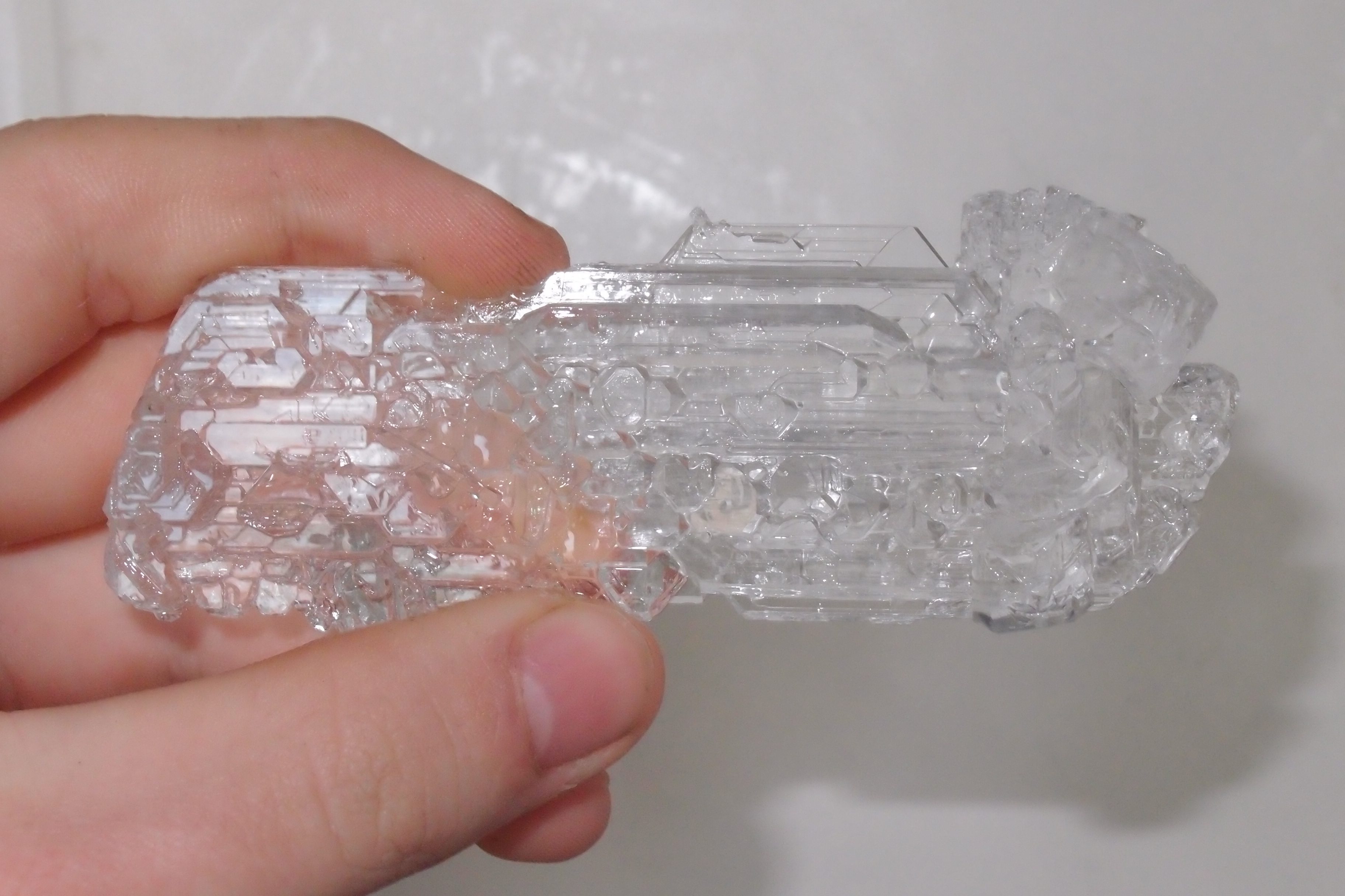

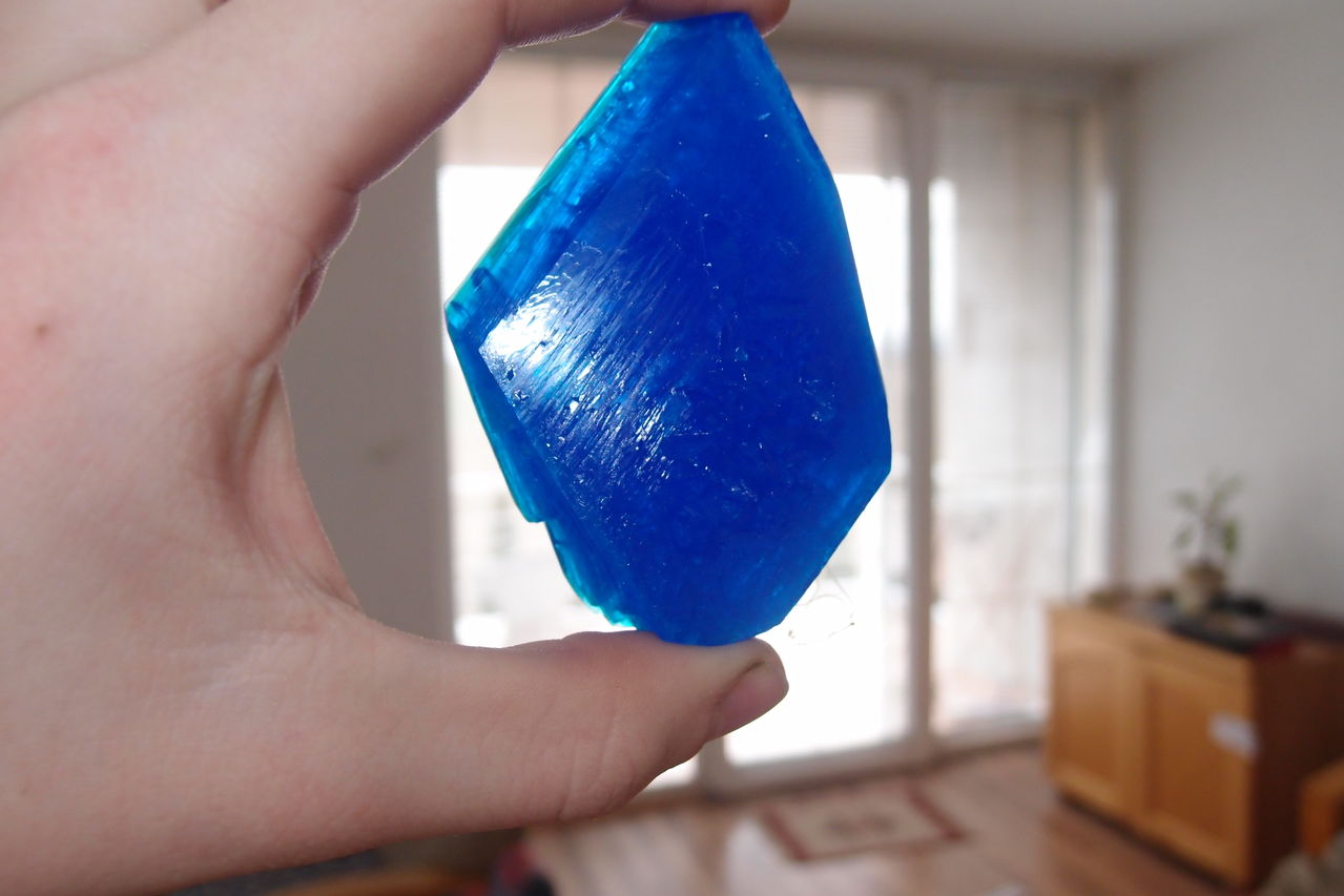

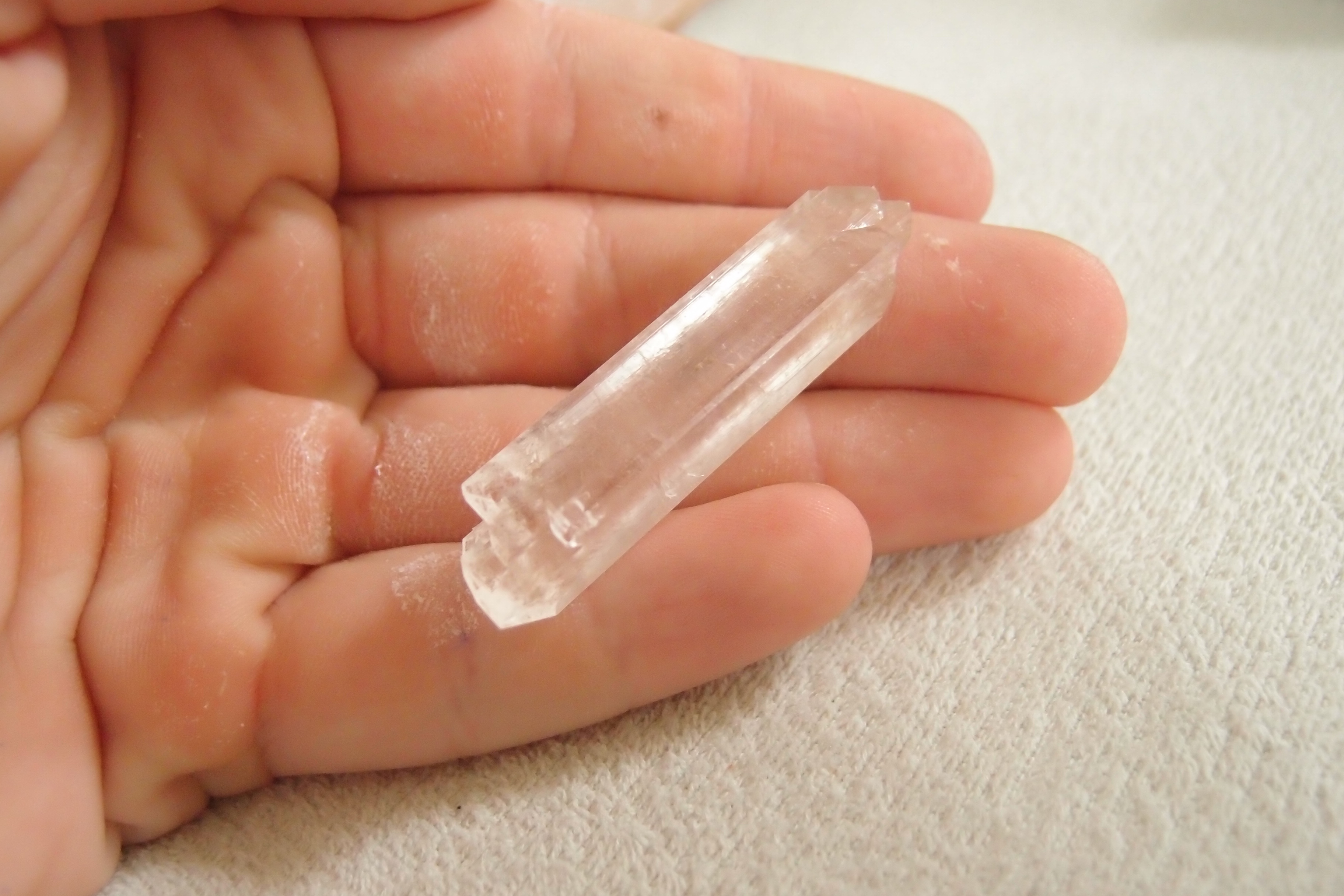

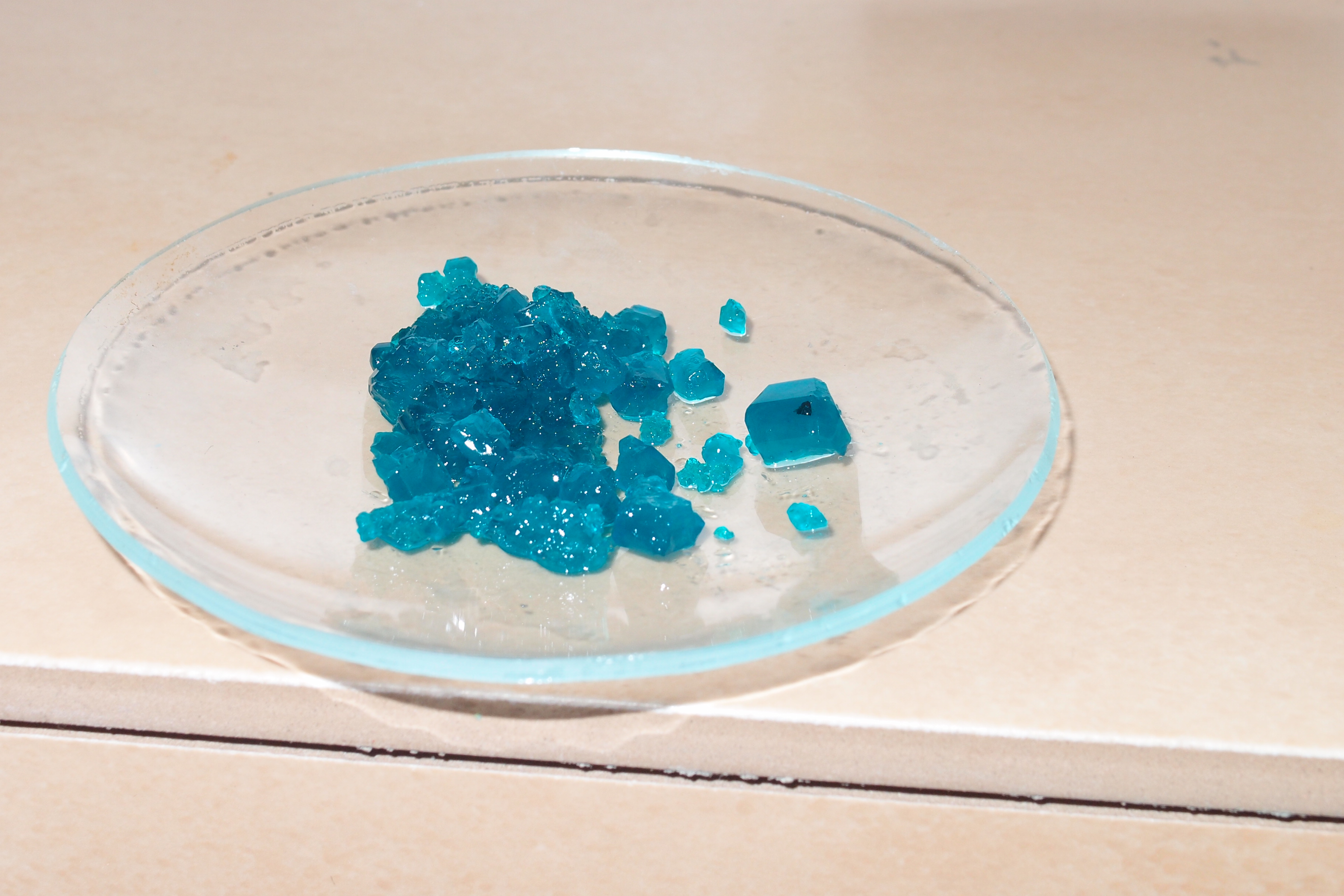

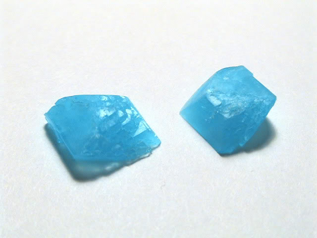

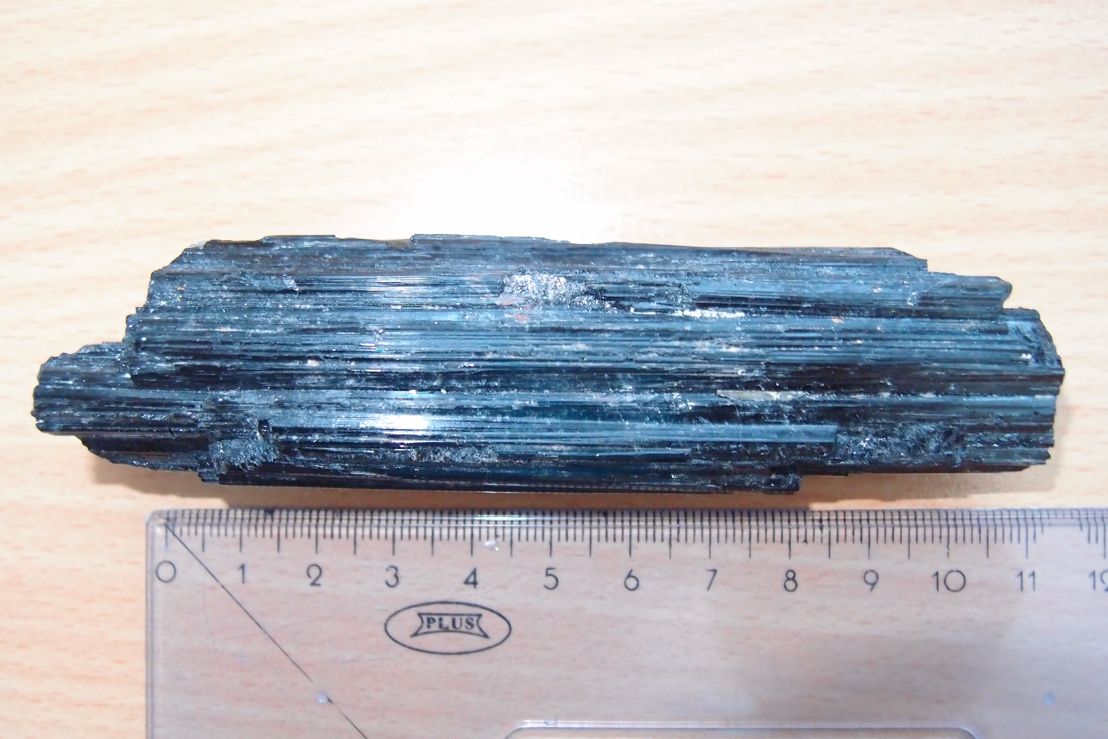

crystal grower - 20-1-2016 at 06:14
blue vitriol crystal grown in 2weeks.:P
cuso4monocrystal.jpg - 101kB
cuso4monocrystal2.jpg - 85kB
Just wondering for what price it could be sold, any ideas??
(I would tell the buyer that its manmade of course).
I would say that the price would depend on the buyer, honestly. Perhaps an auction would do(I think of eBay)?
Bot0nist - 20-1-2016 at 15:13
Copper sulfate growing on a piece of copper pipe after its reaction with a warm mix of hydrogen peroxide and sulfuric acid. Original pic and write in the pretty pictures thread. Love the crystals everyone. Keep up the good work.More (new crystals) to come from me soon.
2016-01-20 16.02.08.jpeg - 198kB coppersulfateoncoppperp.jpeg - 66kB

crystal grower - 23-1-2016 at 10:18
my first k2cr2o7 crystals.
lopezite.jpg - 216kB
lopezite_2.jpg - 119kB
Im going to grow monocrystal in the near future.

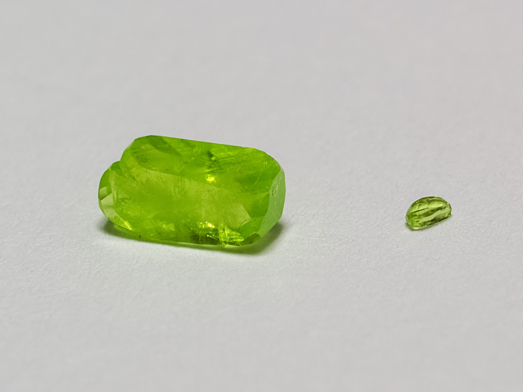

nezza - 26-1-2016 at 00:57
This is a small crystal of praseodymium sulphate (About 7-8mm long). It appeared slowly (several months) in a solution of the sulphate I made some time ago.
Paseodymium sulphate.jpg - 149kB
crystal grower - 26-1-2016 at 03:14
Really nice. Thanks for posting it here.
aga - 26-1-2016 at 13:52
... small crystal of praseodymium sulphate ...
Biggest i've ever seen !
Could you please post the process by which you arrived at that crystal nezza ?

The Volatile Chemist - 28-1-2016 at 13:31
Na3Cit with some NaOH solution sort-of still around (on them). Except for this, they'd be 'dry' crystals.
These are broken up from their original size (as they formed). They're lying on a blue, transparent clip-board.
IMG_0016.JPG - 751kB

nezza - 29-1-2016 at 02:30
aga. I did not grow the praseodymium sulphate crystal deliberately. It crystallised out of a saturated solution of praseodymium sulphate I had made by dissolving the metal in dilute sulphuric acid. The solution had been standing for some months and presumably had evaporated somewhat.
crystal grower - 29-1-2016 at 03:24
Is that natural color of sodium citrate?:o
Its pity that NaOH was in excess.
Anyway nice crystals

crystal grower - 31-1-2016 at 01:17
I had nothing to do yesterday so I decided to grow some new crystals to my collection.:D
NaHSO4.H2O crystals (prismatic crystals remind me my skoryle - second photo.)
nahso4.1h2o.JPG - 1.6MB Skoryl.JPG - 1.7MB

Oh, no, sorry, they're sitting on a blue clipboard. They're a sort-of rocky milk-white.
Dmishin - 4-2-2016 at 02:16
How did you make the compounds (not crystals) K2Mg(SO4)2*6H2O and (NH4)2Zn(SO4)2*6H2O?
Mixing simple sulfates in stoichiometric proportions in aqueous solution, then crystallizing. But actually, since these double compounds are often less soluble than single salts, it is often enough to mix any salts, providing enough required ions.
I made a batch of K2Mg(SO4)2*6H2O by mixing KCl and MgSO4 and evaporating, by the equation:
2KCl + 2Mg2SO4 + 6H2O -> K2Mg(SO4)2*6H2O (s) + MgCl2 (aq)
I also make alum by mixing NH4NO3 (that's crazy, but it is the most obtainable source of ammonium ions for me) and Al2(SO4)3.
Dmishin - 4-2-2016 at 02:29
A similar method worked ... not (NH4)2Cu(SO4)2*6H2O
I wonder why. I tried this in mini-test (few ml of solution), and observed light-blue tabular crystals, clearly different from the pure CuSO4*5H2O.

Dmishin - 5-2-2016 at 10:34
As you can see, the crystals do not look like the ones you posted. Whether or not they are K2Mg(SO4)2*6H2O, I'm not sure.
I see the opposite: the crystal at the top definitely look the same. Look, I drew similar edges with red.
compare.png - 86kB
The difference is because your was grown quickly on the bottom of the vessel, and mine were grown slowly, suspended on a thread in the middle of solution and have all edges fully developed.

Dmishin - 7-2-2016 at 06:44
@Pumukli
I usually just tie them. With some luck, if the thread is thin and smooth enough, it forms no additional crystallization centers, and knot submerges seamlessly into the growing seed. Method described by crystal grower (waiting until appropriate seeds naturally appear on a thread) also works and gives even better results, but is a bit unpredictable.
I photographed my process of attaching seed (of glucose-NaCl cocrystal) for a reddit thread, take a look: http://imgur.com/a/3h2Gf
At the moment, seed on the last photo doubled in size, and the knot is inside.
crystal grower - 8-2-2016 at 09:09
This one is NaHSO4.10H2O crystal made by cooling the solution.
I u want simply and quickly made crystals I could only recommend this one. Only but quite serious con is that this stuff is very hygroscopic and can be easily dehydratated.
P2062395.JPG - 1.5MBP2062398.JPG - 1.5MB
Velzee - 8-2-2016 at 09:51
:o All I keep getting from you is amazingness!! Keep it coming! Perhaps, try colored crystals(red, green, yellow, ect.)?

crystal grower - 11-2-2016 at 05:44
Nothing special, but pretty anyway. MgSO4.7H2O monocrystal.
mgso4.JPG - 1.5MBmgso44.JPG - 1.4MB
blogfast25 - 11-2-2016 at 07:56
Wow! That's quite a whopper.
Many would be interested knowing how it was made or obtained. I wouldn't usually consider MgSO4.7H2O as an ideal crystal growing material.

crystal grower - 11-2-2016 at 11:08
Epson salt ussually forms long needles and it's difficult to grow large single crystal (it also form many parasitic crystals quite often ) .
That was serious problem for me.
For this crystal I used this procedure:
I made some crystals by slow cooling of the solution.
I picked the pretiest of them and tied it on a thread.
Then I put it back to the solution.
I noticed that the solution is slightly yellow I probably accidentally contamined it with iron(III) chloride (I had worked with it before that). Yeah that seems to be amateur mistake, but it appeared that the iron chloride (which didnt form crystals itself somehow helped the MgSO4 to grow single crystal without any parasites.
Then I let the solution to slowly evaporate.
I don't exactly know how it work :D but I have heard that FeCl3 is sometimes used for similiar purposes.

Bezaleel - 19-2-2016 at 06:45
files.php.jpg - 149kB
Congratulations, Nezza. It's a beauty. Crystallising the rare earth sulphates is not that easy. A bit of luck is needed as well, I guess, as I run into supersaturation most of the times. I have a similar size crystal from Nd2(SO4)3.8H2O. I get the impression that it is an advantage if the solutions are not too pure. My Nd-sulphate crystals formed with ease from the Nd-sulphate extracted from magnets, that surely contained some minor impurities from the magnets.
IMG_3314_zoom_cleaned.jpg - 11kB IMG_3150_close_up_cleaned.jpg - 9kB

I've done this, one must add an organic acid (weak acetic) to a solution containing one reactant and Silica gel. When this hardens, add the second reactant on top and allow to sit until crystallization occurs. One of the products must be less water-soluble than the reactants to crystallize. Done this w/ copper, lead, Copper(II) hydrogen phthalate, and PbI.
VolatileChemist, I'd love to see your PbI2 crystals produced this way. Have you somewhere written down the method you used?
I could only produce the yellow-golden platelets from letting a hot solution of PbI2 cool down.
IMG_7277_adj2of3_-3535.jpg - 13kB
Quote: Originally posted by Dmishin
Oh, crystals! I am sorry in advance for picture-loaded post. So, here is a part of my humble collection.
K2SO4
files.php.jpg - 599kB
All of them grown using evaporation method, without any special equipment.
That's peculiar as you get a lovely hexagonal bipyramid. Wish I had obtained a seed crystal like that! Did this just form in your solution? I only got tabular crystals from K2SO4.
IMG_9294_cleaned.jpg - 16kB
I got more clusters of crystals than observable single crystals. I'll try again.
Monocrystals should form cubes with some of the corners cut off diagonally, according to H.L Heys' Chemistry Experiments at Home for Boys and Girls (ISBN 9780245554476) . This take very slow evaporation and controlled temperature changes. Mine were crystallised too quickly and gave such results as these.

Barium chloride
Bezaleel - 20-2-2016 at 08:21
IMG_7520.JPG - 362kB IMG_7570_detail.JPG - 160kB IMG_7692.JPG - 400kB
Barium chloride dihydrate crystallises as large plates with the corners cut off at about 45°. The crystals grow very easily by cooling down the solution. (Always make sure some undissolved crystals are at the bottom before hanging in your seed crystal - since they grow quickly, they also dissolve quickly...) In the pictures above, the crystal is suspended from a 0.1 mm nylon monofilament thread. There doesn't seem to be a problem in hanging some 100 grams on these threads.
Care must be taken not to let them grow too fast, or all kinds of outgrowths will detract from their beauty.

crystal grower - 21-2-2016 at 07:12
Small crystals of nickel sulfate hexahydrate.
I will hopefully post bigger crystals when they will be done.
NiSo4.6H2o.JPG - 1.4MB
Deathunter88 - 21-2-2016 at 08:18
Very nice crystals! I made 200g of nickel sulfate the other they and they crystallised into the beautiful crystals you have there. But upon placing on some paper towels to dry, the next day they had dehydrated into a gray-green crumbly powder. I don't know if you will have the same problem but the humidity here is 60% so if you want your crystals to last you need to be somewhere more humid than 60% (I don't know by how much you have to be above by) or use nail varnish as soon as you remove the crystal from the water.
crystal grower - 21-2-2016 at 09:04
Thanks for caution.
They were being on air about 6 hours till now and it seems that they arent dehydrating at all.
Now I am going to grow bigger crystal and I will probably set it in closed akryl box. I hope it will be enough.

Another crystals of NiSO4 but this time they are more green than blue. Am I right that it´s heptahydrate ??
niso4.1.JPG - 1.4MB
[Edited on 23-2-2016 by crystal grower]
Bezaleel - 26-2-2016 at 07:49
Crystal grower, you are correct. The blue one is the hexahydrate, the green one is the heptahydate.
