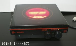

Bert - 12-12-2016 at 07:57
My favorite stirring hot plate uses a quartz heating element under a glass top. 16 years, plenty of spills and other mistakes, and only a few scratches on that quartz glass.
Bibby Sterilin. I have not seen another like it, and got it new for about USA $250.00 delivered. Heck of a deal. It is set up with a socket and removeable jumpers for remote control of heating, so a PID or such can be used. The stirring is controlled only from the unit. Does have a socket for a support rod, horizontal and out the back, rather than vertical and on top.
http://www.bibby-scientific.com/
Yes, it would be nice to monitor and adjust the stirring and temperature from an iphone.

What is the price for a 300mm square top for an IR hot plate?
BTW, 900 watts. The response time to a change in heat setting on this is FAST compared to the ceramic block units with internal resistance elements- kind of like the difference between cooking stove top with gas range and the slower to react electric ones.
(Can you tell I like these?)
1786-1.jpg - 161kB
