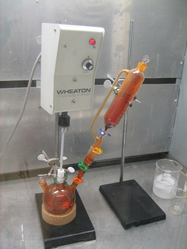

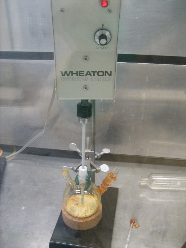

chemrox - 9-4-2008 at 17:53
Experiment 1 was a scale up from the sulfer/bromine method and it failed in the sense that most of the acid Na salt remained unreacted. Two possible factors; inadequate drying-the salt sat a long time after fusing and powdering, the other factor, inadequate stirrring. I found it impossible to move the stuff inisde the flask sufficiently to get good mixing.
The other failure was also a scale-up with some of the same issues. The method was Na salt plus acyl halide. The addition of the halide did not produce a lot of heat right away. When the addition was complete it looked like twice as much halide could have been added. Distillation of the resultant mix started at 65 degC and ended at ~160 degC
acyl halide bp 80; acid bp 141 and anhydride bp is 168 go figure. Azeotropes? There was a lot of leftover material to recover after all was done.

After reading of the success of benzylchloride1 I was anxious to try the S2Br2 synthesis of Ac2O.
Working with Br2 is exciting enough for me but add in the preparation of a vicious looking reagent like S2Br2 and the stage is set for excitement. Lacking a detailed procedure, not understanding the stoichiometry, and not able to find an MSDS for S2Br2, added to the anticipation. I prepared carefully and wore full safety regalia: safety goggles, mid-arm rubber gloves, long-sleeved shirt, lab apron, and above all: hood fan ON.
I followed BZ1's procedure exactly, except I had the benefit of a newly purchased, but not yet used, overhead stirrer.
I had reason to believe that my NaOAc was of good quality so did not fuse it. I prepared my own bromine from NaBr and washed it with con H2SO4. Sulfur was flowers of sulfur, USP grade.
Addition of the sulfur to the bromine was uneventful. I really saw no evidence of a reaction other than there was no sediment in the beaker after stirring. This was placed in a pressure equalizing funnel.
The mixer was turned on and the S2Br2 + Br2 slowly added to the 500 ml RBF. Although the mixer was working well it only stirred the material within the diameter of the blades. So most of the NaOAc just sat there as an annulus. But I kept adding the liquid until it was all in. Then I removed the addition funnel and poked the unreacted material into the center using a glass stirring rod and the side-ports of the RBF. There was some minor refluxing going on but not much. All of a sudden (within a few seconds) the NaOAc began reacting and the whole mass turned into a creamy liquid that stirred well with the mixer alone! The temperature rose to possibly as high as 80C. I did not measure it but just felt the flask by hand. After 15-20 minutes of stirring it had cooled off.
Tommorrow I will vacuum distill to recover the putative Ac2O.
Here's 2 pictures. The first is before the breakup of the solids while the liquid was still being added:
Attachment: phpsApV52 (97kB)

The second is of the creamy product following the sudden breakup of the solids:
creamy product.jpg - 86kB
[Edited on 30-5-2009 by Magpie]
[Edited on 31-5-2009 by Magpie]
Magpie - 31-5-2009 at 17:08
My preparation of Ac2O via S2Br2, started 2 days ago, was completed today.
The reaction product formed previously was vacuum distilled at 170-180 mmHg with distillate temp as high as 70C. This went smoothly with grey, slightly charred solids remaining in the pot. Crude distillate volume was about 30mL.
This was then redistilled at atmospheric pressure, obtaining 2 cuts. 1st cut: 128-135C, ~15mL; 2nd cut: 135-143C, ~10mL. I think a fractionation could serve well here instead of the simple distillation I used.
To confirm identity of the Ac2O I mixed 1 mL of cut 2 with 2 mL of aniline, added 15 mL of water, and shook vigorously. There was an immediate and massive formation of white crystals: putative acetanilide. These crystals were redissolved (by heating) and the solution then filtered. The filtrate was cooled to recrystalize. The mp of the crystals was determined to be 113-114C in agreement with my handbook value for acetanilide.

Some things that I think would facilitate this preparation:
1. Figure out some way to add the solid material (NaOAc) last, a little at a time. This would greatly aid in stirring, thus preventing the difficulties both chemrox and I experienced. It would also keep the reaction under control. Just before my reaction suddenly took off I thought I had a failed reaction, then, in 5 seconds, I thought I had a runaway.
The good thing about adding it first is that you have good containment Once you get a whiff of S2Br2 you are glad of that!
Note: Because of the sudden and dramatic breakup and reaction of the NaOAc chunk I'm thinking Sauron may well be right about the formation of an acyl halide that triggers the reaction. This also seems consistent with the requirement for initial Ac2O in one of the Rhodium procedures.
2. Acquire enough crude Ac2O to allow a fractional distillation, thus improving purity of the product.
3. Employ CaCl2 cartridges during the distillations to prevent or reduce moisture absorbtion from the atmosphere.
4. By all means have a fume hood, and consider your neighbors. Time it for when they aren't around.
Conclusions
