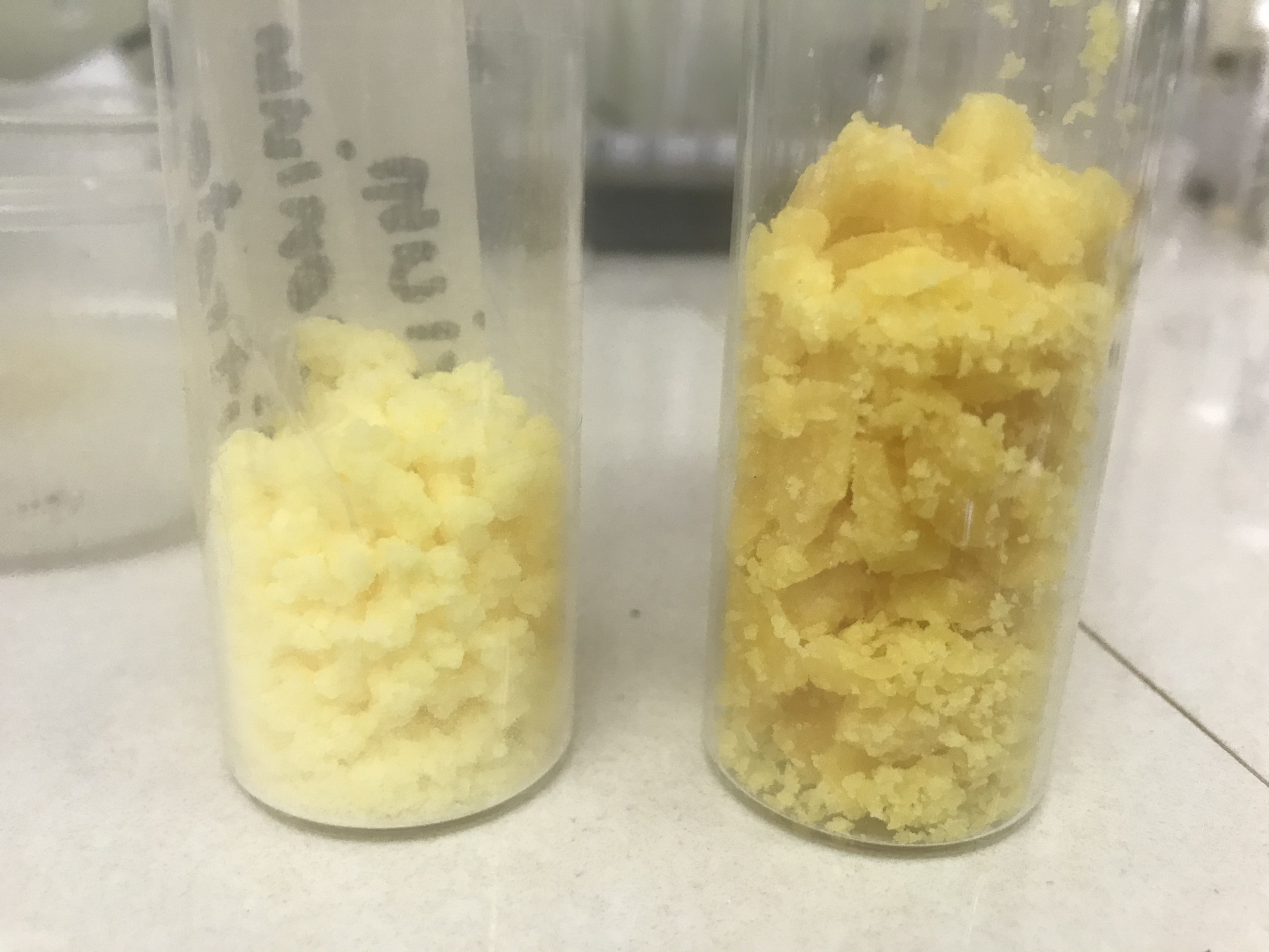

I tried to make (NH4)2Ce(NO3)6 all the way from ferrocerium rod.
First I dissolved about one third of huge ferrocerium rod in HCl. Reaction was quite violent (lot more violent than Nd2Fe14B magnets with HCl) and huge amount of H2 gas and heat was liberated. Also there was strong unpleasant smell. So I decided to seal reaction flask with stopper conected to rubber tubing to lead the gas far away and out through window (cheap alternative to fume hood). I left reaction overnight and then most of ferrocerium was dissolved. Then I diluted reaction with distilled water and filtrated off all undissolved particles until solution was clear.
Next I purified Ce(III) by precipitating cerium (III) sulfate with concentrated solution of sodium bisulfate (of course sodium sulfate works as well but bisulfate was only thing I had at the moment). Greenish Fe(III) was left in solution but white Ce (III) sulfate precipitated. I filtrated cerium (III) sulfate and washed few times with boilig water. Dried it in oven @120˚C.
Then I converted all the Ce (III) sulfate to Ce (IV) hydroxide by mixing it with hot Na(OH) solution and adding H2O2 to oxidize Ce(III) to Ce(IV). Before adding H2O2 I cooled reaction in ice bath but anyway H2O2 reacted quite virgously and after I dropwise added few mililiters of H2O2 colour changed to yellow (fine emulsion of Ce (IV) hydroxide after shaking) but most Ce (III) hydroxide was still unreacted as yellowish white clumps. Since H2O2 is not cheap, I added bleach (5% NaClO) instead. After few minutes of virgous shaking all clumps transformed to fine yellow emulsion which slowly settled down. Left ir overnight, filtrated and washed 4 times with distilled water and 2 times with acetone. After drying I got few grams of fine yellow powder of Ce(OH)4 (hydrate?)
As it was quite expensive to make, first I tried to make ceric ammonium nitrate (CAN) in small scale. I weighted 0.5 grams of Ce(OH)4 (0.0024 mol) and converted it to CeO2 by heating in test tube with butane torch until no more water was evolved.
After heating I got 0.36 grams of CeO2 (0.0021 mol).
Next I heated stoichiometric amount of ~14M HNO3 (0.9 ml) and then added CeO2. It reacted virgously but lot of CeO2 remained undissolved.
I heated mixture and added more HNO3 dropwise (~0.5ml) until most of CeO2 dissolved.
As a result I got cherry red solution which I transferred to fresh tube to get rid of undissolved particles (after settling them down for few minutes). Then heated it and added stoichiometric amount of NH4NO3 (0.34 g).
Solutions colour changed from cherry red to orange and orange precipitate formed instantly.
As the colour is exactly as it should be (http://en.wikipedia.org/wiki/File:Ceric_ammonium_nitrate.jpg) I assume orange precipitate is pure (NH4)2Ce(NO3)6
Sorry for my English. I hope you can understand what I wrote.

I just dissolved some Ce(OH)4 in nitric acid
then reduced Ce (IV) to Ce (III)
and added sodium sulfate solution. White Ce (III) sulfate was formed.
________________________
p.p.s.
I just did slightly different experiment.
weighted stochiometric amounts of Ce(OH)4 (2 g) and NH4NO3 (1.34 g)
dissolved Ce(OH)4 in ~14M nitric acid. Reaction was exotermic with lot of heat an fizzing. Eventually clear orange liquid formed.
Meanwhile I dissolved NH4NO3 in hot water. Then added it to cerium solution.
then poured on small petri dish
and gently evaporated in oven @120C until solid crust of CAN was formed
when I tried to stir with glass rod, the crust absorbed all remaining liquid and turned in dry hydrate. (According to literature its chemical formula is (NH4)2Ce(NO3)6*xH2O; x=6-8)
As a result I got 4.4 g of CAN hydrate
[Edited on 14-2-2010 by NADPH]

Lion850 - 24-2-2020 at 23:16
Today I made cerium ammonium nitrate. As it boiled down the solution was deep orange and I expected orange crystals. Once crystals started to form the color was lighter but still orange while wet. It must have been boiling off its water of hydration because as the beaker cooled the crystals became rock hard and changed color to a nice yellow. I suppose the color varies between orange and yellow depending on amount of included water?

Texium - 25-2-2020 at 07:10
CAN is never yellow like that. Anhydrous CAN is a deep red-orange. The only reference to a hydrated species that I could find was the mention of a (NH4)2[Ce(NO2)5(H2O)2]•2H2O on Wikipedia, but its appearance is not described, and since it contains water ligands and one fewer nitrate ligand, it’s a fundamentally different compound, and probably doesn’t exhibit the same useful properties as CAN. Other Ce(IV) compounds are yellow though. You may have overheated it and produced basic cerium(IV) nitrate. Try redissolving the yellow stuff in nitric acid and adding more ammonium nitrate.

Lion850 - 26-2-2020 at 21:05
Hi Texium - quite a few places online mention the color as yellow to orange, and a picture search shows samples with similar yellow color. Mine was still orange when a wet paste, and only turned yellow when it reabsorbed the water as it cooled.
I’ll try a second batch when I have more reagents ready, and dry it in the desiccator from when it is a deep orange solution.

Lion850 - 28-2-2020 at 00:18
I made another batch which I reduced in volume on a steam bath and then when it was a wet pale orange paste the desiccator under vacuum. Again, the color lightened as it dried but it did end up a bit more orangy. See photo comparing the two batches.
This site mentions that the tetrahydrate is white.

woelen - 28-2-2020 at 04:22
Keep in mind that cerium exists in two oxidation states. Cerium(III) is colorless, cerium(IV) is yellow/orange. Cerium(III) salts hence will be white.
Texium - 28-2-2020 at 07:41
Yeah at best here you probably have a mixture of Ce(IV) and Ce(III). Could you please post the exact procedure that you used to make this, since your product looks so different than what others posted upthread?
Lion850 - 28-2-2020 at 18:41
Woelen, Texium:
I had available Ammonium Carbonate, Cerium (iii) nitrate, and 70% nitric acid. All LR grade. The ammonium carbonate and cerium (iii) nitrate are both while/clear crystals. I used this equation:
1Ce(NO3)4.6H2O + 2NH4NO3 = 1(NH4)2Ce(NO3)6 + 6H20
My app does not accept Ce(NO3)3 as input which was a problem. I decided to use the same quantities as nitic acid would be in excess and I hope the nitric acid would kick the cerium (iii) to cerium (iv).
I made ammonium nitrate by reacting 29g of the ammonium carbonate (which have the formula on the bottle as NH4HCO3.NH2COONH4, I assume this is to keep it stable) with 50g 70% HNO3.
NH4HCO3NH2COONH4 + 3 HNO3 = 3 NH4NO3 + 2 CO2 + H2O
This should have given me 44g ammonium nitrate in solution.
One fitth of the ammonium nitrate solution was poured off, should have been just over 8g in solution. 15g of cerium (iii) nitrate was added and stirred. The solution remained white with suspended cerium nitrate. Slight heat resulted in a clear solution.
5ml 70% HNO3 was added which turned the solution yellow with a hint of orange. This was boiled down and as the volume decreased it became more orange until at small volume it was a dark orange. At this point the color looked perfect!
When crystals started to appear the color became lighter and towards yellow. It was removed from the hot plate still wet with a bit of orange but as it cooled it absorbed the remaining moisture, became rock hard, and the last orange disappeared.
The second lot was basically the same but it was not dried on a hotplate. It was concentrated on a steam bath and then dried in the desiccator under vacuum overnight. Slightly darker product.
It will be great if you guys can recheck my amounts used, if incorrect I must learn :)
woelen - 1-3-2020 at 23:50
You should not rely on an app ;)
If you have Ce(NO3)3, then you should not use Ce(NO3)4 in your equations. I once tried oxidizing Ce(NO3)3 to cerium(IV) with nitric acid, but this does not work very well. My solution did not get the deep yellow color I expected. Cerium(III) is fairly difficult to oxidize to cerium(IV). If you have peroxodisulfate (e.g. the ammonium salt or sodium salt), then you should be capable of oxidizing it completely to cerium(IV).
