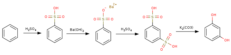

Possible route to resorcinol from Tylenol / Paracetamol?
guy - 29-12-2007 at 23:01
The only step I'm unsure about is how good the reductive demamination with EtOH is.

Nicodem - 2-1-2008 at 08:23
Even if the nitrosation/oxidation gives you the correct regioisomere as the above reference clams (I have doubt's but could be), you will still have to deaminate by nitrosating a p-hydroxyaniline which I do not think it is possible without ending with the corresponding p-benzoquinone (I could be wrong though, but not motivated enough to check the literature).
PS: Resorcinol is terribly cheap and easy to buy. You might have at least chosen a better target. For example, if you manage to prepare 3-nitro-4-acetamido-phenol you could make 2-methyl-5-hydroxybenzimidazole from it... or anything at least remotely more interesting than resorcinol.

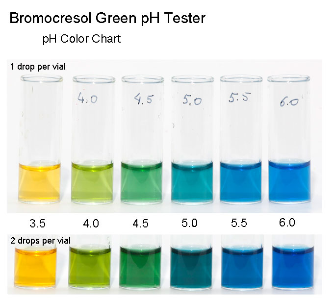

Bromocresol green indicator is probably about right, keeping toward the yellow range during the reaction.

Bromocresol green should work as an indicator to monitor pH, being kept towards yellow for the reaction to proceed. The end product is IIRC yellow and the expected quench pH possibly about pH 5.5 due to sudden reduction of the active evolution of HNO2. The mix of color in the optimum range is likely then to be a yellowish green with the quench arising in the really solid green that would come with rising pH in the likely pH 5.1 to pH 5.5 range with the peak HNO2 activity expected at about pH 4.8 to pH 5. Anyway, the Japanese chemists specified pH 4 so pH 4 is what I modeled, just in case they are right on the bullseye. It could be interesting to try an alternate model with the buffer at pH 4.8 to see if yield goes up or down.
bromocresol_green_chart.jpg - 54kB
There should be adequate solubility for the paracetamol slurried in the 20.4% acetic acid / 8.2% sodium acetate trihydrate "model" buffer reaction medium for it to very gradually dissolve enough to react incrementally in the contemplated reaction scheme.
How cleanly will be the separation of the end product is unknown, and is dependent upon the solubility in the spent reaction mixture. Neutralzing and salting out may be required, and / or evaporation possibly vacuum evaporation at reduced temperature to facilitate recovery of the end product. Or an extraction using a solvent, possibly methylene chloride or toluene may be required.

Here's a scheme that should actually be valid. Only missing one reference.
resorc.png - 11kB
1. Start with benzene and sulfonate as usual with H2SO4.
2. Create the Barium salt with BaOH or similar.
3. Reflux with Conc Sulfuric acid at 209*C ~4Hr's to create the 1-3 disulphonate.
Benzenedisulfonic Acid from Benzenemonosulfonic. C. E. Senseman. Ind. Eng. Chem., 1921, 13 (12), pp 1124–1126. DOI: 10.1021/ie50144a012 (http://pubs.acs.org/doi/abs/10.1021/ie50144a012?journalCode=...)
4. Melt in potassium carbonate (missing ref?) Meyer, J (1897). Ber 30: 2569
Probably not cheap but it seems like there would be appreciable control in the intermediates synthesis (no regioisomer hell). Pretty simple chemistry. Not sure what temp the melt is performed at though.
[Edited on 5-7-2015 by smaerd]
gdflp - 5-7-2015 at 11:10
There is a procedure for the alkali fusion of the 1,3-disulphonate on p.144 of Fundamental Processes of Dye Chemistry in the forum library, I believe that Magpie did some experimentation with the preparation of resorcinol this way a while back. That's a very interesting reference for the disulfonation, I was always under the impression that the disulfonation of benzene required at least 20% oleum, such as the procedure preceding the alkali fusion in Fundamental Processes of Dye Chemistry.
smaerd - 5-7-2015 at 11:32
Come to think of it, I think I read Magpie's synthesis a year or so ago! Or maybe it was a napthalene derivative(http://www.sciencemadness.org/talk/viewthread.php?tid=11663#...)? Either way, same type of chemistry.
Supposedly, the publication: Polak. Rec. Trav. Chim. , 29, 1910,
States that the barium salt in 98% acid (sulfuric) is sufficient. Then again, maybe in 1910 industrial acid had high concentrations of oleum. The reason I believe it wouldn't is that they state 98%. Could be a load of shit though.

About bromocresol green...is it stable towards nitrous acid?
The colour shift is interesting but if you form a yellow compound in the blue shift region the total solution will look green giving misleading info about pH.
If you form a brown compound the colour will also be hard to figure...
Last but not least...paracetamol will also make a buffer arround pH 9.3 +/-1 and the resulting 3-nitroparacetamol will add complexity with a third buffer arround pH 8.6 +/-1...
So wich one will win? Acetic acid/acetate, p-acetaminophenol/p-acetaminophenate or 3-nitro-p-acetaminophenol/3-nitro-p-acetaminophenate?

Yes I think the colour of the reaction mixture will mask the colour of bromocresol green if used in the reaction mixture (and survives) I would use the dye to prepare paper strips. Actually all of the reactive (ie phenolic) o and p sites in bromocresol green have already been blocked so the compound may survive under the mildly acid conditions, it depends on its ability to resist oxidation.

WRT the bromocresol green if it does survive the reaction system then yes I knew the green range would likely be obscured, but thought the yellow would probably work as the marker. What will be the color development for the reaction mixture is an unknown that could defy any use of any indicator dye and it could require monitoring with a meter. Also possible is that any buffer system would be overloaded but that would tend to not make sense for reason that use of a buffered reaction system was specified by Matsuno. To specify a buffered system if a buffer wasn't even used would be misleading more than simply being deliberately obscure and would be unethical and dishonest.
