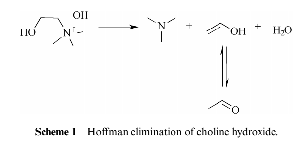

DeIonizedPlasma
Posts: 21
Registered: 28-9-2014
[*] posted on 8-12-2015 at 20:17
I'm going to have to try that some time;my choline chloride smells awful! I thought that was just a property of that compound.
No, sadly choline chloride just likes to undergo a Hoffman degradation into trimethylamine (wonderful fishy smell), water, and ethenol/acetaldehyde from what I can find. Mechanism picture attached, taken from Electrochemical decomposition of choline chloride based ionic liquid analogues. Given that it requires the hydroxide rather than the chloride, I think it may be happening due to trace presence of water. I couldn't find more mechanisms on the degradation, but I wonder if there isn't one that would occur in anhydrous ChCl. Perhaps someone should attempt to seal some choline chloride with negligible water content and leave it out for a while to test if it produces trimethylamine.
gF3IG1v.png - 19kB
[Edited on 9-12-2015 by DeIonizedPlasma]
