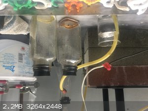

Today I made ethylene using a tube furnace packed with 6" of alumina BBs. The BBs are BASF F200, 1/8" in diameter held in place with 1/8" mesh ss screens on both ends. The ethanol feed is 95% ethanol (Everclear). The system was first purged with argon. The ethylene was caputured underwater using the 2 gas bottles shown. When lit the gas burned like a candle with a somewhat sooty flame. I intended to do unsaturation tests with Br2 water and KMnO4 water but did not have these reagents prepared. The furnace temperature was held at 469°C using a PID controller. The ethanol was kept at a low boil.
See next post for 2 additional pictures.

[*] posted on 30-11-2018 at 18:38
condenser.JPG - 1.9MB gas bottles.JPG - 2MB

[*] posted on 30-11-2018 at 18:48
Photos are downside up

[*] posted on 30-11-2018 at 18:59
Toggle the pictures. They will invert.
