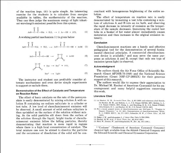

I'm just curious of how this mechanism works. Obviously what happens is a photon is given off somewhere in the reaction of a low wavelength, but what is the reaction?
According to here it's like:
So what's going on is that the part connecting the trichlorophenols is folding in on itself, then that byproduct reacts with the fluorophor (the anthracene dye) to give off light in the form of a photon.
Basically the ring-like molecule is exciting the fluorophor.
Am I right?

IIRC, the peroxide oxidizes the TCPO to yield the dioxetane which spontaneously decomposes to yield 2CO2 and hv (which is in the UV range). The UV-hv excites the fluorophore and the resulting emission is visible.
If you balence the equation you will find the staight oxalyl chloride will work just fine. The diester is just to make it easier to handle/store. I have tested it with straight oxalyl chloride and it works fine.

Here's a .zip containing 5 papers. The best one is probably Mohan's (from American Cyanamide) from 1974 (It is the one I used the first time I made the stuff).
There is some controversy surrounding the dioxetane-to-light step. In one of the papers, it appears that a dye-radical cation might exist briefly with the CO2 radical anion. While this suggests the possibility of dye stimulation via intersystem cross, it does not necessarily rule out photochemical (UV) excitation.

Oh well, here are screens of the Mohan paper. Sorry about the low quality, but they will get you by.
Cheers,
O3
Mohan 1974 page 1.jpg - 483kBMohan 1974 page 2.jpg - 300kB
