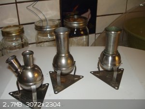

I've picked up these round bottom flasks which seem to be stainless steel.
They're certainly some rustproof gray metal, but they have no markings whatsoever except an 'M' on each one.
Two have standard taper joints in 24/40, and one is a 2-neck 14/20 flask.
Two were assembled by welding, and one looks like it might have been brazed together.
So just what are these things actually for?
High temps and caustics?
If I stick a glass fitting in one of those standard taper steel outer joints, won't the different expansion coefficients be a problem?
Will I have to hunt up steel condensers and dropping funnels to use this stuff? Or some hellishly expensive glass-to-metal fittings?
Okay, so I bought something I know nothing about..again, but I'd never even seen a steel RBF in regular lab-scale size before, and these little beauties were just as cute as lace pants.
Anyway, any information would be appreciated.
The only similar stuff I've seen is large Ace-style reaction kettles; and they had flat flanges, not tapered steel joints.

Can you post pictures ?

DSC03592.JPG - 2.5MB DSC03592.JPG - 2.5MB
DSC03590.JPG - 2.7MB
These are them.
They're black on the inside. Don't know if they're ashed in a furnace to clean them or if they're just dirty.
(It just occurred to me that it will be challenging to tell when these things are clean too)

Oh wow, ive thought about those before but ive never seen them anywhere.
They could be one of a kind.
If you wanted to put them to use i think you may get away with glass joints that are perhaps slightly smaller than the joints on the flask, which are then packed with ptfe tape to seal them, i suppose if the temp was below 200*C i doubt there would be enough thermal expansion to put any strain on the glass but id be more concerned with it not sealing.
You could definitely do some simple organic stuff in them, but there are alot of things that would be just plain incompatible (especially acids).
Maybe making benzene via decarboxylation of benzoic acid or another thermal decarboxylation.
Maybe even prepare anhydrous ammonia.
2 NH4Cl + 2 CaO → CaCl2 + Ca(OH)2 + 2 NH3
This chart may be of some use.
https://www.calpaclab.com/stainless-steel-chemical-compatibi...

The bases appear to be stamped "18-8 stainless steel". Is the 'M' on the flask? They could be made of Monel - I have worked with it before, very difficult to machine/fabricate, VERY expensive - also extremely corrosion resistant to most acids and nasty HF caustics.
If it is Monel, I would expect those to easily cost several hundred bucks apiece to machine and fabricate. Monel is such a pain I would quote them at $1000 each and be disappointed if I got the job.
The "M' mark is on each flask, right below the neck, like it was stamped with a simple metal stamp. I'll try to get a clear picture in the morning, but there's not much to it.
The holders marked 18-8 stainless are, I think, not really related to the flasks. They look like the holders they use for flasks on shaker trays, and they're marked Fischer and have a patent number on them. I bet they were just something handy to display the flasks on.
I assumed the flasks were stainless, but they do have an odd color.
I have polished the outsides to get the discoloration off, and the result looks a bit darker than clean stainless steels I'm used to. Almost like a pewter in color.
Any Ideas on how I can find out if these ARE monel?
The density of monel looks like it's in the range of stainless steel, so I suppose I can't use that. The seams on the welded ones do look like whatever they're made from isn't much fun to weld.( Like it goes mushy when you try to fuse it.)
One of the flasks did have some green crystalline residue in the neck, which Could have either been corrosion, or just residue from whatever they were last used for. It reminded me of a nickel salt, maybe chloride, in color.

Well, if you don't mind sanding off a little bit of dust from the surface somewhere, you could test for copper. SS does not contain copper but Monel does.
I am just tryiung to think of a simple wet chemistry test that would differentiate between Ni ands Cu. Give me a moment...
[Edit]
Not much springs to mind.
Assuming you dissolve a few micrograms of your metal in some acid (I would use nitric), you could try the following tests:
Cu2+ forms a red/brown precipitate with potassium ferrocyanide. I don't think Ni2+ does anything similar. But that might not be a good test -- particularly if Fe and Cr are around.
Cu(OH)2 is a lot less soluble than Ni(OH)2. So if you make your solution alkaline and catch the first precipitate, then test that with concentrated ammonia -- the Cu tetramine colour will confirm the presence of Cu in your original material. That would be a strong indication of your original material being monel.

Test for Monel:
Depending on the amount of copper in the alloy, Monel should be somewhat magnetic.
1 drop 1:1 nitric acid and water, observe after 5 minutes
No reaction indicates 400 series SS or 17-4 PH
If bright green, add 1 drop concentrated ammonium hydroxide
Blue color indicates Monel
