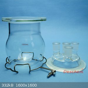

I see that it is highly case sensitive. I don't know how well it could perform when there are other substances that also evaporate, solidify or sublime within few 10's of degrees.
I was thinking, could a reactor type flask be used for vacuum sublimations? Cold finger(s, as multiple joint flanges) could be inserted for condensation.

I suppose you could, but why not just use a normal setup with a coldfinger under vacuum? Most borosilicate jointed glassware is already rated for vacuum. Pull a vacuum under a 2 necked rbf with a coldfinger, vacuum adaptor and a trap.
