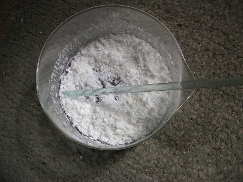

I have just evaporated CH3NH3Cl solution [ prepared from absorbing CH3NH2 gas in HClaq; gaseous methylamine was released (by adding NaOH) from brown, impure product of reduction of CH3NO2 with Fe/HClaq ).
Quickly, cheaply and easily :P
On the picture : about 0,6 mole of hydrochloride
[Edited on 26-6-2009 by kmno4]
