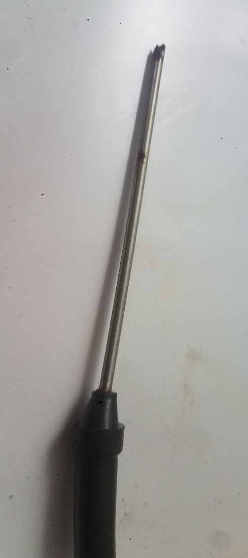

I reheated it today after insulating more thoroughly. Same heat settings, though I have some question as to the veracity of the sand bath temperature; the thermocouple probe looked pretty bad after I pulled it out. The last time a thermocouple got melted, the readings were unrealistically high.

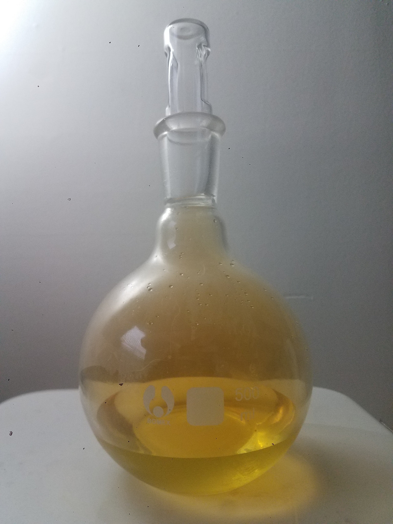

I ran the distillation until it reached 114°C (density of 1.34g/mL at 28.4°C, 57.6% for the first fraction), then swapped receivers as it seemed to not be climbing. The temperature dropped to around 110°C and never rose again. I ended heating when I saw heavy red clouds of NO2 puffing into the condenser. Haven't measured density for the second fraction yet.
I'll definitely run this again. I'm thinking I'll do several runs, combine all the fractions, and do one final distillation to get 68% HNO3. I also think I'll switch to an oil bath. As to insulation, that seemed critical, so maybe I'll get out the glass wool. I'd used Al foil this time--ultimately in 3 layers.
Edit: Took the density of the second fraction, got 1.36 g/mL at 22.7°C, which is 61.0%. I'm satisfied with this as a first attempt. Certainly, my technique could stand improvement, but the reaction worked with relatively little fuss. I did not suffer major issues with foaming or clogging--I found it to be rather well behaved for such a solids-heavy slurry. I employed a dumbbell-shaped stirbar just in case. I found the microwave trick to be extremely useful in cleaning my reaction flask. As for the thermocouple: it did not survive. A couple pictures, the thermocouple and the combined fractions before the acid is transferred to an amber bottle.
20180929_072719.jpg - 261kB 20180929_072807.jpg - 1.8MB
